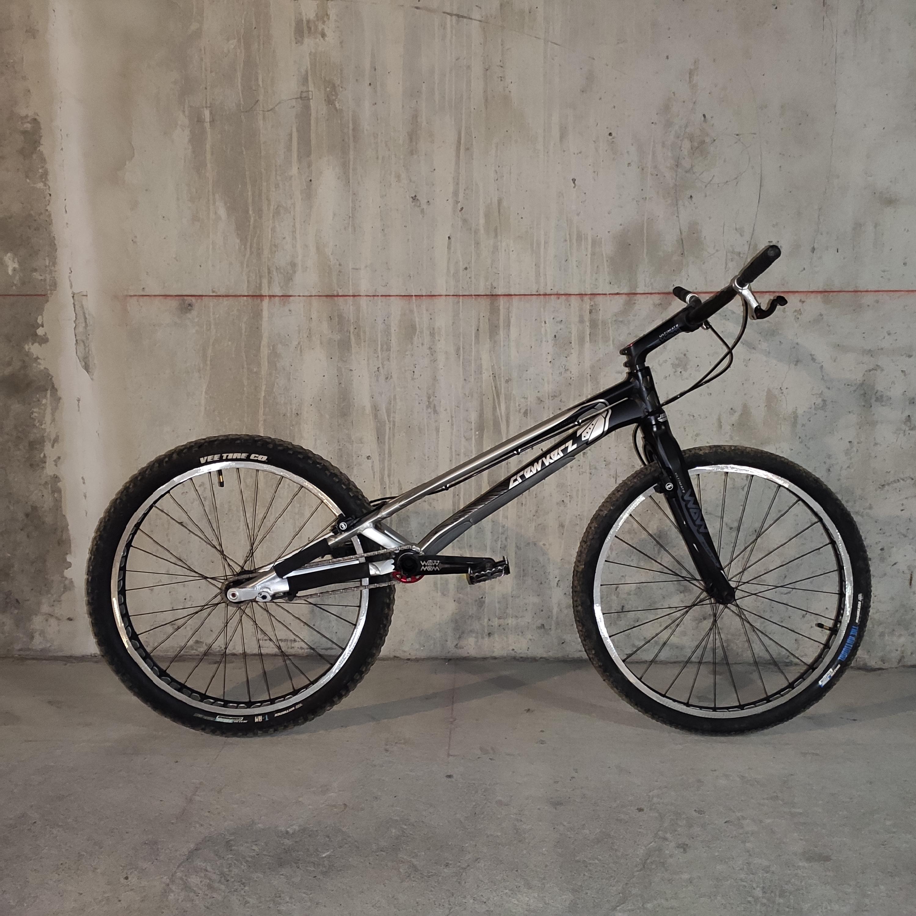

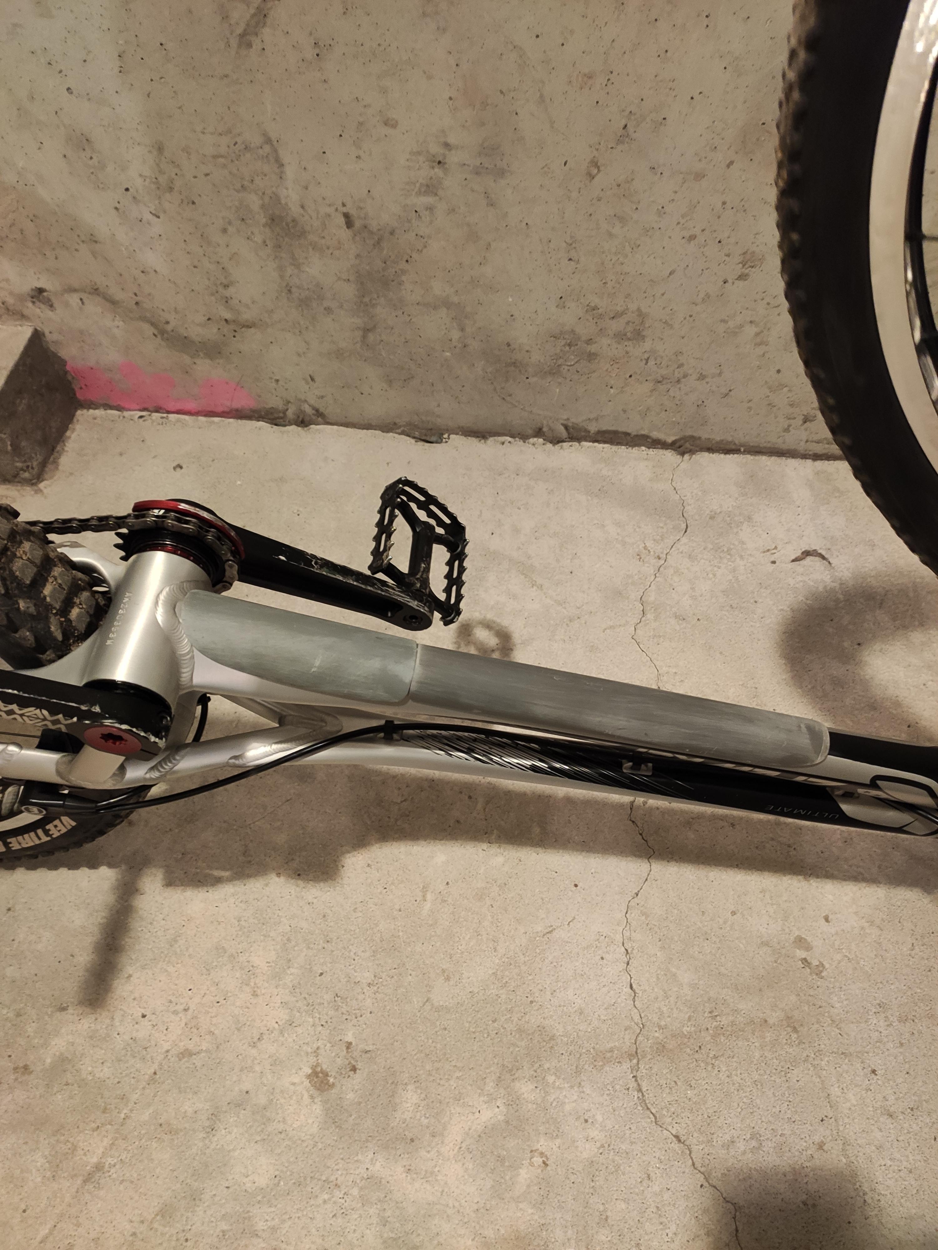

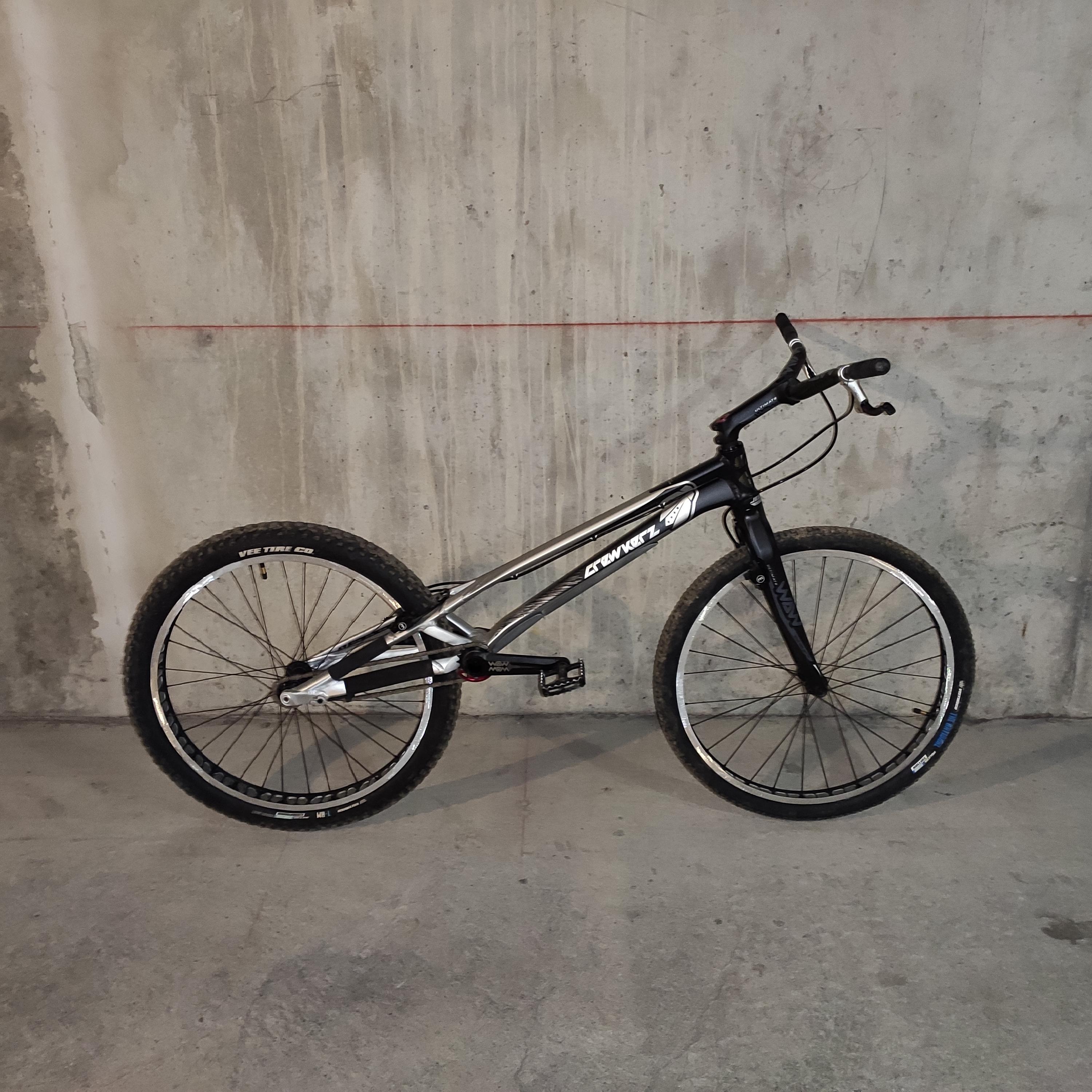

Canardweb Posted February 21, 2024 Report Share Posted February 21, 2024 Hello, just a small advertisement about the new Crewkerz bikes and frames with the new design. The decoration of both the frame and components is now more sober and every red accent from through-axle or bashing are now black. Mine uses old parts as I prefer red ones. They have increased tube thickness, integrated headset and updated geometry as they are all shorter. I am also working on some universal frame protections. This is my fifth prototype made from PVC. I hope to be able to make them from carbon soon. Previous prototype saved my 20" that I sold as it would have been dented otherwise. Enjoy! 2 Quote Link to comment Share on other sites More sharing options...

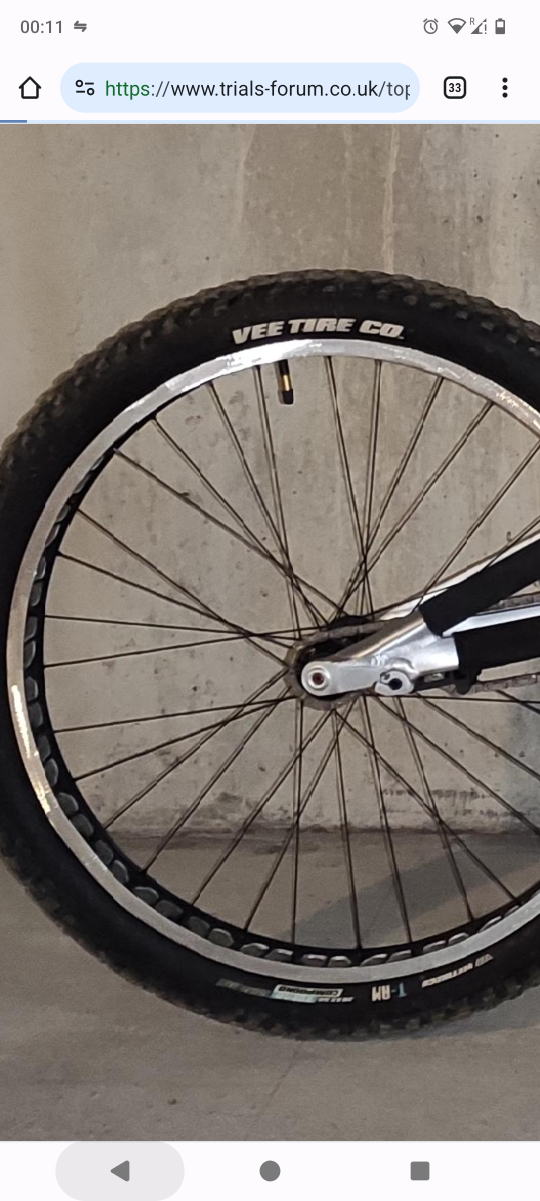

La Bourde Posted February 22, 2024 Report Share Posted February 22, 2024 You meant head tube instead of headset, right? I really like the fact that they always improve the proven design further. When you look at the history of the Atomz/Crewkerz bike, it is like natural evolution: AKTII -> Quark -> Cleep -> Jealousy mkI -> etc. Some minor changes for each generation. Also having slightly shorter bikes sounds for me better. My 1090mm large Cleep is for my riding level not better than my Freed 3 with 1070mm. On the other side, I found the 1065 Jealousy I tried two weeks long too unstable. Was really nice to have fun with though. PS: be careful with your spokes, they look already snapped on the pictures (how can a smartphone generate these artifacts !?) Quote Link to comment Share on other sites More sharing options...

Canardweb Posted February 23, 2024 Author Report Share Posted February 23, 2024 16 hours ago, La Bourde said: You meant head tube instead of headset, right? I really like the fact that they always improve the proven design further. When you look at the history of the Atomz/Crewkerz bike, it is like natural evolution: AKTII -> Quark -> Cleep -> Jealousy mkI -> etc. Some minor changes for each generation. Also having slightly shorter bikes sounds for me better. My 1090mm large Cleep is for my riding level not better than my Freed 3 with 1070mm. On the other side, I found the 1065 Jealousy I tried two weeks long too unstable. Was really nice to have fun with though. PS: be careful with your spokes, they look already snapped on the pictures (how can a smartphone generate these artifacts !?) Where did I made a mistake about the headset or head tube? And what's wrong with my spokes? 3 hours ago, Jere_h said: Yeah although the logic to that long wheelbase and short stems in MTB is geared towards gravity riding/downhill sections which doesn't apply to trials at all. So to get fast in trials we'd proably have to look towards XC bikes which already has kind of happened. I think this new slightly shorter wheelbase of the -24 Jealousy favours very well that modern quick and flowy riding style. Also riders getting stronger and stronger, most of them seems to hit gym as much as riding their bike, so maybe they don't need that added leverage of a long bike anymore. Just thoughts/guesses anyway, it's always a compromise and depends on rider body etc. Personally I've tried long and short trials bikes too and noticed the same thing, if the setup gets too short it will be exhausting or not so precise to keep on the backwheel which affects pretty much all the other moves then. MTB geometry is actually one pretty interesting topic right now. As we know those bikes have been consistently getting longer and slacker to a ridiculous level, but now it seems like they're making sort of an U turn finally. The reach getting shorter, stack higher and chainstays longer (the last one is making me a bit uncomfortable though but I get the idea of better cornering). Commencal actually shortened the reach of the new Meta v5 as much as 20mm compared to previous gen, so the bike rides higher and more relaxed. But yeah we're talking about MTB industry so it might be 50% of what really is necessary to develop a better bike, and 50% of marketing and getting people to constantly update their rig. Bikes are so good already, it's getting impossible to make them any better without sacrificing things. Couldn't agree more! Quote Link to comment Share on other sites More sharing options...
La Bourde Posted February 23, 2024 Report Share Posted February 23, 2024 8 hours ago, Canardweb said: Where did I made a mistake about the headset or head tube? And what's wrong with my spokes? I first understood you wrong. Read twice helped. They changed both the headset height and the headtube length, right? Your spokes looks silly on my display : Look at the top left oblique ones. They look like they are not continuous 1 Quote Link to comment Share on other sites More sharing options...

Canardweb Posted February 24, 2024 Author Report Share Posted February 24, 2024 5 hours ago, La Bourde said: I first understood you wrong. Read twice helped. They changed both the headset height and the headtube length, right? Your spokes looks silly on my display : Look at the top left oblique ones. They look like they are not continuous They went for integrated headset. You don't have to press cups inside the frame anymore. Which reduces the stack height. And they also reduced the head tube length yes. Not the best choice for an oldschooler like me...( I guess that's what I am now...) About the spokes: WHAT IS THIS SORCERY? Look at the rim also hahahaha. Prototype square rim! 1 Quote Link to comment Share on other sites More sharing options...
