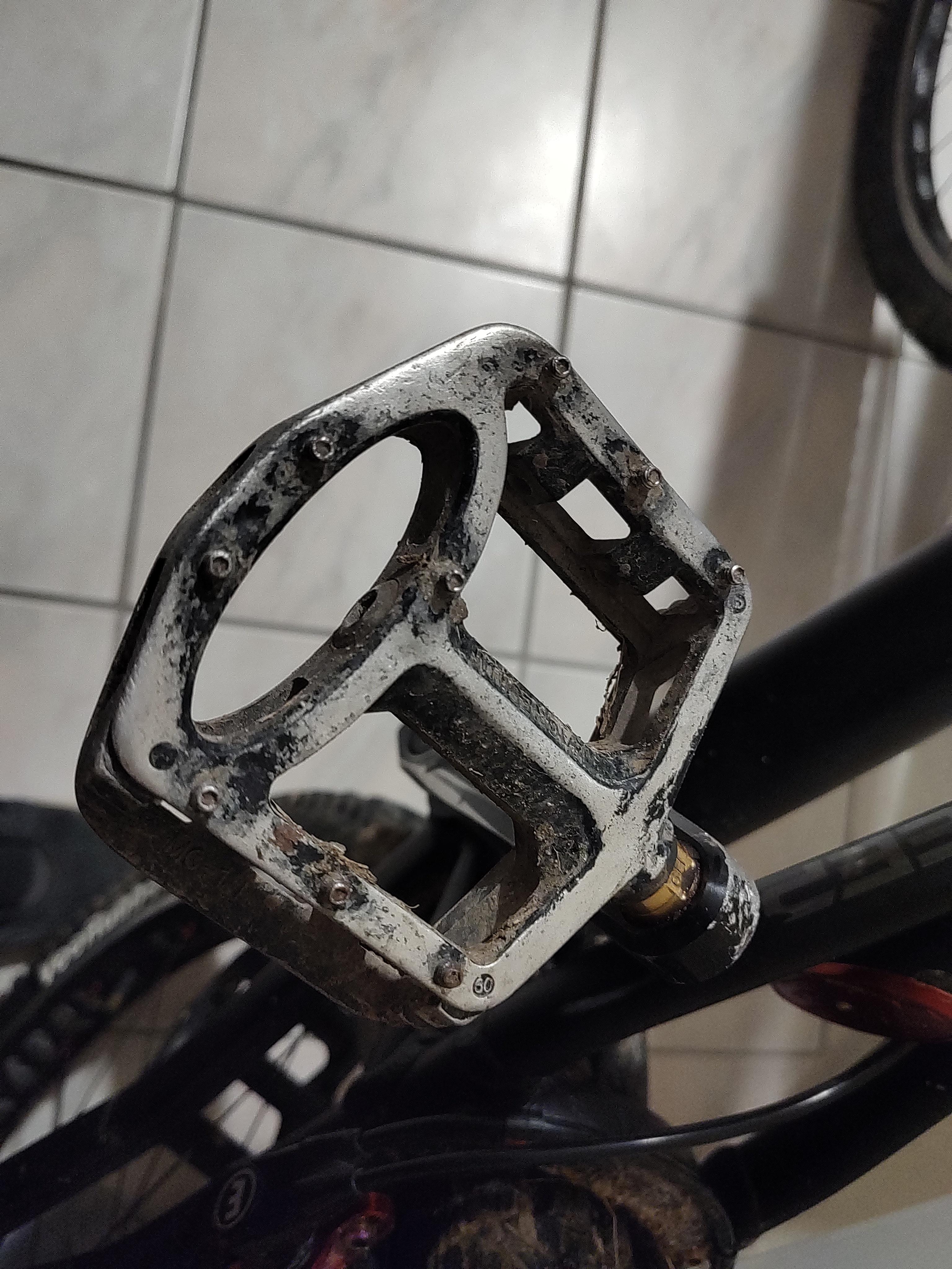

Hi,
the last few wet rides, my feet just keep slightly move on the pedals: the paint on the aluminium body is missing on some area and the soles of my shoes are worn much.
In addition, the xpedo spry are not concave and the axle protrudes.
Years ago, I removed the original pins and put some grub screws (6 mm and 8mm, if I recall correctly)
Not a problem in dry conditions, but as soon as the sole is wet I was a little annoyed.

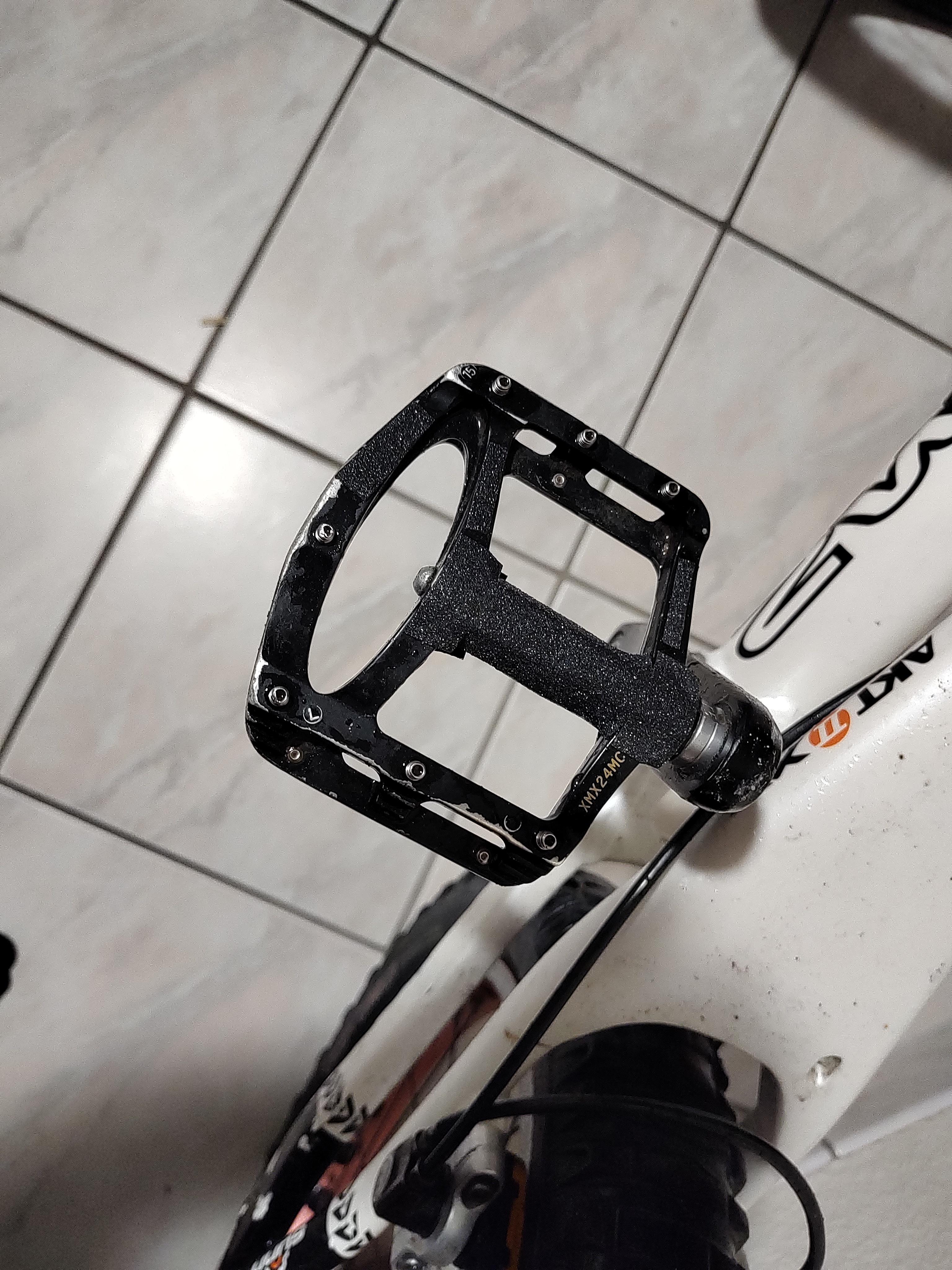

So I tried to glue some skate grip tape.
The first ride with the grip tape is positive.
Do you use grip tape in your pedals?
How long does it last?

I guess it makes sense first when soles and pedals are worn.
As long as the paint is present, the body has enough grip in wet conditions.
But I have some pedals which body is almost polished by the soles of my shoes. In this case, even if the pins are sharp, I feel less grip.
I rode today again in wet conditions and still have the impression it is better.
