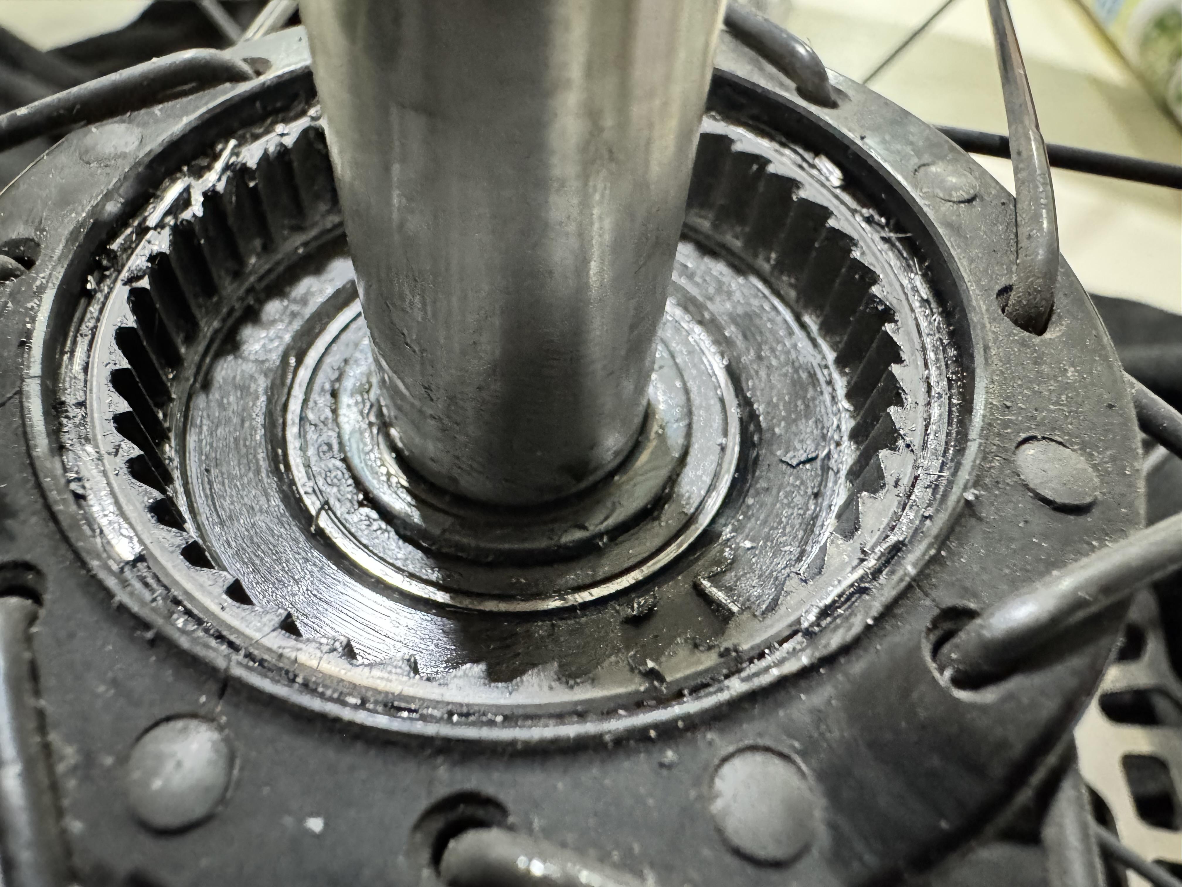

MaderaMark Posted November 4, 2024 Author Report Share Posted November 4, 2024 4 hours ago, A1T4 said: Has it happened again. absolutely, YES.... first Hope hub lasted about 1 year and 7 months... this second one is about 8 months... Iit is funny because, years ago I was 3kg heavier than this year and nothing much have changed on my riding skills.... Quote Link to comment Share on other sites More sharing options...
La Bourde Posted November 4, 2024 Report Share Posted November 4, 2024 That sounds quite bad. I never encountered an issue with the 3 Hope pro IV ss/trials I owned. Neither on the classic one on my wheels for enduro/DH. The steel outer ring slips within the hub shell, right? Like with your first one? Is the hub shell cracked? Who laced the wheel? What was the spoke tension? 1 Quote Link to comment Share on other sites More sharing options...
MaderaMark Posted November 4, 2024 Author Report Share Posted November 4, 2024 1 hour ago, La Bourde said: That sounds quite bad. I never encountered an issue with the 3 Hope pro IV ss/trials I owned. Neither on the classic one on my wheels for enduro/DH. The steel outer ring slips within the hub shell, right? Like with your first one? Is the hub shell cracked? Who laced the wheel? What was the spoke tension? The steel outer ring slips within the hub shell, right? Like with your first one? YES Is the hub shell cracked? NO Who laced the wheel? Reputable Bicycle shop here What was the spoke tension? not sure but I asked the shop to lace the spoke professionally, since the charge is a bit pricey.... Quote Link to comment Share on other sites More sharing options...
La Bourde Posted November 4, 2024 Report Share Posted November 4, 2024 Maybe Hope had a bad batch and this hub landed on the grey market. Today I saw a video about Hope counterfeit cranks (in French else I would have share). Difficult to tell the difference until they crack. He notable differences were: - one part was not anodised but is anodised one the genuine ones - the label of the crank length is lasered instead of CNC'd - the axle machined in a slightly different way. Quote Link to comment Share on other sites More sharing options...

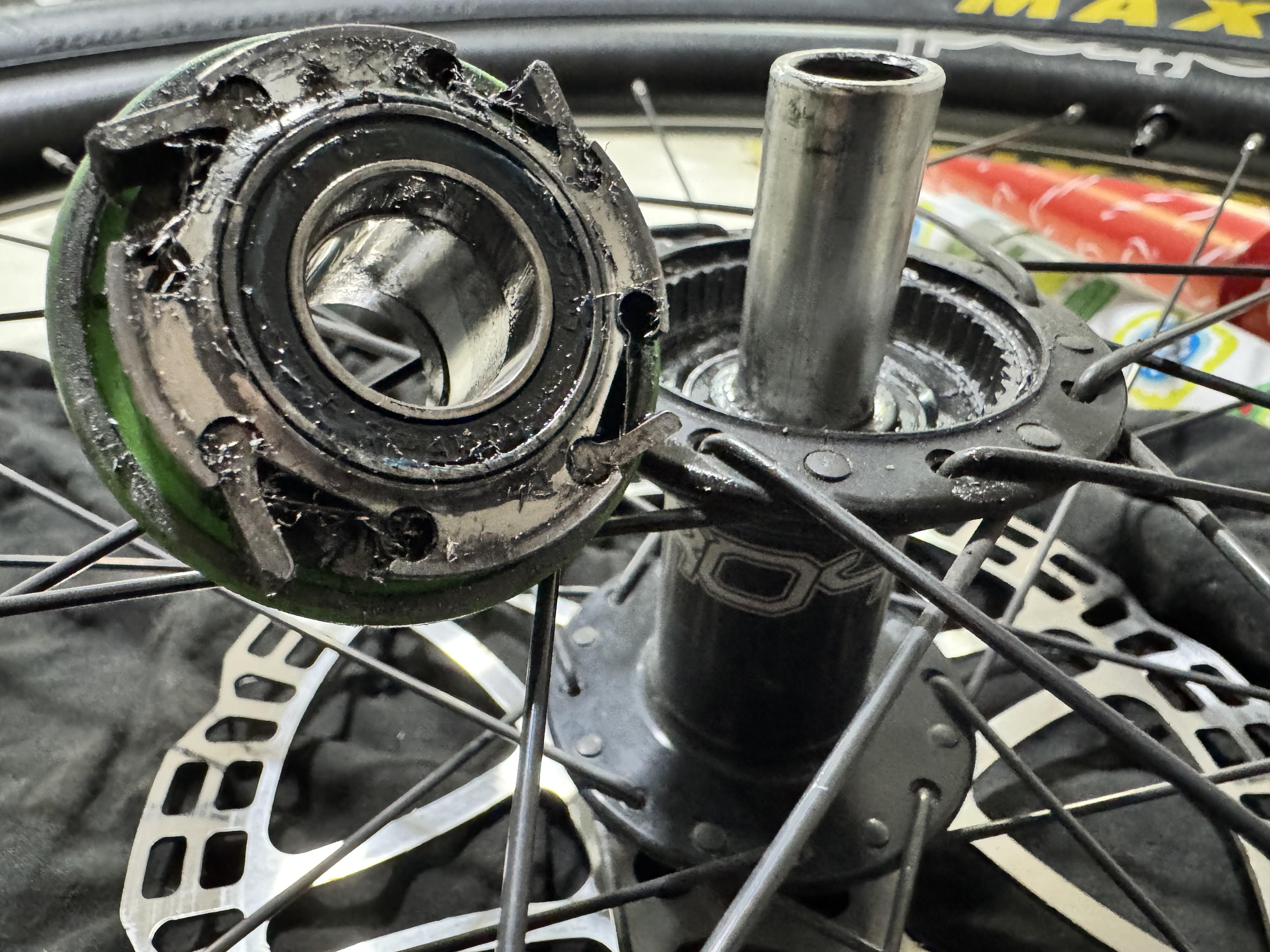

yoda Posted December 27, 2024 Report Share Posted December 27, 2024 (edited) Just had the same happen with my Hope Pro 4. Also note the cracks to the spoke holes. Edited January 9 by yoda Quote Link to comment Share on other sites More sharing options...
La Bourde Posted December 27, 2024 Report Share Posted December 27, 2024 The cracks to the spoke holes are very interesting. When the spoke tension is too high, some cracks can appear, but mostly on the outside. When the tension is too low, the spokes broke (don't expect the hub shell to crack first) Quote Link to comment Share on other sites More sharing options...
Szymon Posted December 30, 2024 Report Share Posted December 30, 2024 I wouldn't consider a hub that's a few years old and has never been serviced. Maybe the hub broke because of worn bearings? Quote Link to comment Share on other sites More sharing options...
