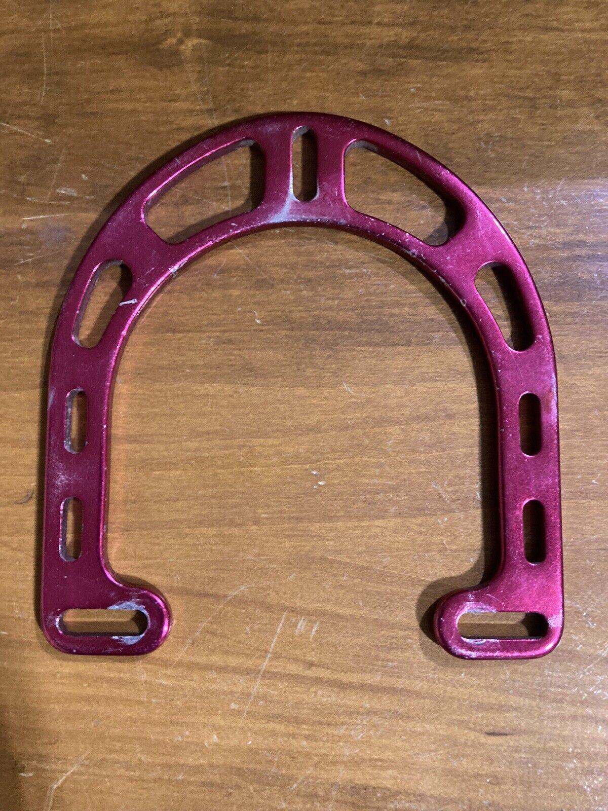

coldriverjoe Posted October 30, 2023 Author Report Share Posted October 30, 2023 Ok, I just did another deep search and found this for 15 bucks on ebay (attached). The dimensions check out. I'll give it a try. It's crazy that 99% of brake boosters that I find online don't have dimensions posted and those that do are for 80mm stud spacing. Many thanks for the input! Quote Link to comment Share on other sites More sharing options...
