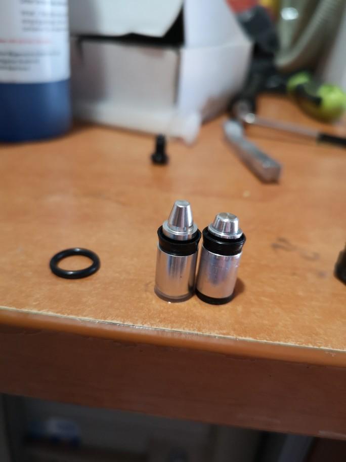

Szymon Posted August 22, 2023 Author Report Share Posted August 22, 2023 MT7 piston on the left, MT5 piston on the right 1 Quote Link to comment Share on other sites More sharing options...
Daan Posted August 22, 2023 Report Share Posted August 22, 2023 (edited) On 8/22/2023 at 6:25 AM, Szymon said: MT7 piston on the left, MT5 piston on the right Expand So, does the diameter differ? We need a venier calliper pic Edited August 22, 2023 by Daan Quote Link to comment Share on other sites More sharing options...
Szymon Posted August 22, 2023 Author Report Share Posted August 22, 2023 Diameter is the same. Only the shape is different. Quote Link to comment Share on other sites More sharing options...
Daan Posted August 22, 2023 Report Share Posted August 22, 2023 Cool, so definitely no difference in power/leverage Quote Link to comment Share on other sites More sharing options...
