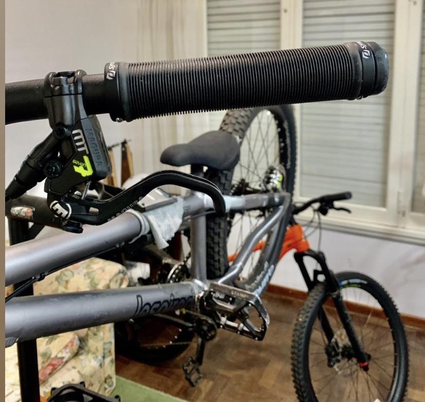

javimic Posted July 9, 2023 Report Share Posted July 9, 2023 Hello everyone, There is a personal factor but: What is the standard width grip to avoid killing forearms in trials? 30mm? My forearms are like rocks since I changed the grips. I had been using the odi longneck grips 🥰 for a year with no problem. No gloves. I changed them for a pair of Synchros dh lock on grips because they were the same ones I had on my DJ but the compound is different and the new ones gave me blisters the first time. So I wear gloves and now my forearms are like rocks as I said before. It seems that the gloves could be the truly reason because I am not used to wearing them. 🤷🏻♂️ Quote Link to comment Share on other sites More sharing options...
