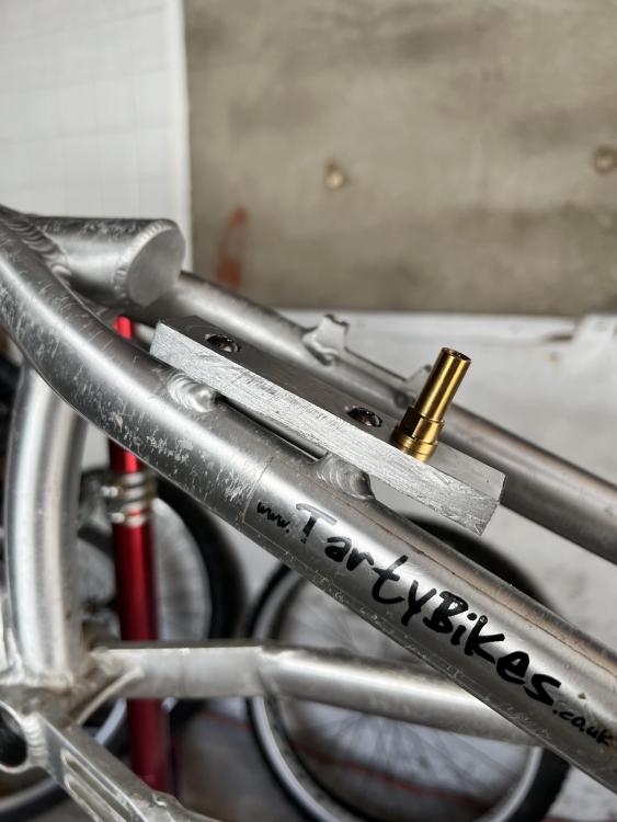

AdamR28 Posted June 23, 2023 Report Share Posted June 23, 2023 Sometimes you can drill / tap the lower frame mount out to M8 and screw a boss straight in. Depends what bike it is (photo would help). Quote Link to comment Share on other sites More sharing options...
Canardweb Posted June 23, 2023 Author Report Share Posted June 23, 2023 (edited) I own a Crewkerz Cleep 2. I will try and post some photos of the brake area but it's definitely impossible for the carbon forks. What I thought was drilling a V-brake boss and inserting a non ended M5 bolt in it so you could screw it in the existing M5 Maggie thread on the frame. I don't know if I am clear enough... Edited June 23, 2023 by Canardweb Quote Link to comment Share on other sites More sharing options...

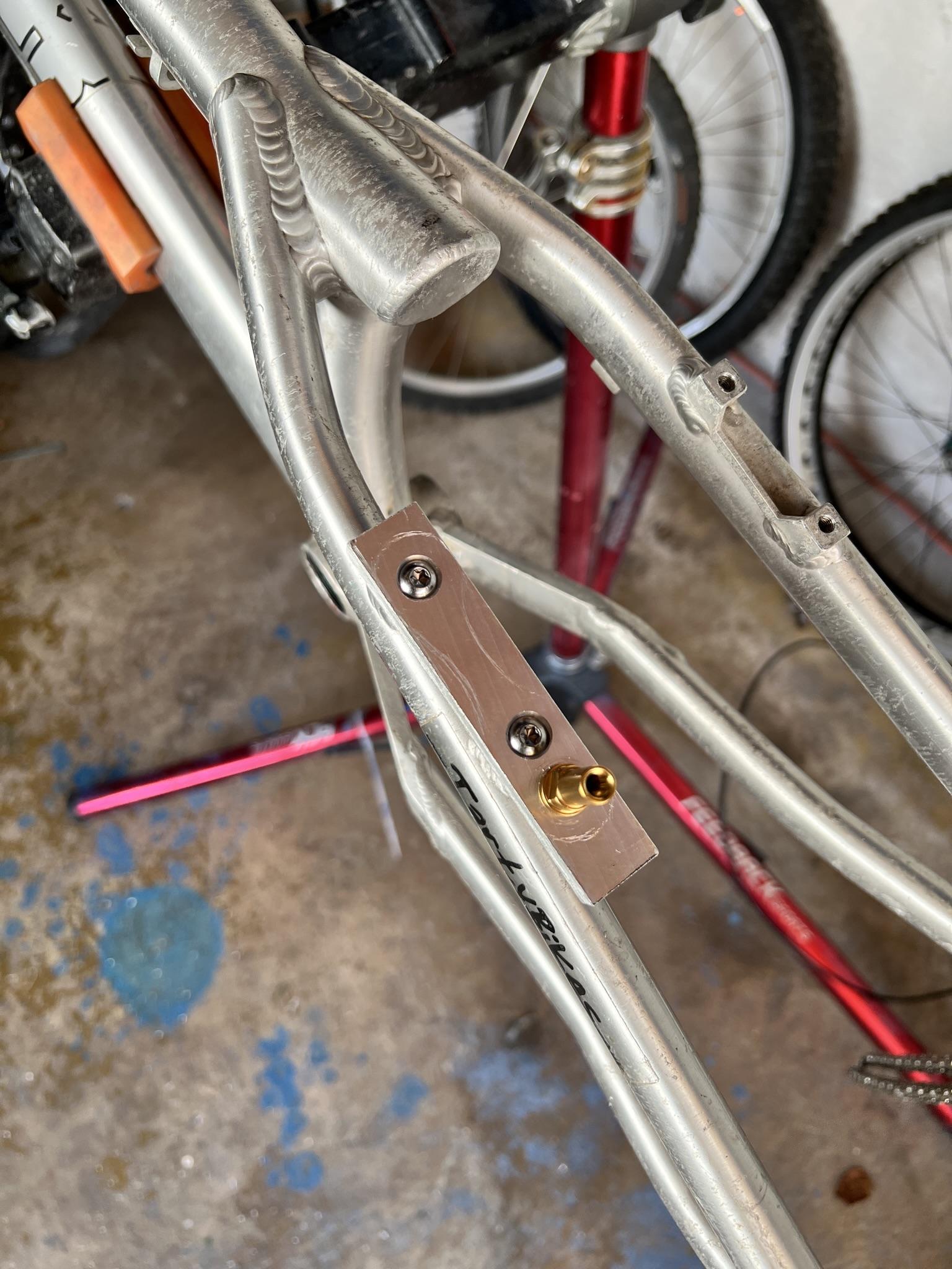

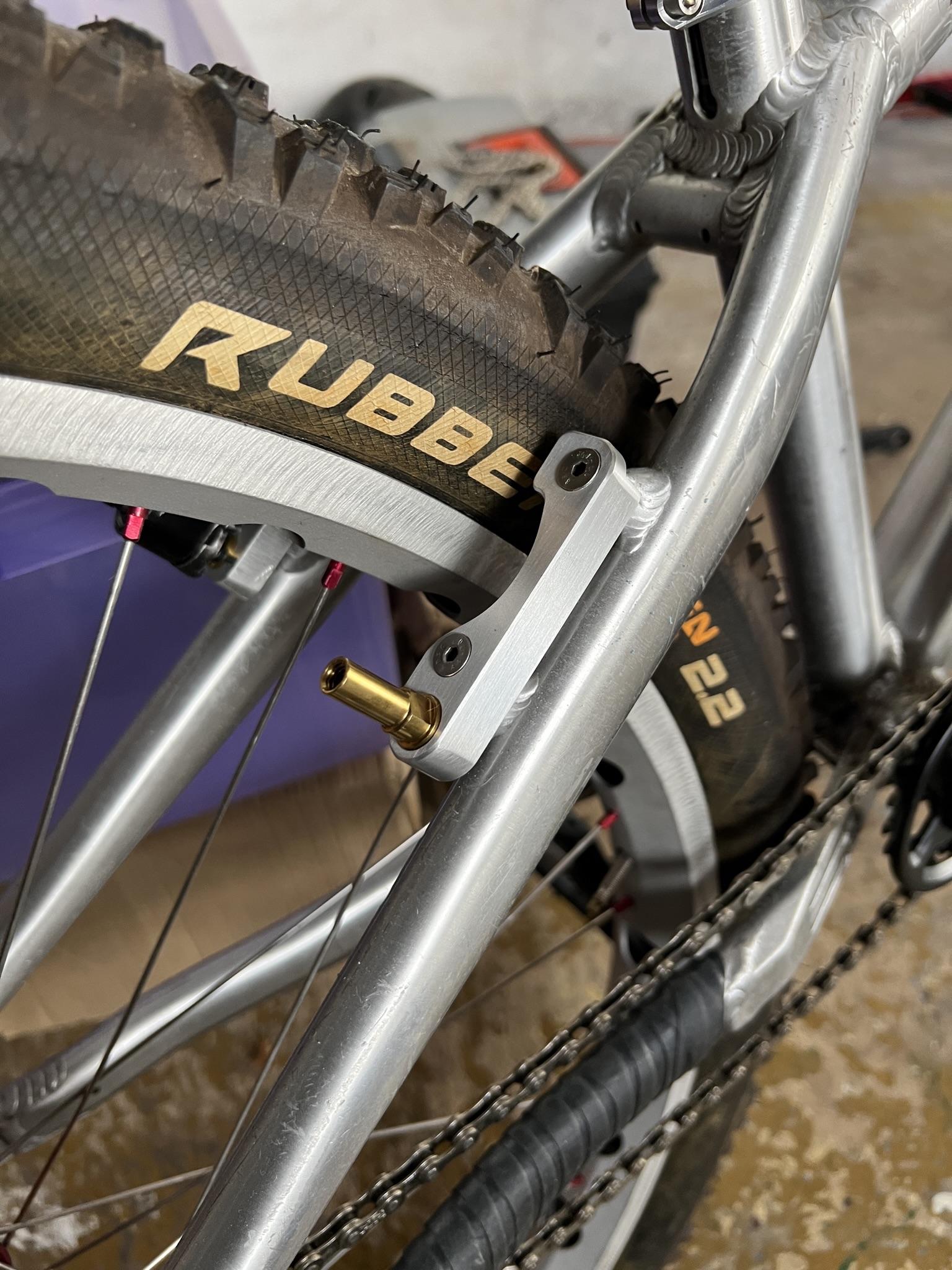

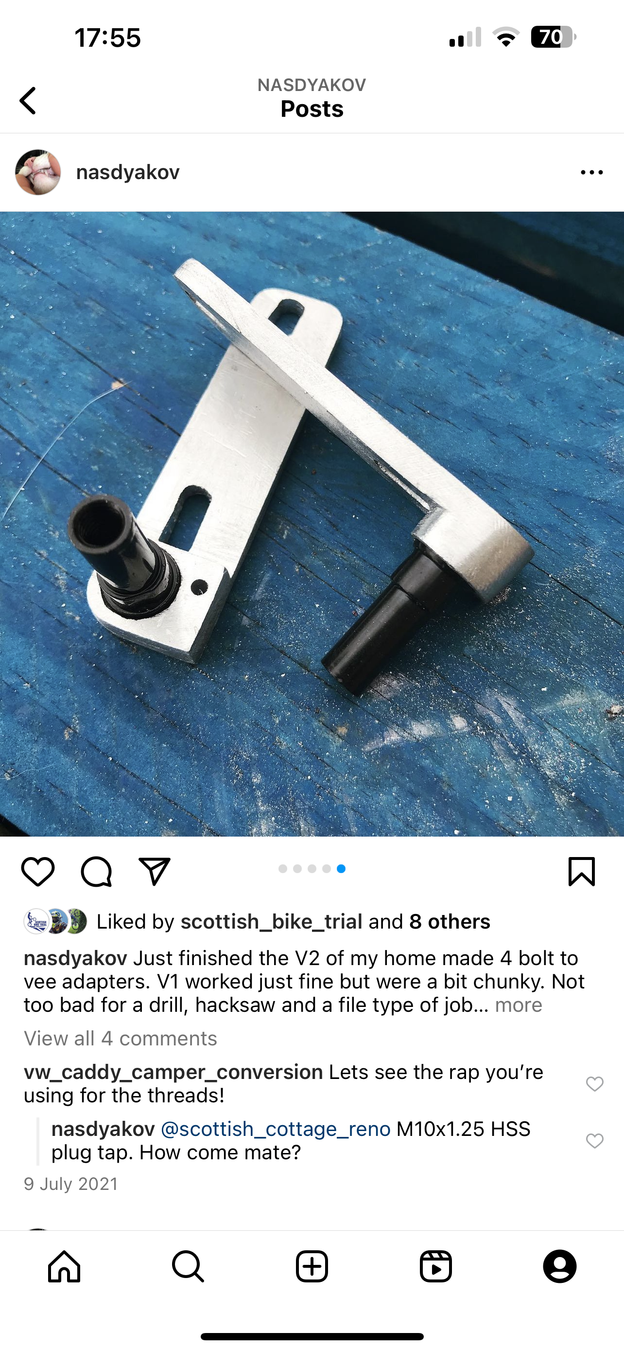

DYAKOV Posted June 23, 2023 Report Share Posted June 23, 2023 You can just make your own dude, there isn’t anything too complicated and you can play with the design (at your own risk, of course). I’ve made quite a few adapters and they’ve all worked pretty well. I’m sure you’ll figure out the dims but one tip from me is make sure you use a pillar drill! Are you based in the uk? I can post a piece of aluminium flat bar and bosses if that helps? Cheers, Nas 1 Quote Link to comment Share on other sites More sharing options...
Canardweb Posted June 23, 2023 Author Report Share Posted June 23, 2023 6 hours ago, DYAKOV said: You can just make your own dude, there isn’t anything too complicated and you can play with the design (at your own risk, of course). I’ve made quite a few adapters and they’ve all worked pretty well. I’m sure you’ll figure out the dims but one tip from me is make sure you use a pillar drill! Are you based in the uk? I can post a piece of aluminium flat bar and bosses if that helps? Cheers, Nas Wow that's awesome work. I live in France and don't have tools to make this kind of part right unfortunately. Quote Link to comment Share on other sites More sharing options...

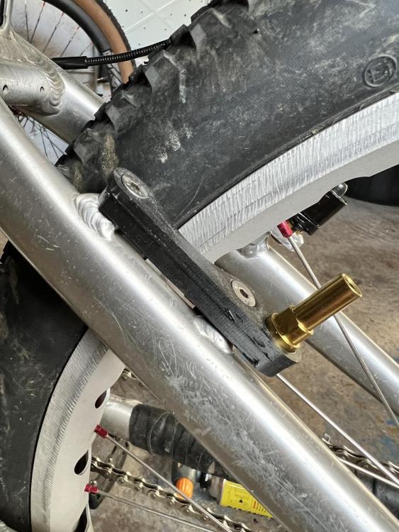

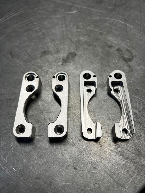

Ali C Posted June 24, 2023 Report Share Posted June 24, 2023 Another vote for making your own, I made some with nothing more than a hacksaw, vice, drill and tap. i tried a few designs and even 3D printed some other ideas until I found one that seemed to work really well. The shape wasn’t ideal to machine though so Euan Beadon helped adjust the design slightly and then machined a batch for me (thanks Euan!), annoyingly even though everything worked well in the 3D print there were some clearance issues with the alloy ones, a spacer under the post would fix it but I haven’t gotten round to doing that yet. Quote Link to comment Share on other sites More sharing options...
La Bourde Posted June 24, 2023 Report Share Posted June 24, 2023 Nice work Ali and Euan! I face also the same problem, I cannot find any adapter and that is why I continue to ride with a cracked one. I think the tangential force that the wheel applies was quite underestimated. One thing I am not sure about is whether the distance between the screw holes of the Magura mount of the same seatstay (this word does not make sens on a comp bike 😂) is the same across different frame/brand. I guess it should be, but the tolerance in MTB/trials are often quite bad. I never checked on my different bikes. The adapters I have are compatible with different lengths between the screw holes. And it is also possible to adjust angle that the adapter does with the seatstay. @Ali C a Levelboss and another Koxx frame (the streety one, right ?). Hope to see them soon in a vlog. Do you think it it possible to get some adapters from Euan? Quote Link to comment Share on other sites More sharing options...
Canardweb Posted June 24, 2023 Author Report Share Posted June 24, 2023 3 hours ago, Ali C said: Another vote for making your own, I made some with nothing more than a hacksaw, vice, drill and tap. i tried a few designs and even 3D printed some other ideas until I found one that seemed to work really well. The shape wasn’t ideal to machine though so Euan Beadon helped adjust the design slightly and then machined a batch for me (thanks Euan!), annoyingly even though everything worked well in the 3D print there were some clearance issues with the alloy ones, a spacer under the post would fix it but I haven’t gotten round to doing that yet. Well this is superb! I don't know anyone here that could machine anything like that. Could Euan make some more? I would pay for that! Quote Link to comment Share on other sites More sharing options...
Ali C Posted June 24, 2023 Report Share Posted June 24, 2023 3 hours ago, Canardweb said: Well this is superb! I don't know anyone here that could machine anything like that. Could Euan make some more? I would pay for that! It would need a slight revision before it’s ready to be used fully, I think I can’t get these to work but it wouldn’t be possible to sell them as-is Quote Link to comment Share on other sites More sharing options...
