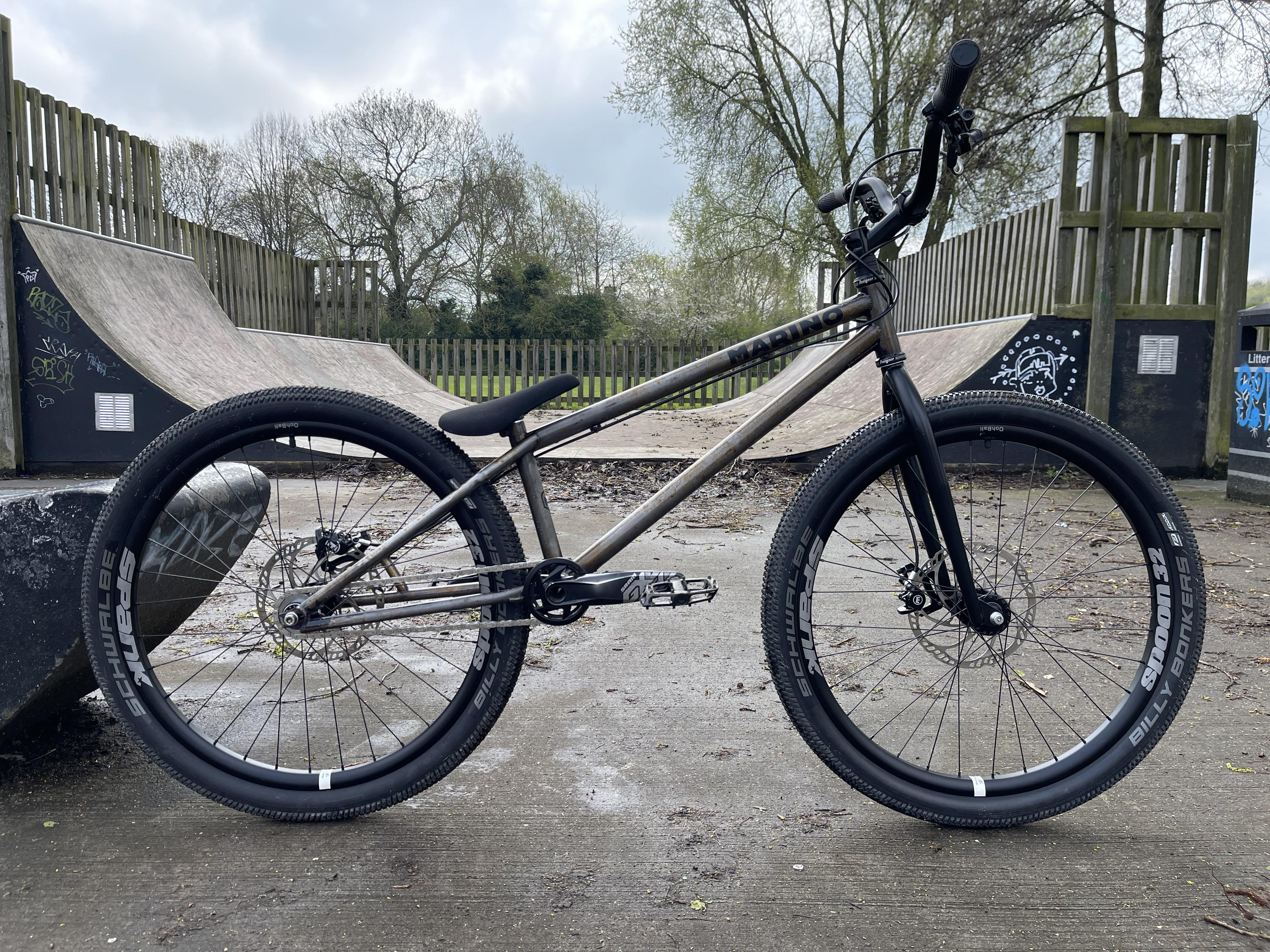

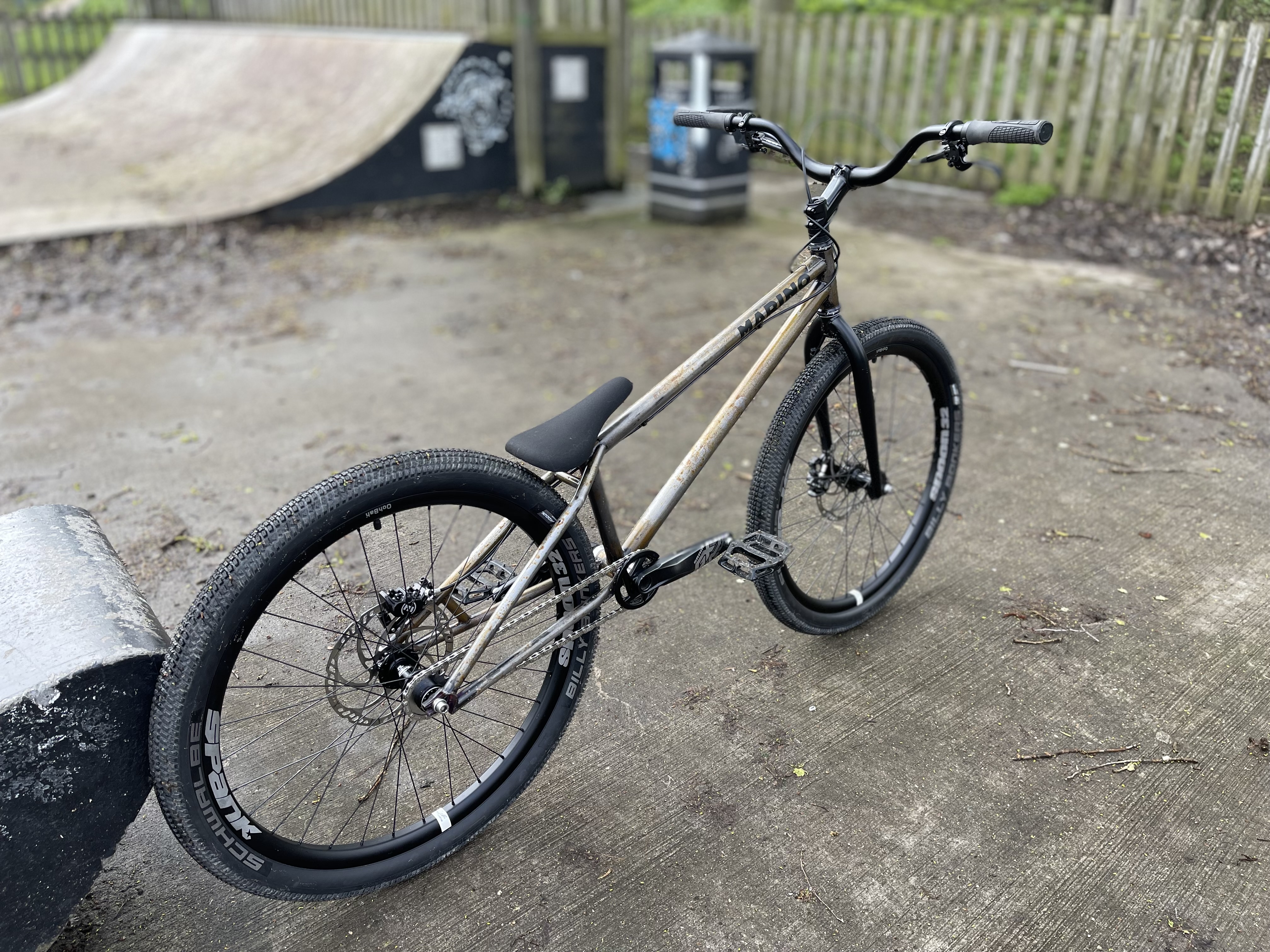

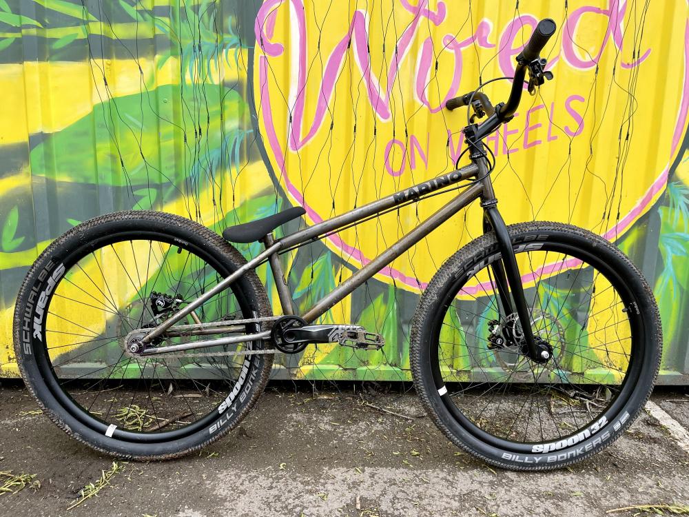

Marino 26 street build
Private Repress
Frame: Marino (based on early hex geo)
Fork: Marino
Headset: Hope
Stem: Wake 90x25
Bars: Arcade riser
Seat: inspired combo
Wheels: hope pro 2 ss on spank spoon 32s
Tyres: Billy Bonkers (decent compound)
Chain: KMC
Cranks: Sram GX
Cogs: inspired integrated bash and sprocket, gusset wide base on the rear - 22:17
Pedals: DMR v12 mk2
BB: custom stainless cups to convert from Spanish to BSA, running GXP bearings
Brakes: shigura - Shimano XT levers, MT5 calliper on the rear and MT4 up front both with standard pads and HC storm 203mm rotors
Grips: Ergon

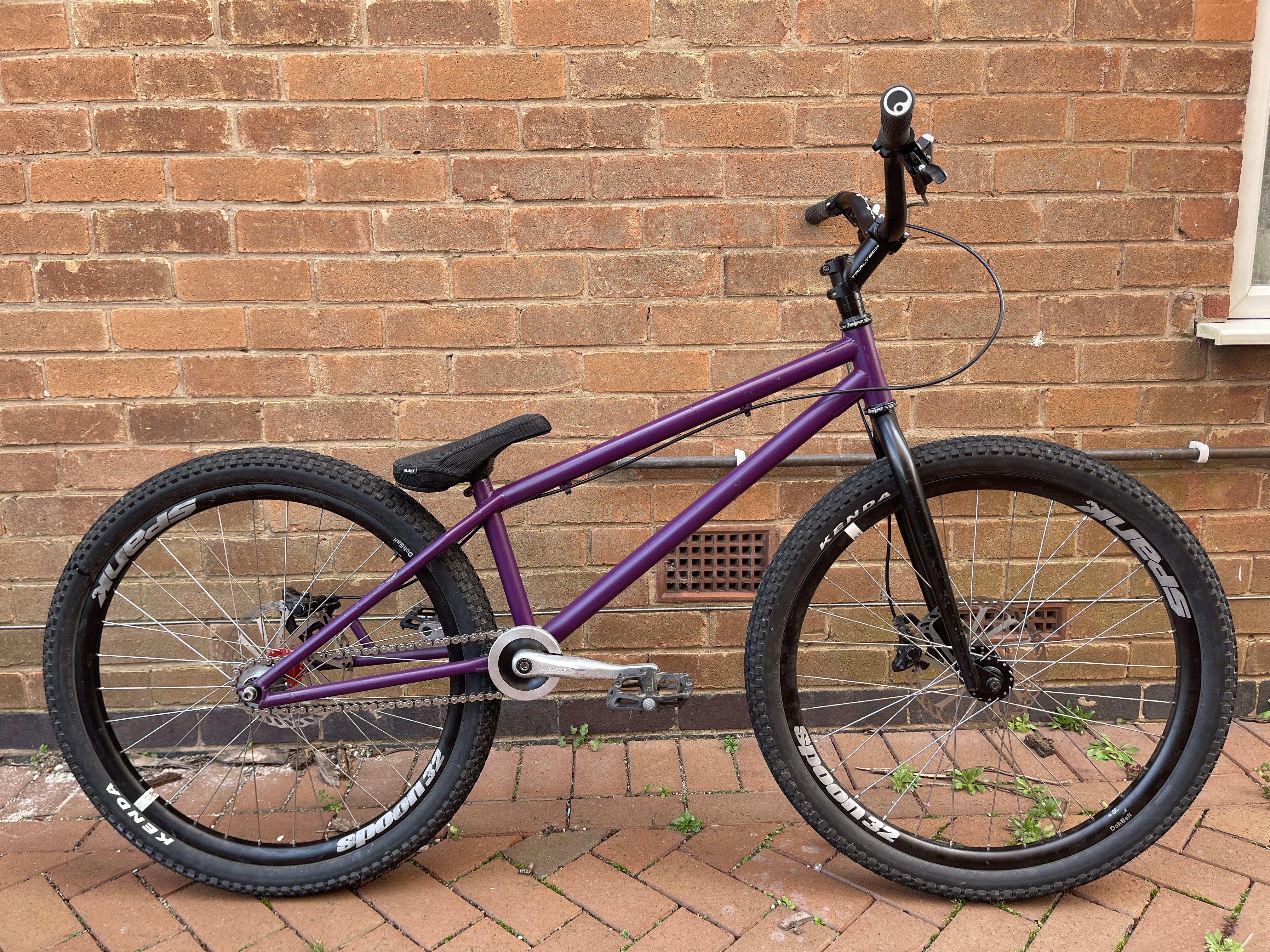

This is how it was when I got it:
