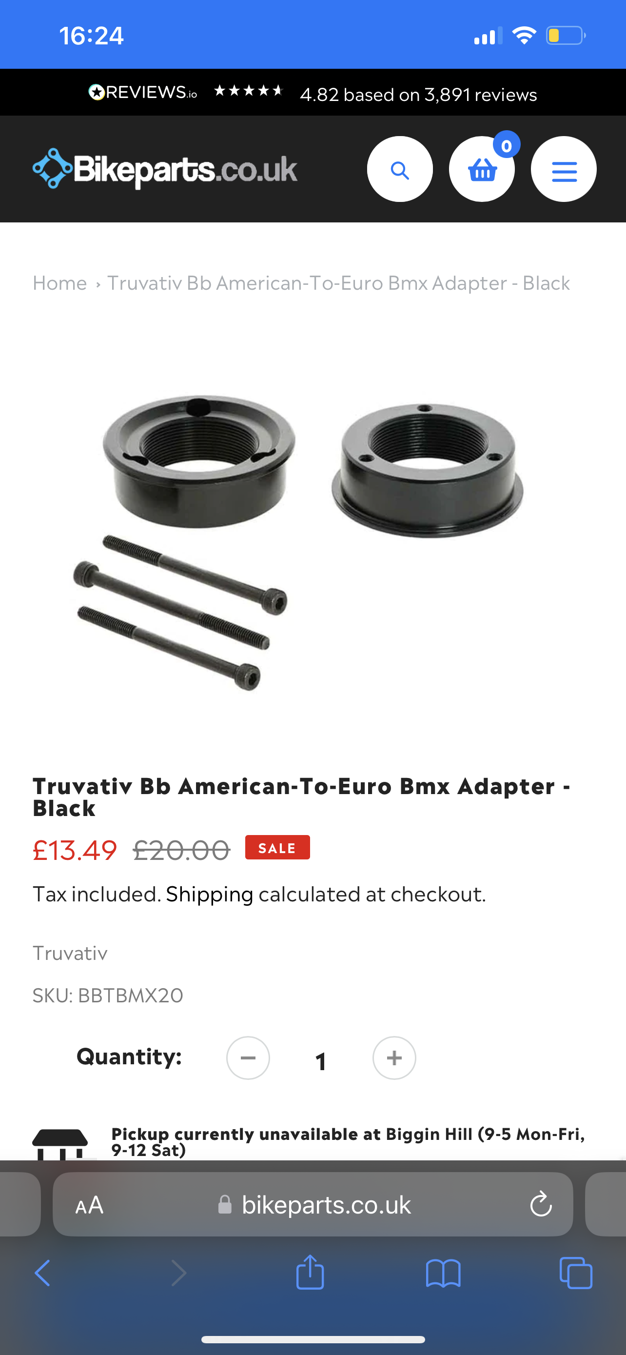

Private Repress Posted March 23, 2023 Report Share Posted March 23, 2023 Hi all, embarking on a new project and have hit a barrier. I’ve got a frame with a Spanish bb (37mm shell) I want to run Sram GX cranks with minimal fuss, these ones: Is there any adapter that exists so that I could simply run the external threaded sram gxp bb on the Spanish bb shell? I’ve seen @Swoofty YouTube guide, but that seems to be a case of replacing the bearings to a suitable size to fit the axel, then working out what spacers would need to be ran either side of the crank. Not sure the parts are easily available to achieve this in the uk. I spoke to Charlie at Tarty bikes that suggested this truvativ adapter, but it seems this is for the larger American bb? any help would be much appreciated Quote Link to comment Share on other sites More sharing options...
Mark W Posted March 23, 2023 Report Share Posted March 23, 2023 Unfortunately there's no adaptor for Spanish to BSA. BSA threads are a shade under 35mm, so there's basically not really the room within the shell to actually fit any kind of adaptor between the Spanish BB bearing race and the BSA cup. You could theoretically do what Swoofty said and just find bearings that have the right axle diameter, but from memory the GXP BB axles are stepped so you'd need a different size bearing for each one. I would have thought the chances of the bearing races on the axles lining up with an inboard-positioned BB would also be slim. If that's what Swoofty has managed then fair play to him! 1 Quote Link to comment Share on other sites More sharing options...
Private Repress Posted March 23, 2023 Author Report Share Posted March 23, 2023 Ah thanks @Mark W that makes perfect sense. I was thinking a press fit with the thread sitting outside of the frame, making it a 73mm shell. That said there’s only room for 2.5mm on each side to do that - bummer! looks like I’ll be sticking with a splined axel. unless there’s any decent trials alternative that fits a Spanish bb… Quote Link to comment Share on other sites More sharing options...

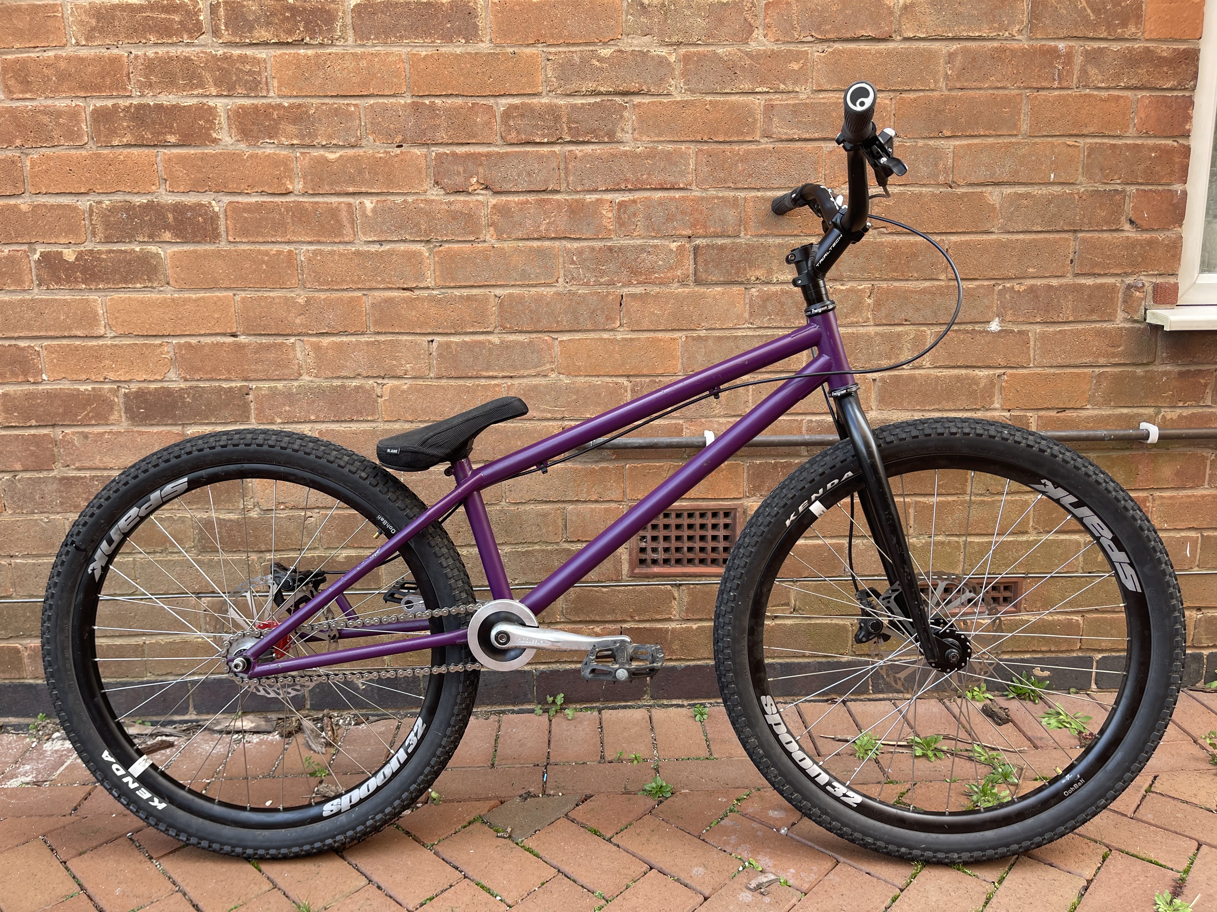

Private Repress Posted March 24, 2023 Author Report Share Posted March 24, 2023 (edited) Thanks @Mark W thankfully it came with the middleburns on; Edited March 24, 2023 by Private Repress Typo 2 Quote Link to comment Share on other sites More sharing options...
Swoofty Posted March 24, 2023 Report Share Posted March 24, 2023 Now that is a sweet lookin ride! Needs eeWings Quote Link to comment Share on other sites More sharing options...

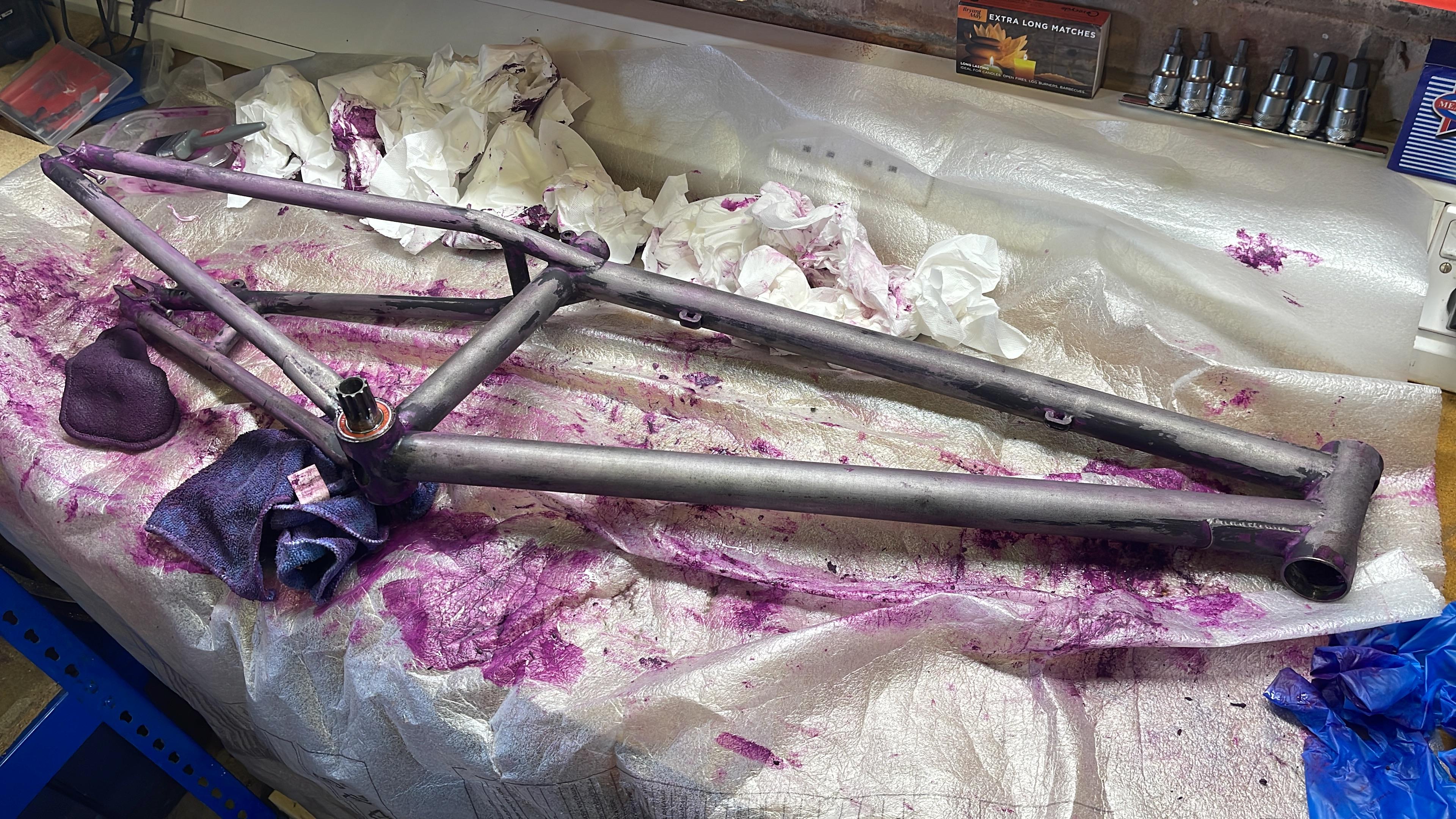

Private Repress Posted March 25, 2023 Author Report Share Posted March 25, 2023 4 hours ago, Swoofty said: Now that is a sweet lookin ride! Needs eeWings Haha! I’d still be stumped for a bash guard! The bike is getting a bit of an overhaul. Just rebuilt the back wheel onto a black Hope hub, new chain and a 17t sprocket ready and waiting. It came with Shimano XT brakes, and I happen to have a spare mt4 calliper and a spare MT5. So very likely I’ll be running shiguras. Oh and I’ve spent about 8hrs in total trying to remove the paint! slow progress, but I like to put my own stamp on a build. I’ll do a build thread once I get a bit more done 1 Quote Link to comment Share on other sites More sharing options...

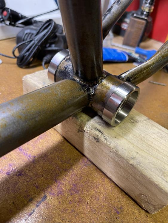

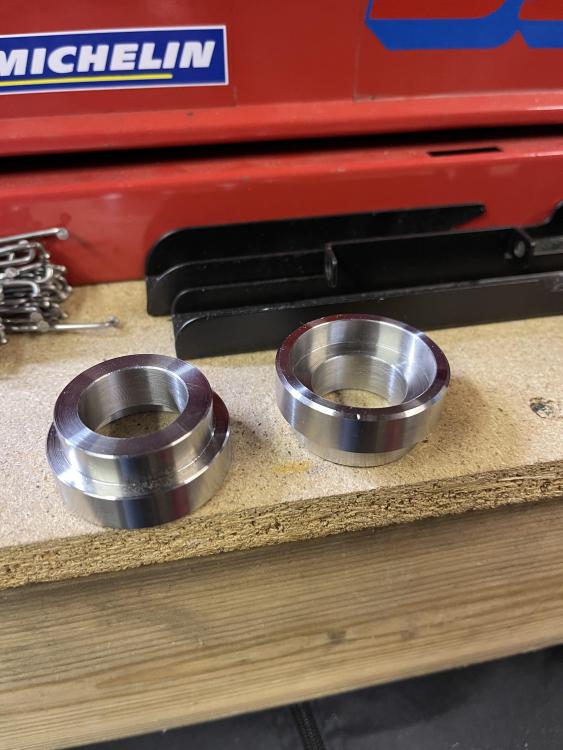

Private Repress Posted March 25, 2023 Author Report Share Posted March 25, 2023 @Mark W @Swoofty @La Bourde Right guys, I’m in the rabbit hole now. I figured some sort of custom push fit adapter could be made. Got talking to a mate who thinks he can do it on a lathe. Essentially it will be very similar to the racing line push fit cups (which I can’t find an anywhere in stock). I’ve ordered these bearings that are gxp bb replacement bearings. let’s see where this goes! Quote Link to comment Share on other sites More sharing options...
Mark W Posted March 26, 2023 Report Share Posted March 26, 2023 On 3/25/2023 at 1:18 AM, Private Repress said: Haha! I’d still be stumped for a bash guard! The Inspired Integrated bashrings fit them, plus you can get SRAM direct mount double spiders so you could run a 4-bolt bash and 4-bolt chainring if you were so inclined... 16 hours ago, Private Repress said: @Mark W @Swoofty @La Bourde Right guys, I’m in the rabbit hole now. I figured some sort of custom push fit adapter could be made. Got talking to a mate who thinks he can do it on a lathe. Essentially it will be very similar to the racing line push fit cups (which I can’t find an anywhere in stock). I’ve ordered these bearings that are gxp bb replacement bearings. let’s see where this goes! Are those bearings sized to fit straight inside the normal SRAM cups, so you'll basically just be pressing a sleeve into your BB that the bearings will then go into directly? I still don't really see how it all fits together properly in light of the non-drive bearing seat being way out of place if the bearings you're using are going to be within your BB shell (rather than being an external cup, where the inside edge of the bearing would be around 8-9mm further outboard than it will be if they're located inside the shell)... I know the drive-side bearing can pretty much go wherever on the axle as that's how they're designed to work - it's just the non-drive side, and getting things lined up properly I'm struggling to get an idea of. Intrigued to see how you get on though! Quote Link to comment Share on other sites More sharing options...
Private Repress Posted March 26, 2023 Author Report Share Posted March 26, 2023 @Mark W My thoughts are to machine external cups that house the new bearings, the cups will push fit into the Spanish bb shell. Machining the cups in theory should mean that I can position the new bearings exactly where they need to be in relation to the crank spindle. whether this will work, I’m not sure. the inspiration for this came from these, which are Spanish to BB30: 1 Quote Link to comment Share on other sites More sharing options...

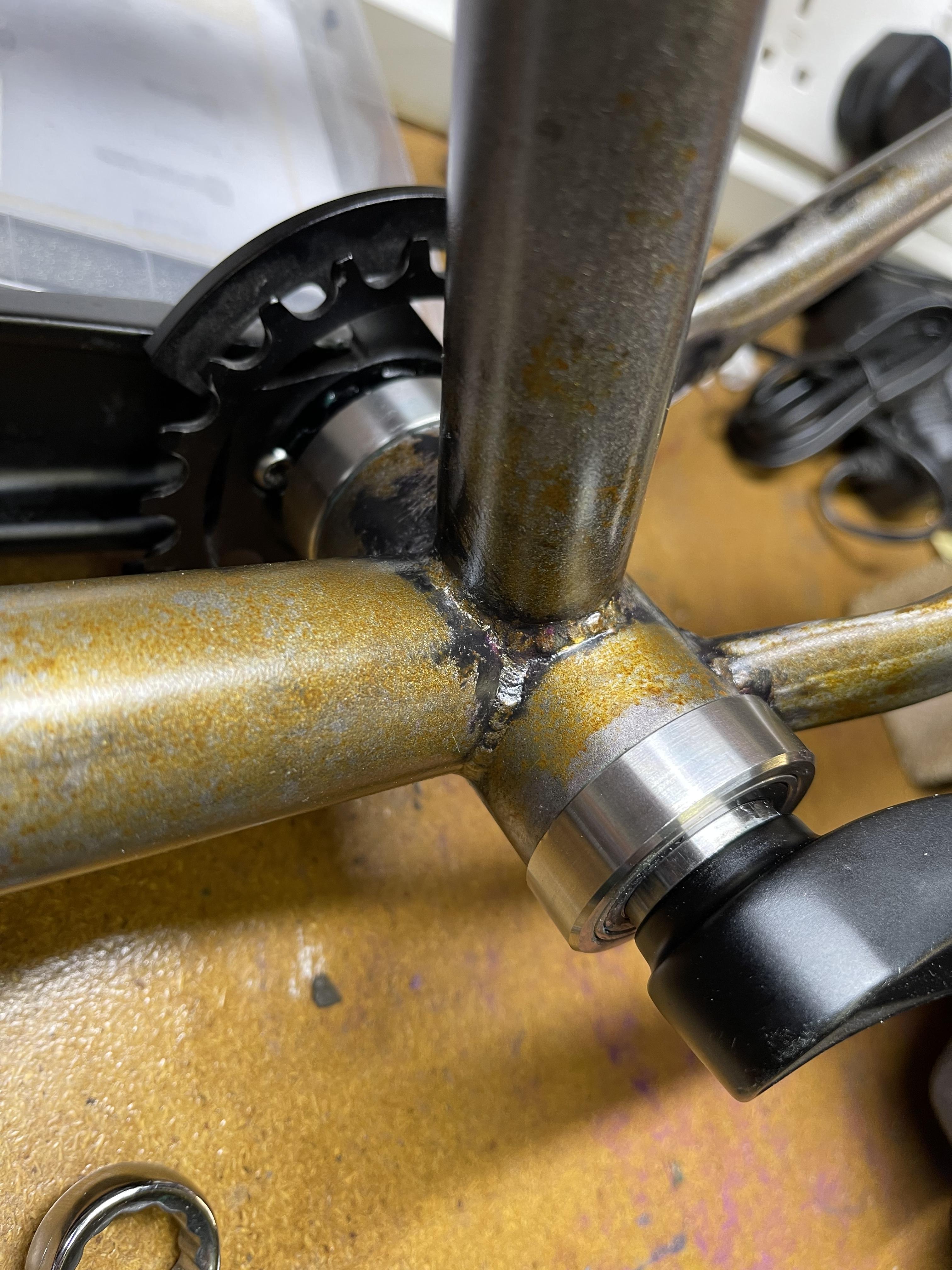

Private Repress Posted April 10, 2023 Author Report Share Posted April 10, 2023 @Swoofty @Mark W @La Bourde after a lot of measuring, and some amazing lathe work here is the finished product: I’m yet to build the whole bike up, but it feels good turning by hand, and I can’t feel any play (I’ll know immediately if there is any once I ride it). Super happy with how this ‘turned’ out 2 Quote Link to comment Share on other sites More sharing options...
Swoofty Posted April 10, 2023 Report Share Posted April 10, 2023 Well done! That looks great! What flavor aluminium did you use? 1 Quote Link to comment Share on other sites More sharing options...
Private Repress Posted April 11, 2023 Author Report Share Posted April 11, 2023 59 minutes ago, Swoofty said: Well done! That looks great! What flavor aluminium did you use? The heavy one, stainless steel haha 1 Quote Link to comment Share on other sites More sharing options...
Swoofty Posted April 11, 2023 Report Share Posted April 11, 2023 Oh right, steel frame. Good thing you're paying attention! 1 Quote Link to comment Share on other sites More sharing options...
Ross McArthur Posted April 11, 2023 Report Share Posted April 11, 2023 Excellent work Gav! Frame finish looks cool too. Duck, Duck, Goose!! 1 Quote Link to comment Share on other sites More sharing options...
Private Repress Posted April 11, 2023 Author Report Share Posted April 11, 2023 14 hours ago, Swoofty said: Oh right, steel frame. Good thing you're paying attention! @Swoofty To be fair, if I was being weight conscious I probably would have gone for aluminium and used a compound to prevent ceasing. But the stainless steel was readily available and didn’t cost me a penny (I’ve built several wheels for my mate so it was a favour). Thanks again for the pointers on this conversion and inspiring a solution! Quote Link to comment Share on other sites More sharing options...
