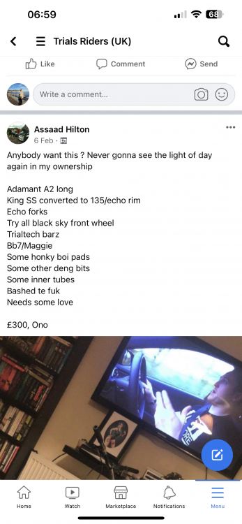

DYAKOV Posted February 18, 2023 Report Share Posted February 18, 2023 (edited) I remember that old BT Raven frames came with 1100wb but they seemed to be quite fragile.. Also adamant A2 had 1100wb and were solid as a trials frame can be but a bit on the heavy side (there’s currently a full adamant A2 selling on Facebook). They’d have a higher bb rise though. I can’t really think of a long trials frame with low bb… Edited February 18, 2023 by DYAKOV Quote Link to comment Share on other sites More sharing options...

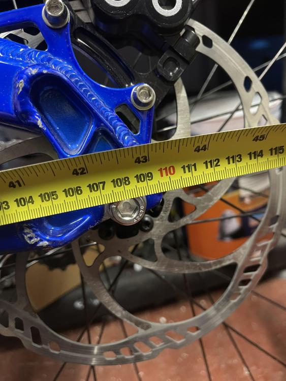

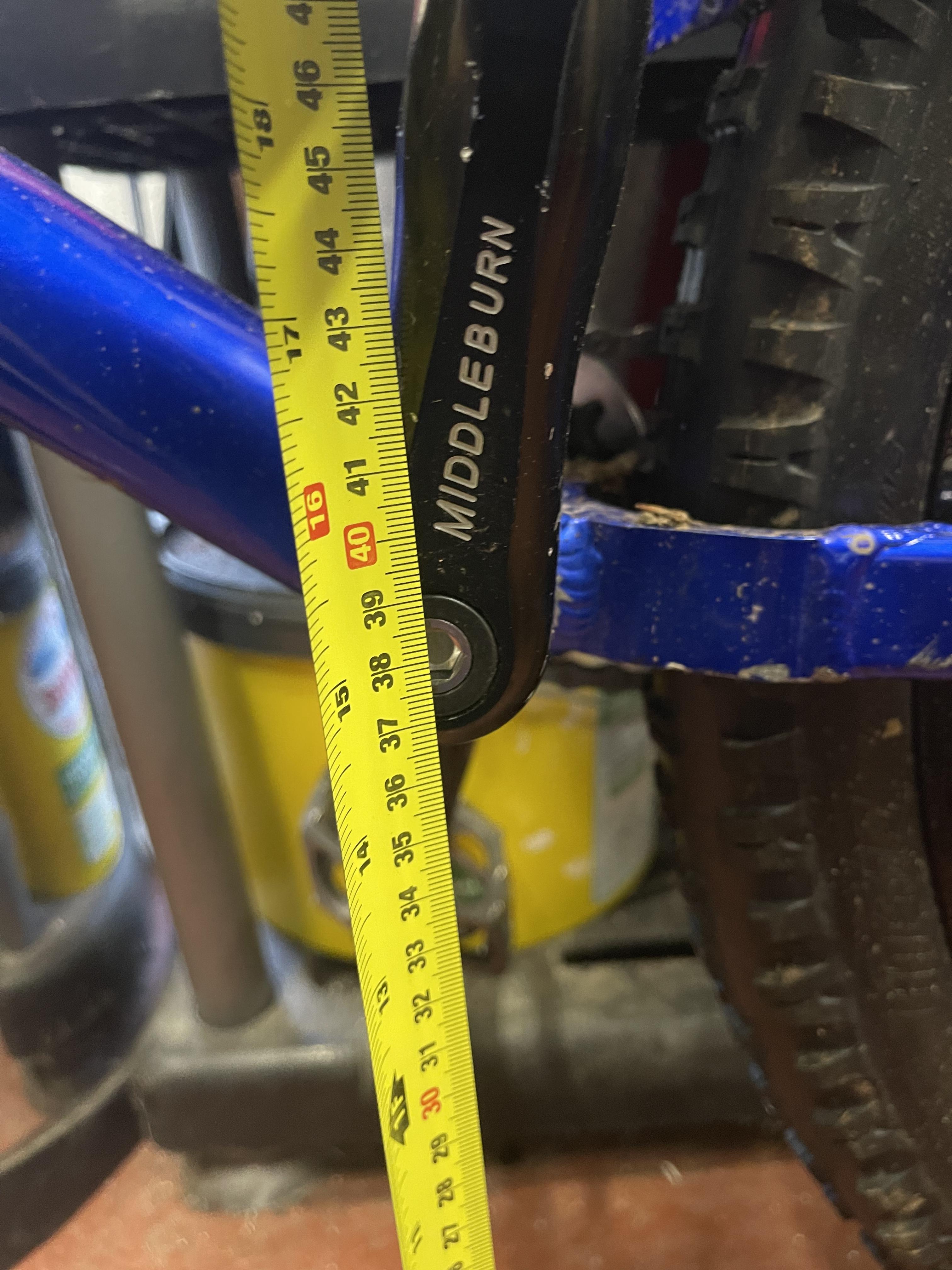

PLIW Posted February 19, 2023 Report Share Posted February 19, 2023 I’ll measure it this morning for you. I think the stem could be changed to improve and maybe the angle of the bars. Quote Link to comment Share on other sites More sharing options...

PLIW Posted February 21, 2023 Report Share Posted February 21, 2023 Wheel base and bb height. Quote Link to comment Share on other sites More sharing options...
