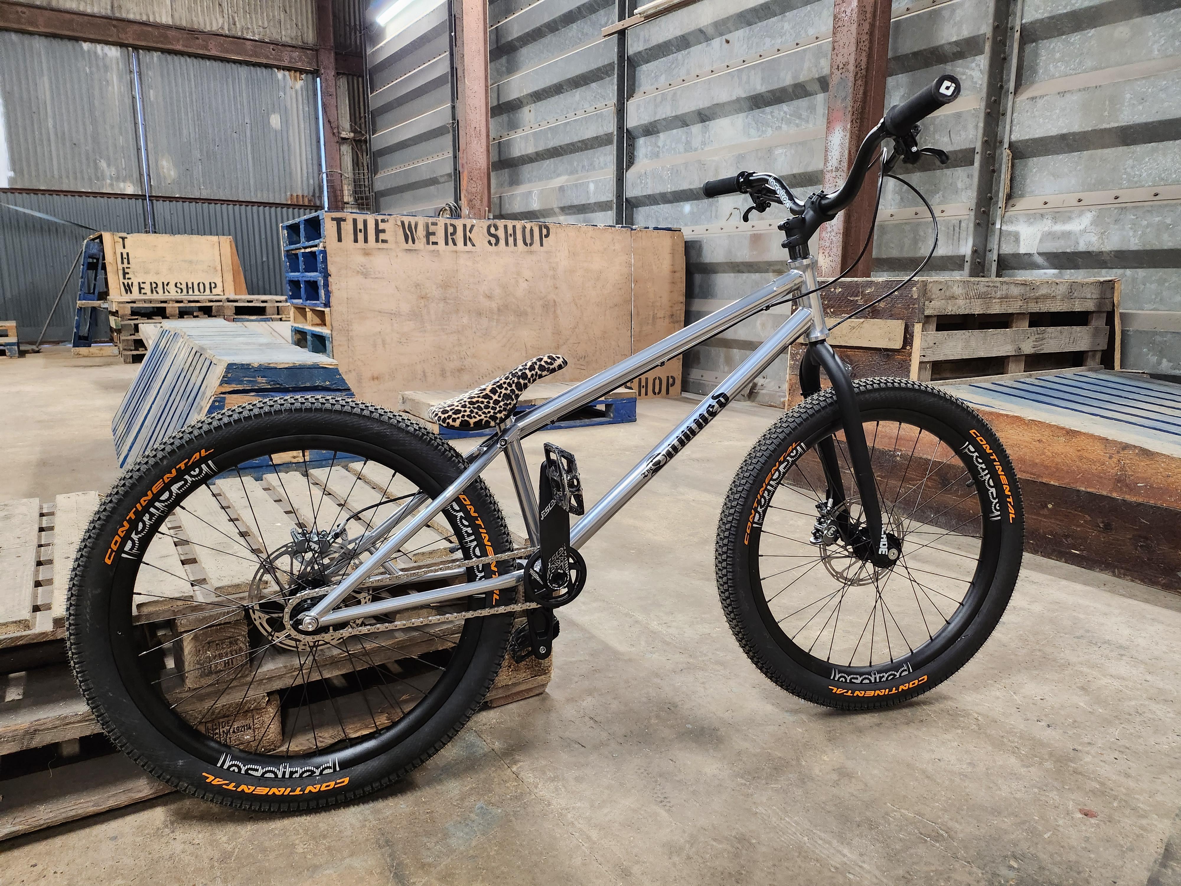

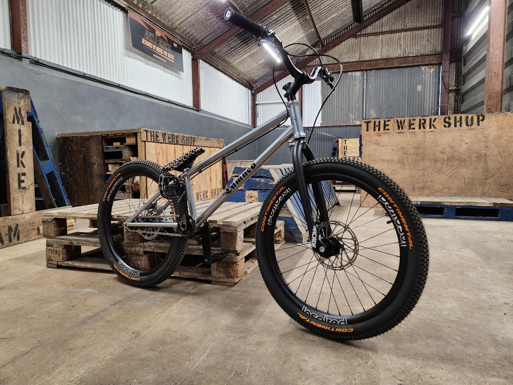

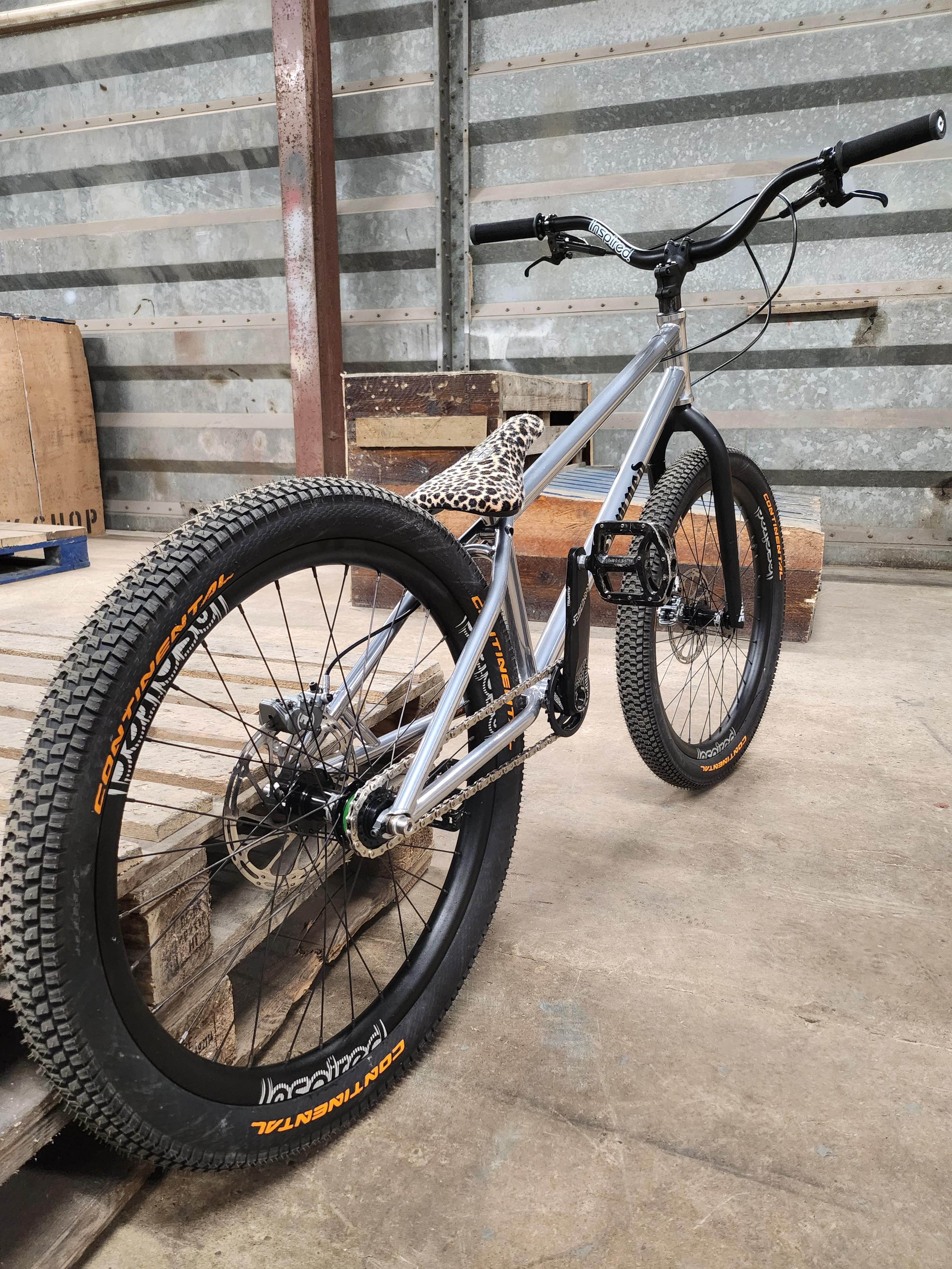

Matt24. Posted January 13, 2023 Report Share Posted January 13, 2023 I had avoided replacing a cracked dark chrome arcade I had bought second handed and been abused after not enjoying the last few years colours and trying a few different bikes. Ended up grabbing an fluro orange one and stripping and getting a chrome powder coat. I can't get away from the fact that 24" steel is in my blood after years on a 24" lesson in my Hey day. Pretty standard build apart from shigura brakes - xt levers on mt7 calipers, some descendant cranks and a good old leopard print bone deth seat (I had one of these on my leeson and after seeing them back in production couldn't help myself) had a ride, feels like home, and I like the way it's turned out.. 11 Quote Link to comment Share on other sites More sharing options...
The Dark Knight Posted January 15, 2023 Report Share Posted January 15, 2023 Nice, not so keen on the seat but each your own Quote Link to comment Share on other sites More sharing options...
DJEHB Posted January 15, 2023 Report Share Posted January 15, 2023 Absolute beauty that Matt Quote Link to comment Share on other sites More sharing options...
AdamR28 Posted January 15, 2023 Report Share Posted January 15, 2023 Looking good. And I think the seat works too! If you want to neaten up the rear hose routing, the banjo bolt can be loosened (a tiny amount) to allow it to be rotated. Its sealed with o rings so no risk of fluid loss or need to rebleed 2 Quote Link to comment Share on other sites More sharing options...
Maintenance Justice Posted January 15, 2023 Report Share Posted January 15, 2023 Nice work. Like the seat, kinda got a 90’s DJ vibe about it Quote Link to comment Share on other sites More sharing options...
Matt24. Posted January 15, 2023 Author Report Share Posted January 15, 2023 Thanks for the comments. I knew the seat would divide, however I had a mild obsession with Sean Burns / Jimmy Levan, Metal Bikes and Bone Deth in my early 20s which meant animal print featured promenantly on bikes and wardrobe so makes me smile whenever I see it! 3 Quote Link to comment Share on other sites More sharing options...
Ross McArthur Posted January 16, 2023 Report Share Posted January 16, 2023 Very nice. From what ive heard, Inspired have been trying to pull off a chrome finish for a while but never pulled the plug. I think it looks great! Adding graphics to break it up helps. Quote Link to comment Share on other sites More sharing options...
Mark W Posted January 16, 2023 Report Share Posted January 16, 2023 On 1/13/2023 at 8:34 PM, Matt24. said: Ended up grabbing an fluro orange one... Here's an orange Arcade for you @javimic Bike looks sweet, Matt! Good choice on the colour. Looks like a great finish for not being 'actual' chrome. Hope you enjoy it! Quote Link to comment Share on other sites More sharing options...
javimic Posted January 20, 2023 Report Share Posted January 20, 2023 On 1/16/2023 at 7:10 AM, Mark W said: Here's an orange Arcade for you @javimic Thanks dude, I was already suffering too much. This could be a reason why we don't see Arcade 2022 on the streets... The owners polish the frames lol. And to Matt, congrats on this austere but amazing whip with a controversial seat. 1 Quote Link to comment Share on other sites More sharing options...
Matt24. Posted January 21, 2023 Author Report Share Posted January 21, 2023 Thanks all, yeah I wasn't sure how well the powder coat would come out but pleased with it. YThe damned graphic is also a nod back to my old Leeson which had a damned sticker on it as was very into them and had a bunch of their stickers in my early 20s so throw one on the leeson. Just a shame @Mark W I haven't got a clean sticker to go on the headtube like my leeson ;-). Quote Link to comment Share on other sites More sharing options...

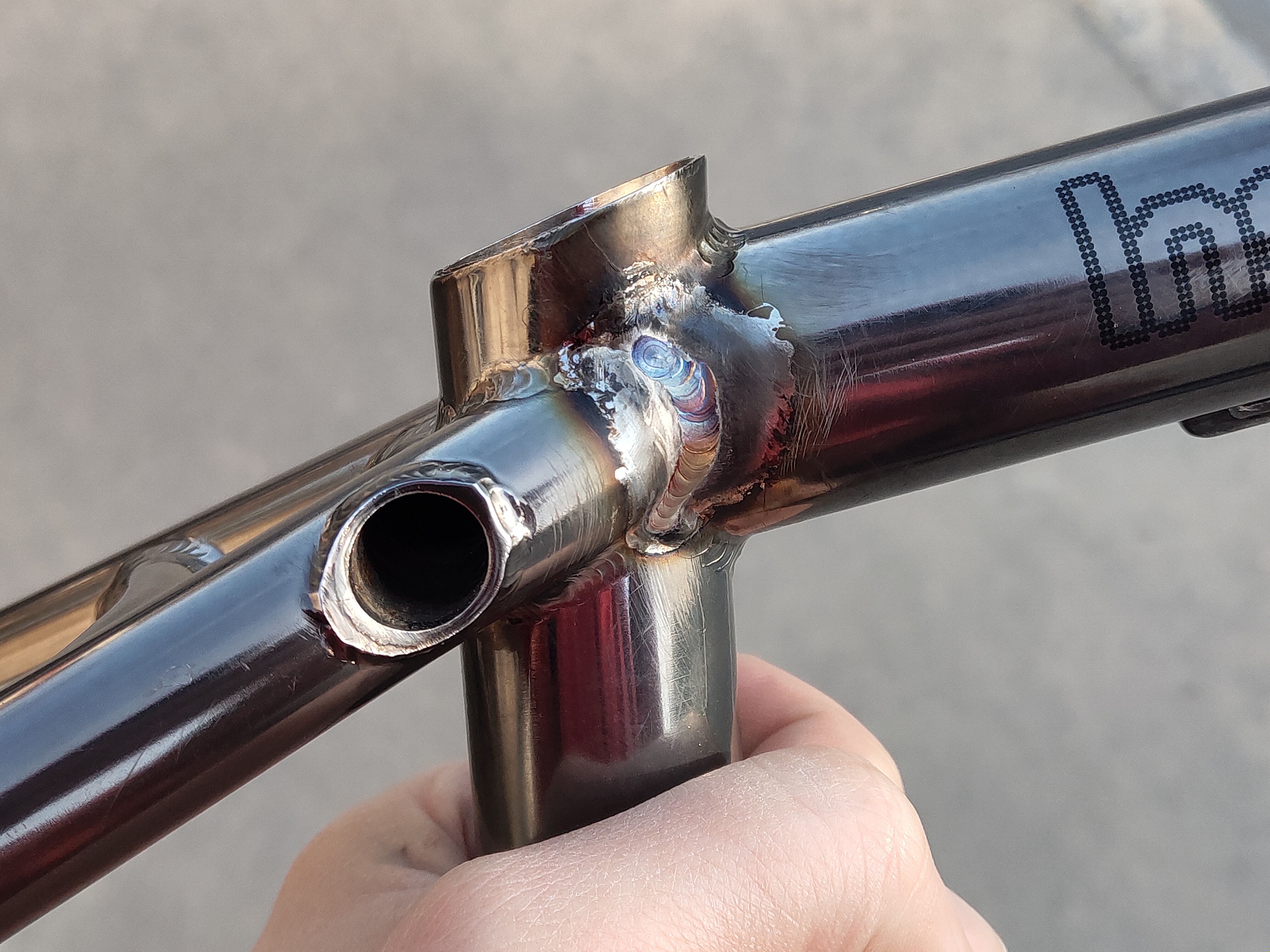

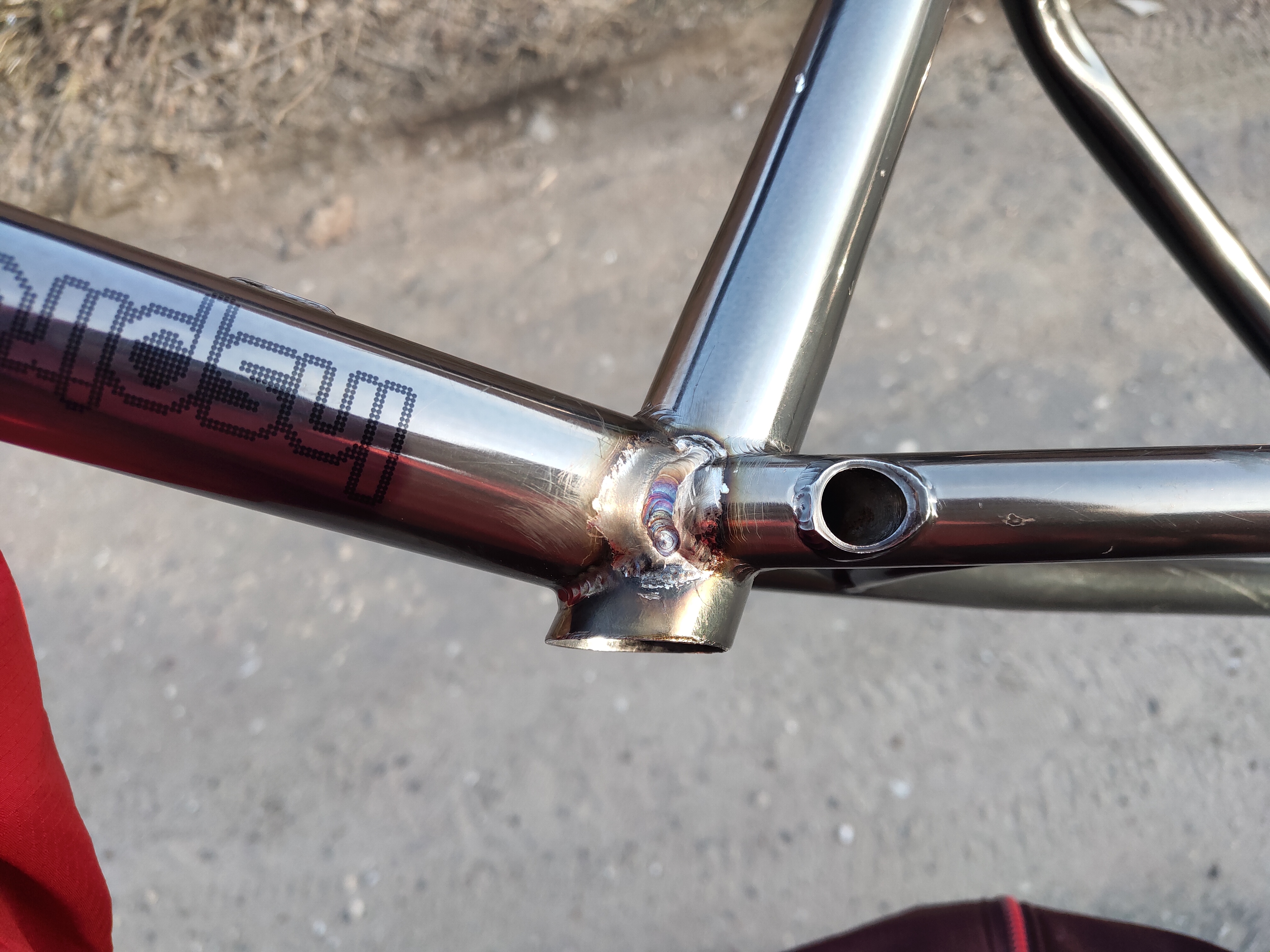

infectedbear Posted April 14, 2023 Report Share Posted April 14, 2023 Hello. Looks like I got your old Arcade frame. Could you tell me please, does it have 1 crack on one side or 2 cracks on both sides of the frame? I wonna weld it tomorrow. Sorry for my english. Thanks. Quote Link to comment Share on other sites More sharing options...
Matt24. Posted April 15, 2023 Author Report Share Posted April 15, 2023 On 4/14/2023 at 5:55 PM, infectedbear said: Hello. Looks like I got your old Arcade frame. Could you tell me please, does it have 1 crack on one side or 2 cracks on both sides of the frame? I wonna weld it tomorrow. Sorry for my english. Thanks. Hey, good luck with it. So I think it was both sides but they weren't very developed so hard to see. I wasn't 100% sure they were both cracks, could have just been stress in the paint but if you are doing it worth doing both sides. Hope you enjoy it 🙂 Quote Link to comment Share on other sites More sharing options...
infectedbear Posted April 16, 2023 Report Share Posted April 16, 2023 4 hours ago, Matt24. said: Hey, good luck with it. So I think it was both sides but they weren't very developed so hard to see. I wasn't 100% sure they were both cracks, could have just been stress in the paint but if you are doing it worth doing both sides. Hope you enjoy it 🙂 So, 2 cranks. Second one was veeeery small. Thanks for the frame P.S. My friend has ~2013 arcade frame in garage (with cracked brakemount and seatpost). Compared them. Older one is for about 5-7mm shorter (shorter frontend). Just a fun fact. Quote Link to comment Share on other sites More sharing options...
Matt24. Posted April 16, 2023 Author Report Share Posted April 16, 2023 @infectedbear Nice. Looks like a neat job. Have fun with it 🙂 Quote Link to comment Share on other sites More sharing options...
Mark W Posted April 17, 2023 Report Share Posted April 17, 2023 On 4/16/2023 at 1:10 AM, infectedbear said: P.S. My friend has ~2013 arcade frame in garage (with cracked brakemount and seatpost). Compared them. Older one is for about 5-7mm shorter (shorter frontend). Just a fun fact. Out of interest, how are you measuring that? If it's the normal trials reach measurement, the Arcade you've got there has a much longer head tube than the older one which will skew things a bit. Quote Link to comment Share on other sites More sharing options...
infectedbear Posted April 17, 2023 Report Share Posted April 17, 2023 12 hours ago, Mark W said: Out of interest, how are you measuring that? If it's the normal trials reach measurement, the Arcade you've got there has a much longer head tube than the older one which will skew things a bit. I had both frames in my hands. Fixed bottom bracket and rear end on the welding table. I didn't measure the reach, just seen the difference in the length of the front triangle (headtube axle was moved 5-7mm forward in 19 arcade). In this case Arcade with wishbones was shrorter. 2 Quote Link to comment Share on other sites More sharing options...
