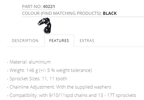

I am planning on running this on my street trials hardtail as this is one of the only decent chain tensioners available right now.
Colab Chain Tensioner | Reverse Components (reverse-components.com)
The only challenge I see is that they specify running these with multispeed chains whereas I was going to go singlespeed chain
And it shows the sprocket compatibility of 13-17, but I was going to run it with 18T in the back.
Do you think I would be able to run this with an 18T sprocket in the back?

Probably not. As Craig said, the issue you're likely to encounter is the top jockey wheel. I can't remember which brand it was (maybe Trialtech), but a while back a company offered their tensioners in 'Short' and 'Long' versions. The Long version is basically what you can see with the latest gen Trialtech tensioners where the main tensioner arm is fairly long, and allows you to run larger sprockets. The Short version had a stubby tensioner arm similar to that Reverse tensioner, and the sprocket range was basically the same as the one Reverse mention there.

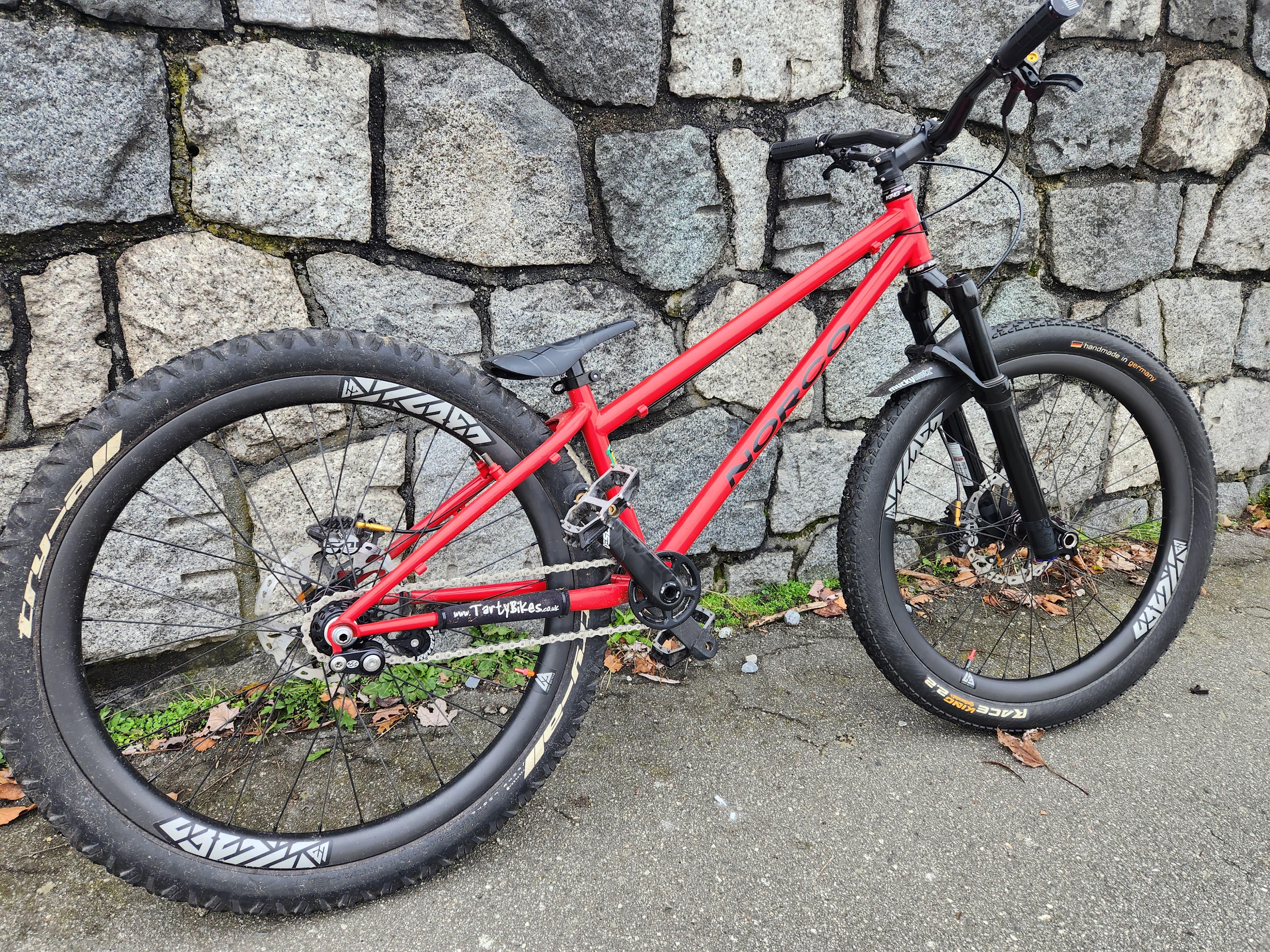

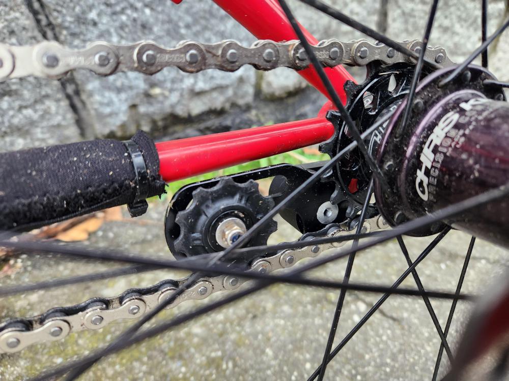

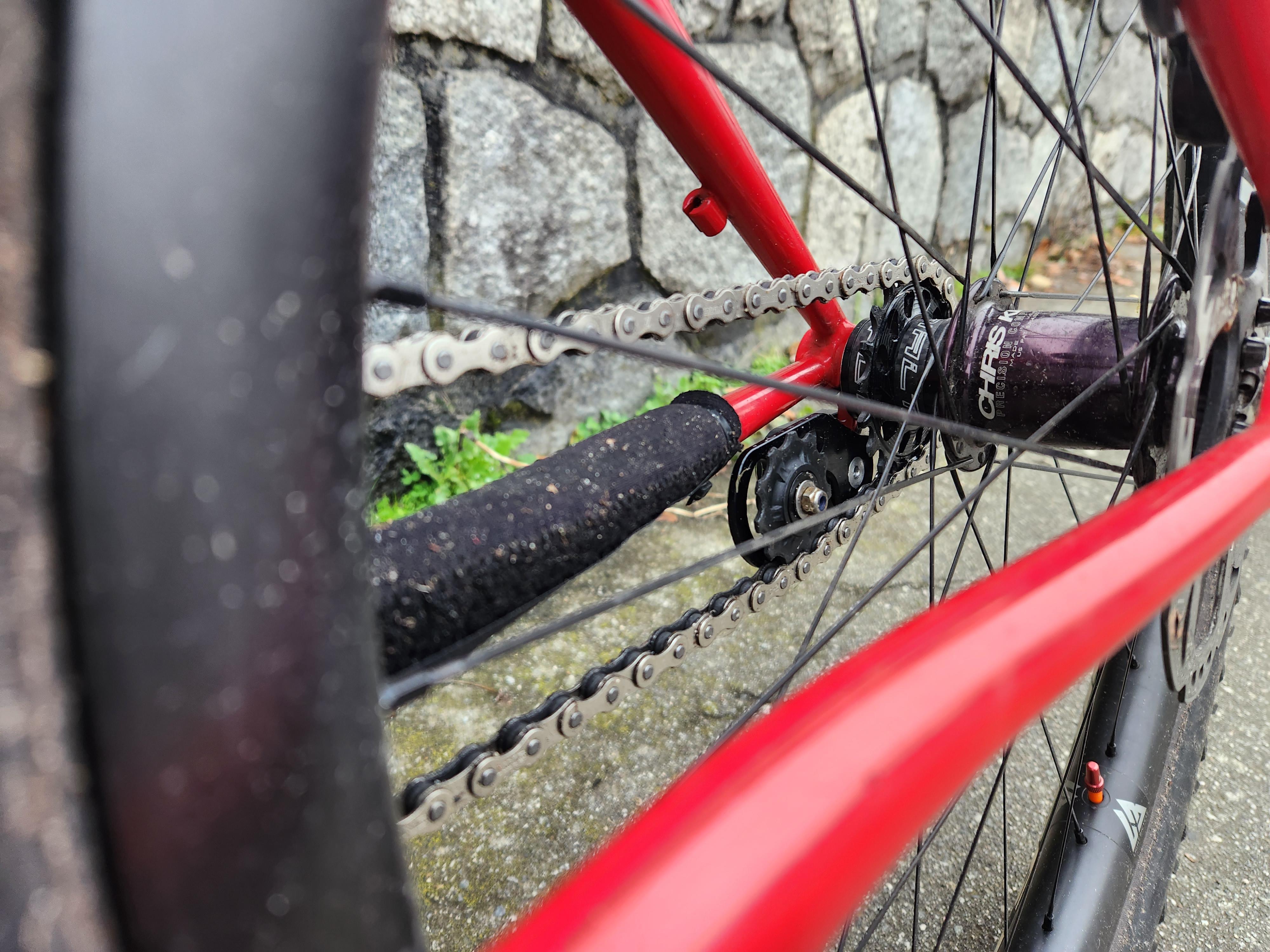

The manufacturer is right. The 18T will not fit with this chain tensioner.
But with some modding, it can work.
I took out the roller first roller for the chain wrap since there is enough chain wrap. So I am only using the downward tension.
With this set up, it is woring beutifully.
  • Like 2

On 1/30/2023 at 3:14 AM, Mark W said:
Holy smokes that back tyre looks meaty, haha. Think it's the rim that really makes it look chunkier.
Glad you got the tensioner to work one way or another (Y)
