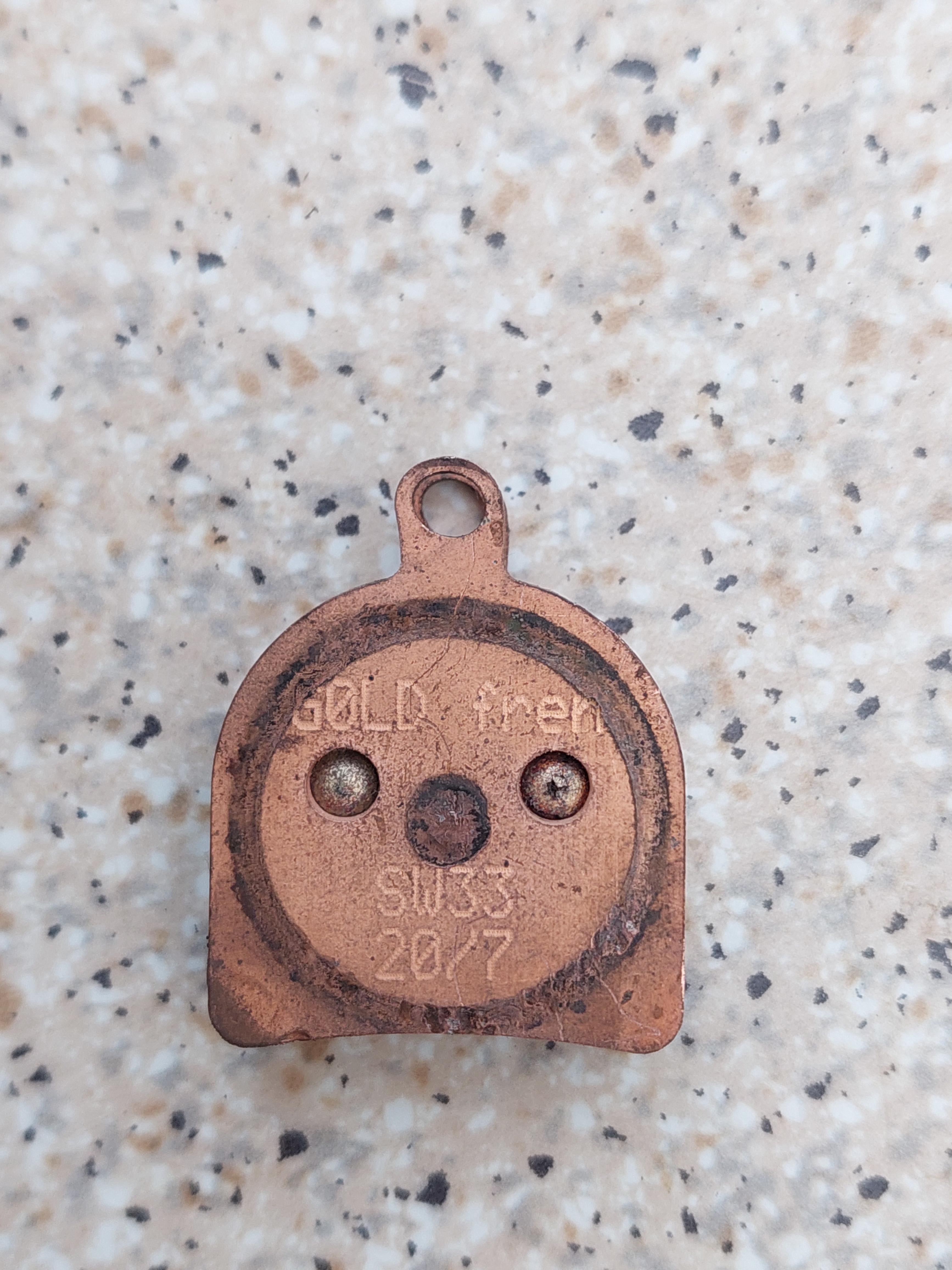

bjap2022 Posted December 14, 2022 Author Report Share Posted December 14, 2022 I checked out the pads (Trialtech Sport) and its clear the piston has bedded into the rear of the pad.... + No paint to sand! Doesn't appear as though the wear mark is in anyway highlighting that the pad is moving over the piston. Squinting with a fine eye, it may appear the wear "circle" of the piston is ever so slightly asymmetrical perhaps. In that respect, the top loop definitely appears asymmetrical though suggesting movement in some way within the calliper. Quote Link to comment Share on other sites More sharing options...
AdamR28 Posted December 15, 2022 Report Share Posted December 15, 2022 Hmm. Looks a bit grubby. The circle should be bright and shiny. I'd give the back of the pad a clean and a sand, and degrease inside the caliper carefully. Quote Link to comment Share on other sites More sharing options...
