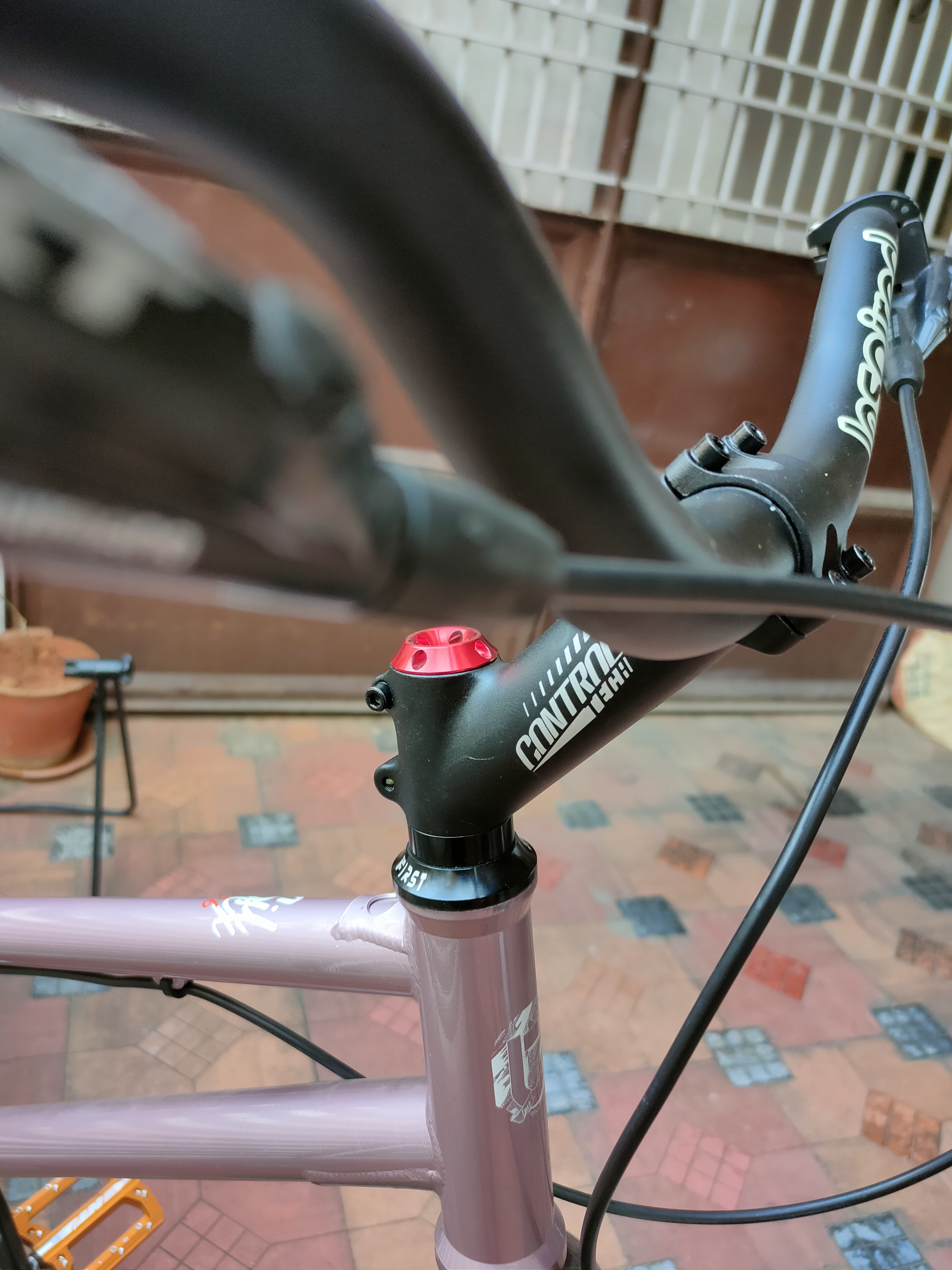

Tharun Shiv Posted April 16, 2023 Report Share Posted April 16, 2023 On 3/29/2023 at 10:40 AM, Daan said: Haha yeah, with the 110 it's certainly high One ride with the 90, and all feels very familiar again. Though my riding has absolutely suffered from that wrist breakage, not that I feel it much or think about it while doing a move, but the flow and the bit of suppleness that I had are just not there. Frustrating! Expand Update on the stem situation! I wanted more height and couldn't stack more than 2 spacers due to the forks coming pre-cut stock, so i got a 120×40° giving me the height of a 130mm and reach of a 110mm stem and i took the current spacers off and reduced it to one so now it acts as a 110×35° stem so no worries about the steerer tube being pre-cut either, now the bike feels just right and much more comfortable, gotta go on a proper ride tomorrow to actually see how it feels! Bonus points the stem i got from control-tech is lighter than the 90mm trial-tech but I'm unsure about the strength as it's not a trials specific brand but we'll see how it goes in the future haha (nervous laughter) Quote Link to comment Share on other sites More sharing options...

Tharun Shiv Posted April 19, 2023 Report Share Posted April 19, 2023 (edited) On 4/19/2023 at 5:43 AM, Daan said: @Tharun Shiv 120 mm, dude, there goes your street cred! But if it rides well, it rides well; curious to hear how you get on. And just keep an eye out for cracks I reckon I've found the sweet spot with the 90 mm, also don't want to be changing stems much with the brake hose routed through the fork haha. Expand Technically 110×35° hahah, but i did ride throughout the week and the bike just feels perfect, more rear wheel × front wheel control and the height makes the bike feel much more familiar to me so i think I'm gonna stick to this, the stem feels pretty solid too! Forgot to add this, surprisingly the spinny moves feel easier too maybe it's because of the height.. Edited April 19, 2023 by Tharun Shiv Quote Link to comment Share on other sites More sharing options...
