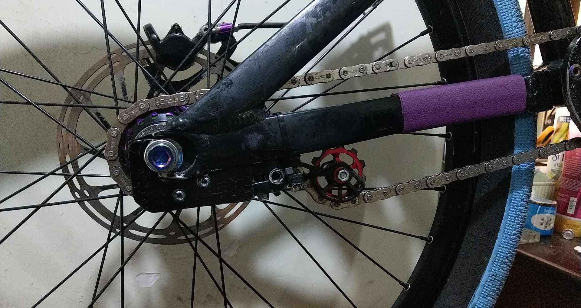

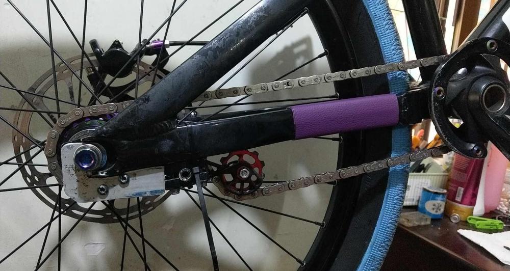

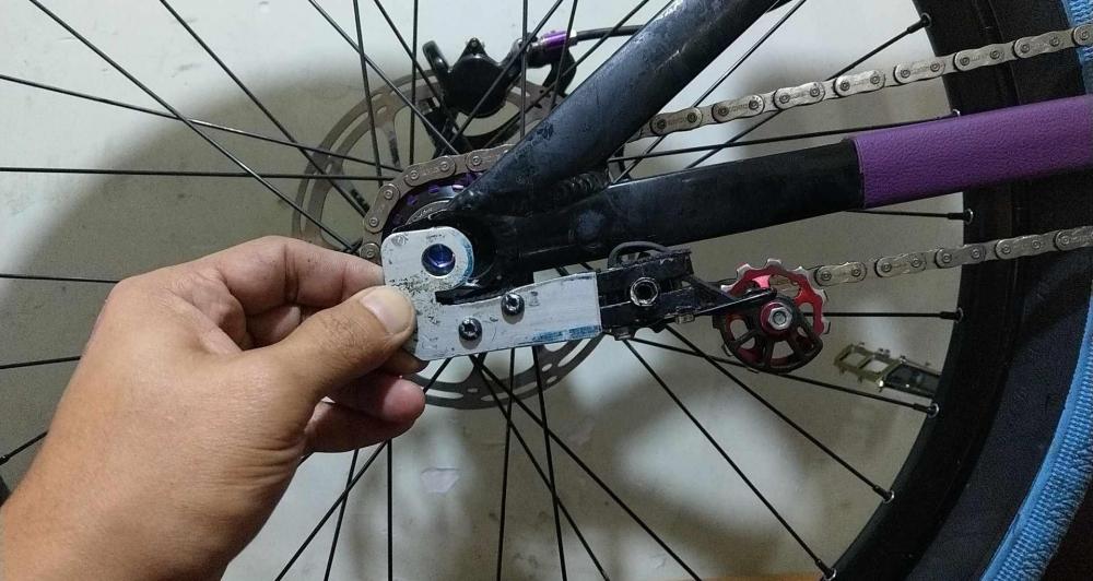

MaderaMark Posted October 20, 2022 Report Share Posted October 20, 2022 i got my DIY too... just being lucky to have friends who dumps mtb parts and I managed to build up. Plus aluminum plates in my work site... 2 Quote Link to comment Share on other sites More sharing options...

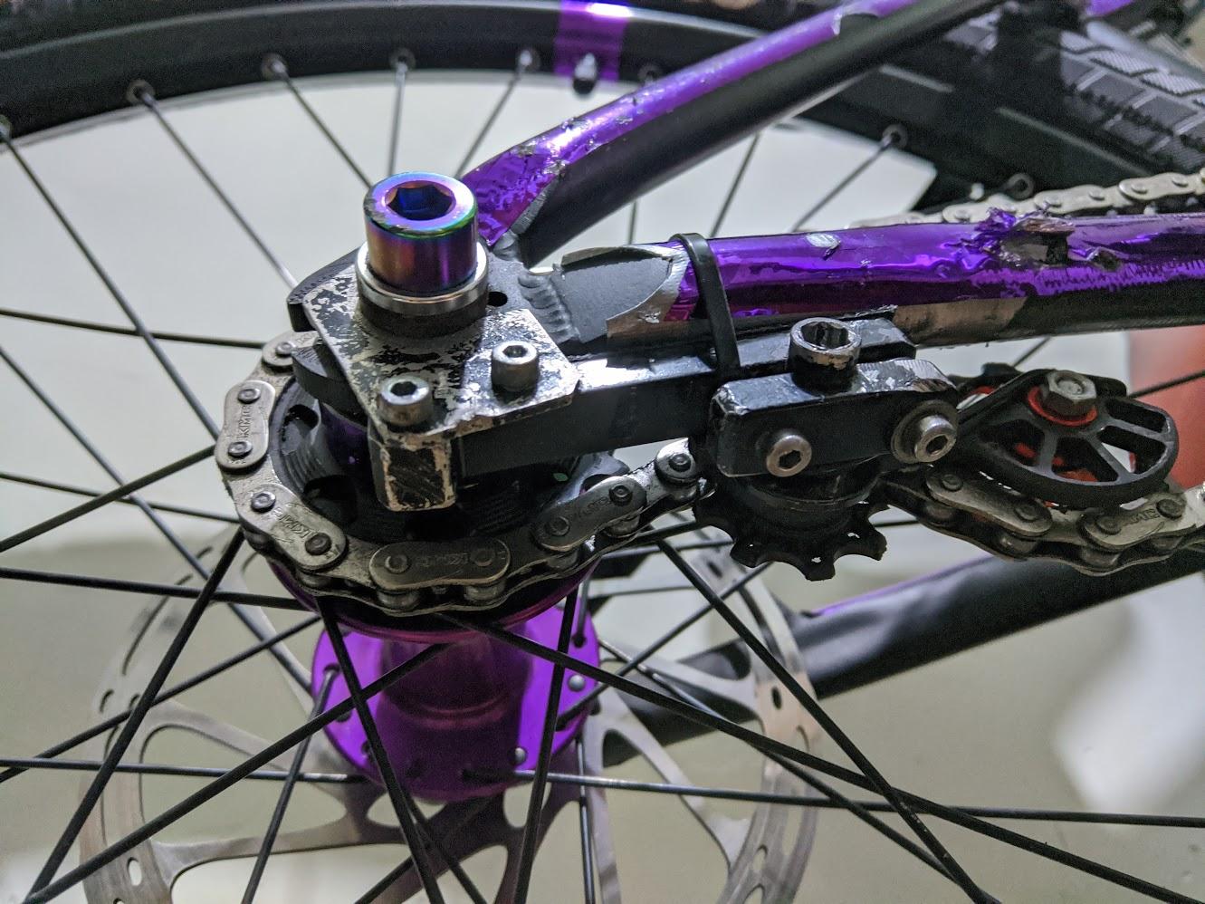

MaderaMark Posted March 21, 2024 Report Share Posted March 21, 2024 on to another frame/drop out 2 Quote Link to comment Share on other sites More sharing options...
