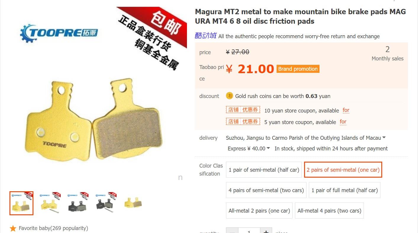

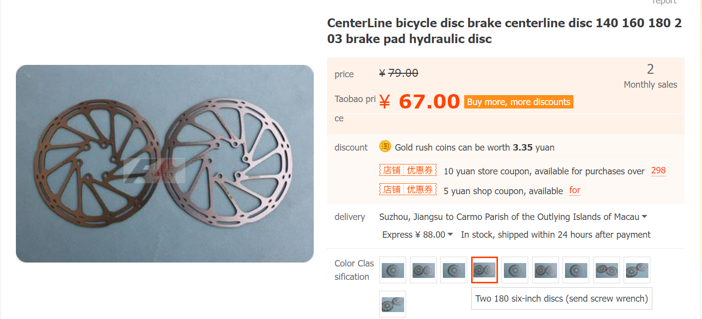

MaderaMark Posted October 19, 2022 Report Share Posted October 19, 2022 i am still with my good aged shigura (deore levers/MT4 calipers) with generic metallic pads plus China made 180mm centerline rotors. still holds my now 77kg fluffy body. Sometimes, cheap isn't always waste of $$$... 1 Quote Link to comment Share on other sites More sharing options...
