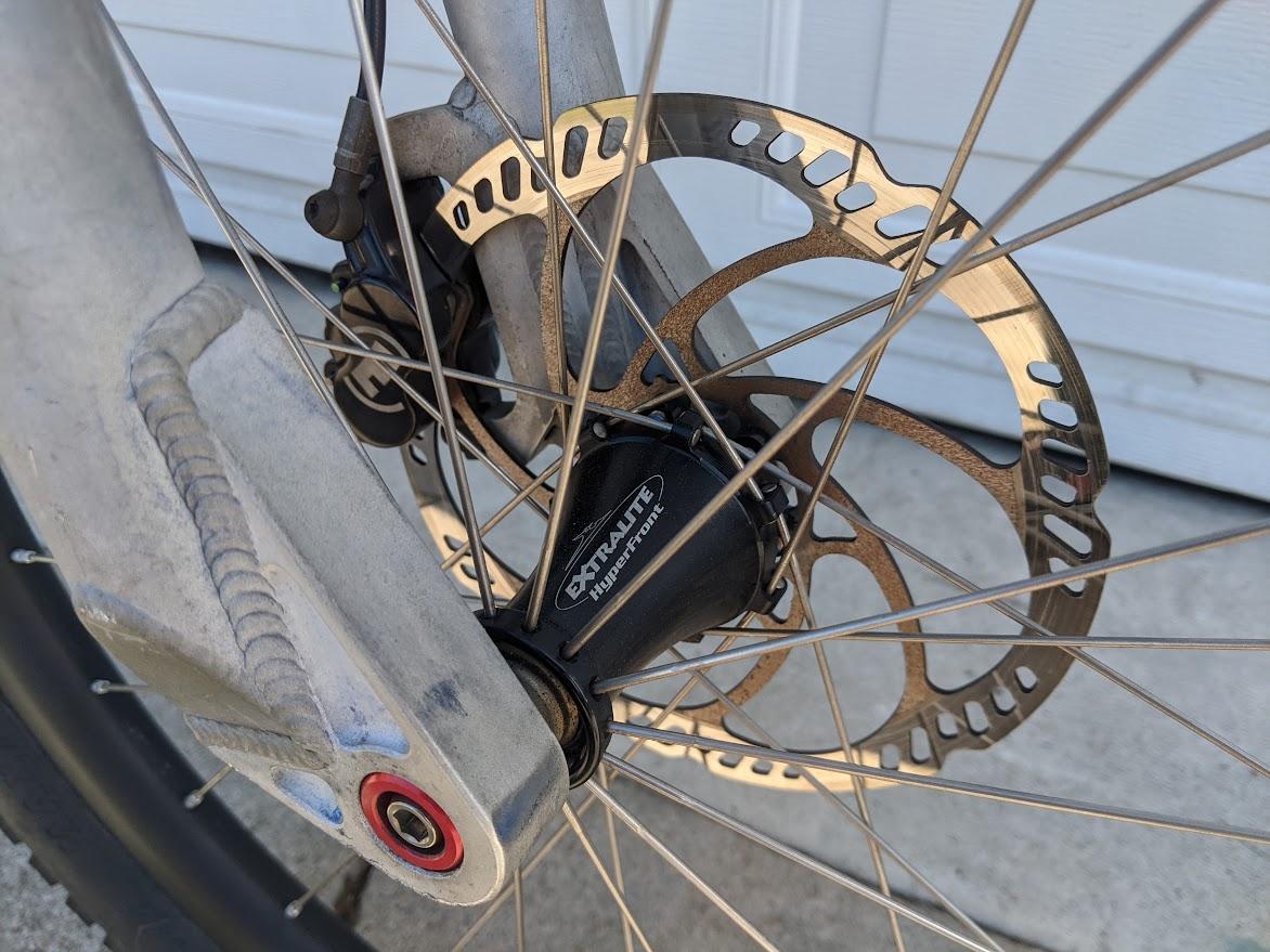

Swoofty Posted September 27, 2022 Report Share Posted September 27, 2022 Most of my bikes are 3x front. My pure trials stock bike is 2x front w HS33s up front. I have one street trials bike that is 3x disc side and radial non disc. Quote Link to comment Share on other sites More sharing options...

Swoofty Posted October 1, 2022 Report Share Posted October 1, 2022 Or you could use a hub designed to be 3x and radial ;-) Oh yeah! Quote Link to comment Share on other sites More sharing options...
Mark W Posted October 3, 2022 Report Share Posted October 3, 2022 That is one way of doing it, haha. Out of interest, have you tried a 3x/3x or 3x/2x pattern up front? Only reason I ask is I found that on a 24" especially it felt so much stiffer. I had a 3x/radial front wheel on my Echo 24", and the difference in feel when I was carving into spins (more so things like bunnyhop 180s and 360s) and things like that was night and day when I went to 3x/3x. That said, I am super fussy as far as feel/setup goes... Quote Link to comment Share on other sites More sharing options...
Swoofty Posted October 4, 2022 Report Share Posted October 4, 2022 I have two 24" street bikes at the moment. The other one is 3x/3x and I honestly can't tell the difference. I can do rolling 180s, but not 360s and I do a lot of front end moves, but no gaps to front. It is very possible that I'm not sensitive enough to notice a difference. The difference may be down to the 3x/radial hub being designed to be that way as opposed to a regular hub built radial non disc side. Extralite make some pretty incredible hubs. The 3x/3x wheel is also Extralite, but the J bend version hub and I've never built it radial. When's your birthday? I'll send you an Extralite hub ;-) Quote Link to comment Share on other sites More sharing options...
