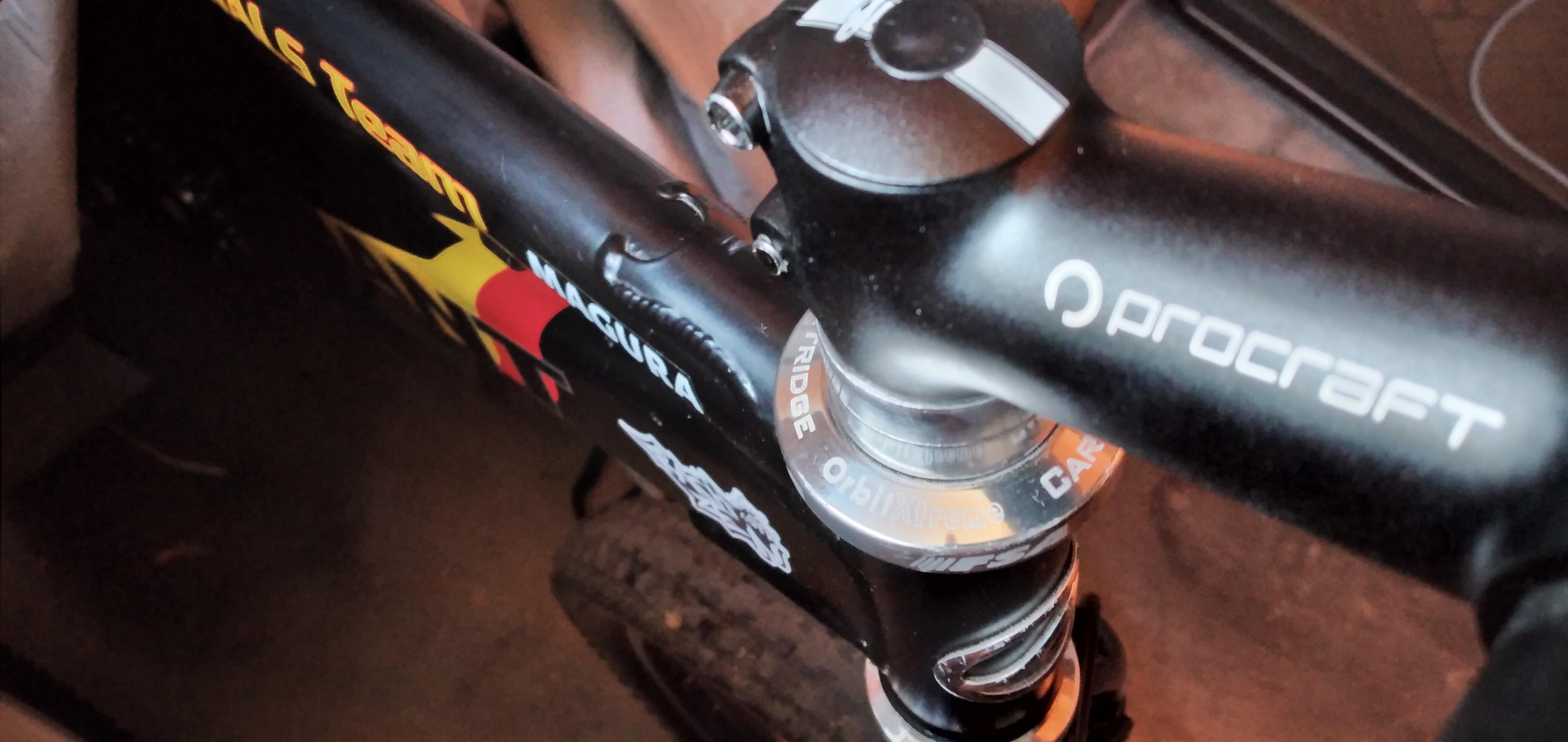

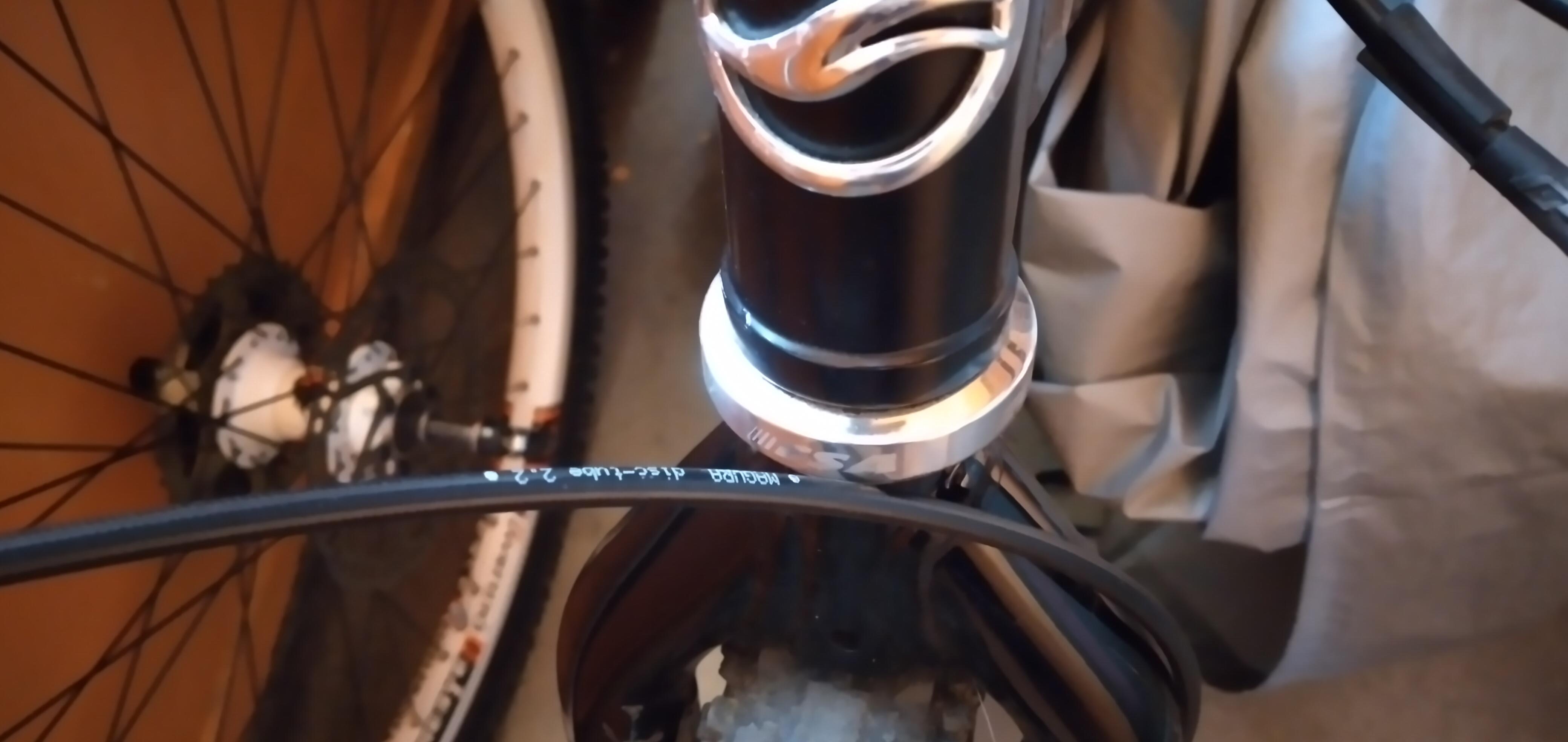

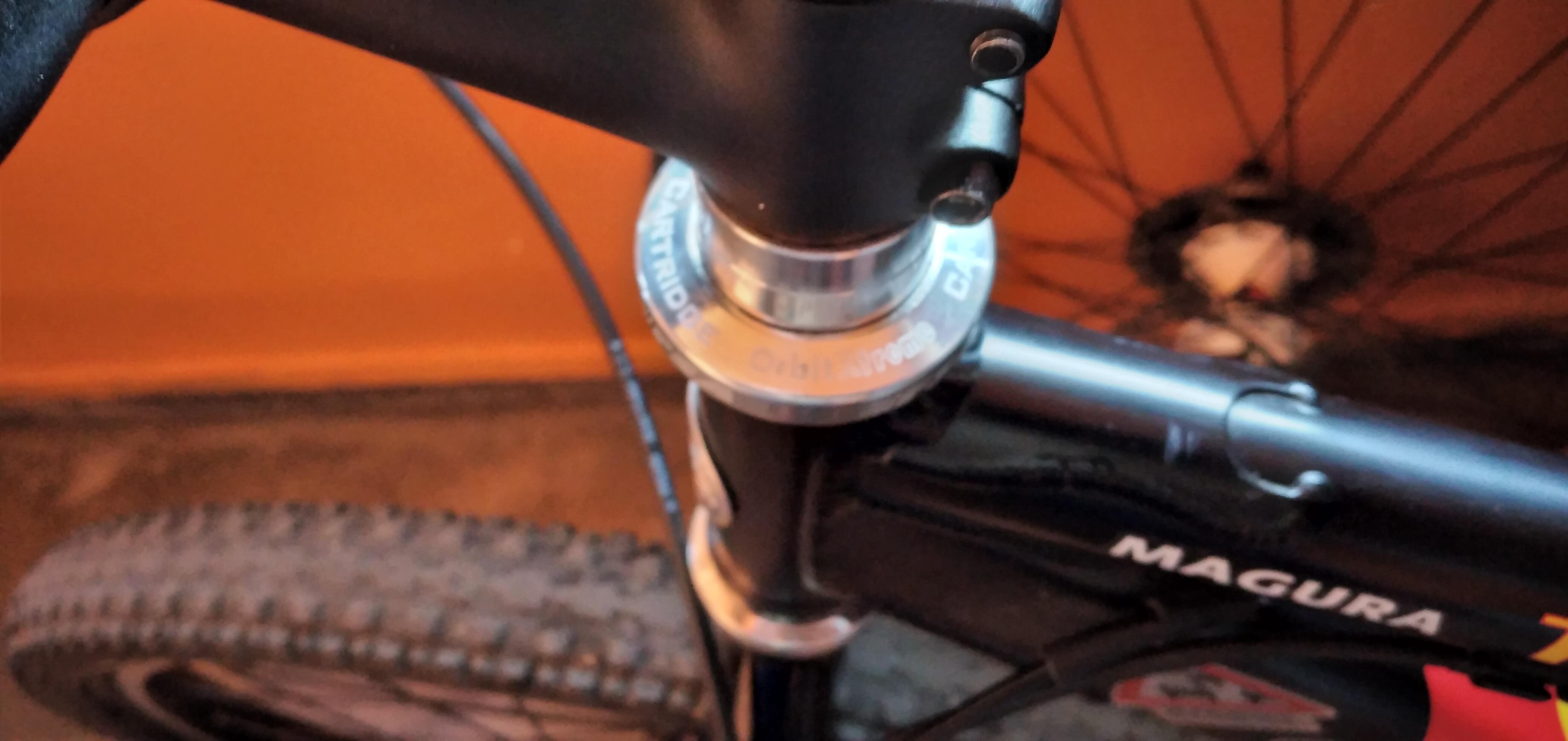

Hi there.My Giant Trials need new headset and current one is FSA xtreme - old model one and frame went to me like taht.What headset do i need in order to get fitted in that frame properly,because is old one?I look at FSA pig but i am not sure it would be ok,so,what would be your recommendation about?

Can you please take a picture of your headset or precise what version do you have exactly?
If I recall correctly, the first versions (black, yellow) requires a EC34/28.6 EC34/30 headset, while the third generation (with curved tubes) requires a ZS44 /28.6 ZS44/30.
Thanks. It is a EC34/28.6 EC34/30 headset.
