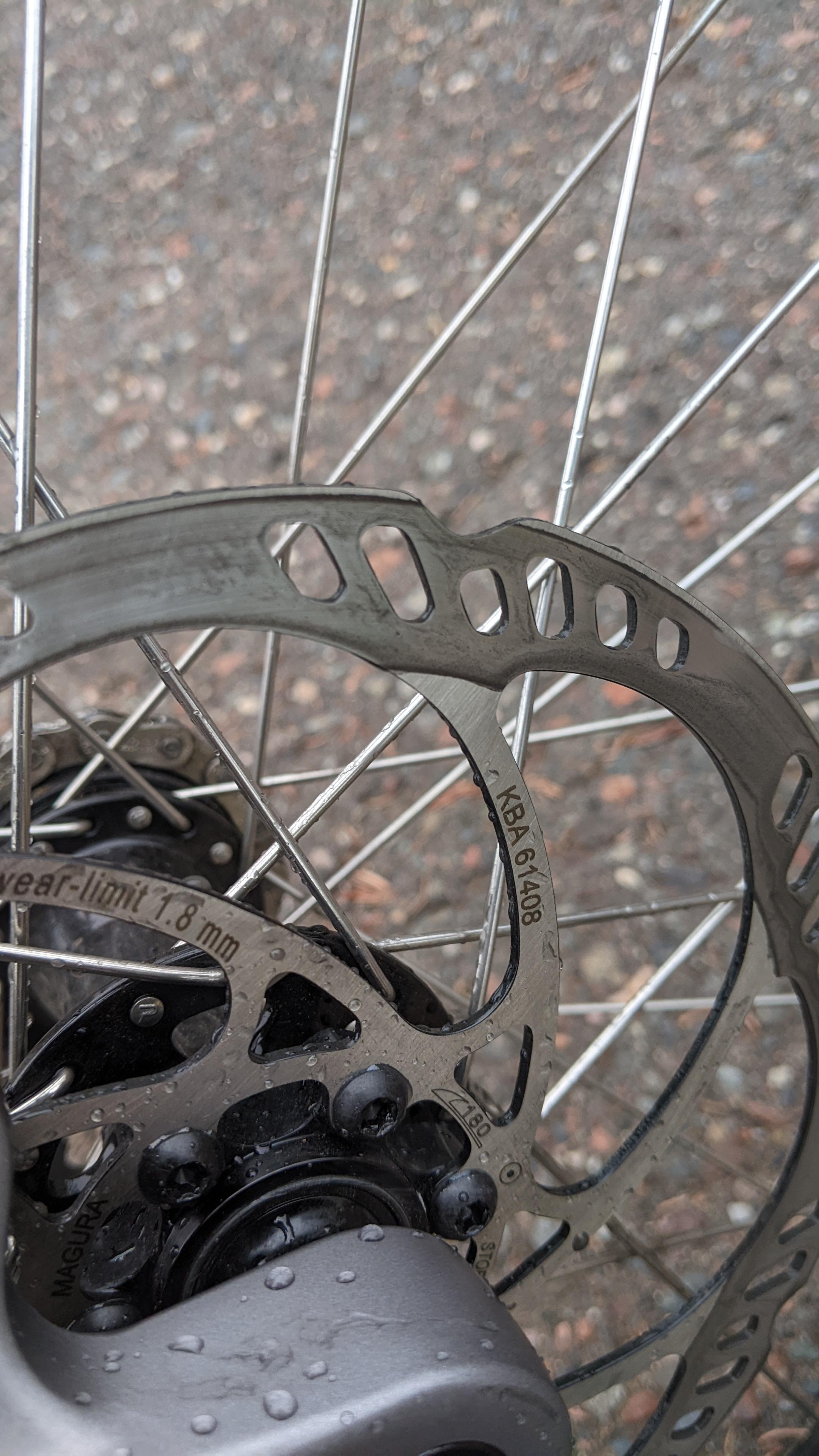

JT! Posted August 14, 2022 Author Report Share Posted August 14, 2022 Urgh, I give up. Went through all the process again and still shit. Might just toss the thing in the shed and worry about it next year. Spent two weekends trying to get this sorted so I can ride it properly before winter, looks like that's not gonna happen. This is what the rotor looks like after I toss on some water to try and see if it needs to bed in. Not sure if it's mineral oil, or just left over debris from sanding the pads. Quote Link to comment Share on other sites More sharing options...
AdamR28 Posted August 15, 2022 Report Share Posted August 15, 2022 That is pretty normal after wetting the rotor. However, new pads AND rotor required to get the brake working properly again. No exceptions. 1 Quote Link to comment Share on other sites More sharing options...
