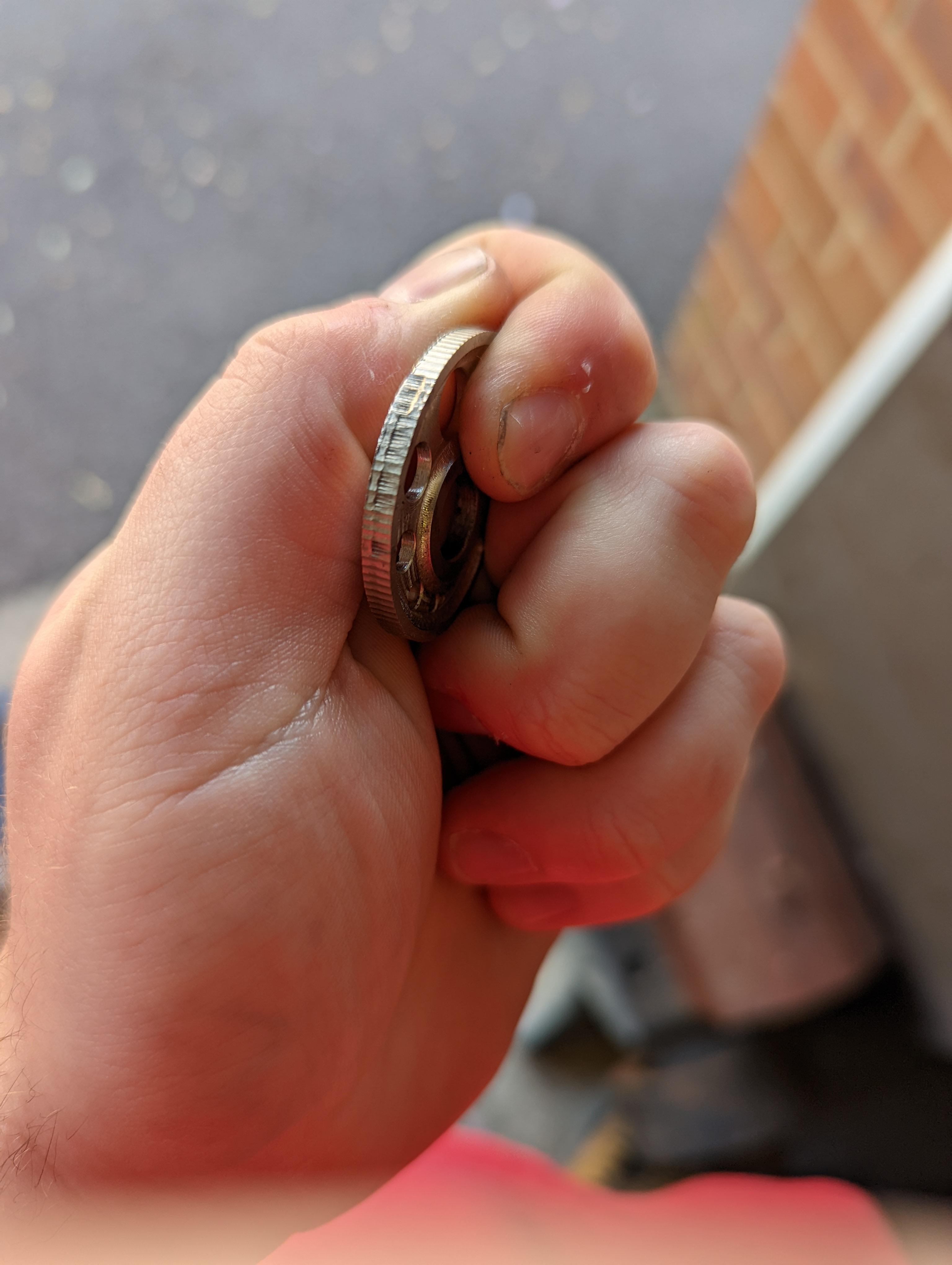

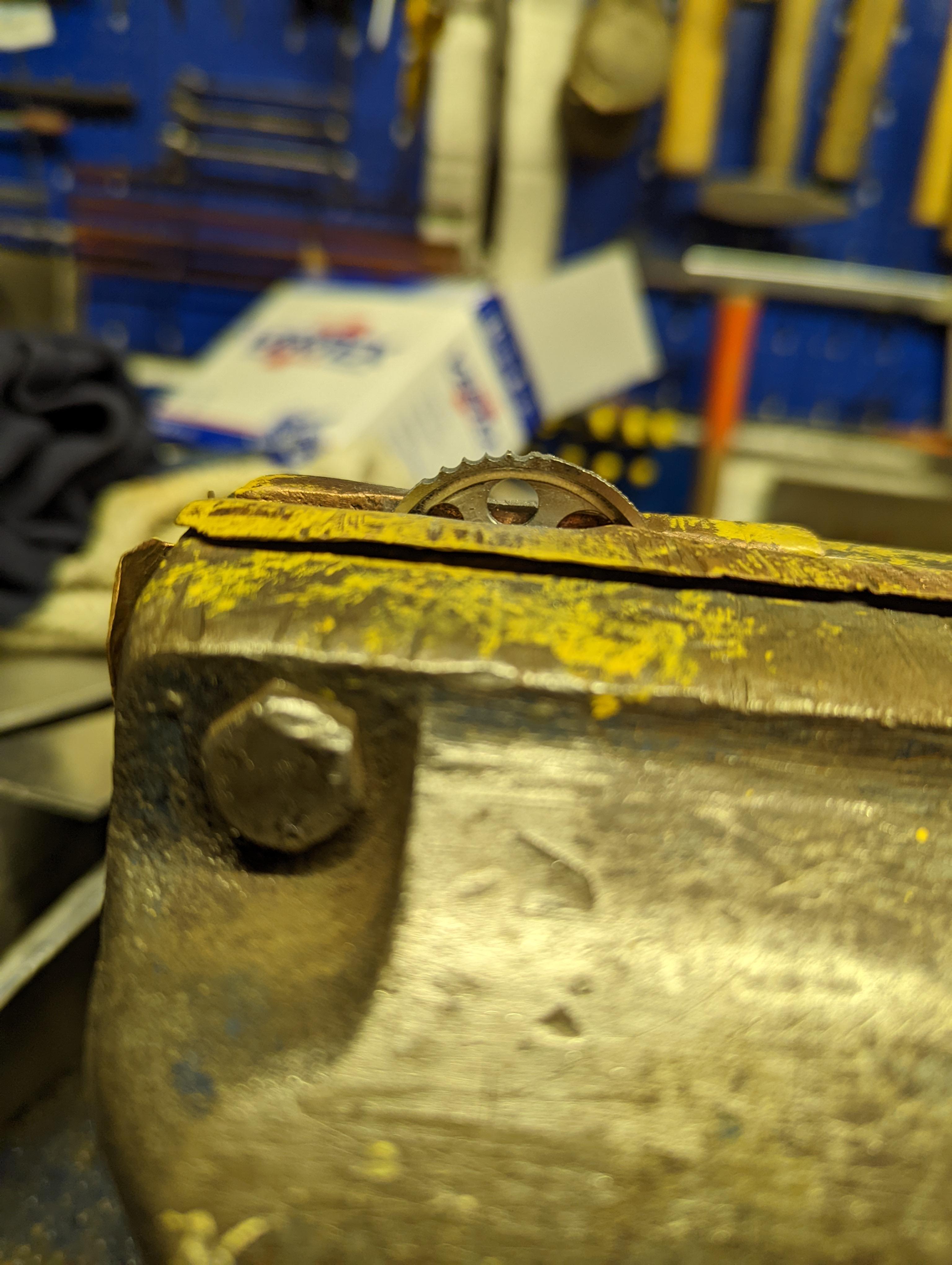

Chakers1998 Posted May 12, 2022 Author Report Share Posted May 12, 2022 Found that I'd mashed the cam. Luckily, my dad has some needle files that were small enough to file some bigger indents on the cam. I had to file another indent on the cam after trying it the first time, because it mashed the cam again. The extra indent made the chain too tight, but when the cam bedded into the snail cam bolt, it got to an appropriate tension. This tension didn't change after bouncing around on the back wheel for 20 mins. I'll have to see how it holds up on the DJ ride, but fingers crossed I won't have a sloppy chain. Quote Link to comment Share on other sites More sharing options...

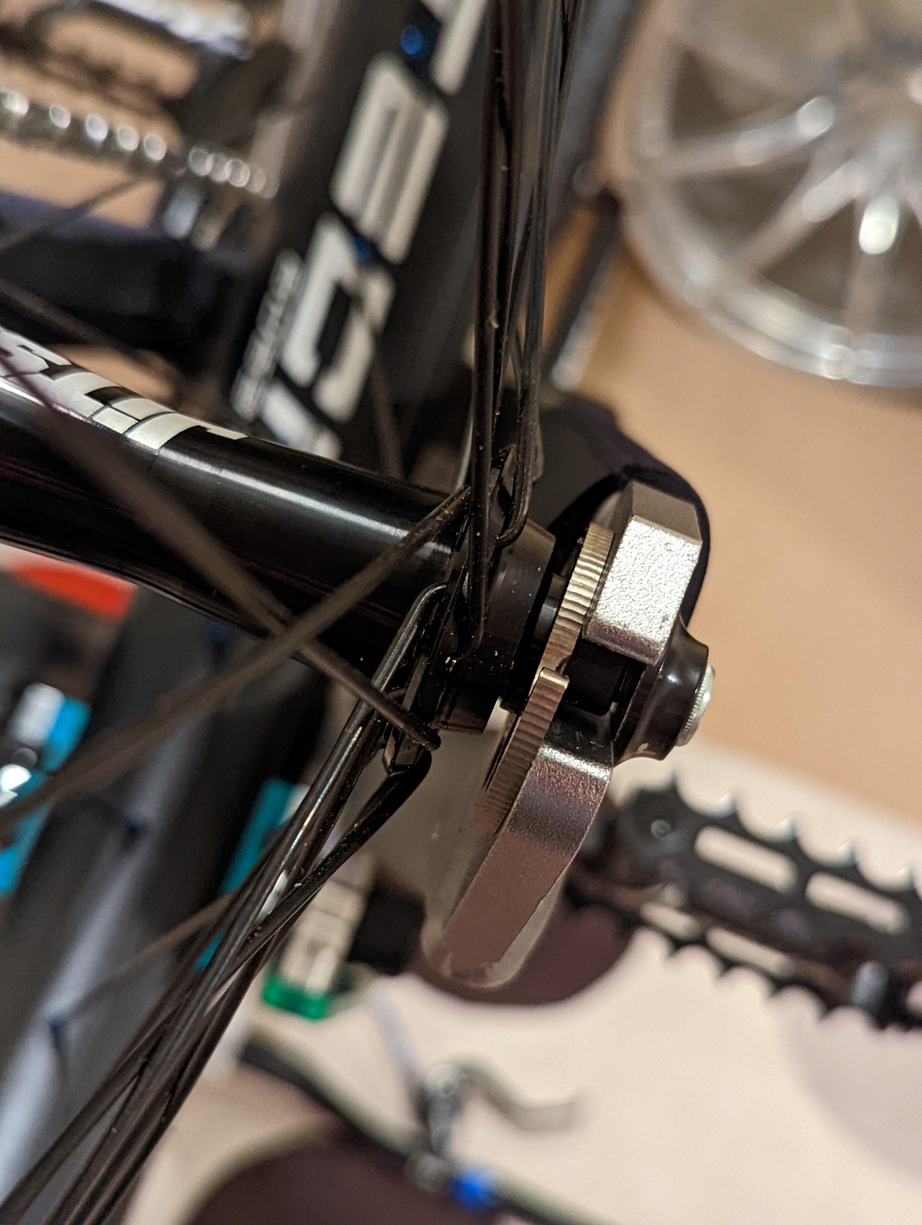

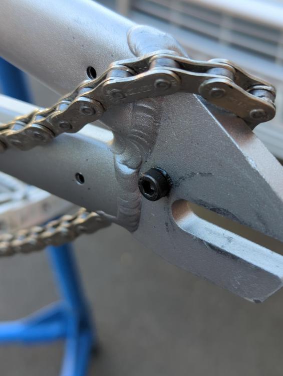

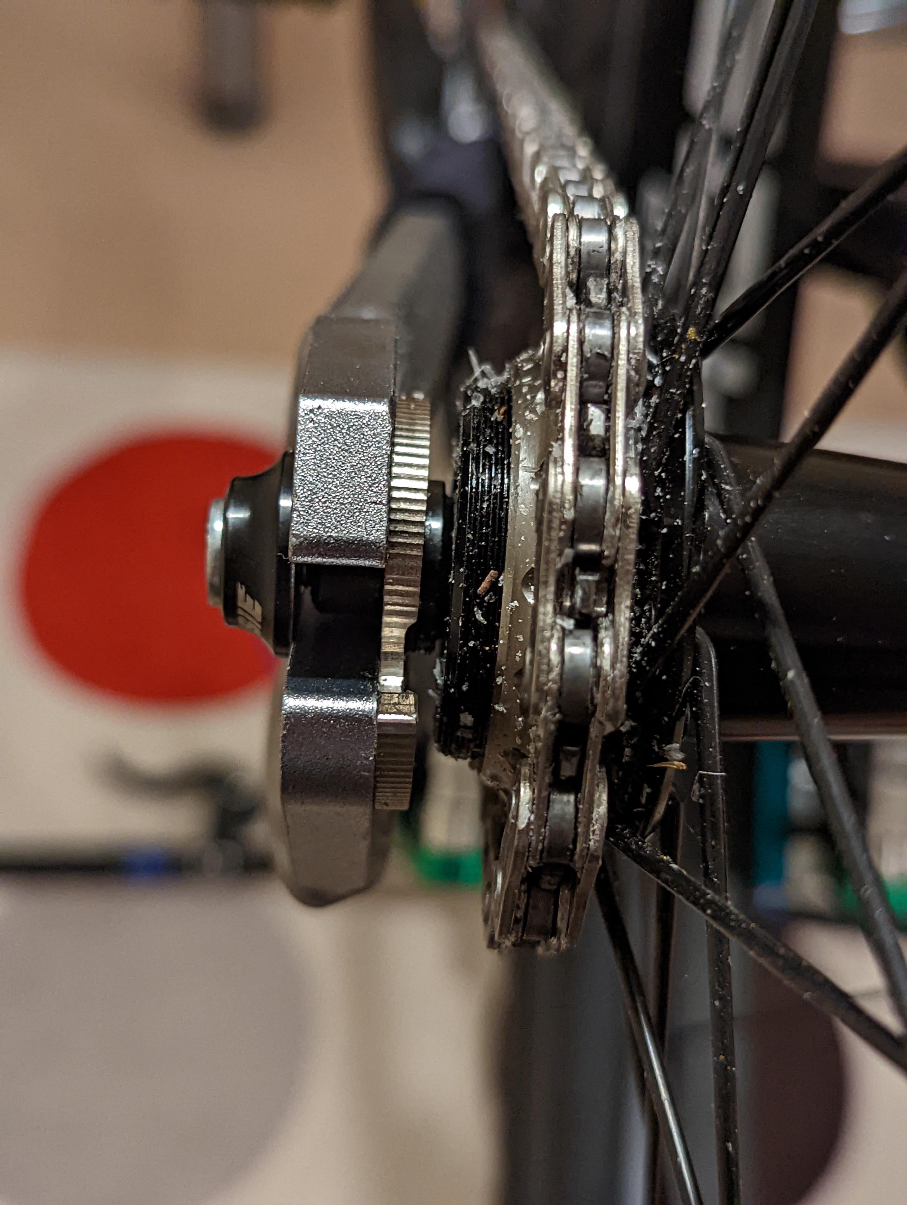

AdamR28 Posted May 13, 2022 Report Share Posted May 13, 2022 Got any photos of what your snail cam is resting against? Quote Link to comment Share on other sites More sharing options...
Chakers1998 Posted May 13, 2022 Author Report Share Posted May 13, 2022 1 hour ago, AdamR28 said: Got any photos of what your snail cam is resting against? Hi Adam, As in what it is resting against Side to side? I've got some pics of that. Quote Link to comment Share on other sites More sharing options...
AdamR28 Posted May 13, 2022 Report Share Posted May 13, 2022 My fault for not being clear - I mean whatever the toothed outer edge of the cam is butting up against. Quote Link to comment Share on other sites More sharing options...
Chakers1998 Posted May 13, 2022 Author Report Share Posted May 13, 2022 Snail cam bolt. The standard ones on an ozonys skill. Quote Link to comment Share on other sites More sharing options...
AdamR28 Posted May 13, 2022 Report Share Posted May 13, 2022 Weird. The egde of the cam looks so beaten up! Never seen one like that before. Wondered if the snail cam bolt might have been weird / in a mess / something else, but no. Hopefully the new axle bolt washers help. Plenty of grease on the axle bolt threads and under the head, give it plenty of torque Quote Link to comment Share on other sites More sharing options...
Chakers1998 Posted May 13, 2022 Author Report Share Posted May 13, 2022 1 hour ago, AdamR28 said: Weird. The egde of the cam looks so beaten up! Never seen one like that before. Wondered if the snail cam bolt might have been weird / in a mess / something else, but no. Hopefully the new axle bolt washers help. Plenty of grease on the axle bolt threads and under the head, give it plenty of torque I think the issue was when the bike was new I was using the Jitsie axle washers which have next to no teeth at all. Plus me probably not tightening down the bolts enough lead to the hub sliding in the dropouts and the cam taking all the load, hence the mashing. I had to swap out a borrowed BB today, which gave me a chance to look at the dropouts and the Tarty axle washers have left a good mark on the frame, plus sanding the frame where the washers clamp on must have helped a bit. Hopping around outside the house for a while hasn't made the chain loosen off, so it's looking like all systems are go. Thanks Everyone! 1 Quote Link to comment Share on other sites More sharing options...

Chakers1998 Posted May 14, 2022 Author Report Share Posted May 14, 2022 Its come loose again!! I've deformed the steel above one of the drilled out holes from where I've filed the cam for bigger notches. I've been really tightening down the axle bolts so I can't understand why the cam is taking so much load, because ideally it shouldn't be. Quote Link to comment Share on other sites More sharing options...

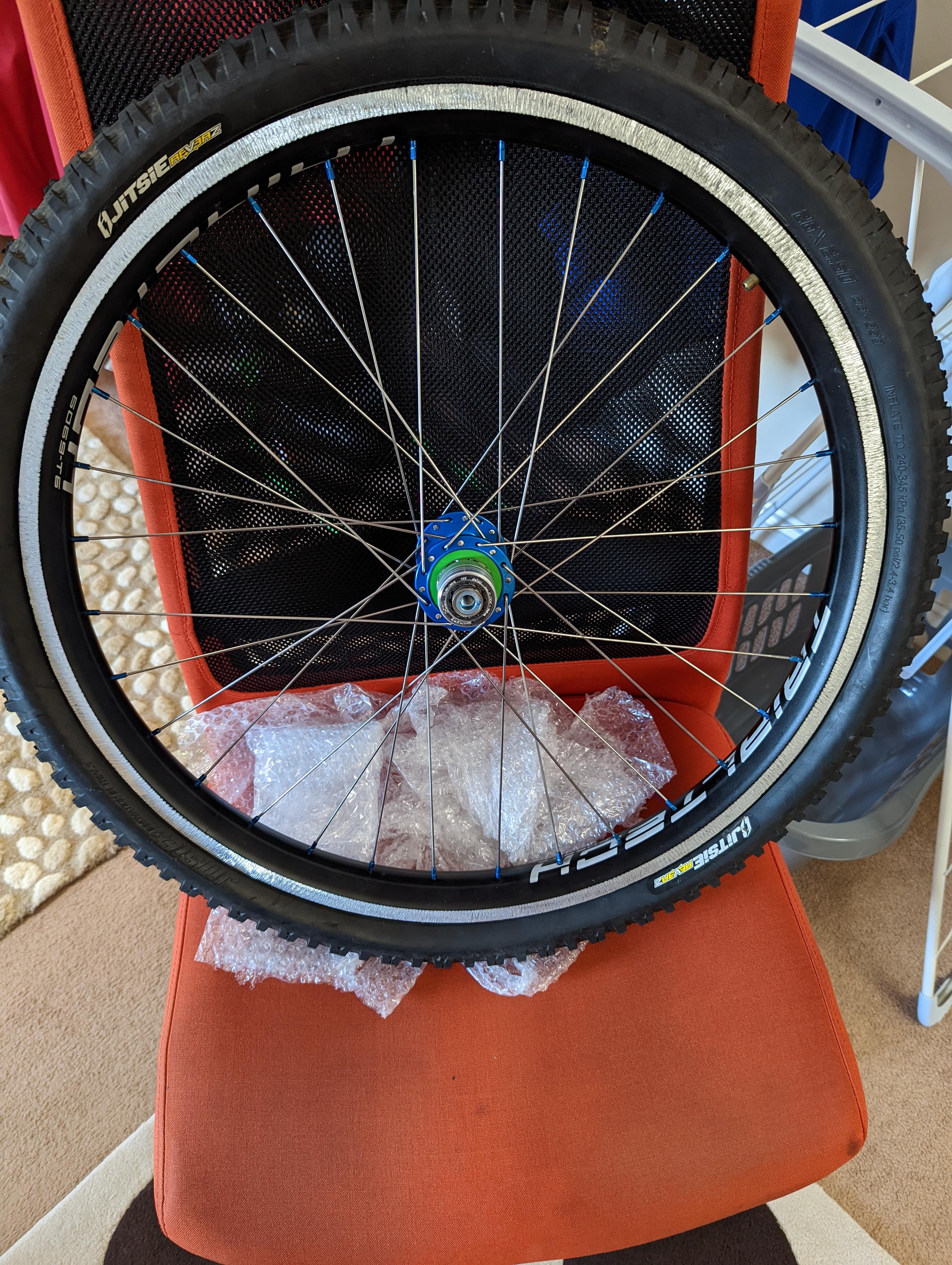

Chakers1998 Posted June 22, 2022 Author Report Share Posted June 22, 2022 Just finished building a Hope trials hub. The Jitsie isn't cutting it, which is a shame as it's a really nice hub and it would be fine with vertical dropouts. Quote Link to comment Share on other sites More sharing options...
