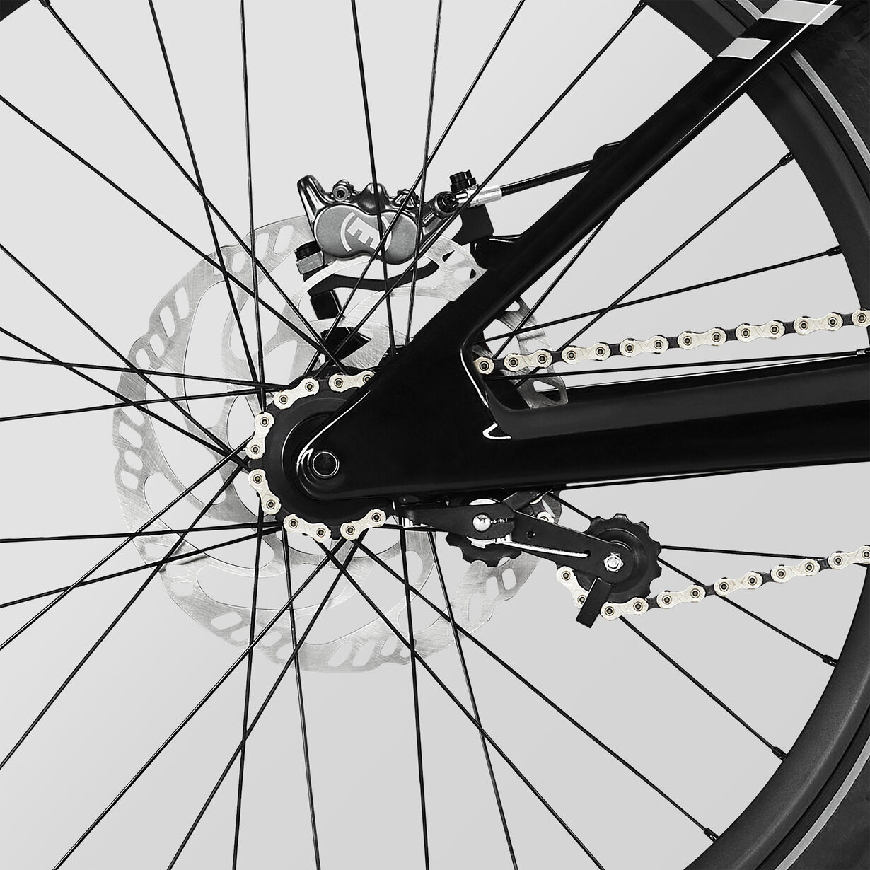

Mark W Posted April 14, 2022 Report Share Posted April 14, 2022 3 hours ago, Davetrials said: can only be good for the sport! Imagine how good it could have been if they put any effort into it. Those rotors have movement between the braking surface and carrier, not something you want on a trials bike. "Crank SRAM Descendant 6K" There's a reason Inspired don't use the 6K alloy version of those cranks on trials bikes. "Chain KMC X11-93 Durable 11-speed chain with nickel-plated outer links. The precision-manufactured KMC Double X Bridge, combined with specially chamfered inner and outer plates, keep the chain running super-smooth and guarantee fast, clean gear changes." Sounds... ideal? "Chainguard Canyon GP0361-01 This chainguard keeps the chain securely on the chainring." In depth subject knowledge ahoy. Copied the Inspired tensioner system, but then decided to add a chain retention hoop on the jockey wheel, making it ballache to drop the chain off to take your wheel in and out, whilst adding no benefit? Sweet 36-click DT Swiss hub to go with it too. It just seems to me that the compromises in spec due to maximising profit margins/not understanding the discipline/not caring/a combination of these things mean that I'm not sure it's going to give a great experience to the end user. A lot of comments are mentioning how expensive it is, so paying a lot for a niche bike only to then have to immediately change parts on it (mainly the rotors) isn't really ideal, and probably won't help those riders new to trials stick with it. The 'good' thing is that judging from the claimed frame weight they've beefed it up quite a lot, so at least that might last and be a decent basis to upgrade on if you like the geo. It would have been better for trials if they'd used their size and resources to create a good quality, affordable, entry level bike rather than making a mediocre top-of-the-range-framekit-with-shit-build-kit. I get why they did - they've spent a lot on the moulds for the frame and fork for Fabio, so to try and recoup that cost they've punted some bikes out, it's just a pity that they apparently spent more time considering the paintjob than the parts they were going to put on it. Realistically I don't see any other brand getting into trials at this stage. It's almost impossible getting hold of their normal product lines, so rolling the dice with trials stuff now just isn't going to be worth it and might just be fully unworkable for them from a production capability stand-point. I expect that that's partially why Marin aren't doing anything more than that one-off frame for Duncan. Equally, I think most of them are getting into trials riders simply for marketing rather than wanting to support trials per se. Danny and Fabio both came with huge audiences already, so it's a goldmine for any brand that can get hold of that and then leverage it. If Danny decided to never ride a trials bike again, Santa Cruz wouldn't be too upset, and I expect it'd be the same for Fabio and Duncan with their respective sponsors too. It means fewer "Look at our rider ride in our office/warehouse/factory!" videos, but means they're just pushing bikes they can actually sell. EDIT: Only just realised in that big photo of the tensioner how properly budget they went with that. My my. Considering it costs more than the Inspired hanger + tensioner, that's insane. See also: £65 rear sprocket and spacers. £23.95 basic top cap and bolt. 5 Quote Link to comment Share on other sites More sharing options...

Maintenance Justice Posted April 14, 2022 Report Share Posted April 14, 2022 (edited) 4 hours ago, Mark W said: It would have been better for trials if they'd used their size and resources to create a good quality, affordable, entry level bike rather than making a mediocre top-of-the-range-framekit-with-shit-build-kit. This. It would’ve been really cool to see a £1000 to £1500 alloy bike with the Fabio name as a draw to a wider audience into Trials but alas no. I was thinking this might be able to engage some new riders (and it probably will to a certain extent) however riders used to dropping this sort of cash expect a bike to perform especially as it’s ‘Rigid’ so it should be mint right? For that money? Surely? Problem is as Mark says there are some really half arsed / totally wide of the mark parts choices that anyone who buys into this will quickly realise are inappropriate or just plain dangerous for actual Trials riding (cheap star ratchet hubs notoriously sluggish engagement and when they skip….). Trials riders will immediately pick out the faults, MTB riders will quickly realise its flawed and be a bit miffed at spending that cash. All the while the grassroots of the market are wondering when their entry budget will buy more than a snickers. Edited April 14, 2022 by Maintenance Justice Quote Link to comment Share on other sites More sharing options...

SLB Posted June 12, 2023 Report Share Posted June 12, 2023 I pulled the trigger and bought myself one. I'm not riding as much these days and hoped a new fancy bike would help me get riding. Problem is I don't want to scratch it :s I bought the Tomomi model and it rides pretty nicely. Super light and flicky. The brakes needed a bleed and the rear hub sucks.. that's the only gripe I've had with it so far. Quote Link to comment Share on other sites More sharing options...
javimic Posted June 21, 2023 Report Share Posted June 21, 2023 On 6/11/2023 at 11:39 PM, SLB said: I pulled the trigger and bought myself one. I'm not riding as much these days and hoped a new fancy bike would help me get riding. Problem is I don't want to scratch it :s I bought the Tomomi model and it rides pretty nicely. Super light and flicky. The brakes needed a bleed and the rear hub sucks.. that's the only gripe I've had with it so far. Congrats! The Nishikubo model is very beautiful. The aesthetic is amazing and scratching it would hurt! The strength of the frame (Yohan) is proven. You will probably change the rear hub, maybe the rotors or not (personal opinion). Being the first edition they have done a very good job that is very competitive. Canyon has sold a lot of them and we don't see people complaining. One would have to wonder why they have chosen some parts when they have all to do the best possible: financial resources, pro rider, etc. Mystery! Quote Link to comment Share on other sites More sharing options...
