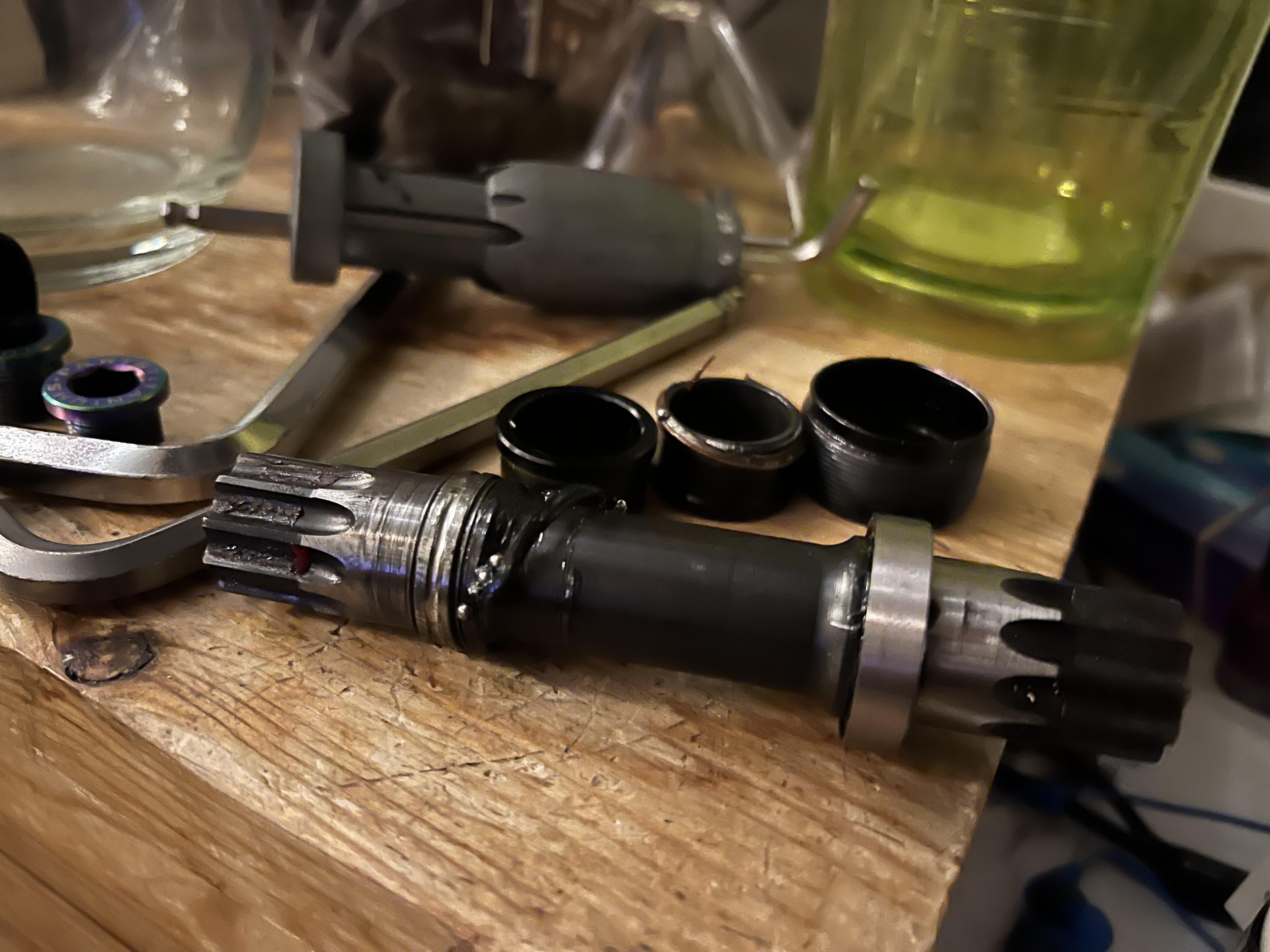

DJEHB Posted February 24, 2022 Report Share Posted February 24, 2022 Purchased a brand new TT sport lite bb back in December. It’s probably seen around 8 hours of pedal time and tonight the driveside bearing died a rather scary and loud death. Anyone else had the same issue with these? Very carefully installed etc, everything kept nipped up. Going to see if there’s any chance of warranty with tarty tomorrow but being a bearing I’m not holding my breath Quote Link to comment Share on other sites More sharing options...
AdamR28 Posted February 25, 2022 Report Share Posted February 25, 2022 Have actually seen a couple of these where the centre sleeve wasn't quite the right length, leading to early bearing death. Pop it back with a note and we'll sort it 2 Quote Link to comment Share on other sites More sharing options...
DJEHB Posted February 25, 2022 Author Report Share Posted February 25, 2022 11 minutes ago, AdamR28 said: Have actually seen a couple of these where the centre sleeve wasn't quite the right length, leading to early bearing death. Pop it back with a note and we'll sort it Adam you are the man. Really appreciate that! I'll post it back today 1 Quote Link to comment Share on other sites More sharing options...

DJEHB Posted May 12, 2022 Author Report Share Posted May 12, 2022 Unfortunately mine did this again after a few more rides. Have switched over to external now. Quote Link to comment Share on other sites More sharing options...
AdamR28 Posted May 12, 2022 Report Share Posted May 12, 2022 That's odd... points to a frame issue, perhaps. Though the Hex should have a nice flat BB face. Quote Link to comment Share on other sites More sharing options...
Chakers1998 Posted May 16, 2022 Report Share Posted May 16, 2022 On 5/12/2022 at 9:15 AM, DJEHB said: Unfortunately mine did this again after a few more rides. Have switched over to external now. This happened to me as well! Fitted the BB on Friday and it went bang on the DJ ride yesterday. I'm going to have my frame reamed and faced at my bike shop. Quote Link to comment Share on other sites More sharing options...
