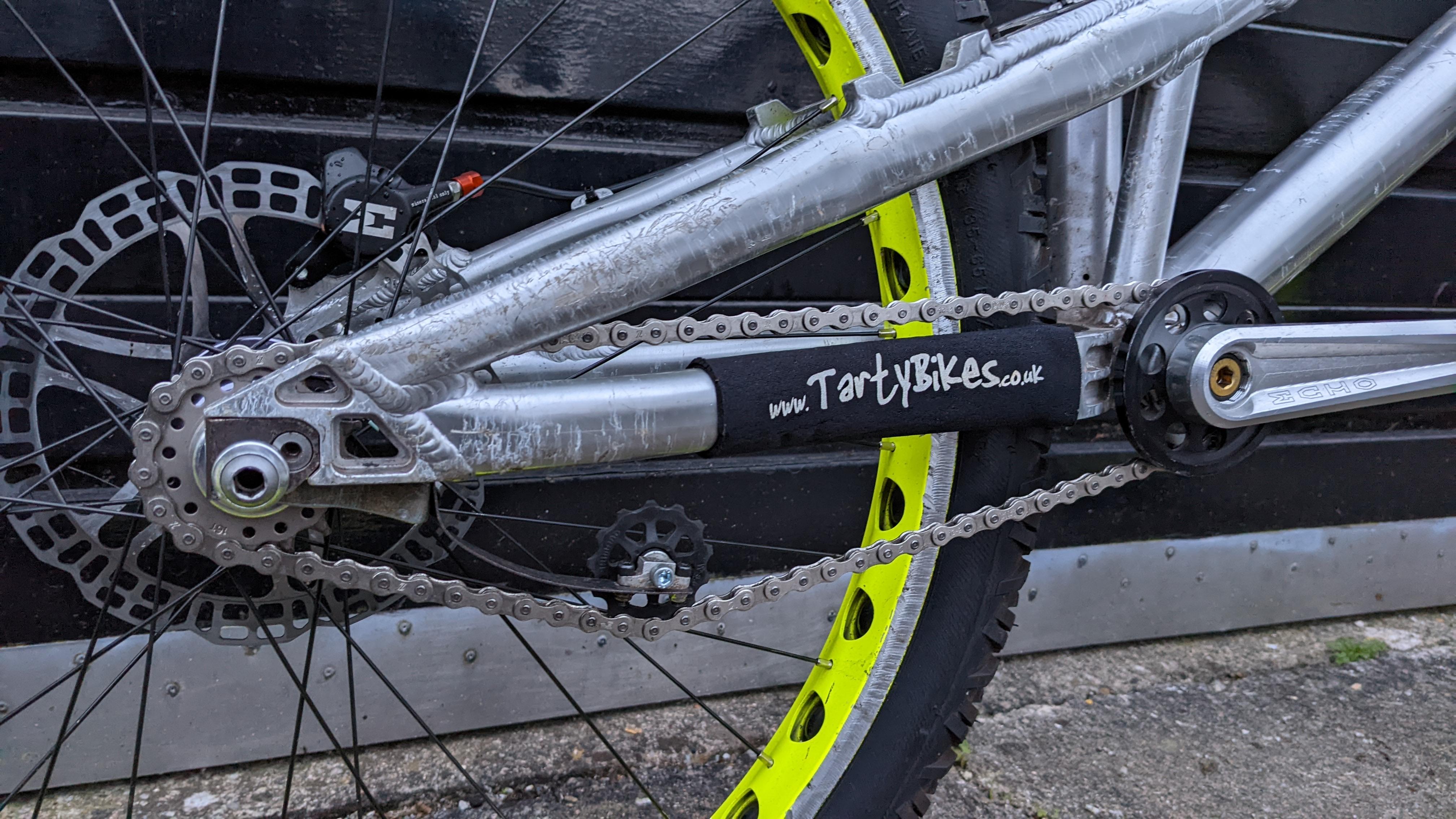

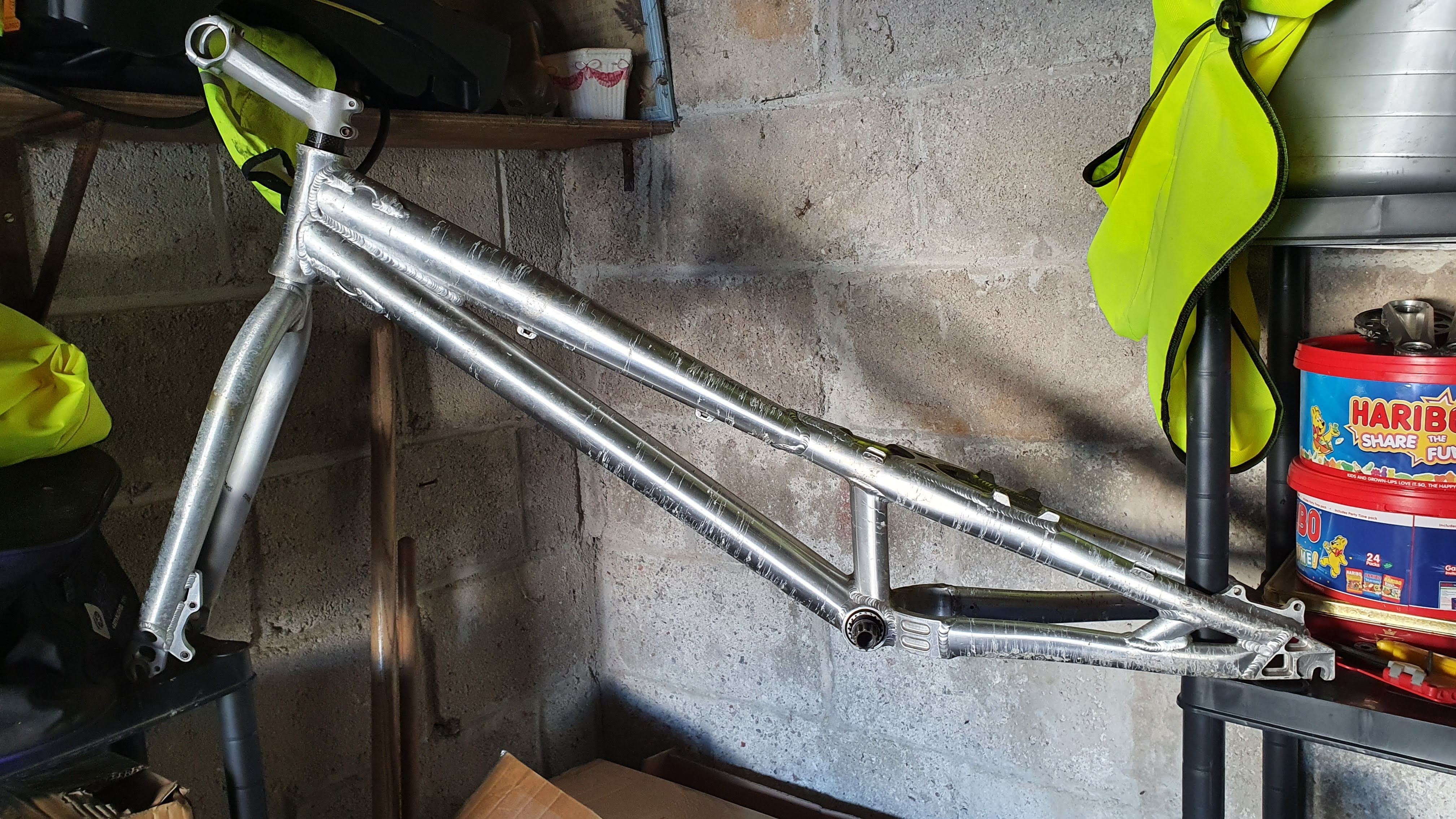

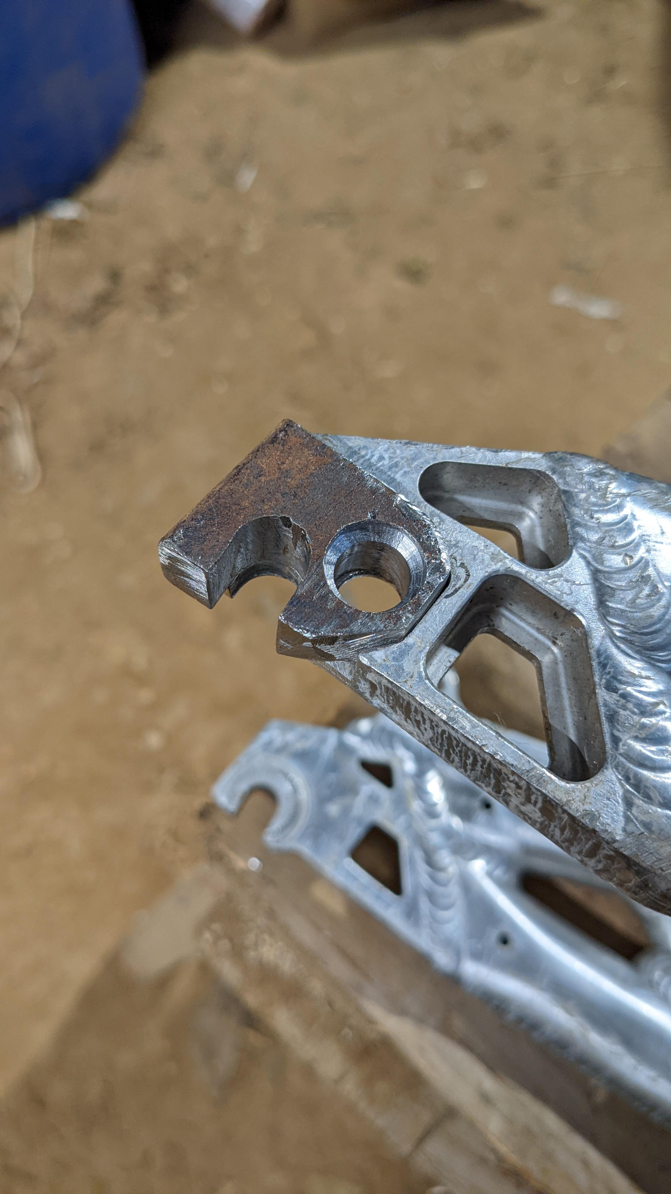

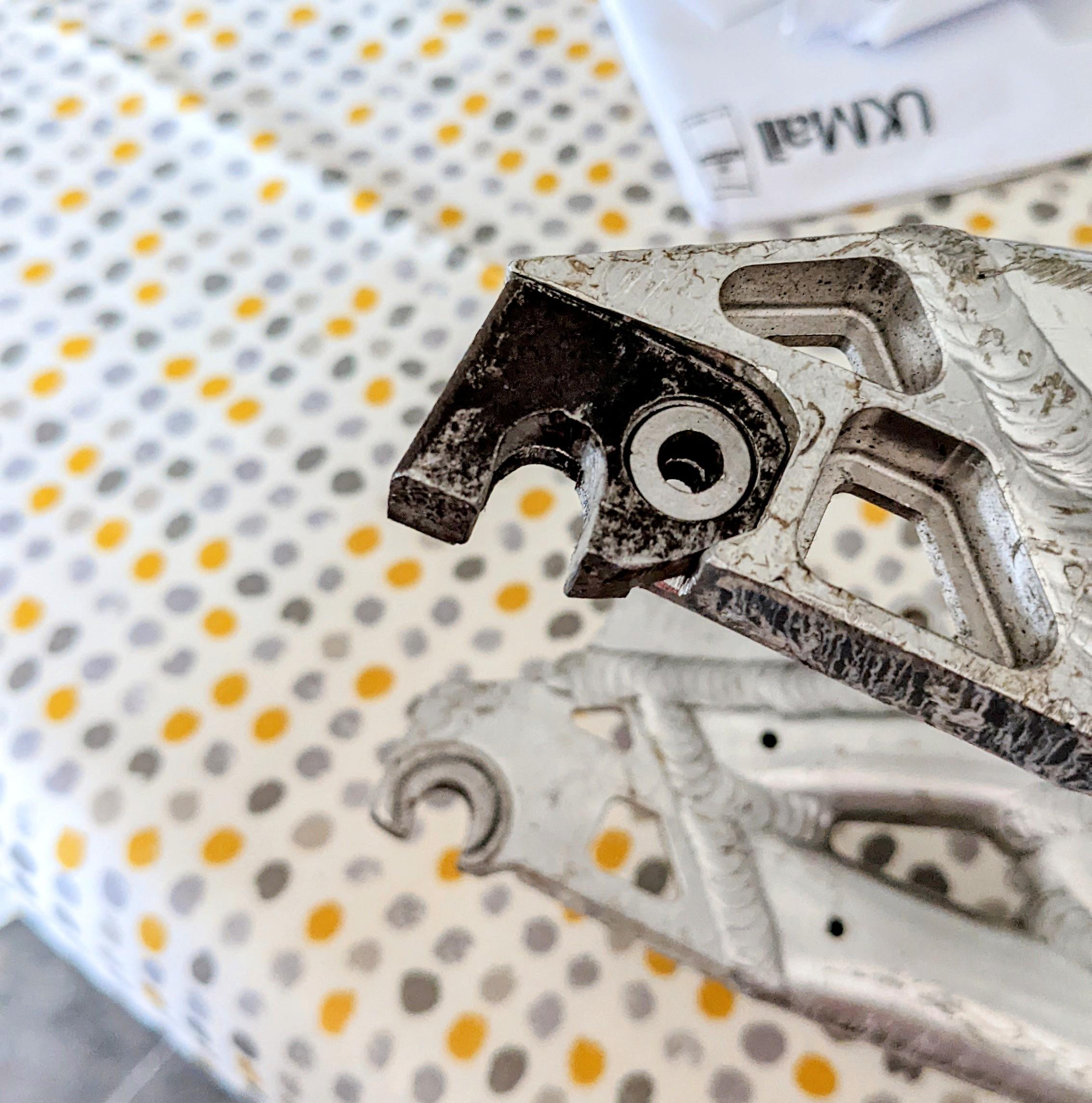

I picked up an Ozonys XS26 which was in need of a little bit of TLC, as with many there is a crack on the drive side dropout, so my plan is to remove the cracked material and create a bolt in dropout.

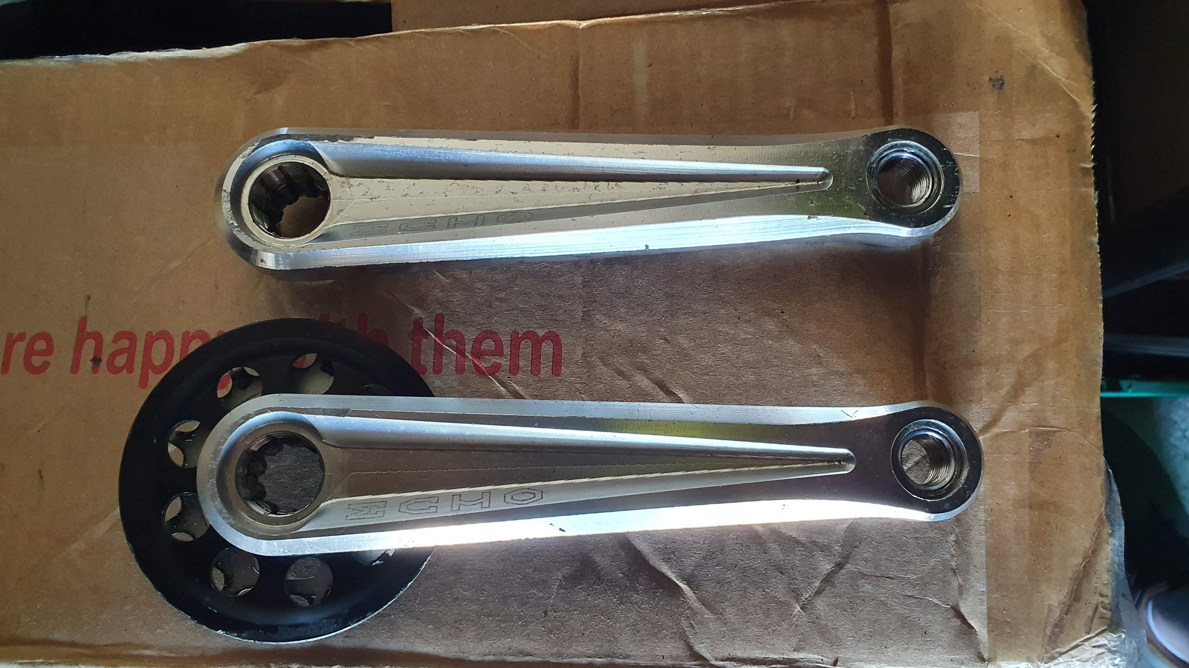

Echo 170mm CNC cranks, bash and 18t sprocket.

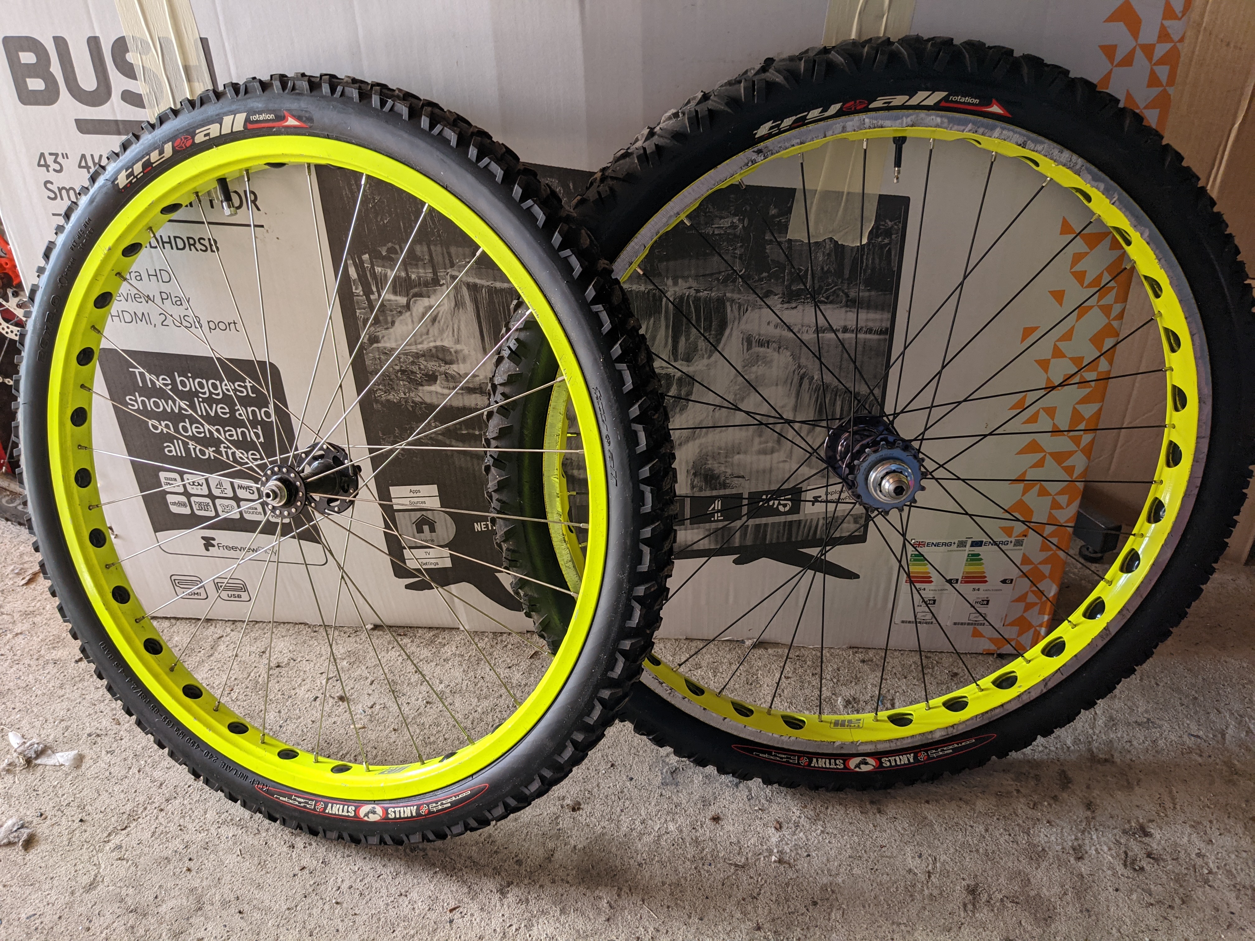

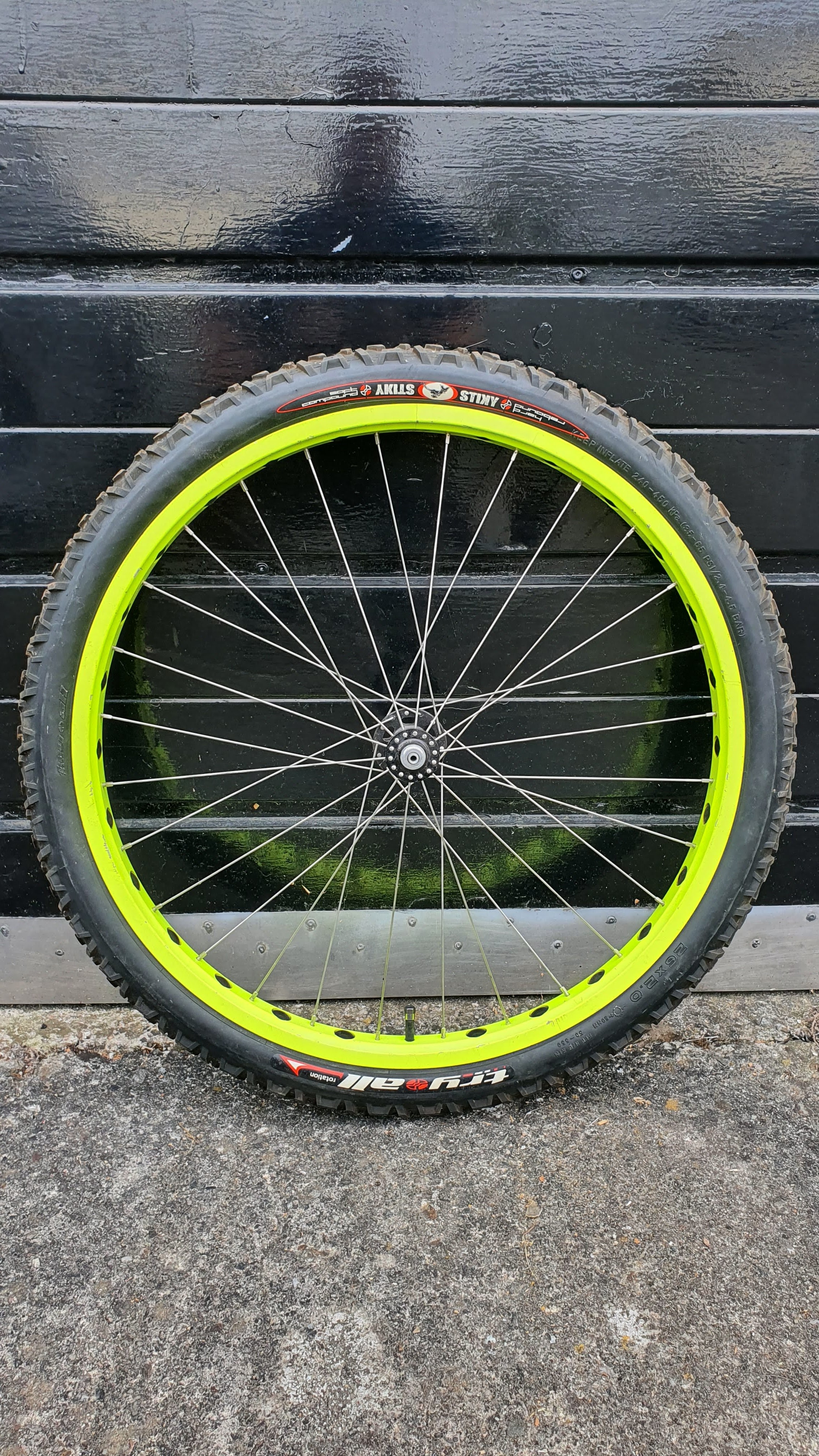

Fluorescent yellow Tryall rims on CK singlespeed rear and Tryall front hubs with Like new Tryall tyres.

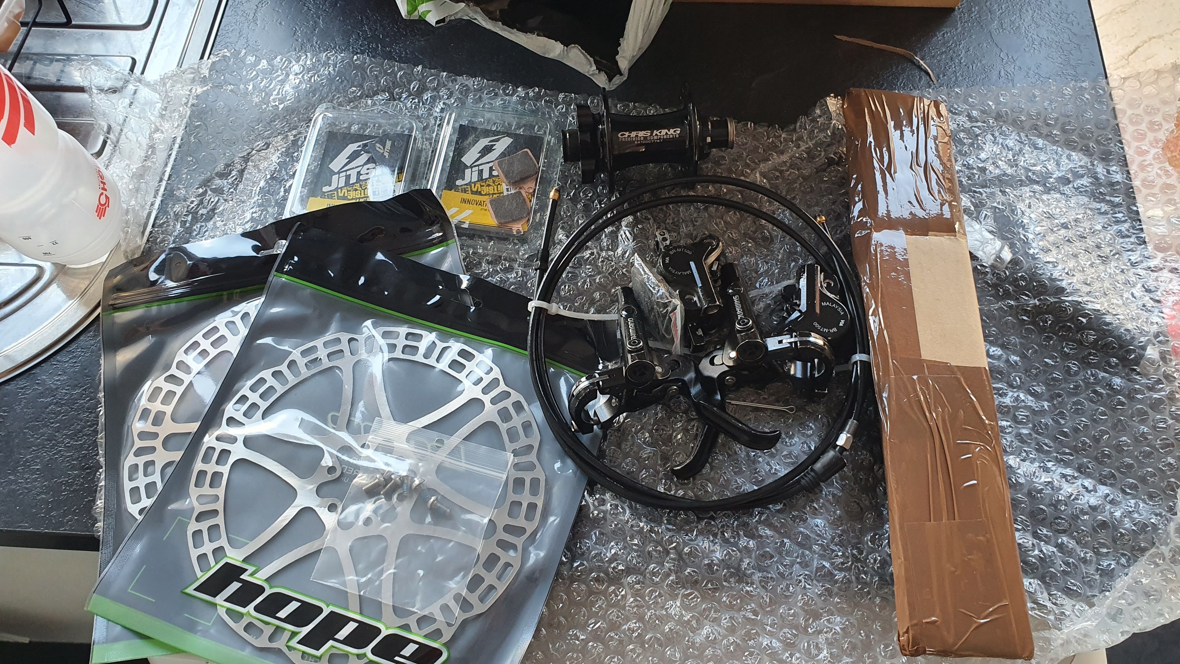

Sheco brakes, echo calipers and shimano levers with trialtech pads on the rear and 200mm hope V2 trials rotors

Fortunately I have already used an Echo caliper and shimano lever, it was nearly 10yrs ago on an Echo 24 I had and it was awesome!
With the new hope rotors and Trialtech/Jitsie pads I think it it will be good. Plus being IS mount they shouldn't break as easily as post mount brake calipers.

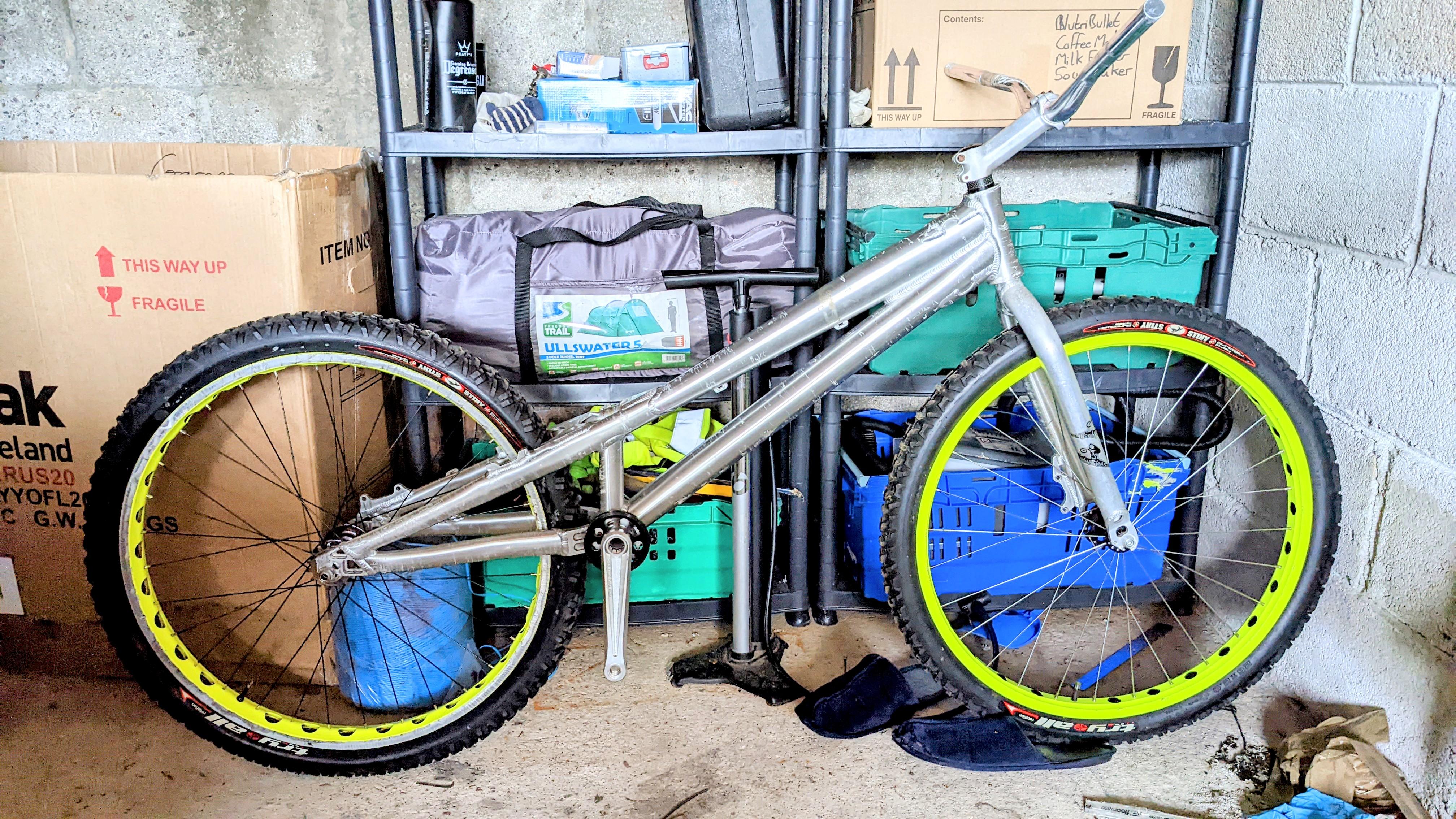

Slowly getting there, need to actually repair the frame at some point though.

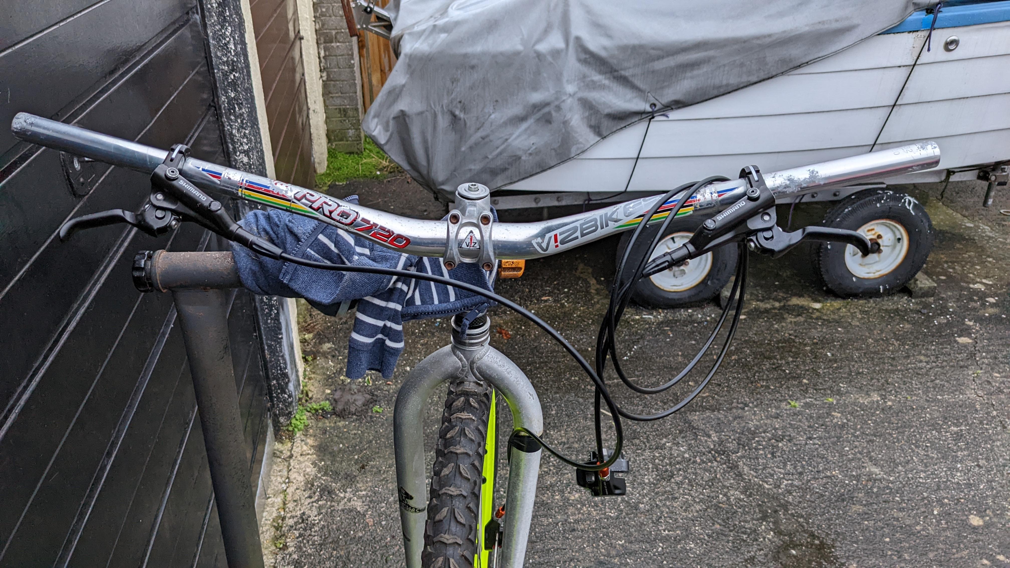

I have realised that after riding 800mm bars on my mtb for the past 3/4years, 720mm just doesn't cut it, going to need to find something wider.

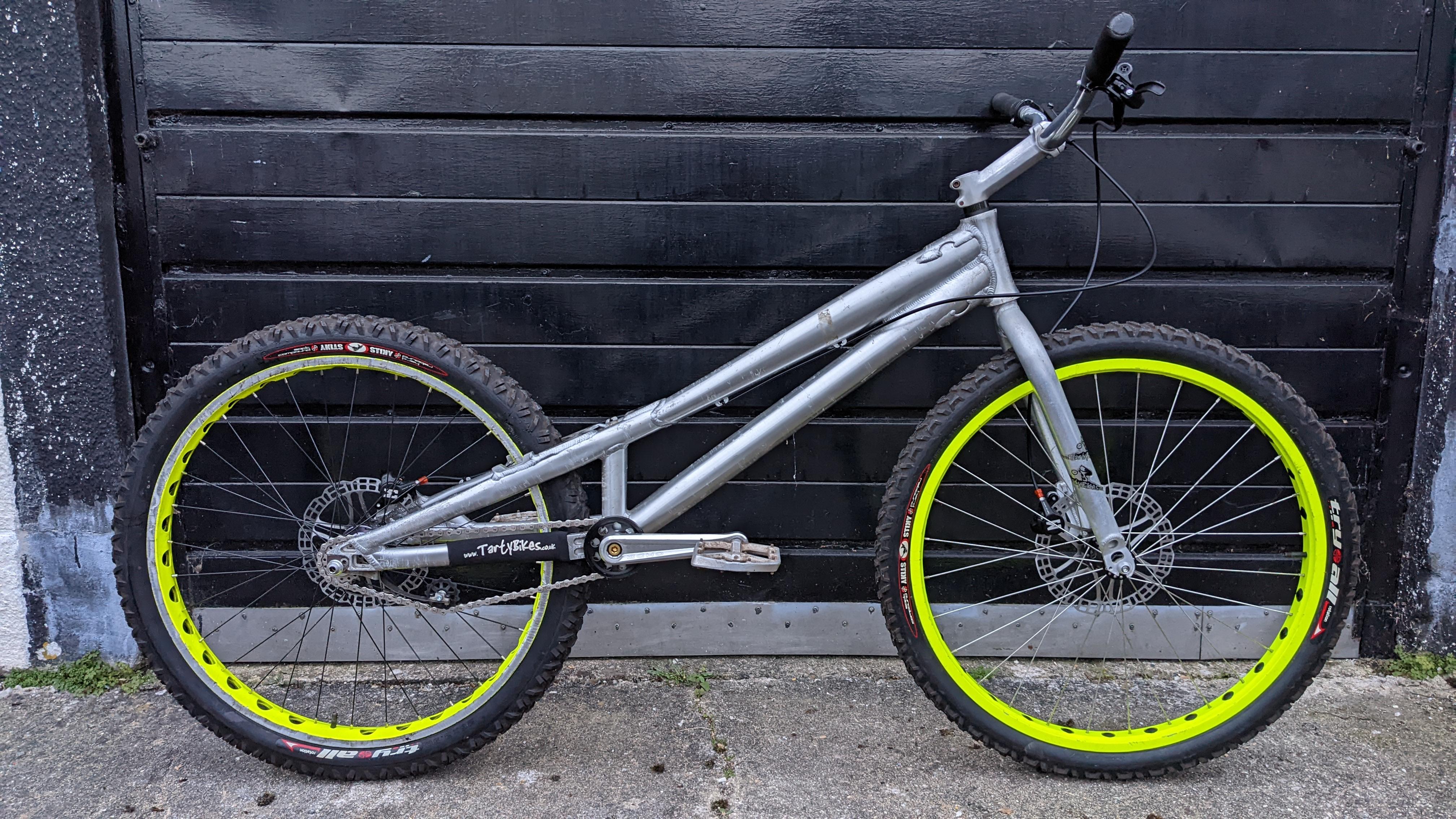

  On 1/19/2022 at 3:58 PM, Ross McArthur said:
Trying to imagine what that would feel like to ride. That geo. Those tyres. No grips. :tongue:
With the rear rim side wall repainted, that would look the ticket.
Expand
Like a proper trials bike Ross! I can't wait to get it finished and try to ride again.
Rear tyre does feel a little dead, but it will do for now, it's not like I will be going big.

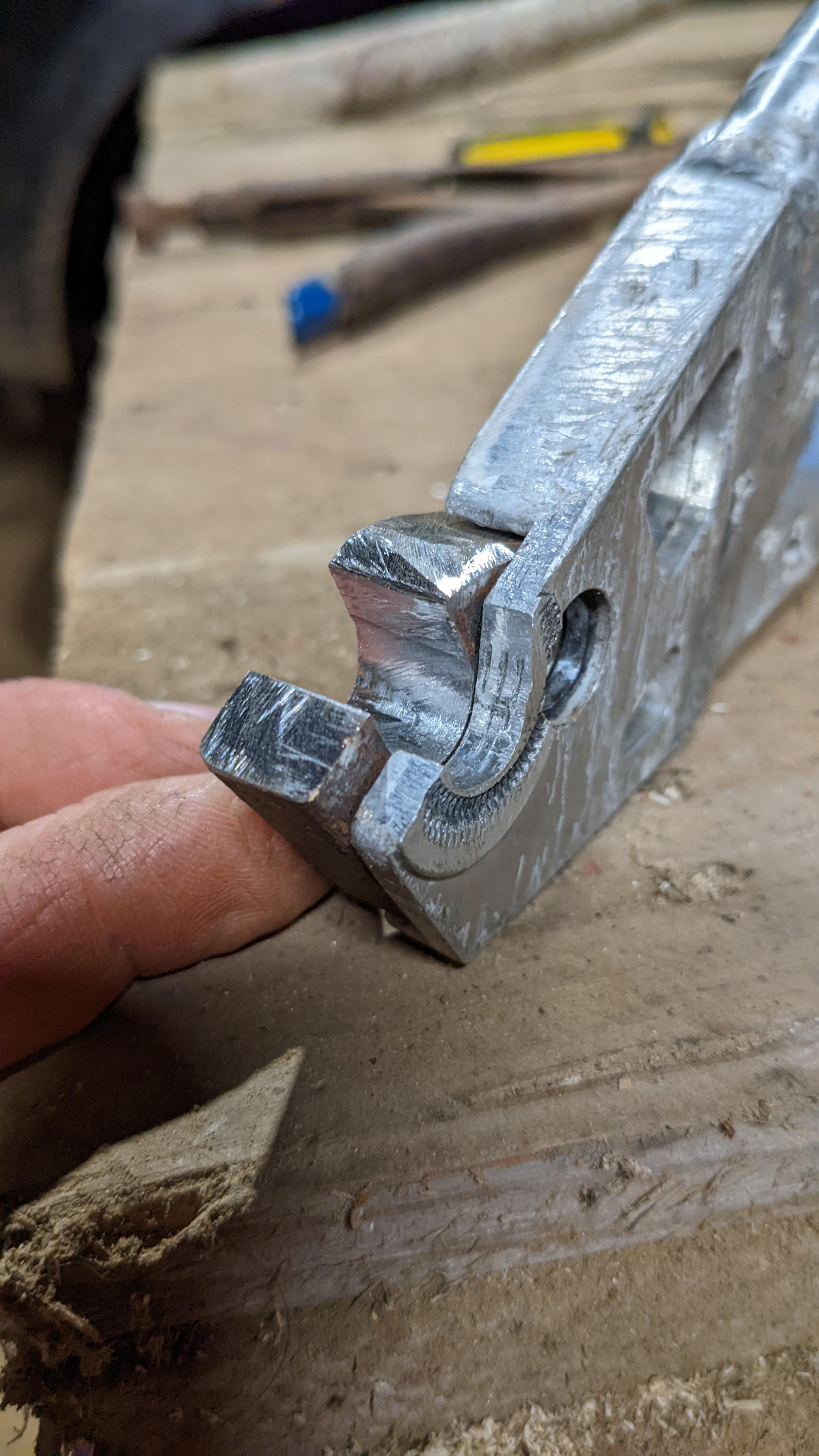

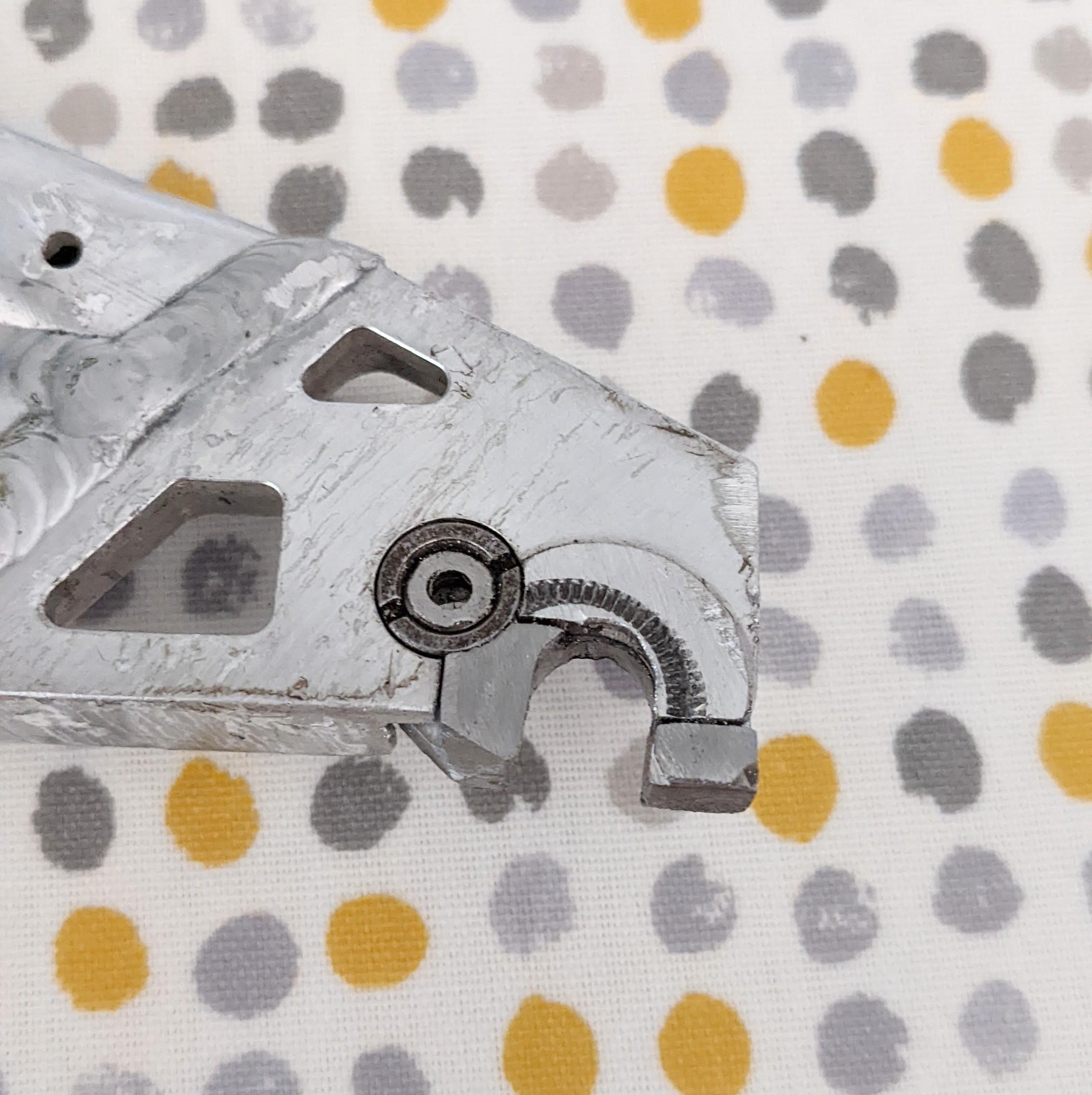

  On 1/20/2022 at 7:41 PM, Canardweb said:
Awesome engineering at that dropout!
Expand
Thanks! If I ever have the time to make a mk2 I might extend it forward under the dropout and include a mount for the sprung part of a trialtech tensioner.
Expand
That's a great idea. That would look like the dropouts of the Crewkerz frame I guess!

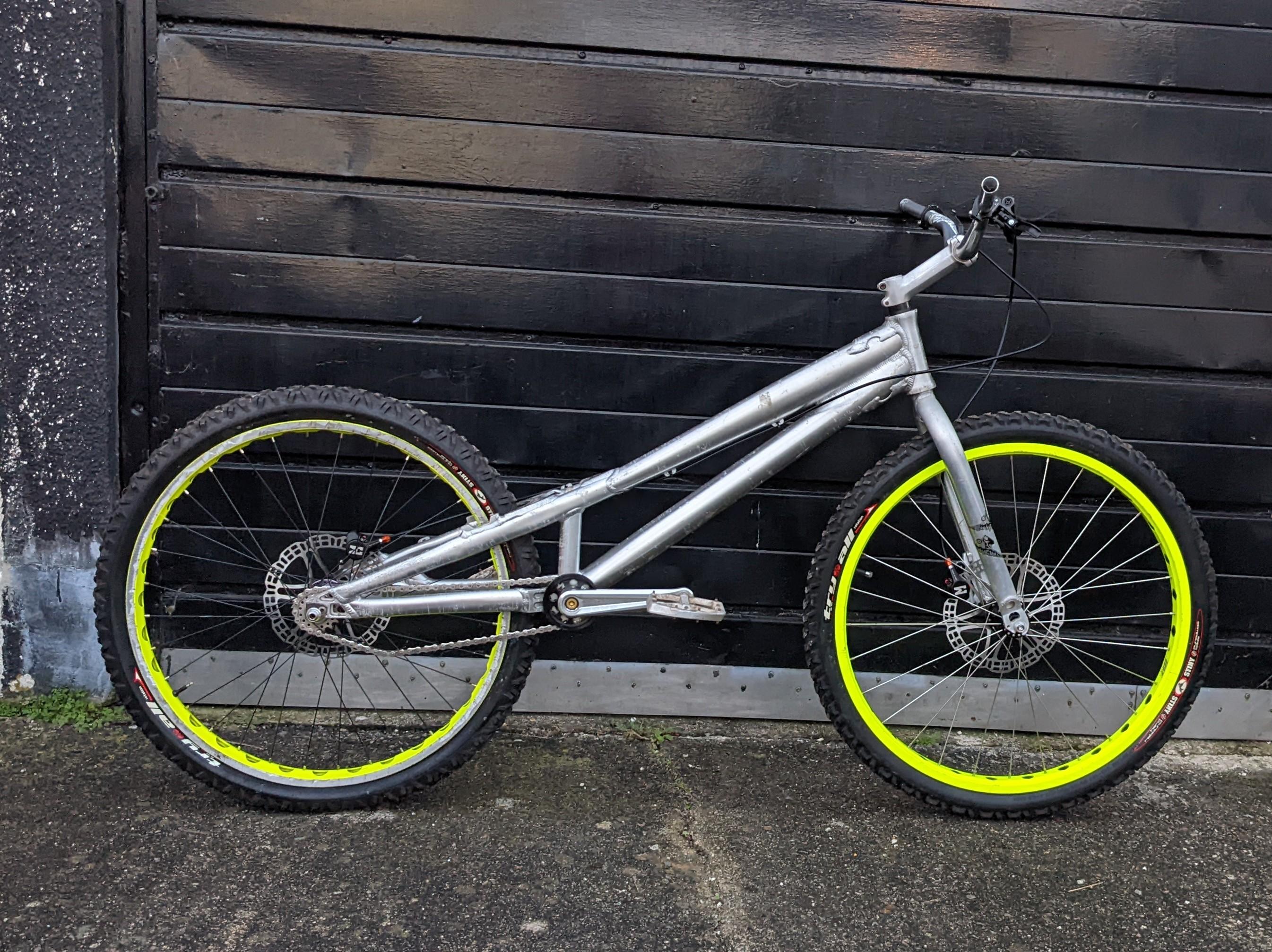

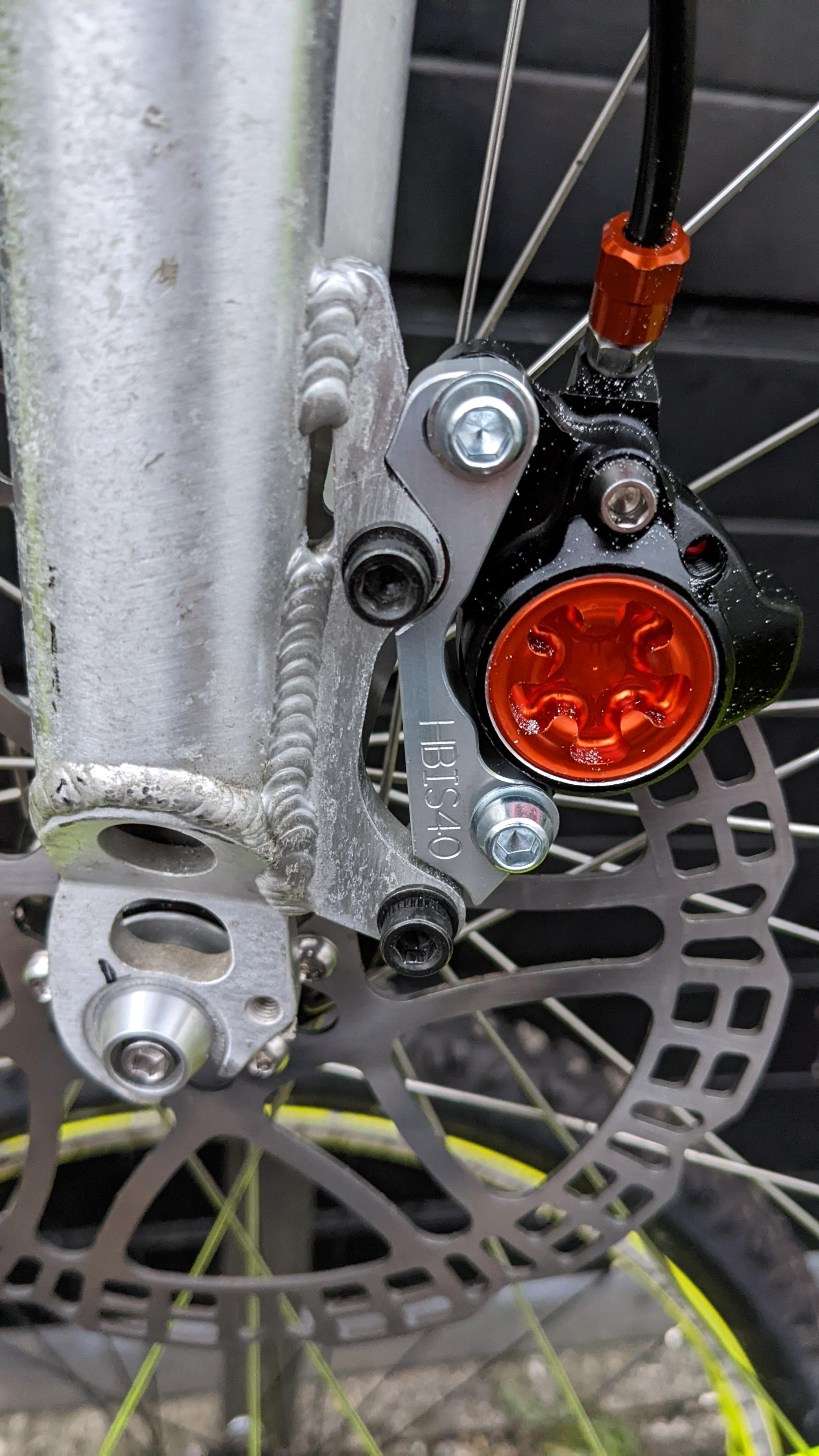

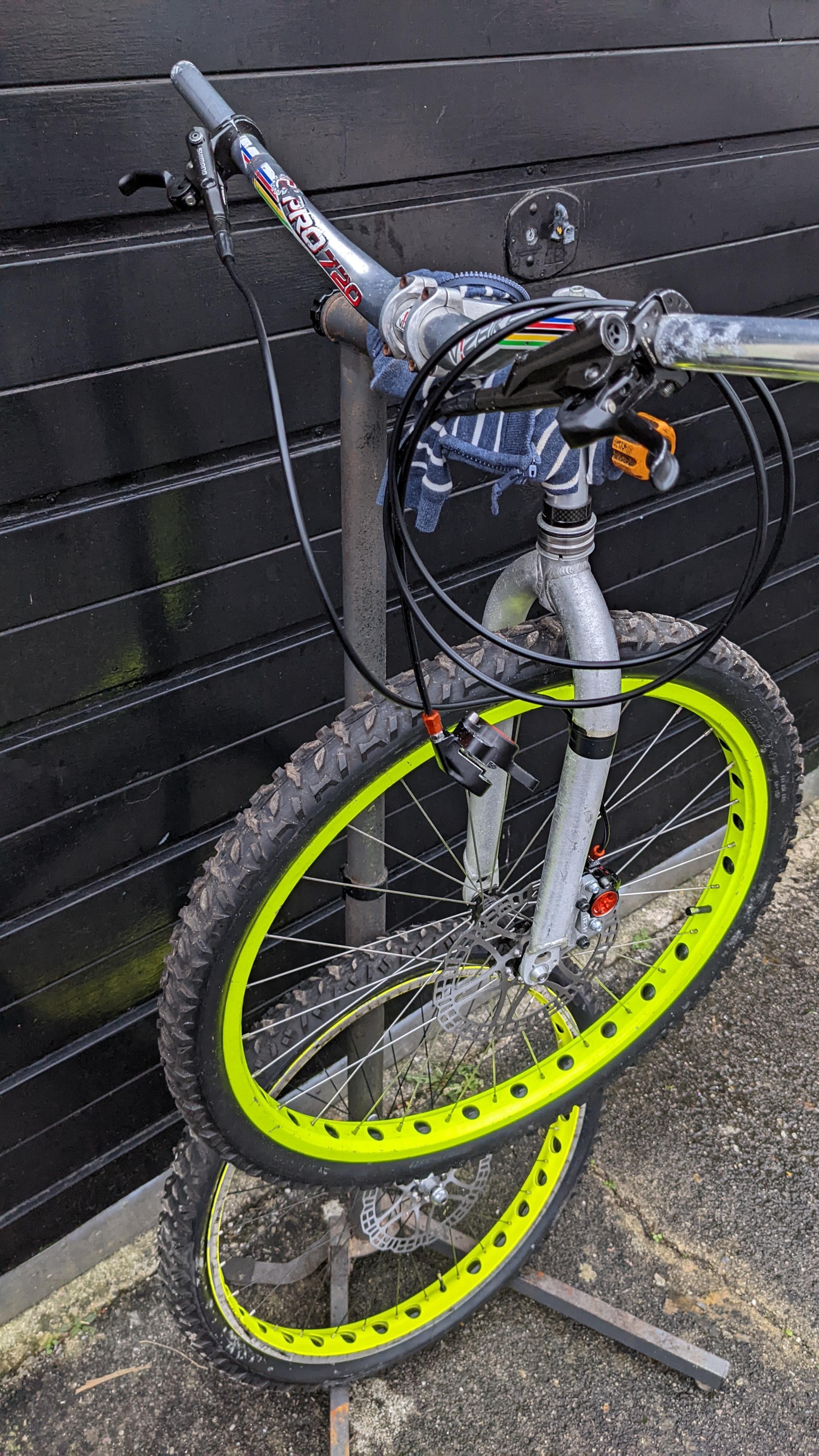

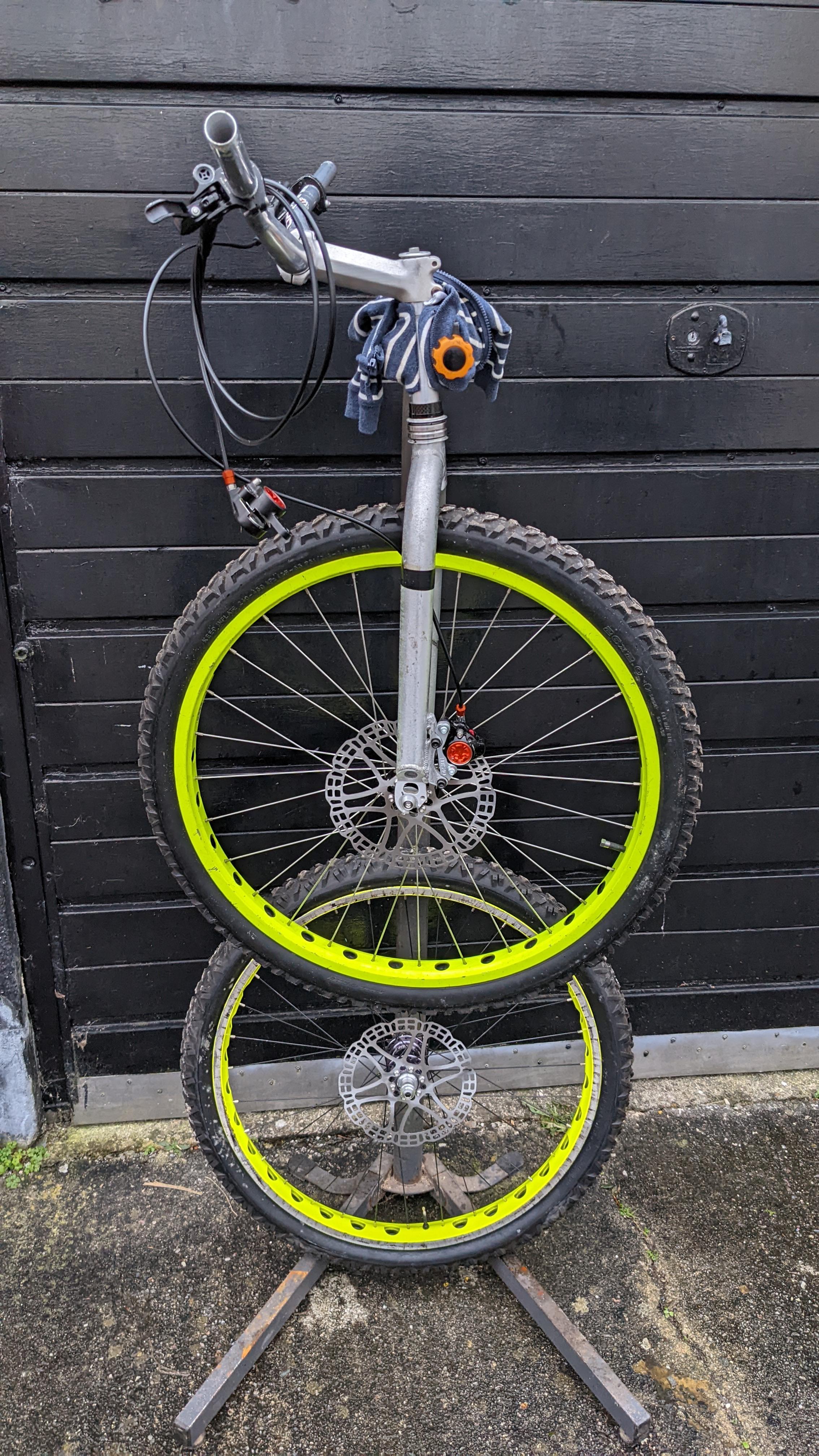

It's finally rideable (sort of, rear brake pads may be contaminated)
I was getting a chain skipping issue with the spoke tensioner, so knocked up a new one.
I just need to find the time to get out for a couple hours now. Its also going to benefit from a higher rise/longer stem at some point.
