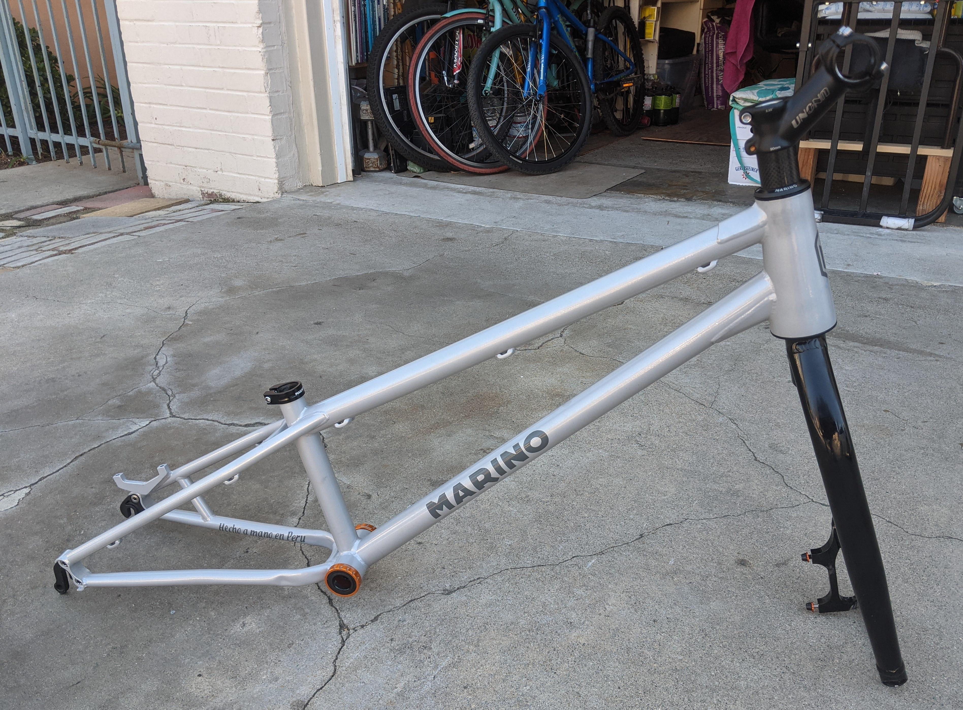

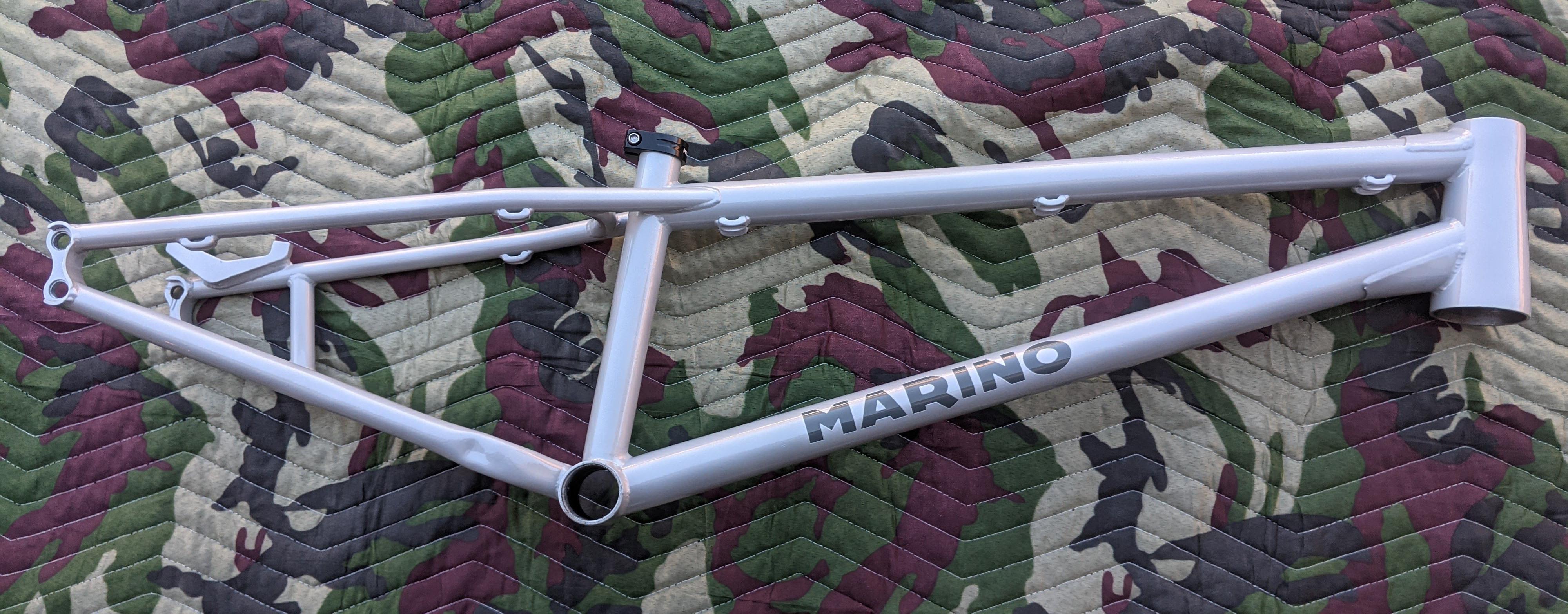

170 days! That's all it took from payment to delivery. The frame arrived unexpectedly on Tuesday (the tracking number never worked) and I've been slowly piecing it together ever since. PXL_20220225_190331362.thumb.jpg.a3a00b0c4d22dea4a40c1b329c0bb676.jpg

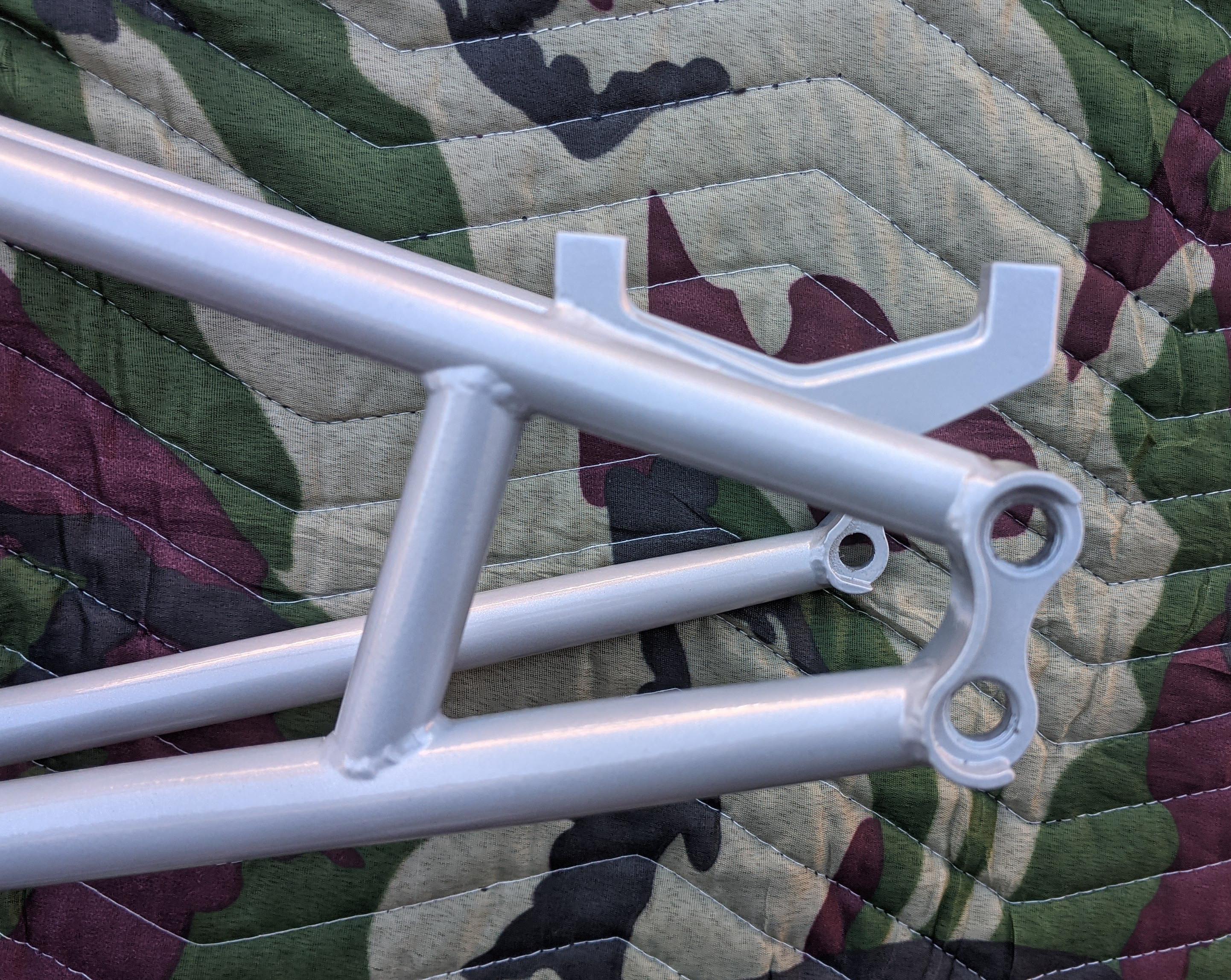

Not sure how long Marino's been doing this, but the frame has replaceable bolt on dropouts L & R so it can run vertical or horizontal dropouts. Hopefully a through axle option someday.PXL_20220225_190402373.thumb.jpg.ae1a81ee503ab53487ec9bd9aeea018a.jpg
Ironically I ordered the frame with a tapered headset, but I no longer have a tapered fork for it so for now it'll get a TMS straight fork.PXL_20220225_195126022.thumb.jpg.f3fbd8a642e53802c620e1723131a259.jpg
Edited by Swoofty
  • Like 1

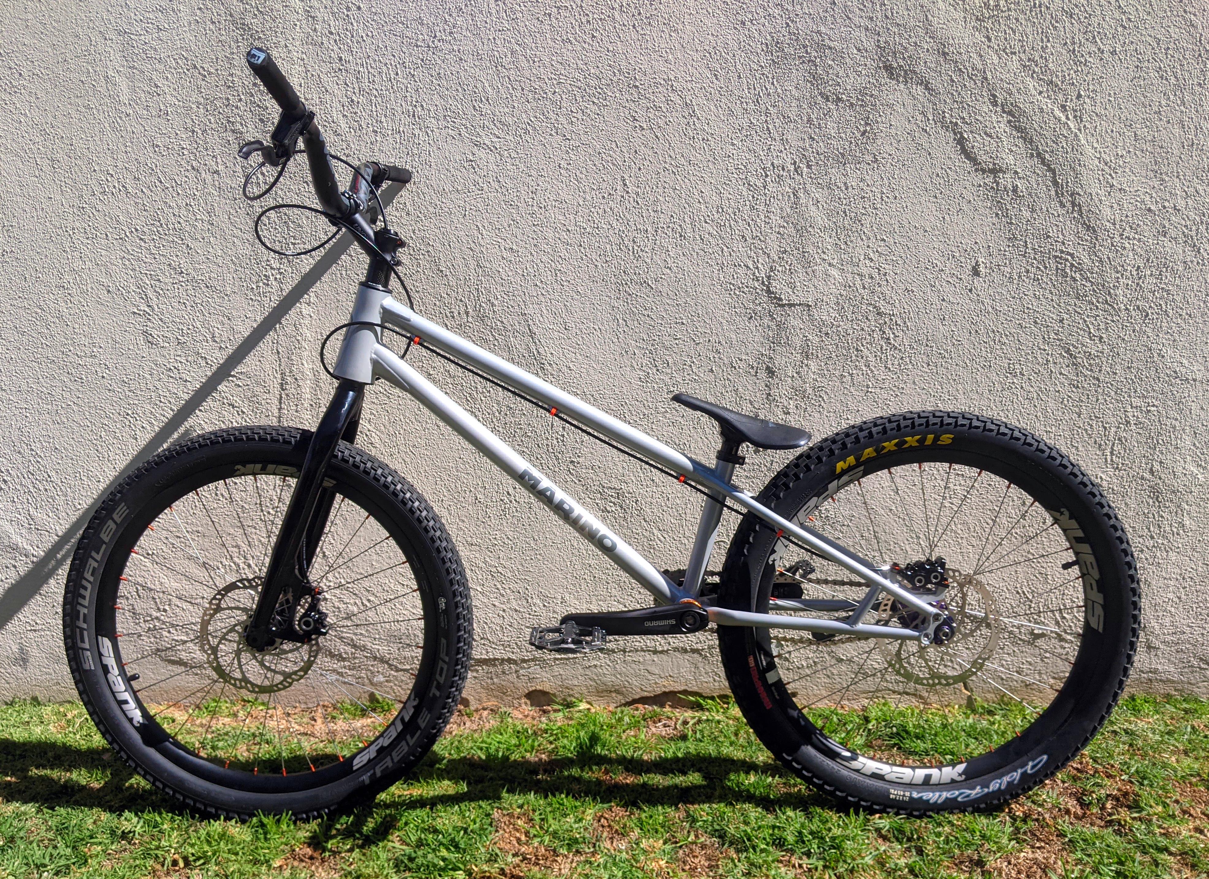

Here's the first build out. The numbers came out spot on. Wheelbase 1000mm, chainstay 360mm, frame weight 2730g.  I haven't tried to measure the BB height or the head angle yet.  Most everything is how I wanted it for this build except for the fork. And oh my god that fork! The bike is basically sidelined until I can replace the fork. The brake mount (post, naturally) is too close to the rotor and no caliper that I could find will slide far enough over not to rub.  I even filed the threads off the brake mount bolt so the caliper could slide over slightly farther, but to no avail. Thanks TMS :-(
  • Like 1
