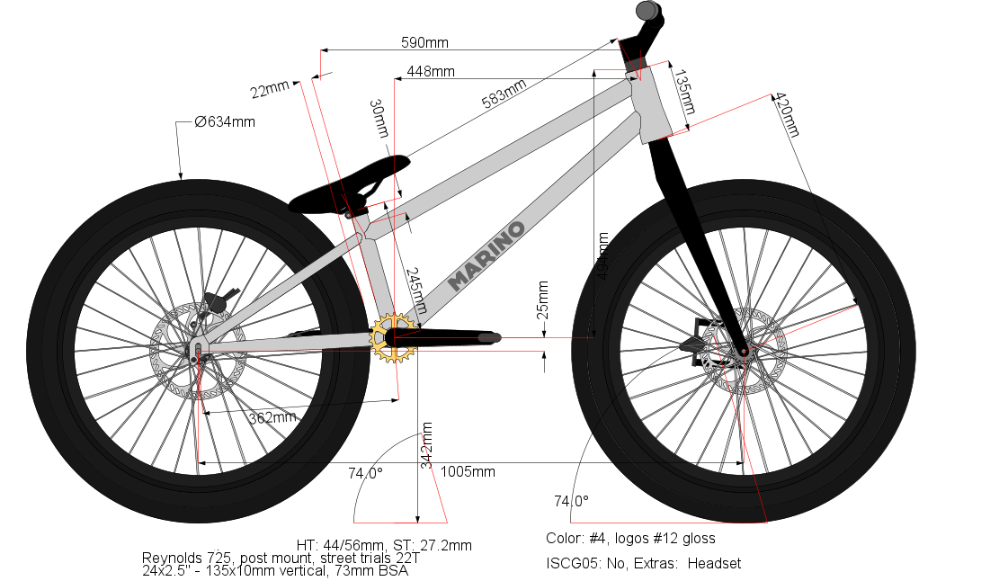

Swoofty Posted September 20, 2021 Report Share Posted September 20, 2021 So for no reason in particular, I decided to order a Marino. I'm still currently in love with my Crewkerz Guilty, but nothing lasts forever and it's nice to have a 'backup' bike. I'd been looking at the latest Silex bikes, but none of them were exactly what I wanted so, enter Marino. This will be my Marino build thread over the next however long it takes to get my frame from Peru. The design was finalized and deposit accepted on September 6th, 2021. The numbers are a little Arcade and a little Guilty, but I wanted tapered headset, vertical dropouts and 73mm BB. We'll see what I actually get. I'll keep updating as I go with bits and bobs that will go on the bike. Feel free to make suggestions or comments about my choices. 4 Quote Link to comment Share on other sites More sharing options...

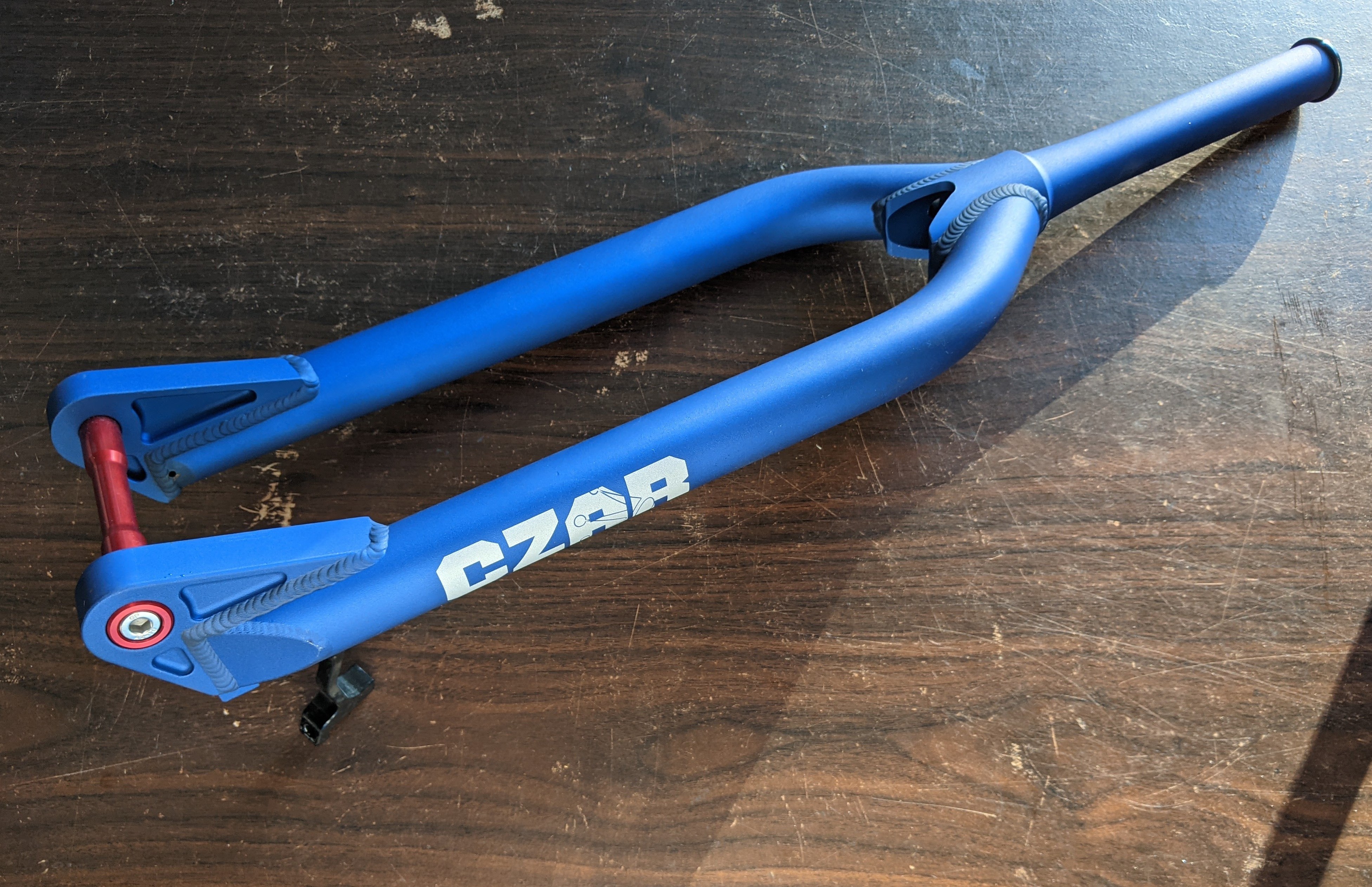

Swoofty Posted September 22, 2021 Author Report Share Posted September 22, 2021 The fork that I chose to design this bike around is the Czar 24/26 urban tapered fork. I've had a few of these forks now and I really like the way they feel. Plus, they were discounted on Tarty Bikes, but only in anodized blue. The frame should come from Marino in silver so this fork will have to get some rattlecan lovin in satin black. I'm feeling orange accents for the build, but I'm not sure what to do about the red 15mm through axle. It seems a little excessive to strip it and re-ano it in orange and painting it is probably not a good option. I'll probably leave it red until the end and hope it doesn't stand out too much. 1 Quote Link to comment Share on other sites More sharing options...
DJEHB Posted September 23, 2021 Report Share Posted September 23, 2021 Nice to see a build thread on the go! You can strip that anodising off in seconds with caustic soda and hot water. I'd at the least do that for the axle, but ideally the forks too before spraying them (blue battle scars coming through the paint might look a bit ugly). Quote Link to comment Share on other sites More sharing options...
uk24 Posted September 23, 2021 Report Share Posted September 23, 2021 Not sure i am sold on the forks.... those drop outs look chunky enough to do toothpick grinds on. 1 Quote Link to comment Share on other sites More sharing options...

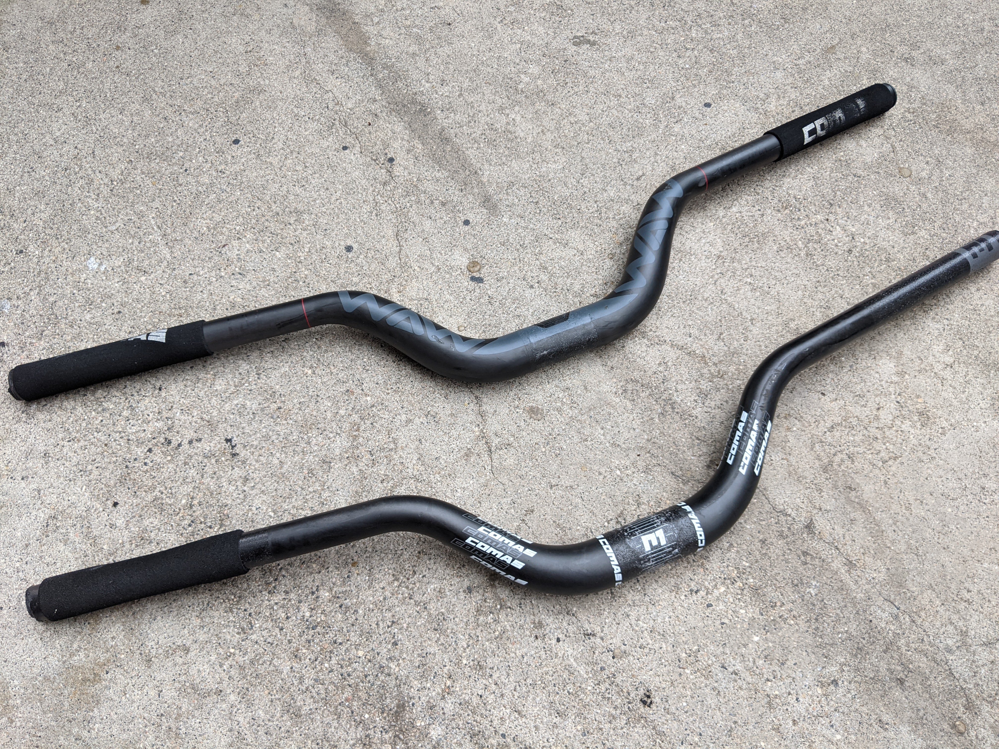

Swoofty Posted September 28, 2021 Author Report Share Posted September 28, 2021 (edited) The contenders for handlebars are the Crewkerz WAW carbon bar or the Comas carbon bar. I've run the Comas bars on my last 3 bikes and I think they're a perfect bar, BUT the WAW bar is stiffer so might feel better on a steel framed bike. The WAW will go on first for a look-see and the Comas will be the fall back. Edited September 29, 2021 by Swoofty Quote Link to comment Share on other sites More sharing options...

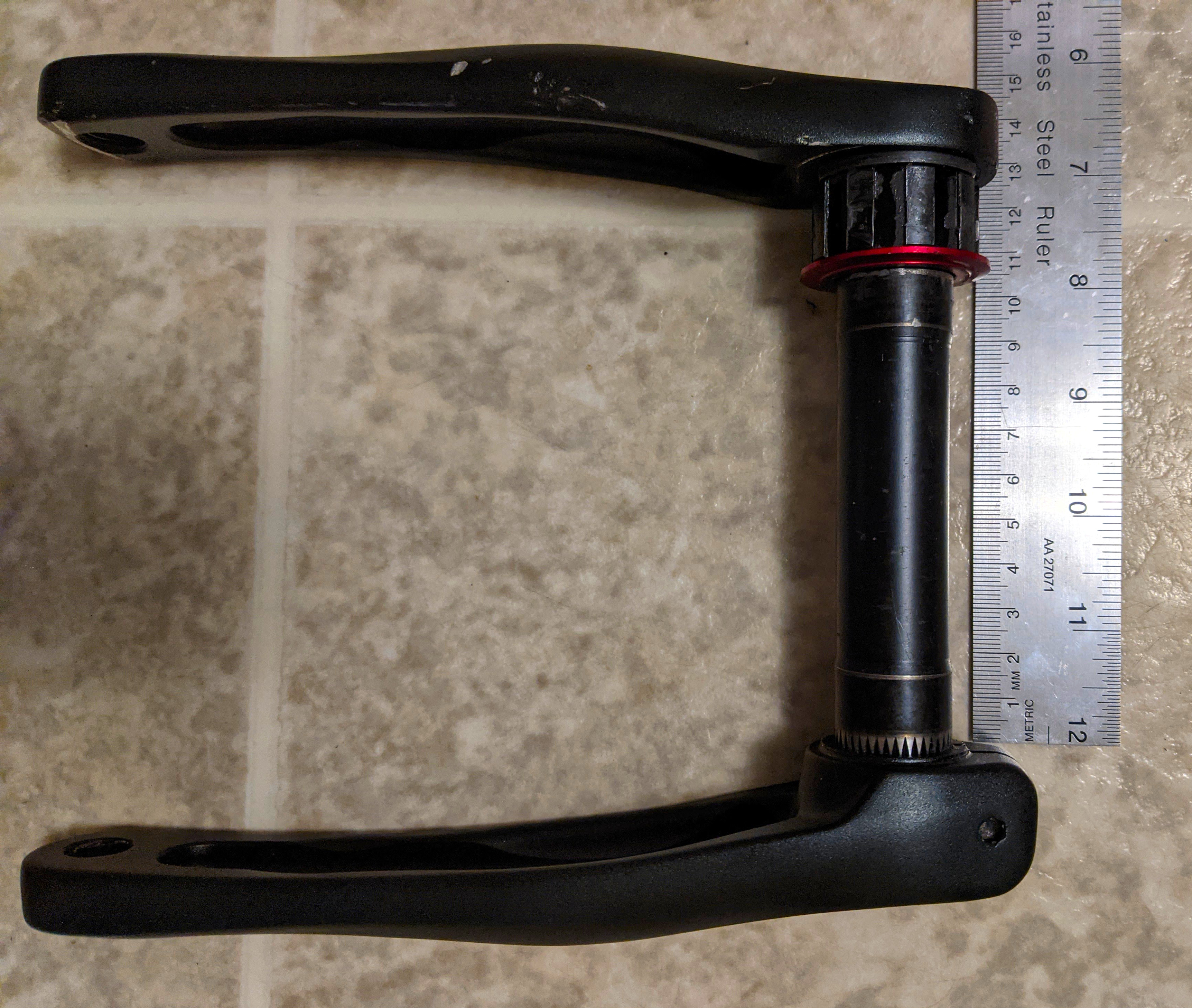

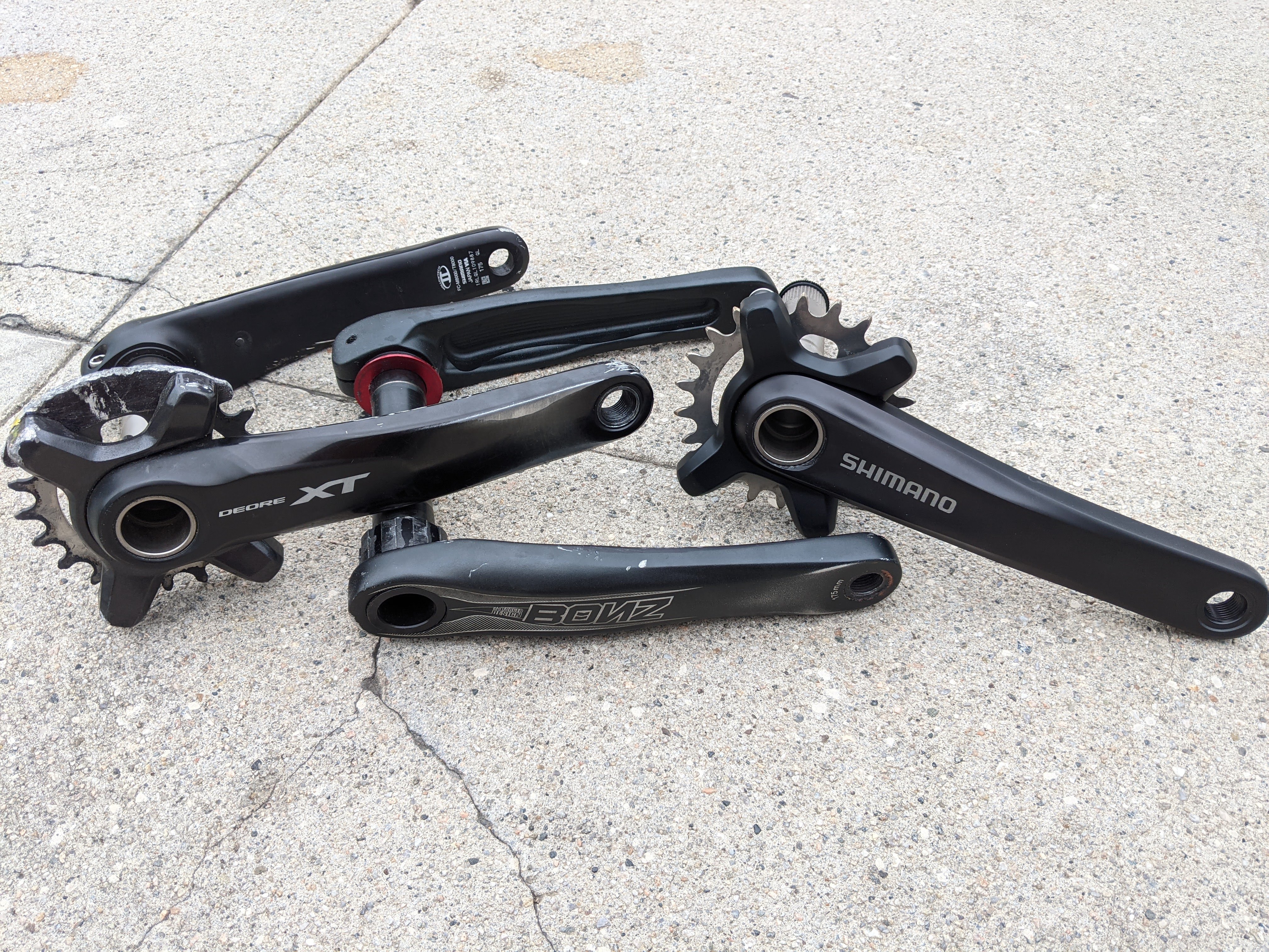

Swoofty Posted September 30, 2021 Author Report Share Posted September 30, 2021 In the crank department, it'll be some form of 24mm goodness. Shimano XT, Deore or Bonz splined (maybe 18t, maybe 22t). I've got a sweet Hope bottom bracket on the way too. Quote Link to comment Share on other sites More sharing options...
Vizla Posted October 3, 2021 Report Share Posted October 3, 2021 How wide is the Bonz spindle compared to the Shimano's 68/73mm MTB spindles? Have wondered if it's possible to fit the Bonz crankset onto an MTB frame with a 73mm wide bottom bracket. Quote Link to comment Share on other sites More sharing options...

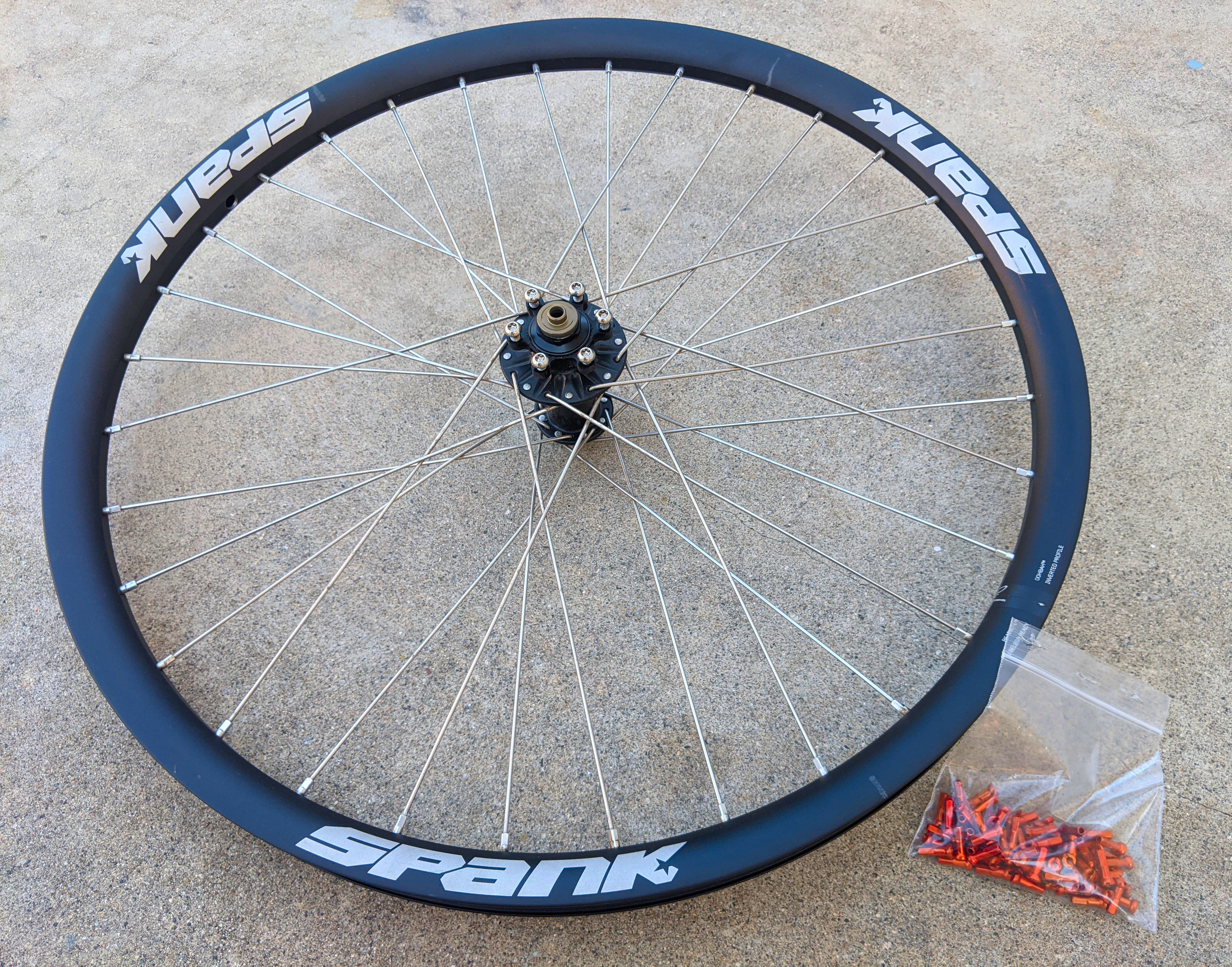

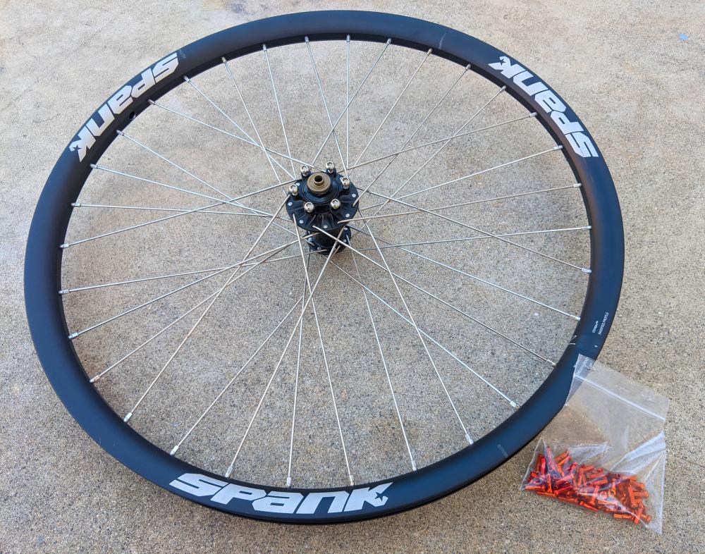

Swoofty Posted October 3, 2021 Author Report Share Posted October 3, 2021 The donor wheel for the front of this build will be my old wheel for the Crewkerz Guilty. Extralite Hyper JF hub to Spank Spike Race 33 rim, DT comp spokes. It just needs to be re-nippled with orange accents. Quote Link to comment Share on other sites More sharing options...
Swoofty Posted October 4, 2021 Author Report Share Posted October 4, 2021 On 10/3/2021 at 11:47 AM, Vizla said: How wide is the Bonz spindle compared to the Shimano's 68/73mm MTB spindles? Have wondered if it's possible to fit the Bonz crankset onto an MTB frame with a 73mm wide bottom bracket. Expand The Bonz is just shy of 100mm. I used it on my Guilty that has an 80mm+ bottom bracket shell. It should work no problem on a 73, you'll just need some spacers to fine tune it. The 2 problems I've found with the Bonz are that nothing but compression holds the freewheel/cog/bash on and the single pinch bolt on the non drive side is not really enough. I have a Bonz on my pure 26" bike and it's been fantastic, but I put a Shimano non drive arm on with 2 pinch bolts. The Bonz crank does unlock a lot of drive possibilities though. Quote Link to comment Share on other sites More sharing options...
Vizla Posted October 5, 2021 Report Share Posted October 5, 2021 Thanks for that dude. Yeah did wonder how everything was held in place seeing as there's no threads for a lockring or anything. As the preload from the compression bolt is about 1nm or less - is there play in the system between the freewheel/sprocket and bash moving under torque? With the single pinch bolt, did that just end up coming loose all the time leading to crank on spindle play or did you find another issue with it? Quote Link to comment Share on other sites More sharing options...
Swoofty Posted October 6, 2021 Author Report Share Posted October 6, 2021 I have the Bonz on my Ozonys Curve also and it has been flawless. For me the key was to replace the non drive side arm and it's been great ever since. I think since the BB is so wide on the Guilty there wasn't enough meat on the spindle for the other arm to hold onto. Quote Link to comment Share on other sites More sharing options...
Vizla Posted October 12, 2021 Report Share Posted October 12, 2021 It's interesting that the Guilty has a wider than normal BB. From the sounds of it, it has an 83mm shell like DH frames, correct me if I'm wrong. I wonder why? Maybe a wider crankset/spindle improves stability kinda like how wider rims offer more sidewall support on off-camber surfaces. Bonz cranks are on the shopping list - really curious how they will work out with a fixed 18t sprocket on a 1x10/11/12 drivetrain. Hopefully the non-drive crank won't have any issues with some blue Loctite on the pinch bolt thread, we'll see. If it has issues then I'll try your Shimano method For your custom Marino, is the mech hanger gonna be replaceable on the vertical dropouts or is it an integrated hanger like on old-school 90's steel frames? Looking forward to seeing updates! Quote Link to comment Share on other sites More sharing options...
