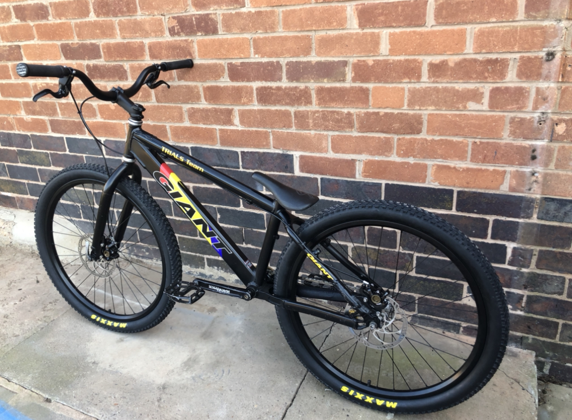

Private Repress Posted September 4, 2021 Report Share Posted September 4, 2021 I run an MT4 on the back of my giant trials team and it’s plenty powerful enough with great modulation. If you want that extra reassurance an MT5/7 will offer it. They seem to bite just that little bit more. I have a mixture of bikes, and run all three across them as rear brakes. 1 Quote Link to comment Share on other sites More sharing options...

Private Repress Posted September 5, 2021 Report Share Posted September 5, 2021 28 minutes ago, Lomani said: Txh for your answer. Which one disk you are use 180 or 203 on mt4? 180mm MT5 on the 26inch giant STP: (this has Shimano zee levers). 180mm MT4 on the 26inch giant trials team: 203mm MT trail sport on the 24inch Marino. I also run a MT7 on the rear of my 27.5inch enduro bike with a 203mm rotor. Of all the brakes, the MT trail sport is my favourite. They are sold as a pair, the front is 4 pot and the rear is 2 pot. I run them the opposite way around for more power at the rear and a lighter front end. I also run jitsie pads in the rear. Crucially though, I’m a relatively heavy lad, the mt4 on the giant trials team which I run a smaller rotor with bigger wheels works absolutely fine for me. Great modulation, lighter than a MT5/7 calliper and plenty enough bite to hold when the back wheel isn’t bang on a ledge / rail. It’s also running standard magura pads. A couple of questions to consider the answers to in helping you make a decision: 1. what type of riding are you doing? Natural, TGS or street. Or maybe a mix of all? 2. What bike are you looking to put the brake on? What size wheel? 3. If you are more than 15 stone I’d for an MT5 or 7. hope that helps Quote Link to comment Share on other sites More sharing options...

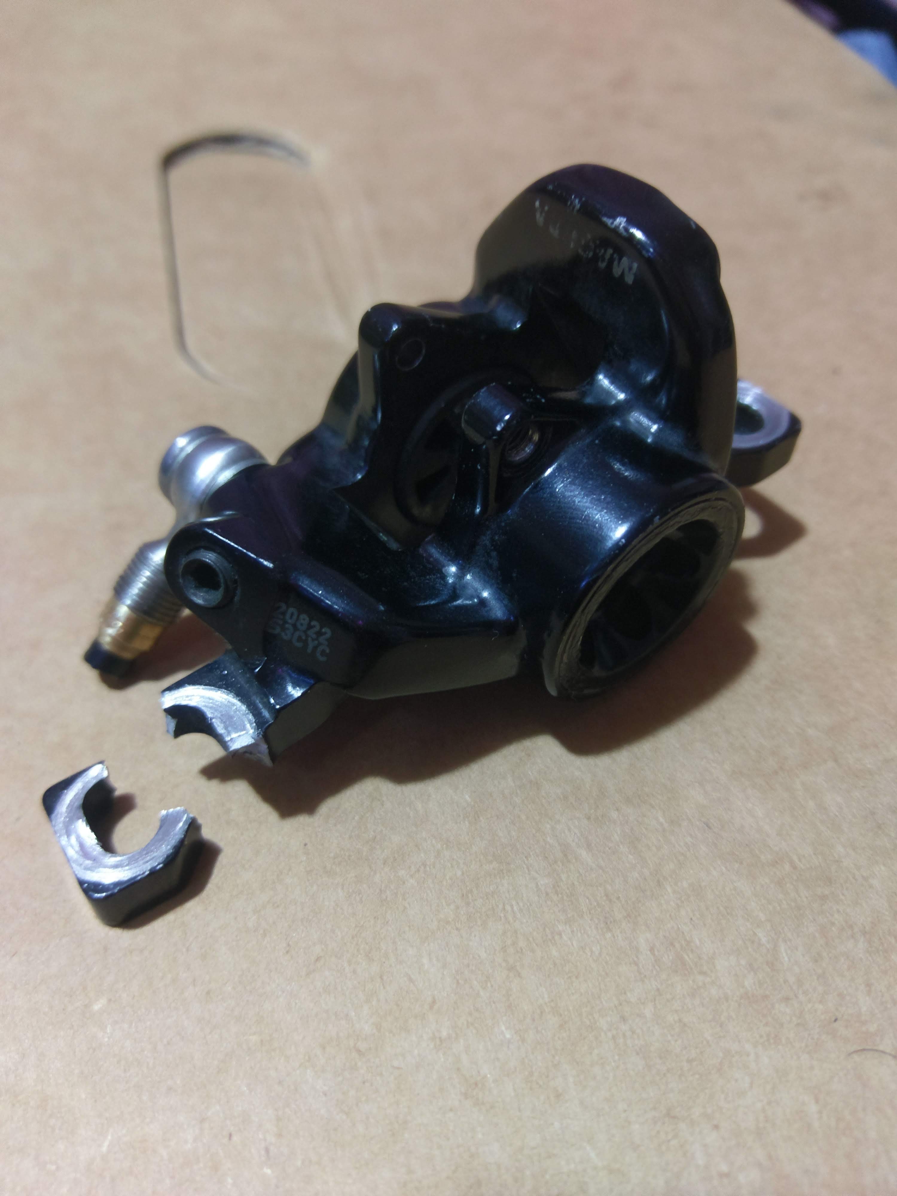

MaderaMark Posted September 6, 2021 Report Share Posted September 6, 2021 I run MT4 since 2018 and MT2 on front. So far 4 caliper adapter had been broken yet the caliper stays the same. Just using cheap metallic pads and power is massive for me. Quote Link to comment Share on other sites More sharing options...
Lomani Posted September 6, 2021 Author Report Share Posted September 6, 2021 10 hours ago, Private Repress said: 180mm MT5 on the 26inch giant STP: (this has Shimano zee levers). 180mm MT4 on the 26inch giant trials team: 203mm MT trail sport on the 24inch Marino. I also run a MT7 on the rear of my 27.5inch enduro bike with a 203mm rotor. Of all the brakes, the MT trail sport is my favourite. They are sold as a pair, the front is 4 pot and the rear is 2 pot. I run them the opposite way around for more power at the rear and a lighter front end. I also run jitsie pads in the rear. Crucially though, I’m a relatively heavy lad, the mt4 on the giant trials team which I run a smaller rotor with bigger wheels works absolutely fine for me. Great modulation, lighter than a MT5/7 calliper and plenty enough bite to hold when the back wheel isn’t bang on a ledge / rail. It’s also running standard magura pads. A couple of questions to consider the answers to in helping you make a decision: 1. what type of riding are you doing? Natural, TGS or street. Or maybe a mix of all? 2. What bike are you looking to put the brake on? What size wheel? 3. If you are more than 15 stone I’d for an MT5 or 7. hope that helps My bike 26 street trial, and weight 78kg. Quote Link to comment Share on other sites More sharing options...

MaderaMark Posted September 11, 2021 Report Share Posted September 11, 2021 After 3 years on me and maybe 5 on the first owner, my stupidity over torque wins.....hehehehe now on MT2 calipers with shimano deore levers... Quote Link to comment Share on other sites More sharing options...
