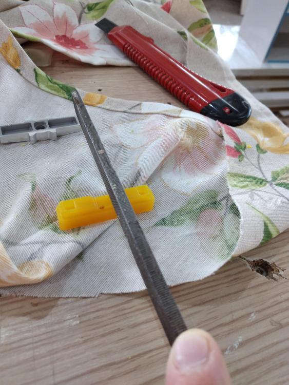

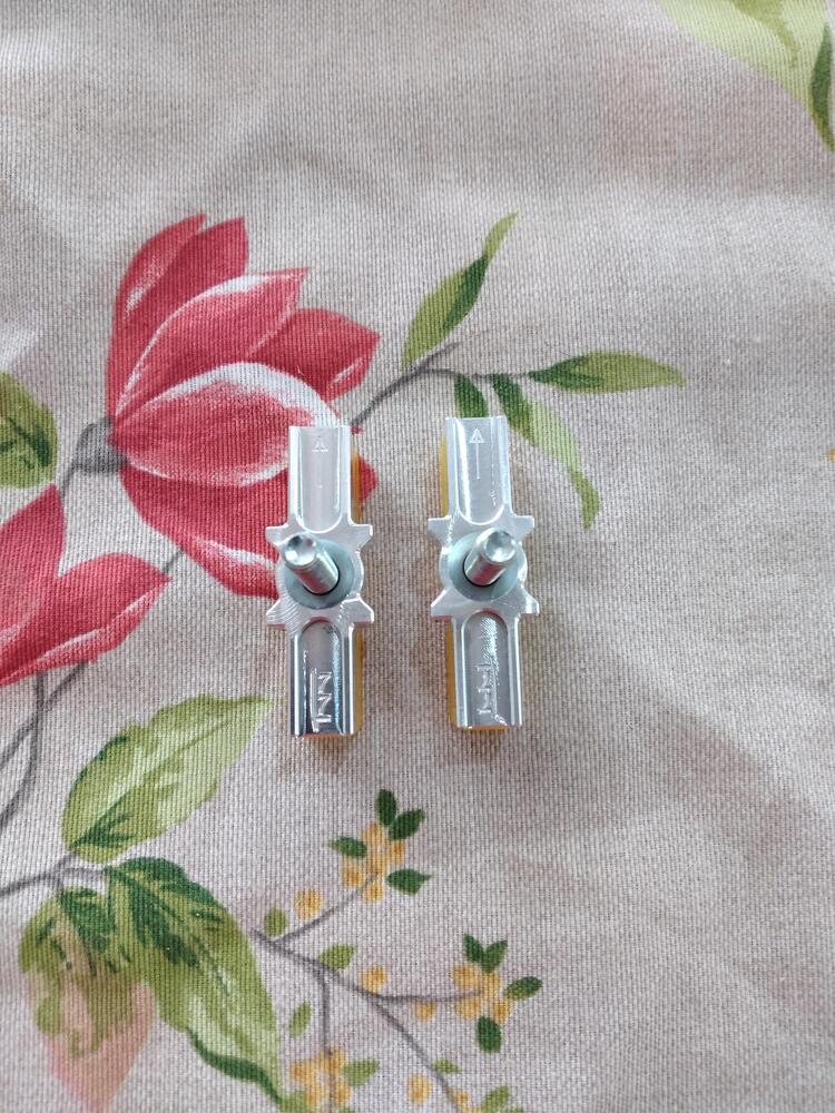

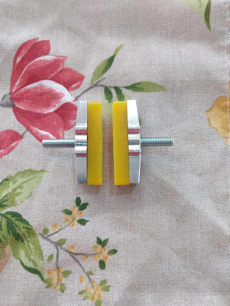

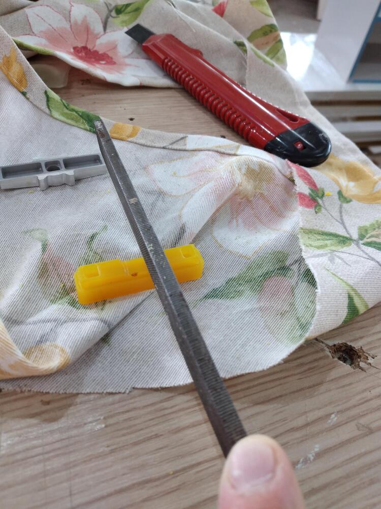

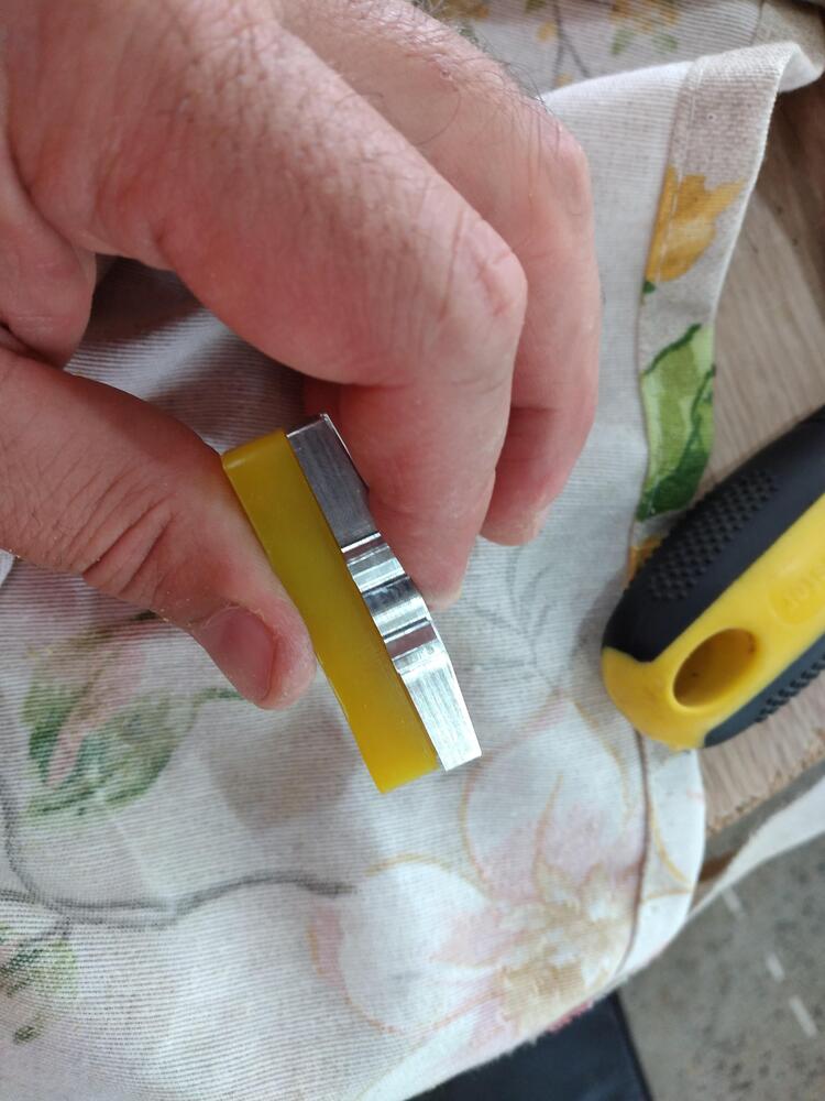

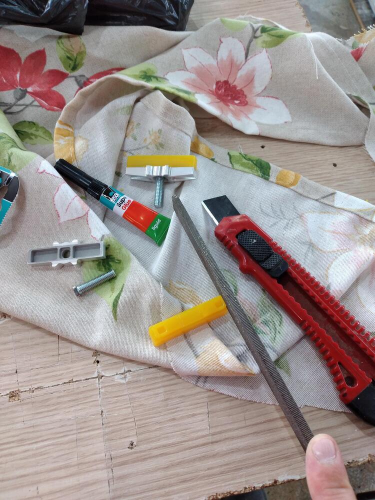

basstrials Posted May 25, 2022 Author Report Share Posted May 25, 2022 (edited) For retro lovers Edited May 25, 2022 by basstrials Quote Link to comment Share on other sites More sharing options...
Pokitren Posted May 27, 2022 Report Share Posted May 27, 2022 On 5/25/2022 at 10:18 AM, basstrials said: For retro lovers BP It looks very cool and thanks for the detailed manufacturing process. How did it turn out in practice? Does it ride well? 1 Quote Link to comment Share on other sites More sharing options...
basstrials Posted May 27, 2022 Author Report Share Posted May 27, 2022 Not tested them yet.Did read that they last very long on smooth rims like mine.I try to learn how to backhop now and soon as go to practice would try them and I am going to post here. Quote Link to comment Share on other sites More sharing options...
