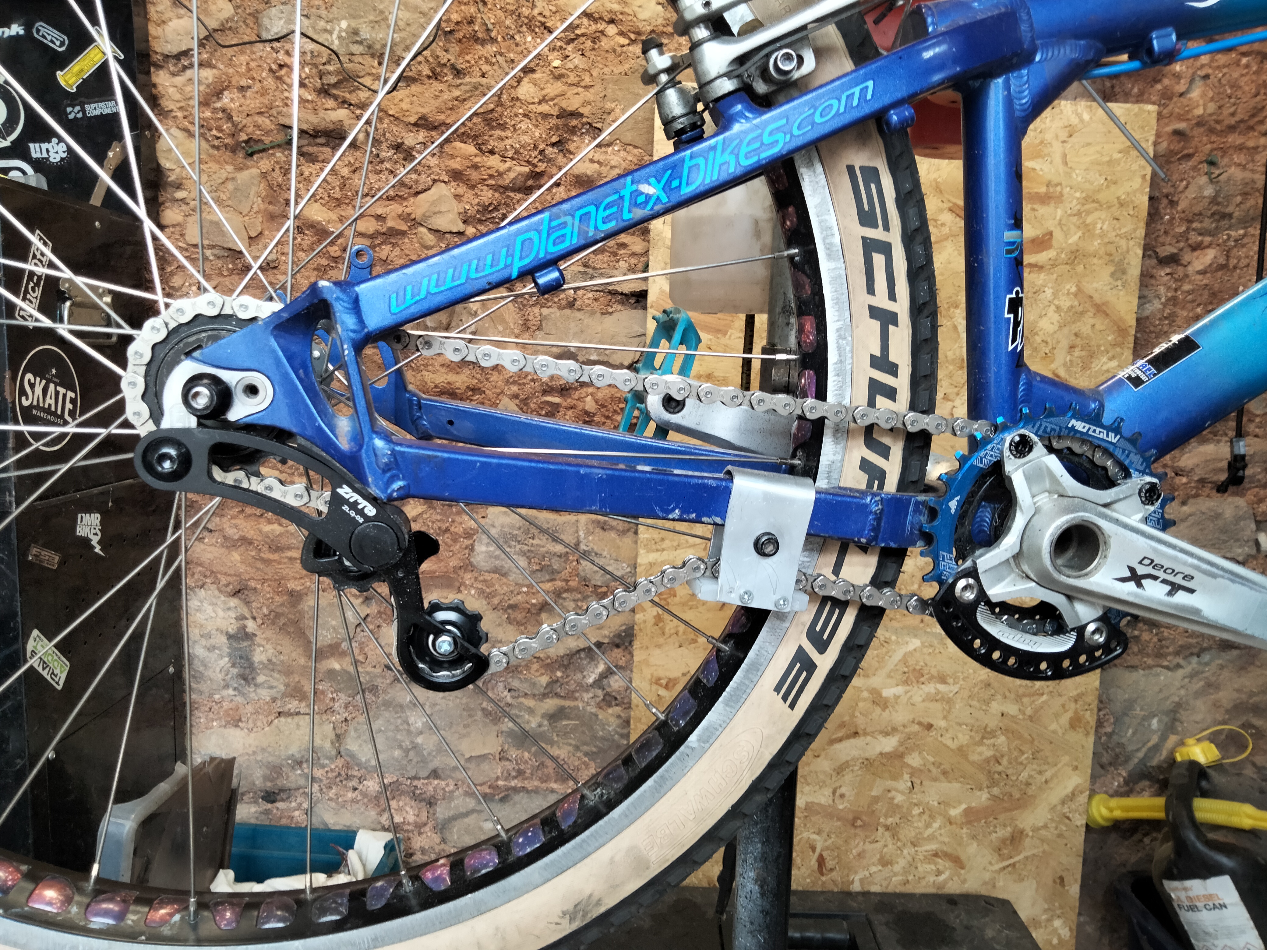

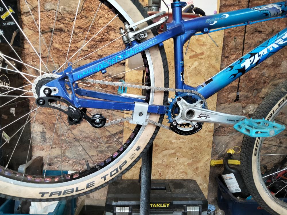

robkerly Posted September 1, 2021 Report Share Posted September 1, 2021 i mucked about with this idea on my old zebdi. ended up with a 2x front set up, with a half bash ring and a fairly chinesium tensioner. chain slap is obviously more than on a singlespeed tenioner setup as it needs more chain. a better tensioner would probably help a lot. i also fabricobbled a front chain device, mostly because a dcd wont fit the square chainstays. hope the pictures help if anybody wants to try it. Quote Link to comment Share on other sites More sharing options...
