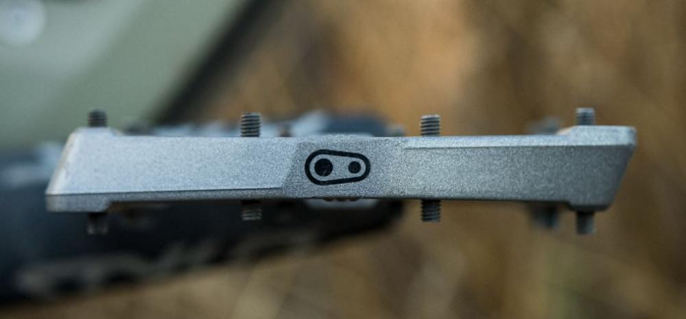

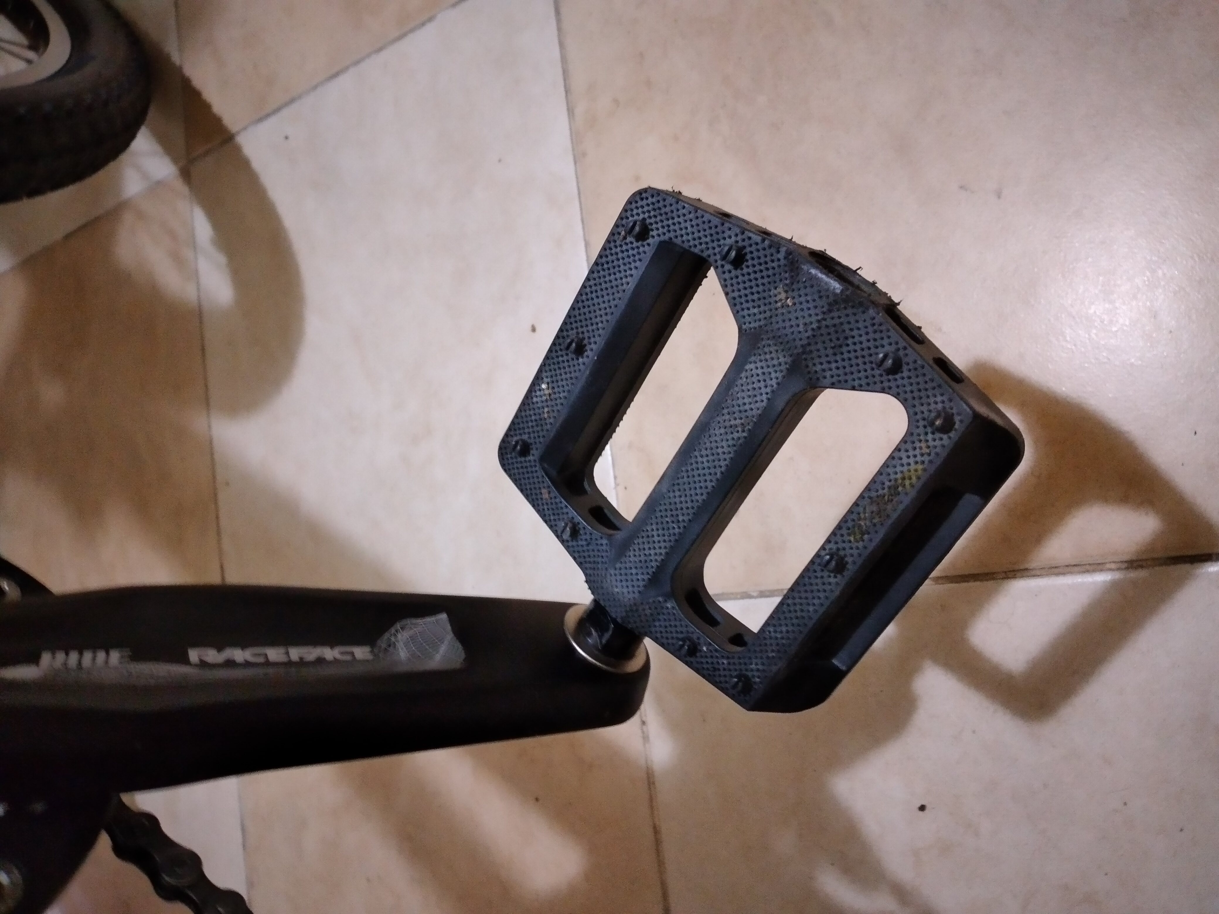

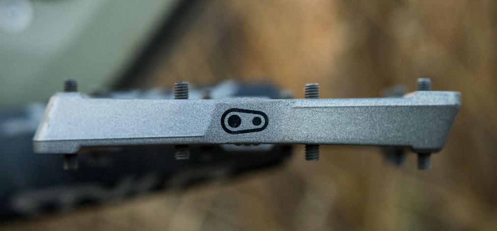

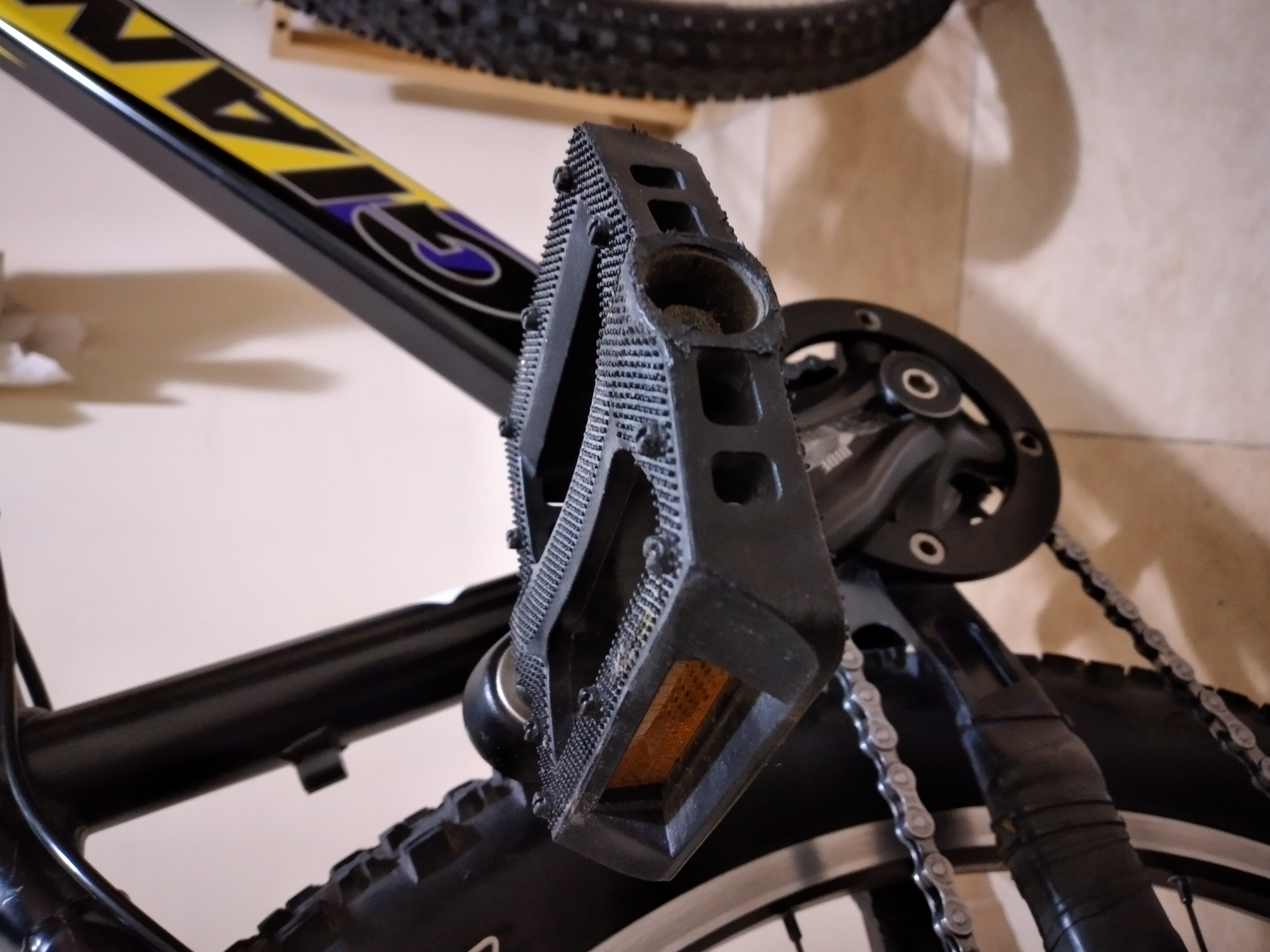

basstrials Posted June 15, 2021 Author Report Share Posted June 15, 2021 These HT looks similar shape to DMR V series,to me at least and i am sure that they are good.Four to five years of abuse from experienced rider like you says enough.I am going to take a look at these Crank's as well,looks very thin.Actually,i use nylon ones,cheap ones about 5GBP,recommended by friend(LBS owner) and surprisingly to me,they holds well for now,but i feel some fear that axles might break anytime i do bunnyhop .Steel use them because i learn to bail out when i losing balance point over back wheel on purpose and pins are not big,so i could safely jump backwards. I know that composite ones be supposedly tougher and all it is in my head.Here they are: Quote Link to comment Share on other sites More sharing options...
