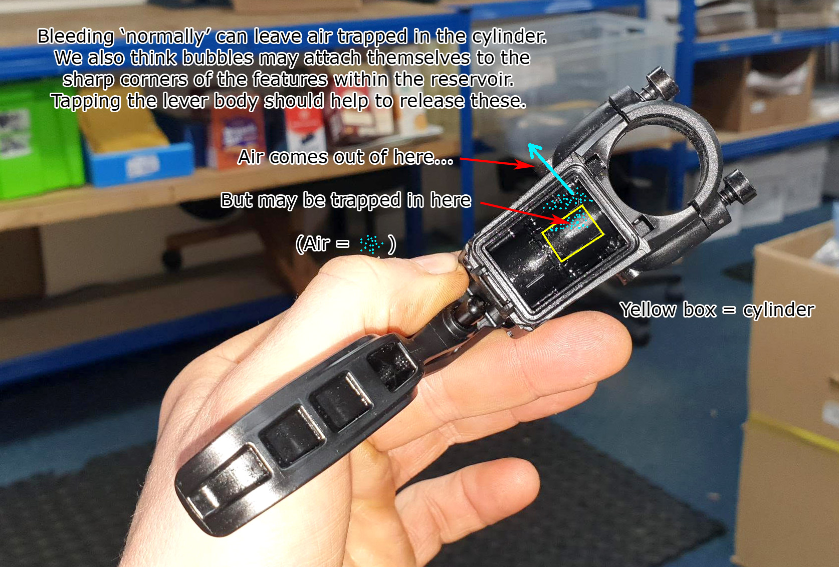

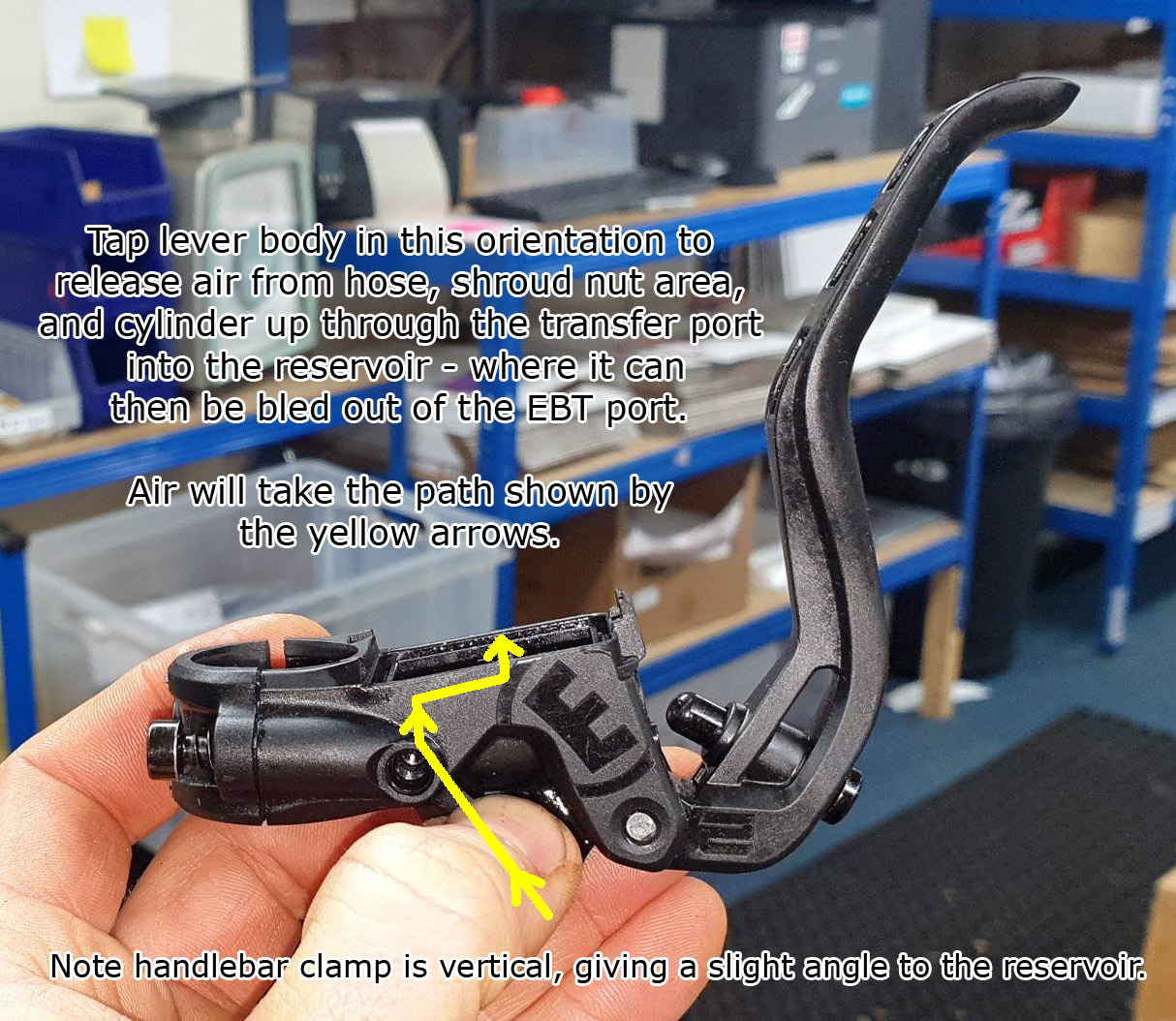

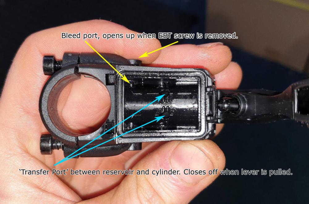

AdamR28 Posted May 22, 2021 Report Share Posted May 22, 2021 These are tricky to get right - even Magura can't do it. They can feel fine until you take the bike off road, or have a bail, or tip it upside down, when the trapped air is released and gets into the system. Hopefully the following images will help... 1 Quote Link to comment Share on other sites More sharing options...

JT! Posted May 22, 2021 Author Report Share Posted May 22, 2021 On 5/22/2021 at 5:58 PM, Adam@TartyBikes said: Hopefully the following images will help... Expand So are you suggesting a just take the lever off, hold it in this orientation, tap it, and then put the lever back on and done? Or should I do this then bleed again? Quote Link to comment Share on other sites More sharing options...
AdamR28 Posted May 22, 2021 Report Share Posted May 22, 2021 Orientate / tap as described while bleeding. 1 Quote Link to comment Share on other sites More sharing options...

AdamR28 Posted May 24, 2021 Report Share Posted May 24, 2021 If you look at the photos I posted above, you can see why a vacuum technique won't work very well (and hence took a couple of tries). 1 Quote Link to comment Share on other sites More sharing options...
