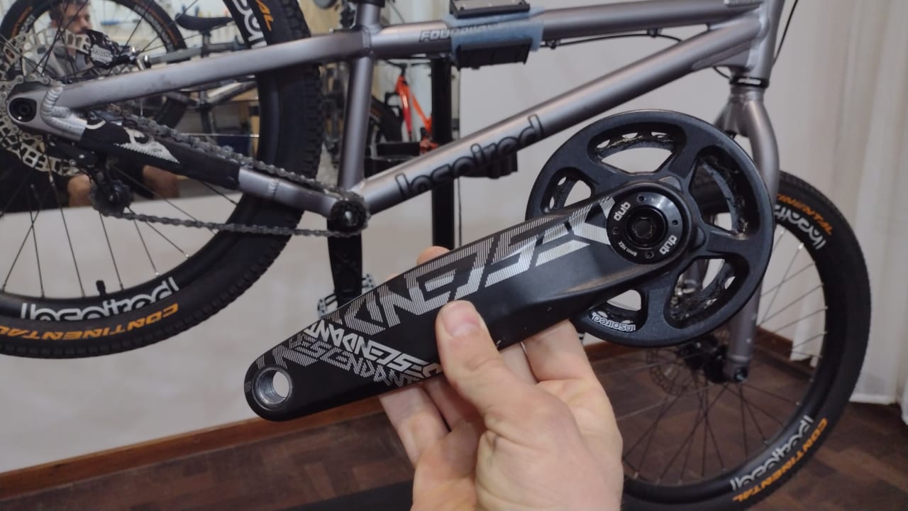

javimic Posted May 8, 2021 Report Share Posted May 8, 2021 Hello everyone! I recently damaged my crankset (almost cry) that I run on my fourplay (descendant truvativ 175mm with 22t - 16 gear ratio) The standard Fourplay Team 2020. Now I have to replace them and saw Duncan or Ali c run 170mm. I don't know what the point of view is. Does anyone know? Thanks in advance! Quote Link to comment Share on other sites More sharing options...

AdamR28 Posted May 9, 2021 Report Share Posted May 9, 2021 Is it just the pedal thread you have damaged? It can be repaired. This is your best option at the moment. 1 Quote Link to comment Share on other sites More sharing options...

javimic Posted May 9, 2021 Author Report Share Posted May 9, 2021 15 hours ago, Adam@TartyBikes said: Is it just the pedal thread you have damaged? It can be repaired. This is your best option at the moment. Adam! Nice to read you again. Unfortunately I damaged the thread on the crank arm. The pedal wasn't tightened enough and I didn't realize it in time. I didn't find repair kits like the one from Unior nor do I know if it's an option for Trials. The quickest option is to get a new crankset (here in Argentina it's the only compatible spare part of the whole bike. If I damaged another thing I had to contact Tarty once more -with pleasure-). In this case, I found the Sram GX Eagle to replace the beloved Truvativ Descendant 7k ... Quote Link to comment Share on other sites More sharing options...

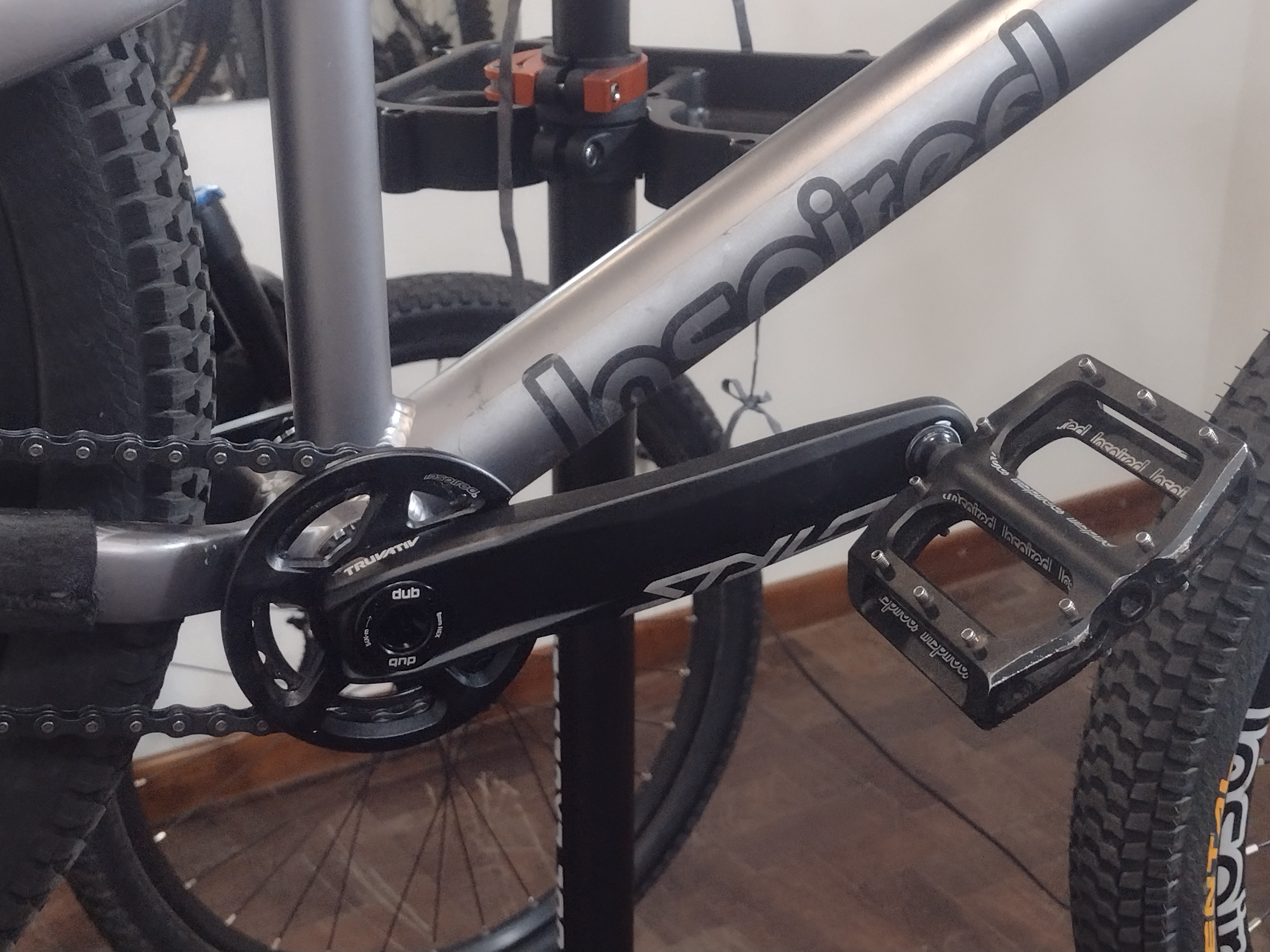

javimic Posted May 20, 2021 Author Report Share Posted May 20, 2021 bueno ... finalmente pude conseguir un par de bielas truvativ stylo dub de 175 mm ... no son muy populares en las pruebas pero se ven bien y van perfectamente ... gracias a todos por los comentarios. Quote Link to comment Share on other sites More sharing options...
