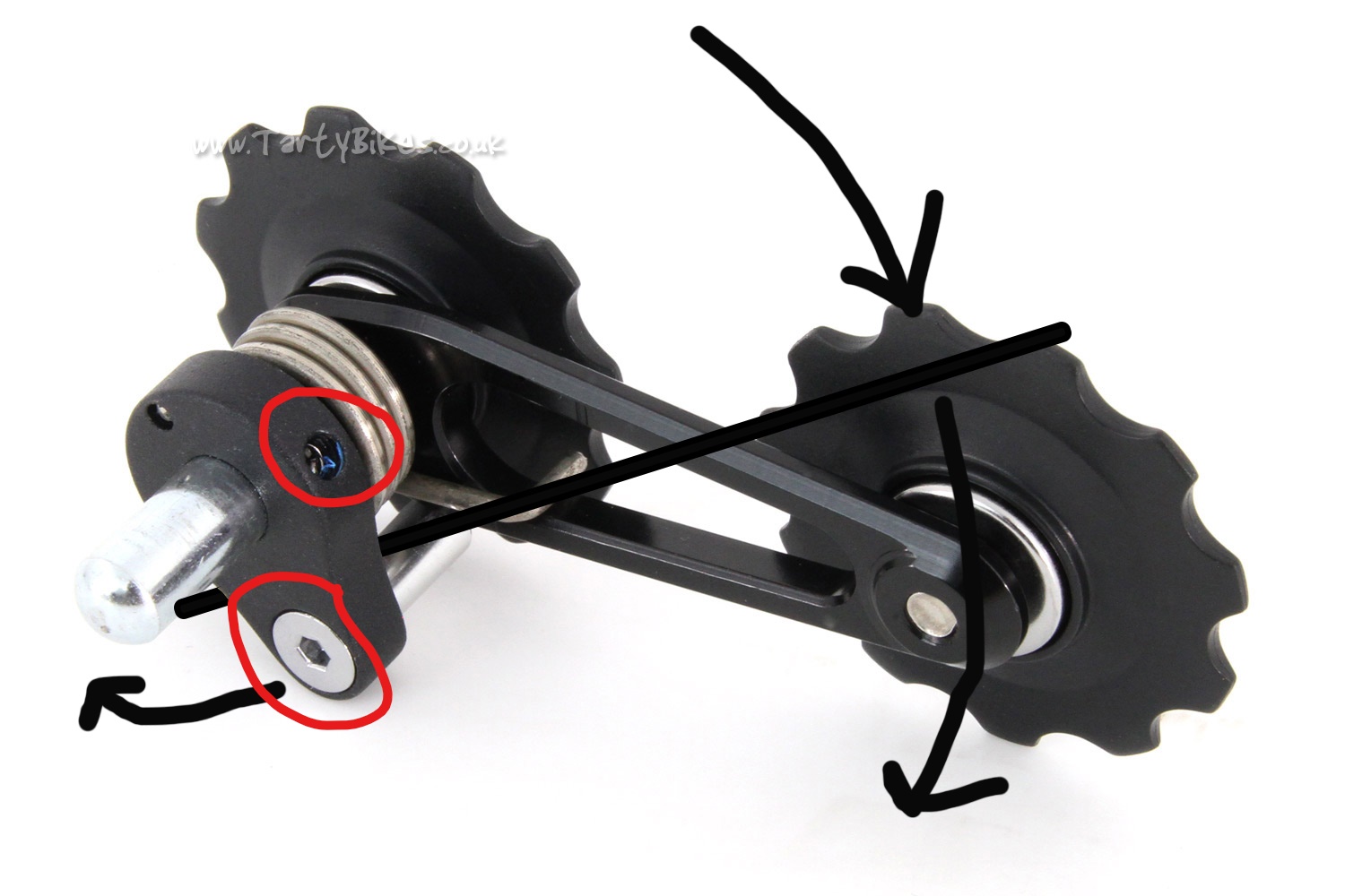

Richie612 Posted April 18, 2021 Report Share Posted April 18, 2021 Hello guys another tensioner question . Since taking a link out of the chain so it wasn't as loose I've encountered another issue with the tensioner (Trialtech). The instructions via the Inspired booklet is pretty vague on the adjustment. My issue is when I use the bike for a short while the chain goes slack again. The source of the problem is the spring tension. When I push on the lower jockey wheel so it moves closer to the Chainstay (as you do to remove the chain) there isn't much force applied to the chain when I release the jockey wheel resulting in the chain going slack again. I know the spring tension needs to be increased but I'm buggered on how to do it. Rich Quote Link to comment Share on other sites More sharing options...
ben_travis Posted April 18, 2021 Report Share Posted April 18, 2021 From the picture you posted in the other topic you just need to rotate the tensioner around a little bit. 1. take the chain off 2. undo pinch bolt that holds the steel rod 3. rotate tensioner as far back as it can go 4. re-tighten pinch bolt 5. re-fit chain 6. ride, be happy, no more tensioner topics ;-) 2 Quote Link to comment Share on other sites More sharing options...

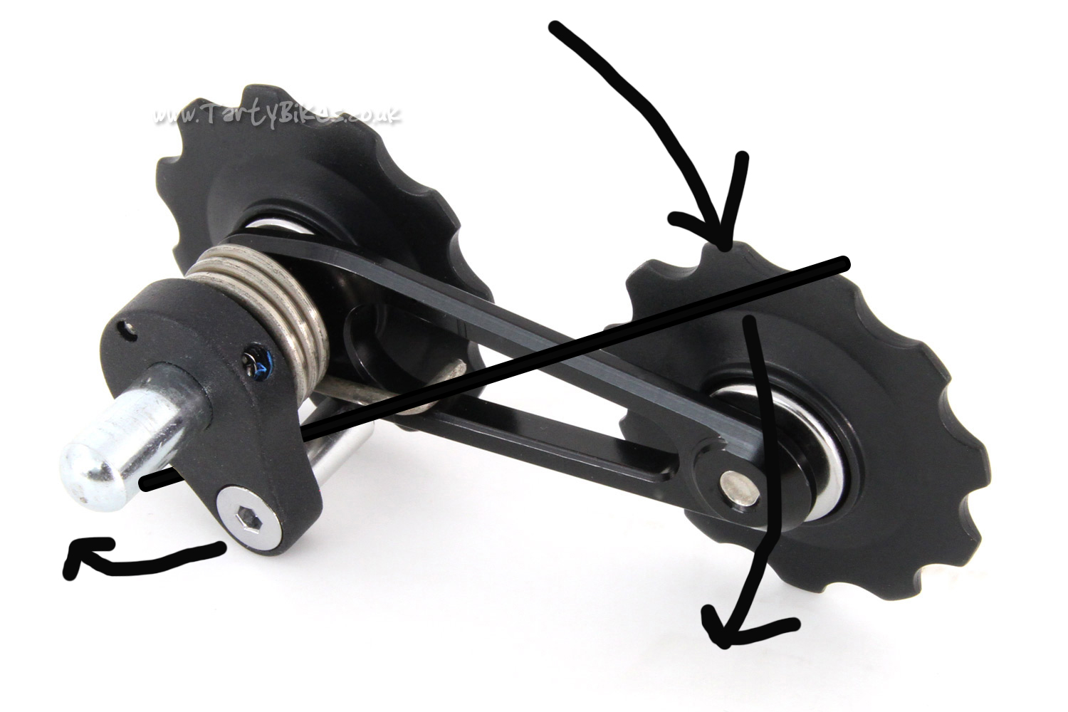

Ali C Posted April 18, 2021 Report Share Posted April 18, 2021 to complicate things I use a different technique which I find can potentially give more tension (to the point of breaking it so be careful). 1. With the chain still on undo the pinch bolt that holds the steel rod 2. use a small screwdriver or anything thin that fits between the rod and the tensioner and use it to lever the rod around (see diagram) 3. when desired tension is achieved, re-tighten the pinch bolt 4. ride and forget about Ben's version Quote Link to comment Share on other sites More sharing options...

Richie612 Posted April 19, 2021 Author Report Share Posted April 19, 2021 13 hours ago, Ali C said: to complicate things I use a different technique which I find can potentially give more tension (to the point of breaking it so be careful). 1. With the chain still on undo the pinch bolt that holds the steel rod 2. use a small screwdriver or anything thin that fits between the rod and the tensioner and use it to lever the rod around (see diagram) 3. when desired tension is achieved, re-tighten the pinch bolt 4. ride and forget about Ben's version Thanks for your advice Ali, much appreciated. I've enclosed a further diagram with two areas circled. When you say steel rod, I imagine that's a type of stopper so the tensioner reaches a certain limit. Now I've had a tinker with that but it seems to be fixed somehow. Undoing the hex bolt did nothing except loosen the head but the rod stayed in position. Another bolt I've circled which is above the steel rod, what does that do? At first I thought it was some kind of retaining pin or grub screw but again I undid it and it seems to be doing not much at all. Rich Quote Link to comment Share on other sites More sharing options...
Ali C Posted April 19, 2021 Report Share Posted April 19, 2021 I mean the rod that's being held by the pinch bolt, the big one up and left of the one you circled...I probably should've called the stopper rod a separate name 1 Quote Link to comment Share on other sites More sharing options...
