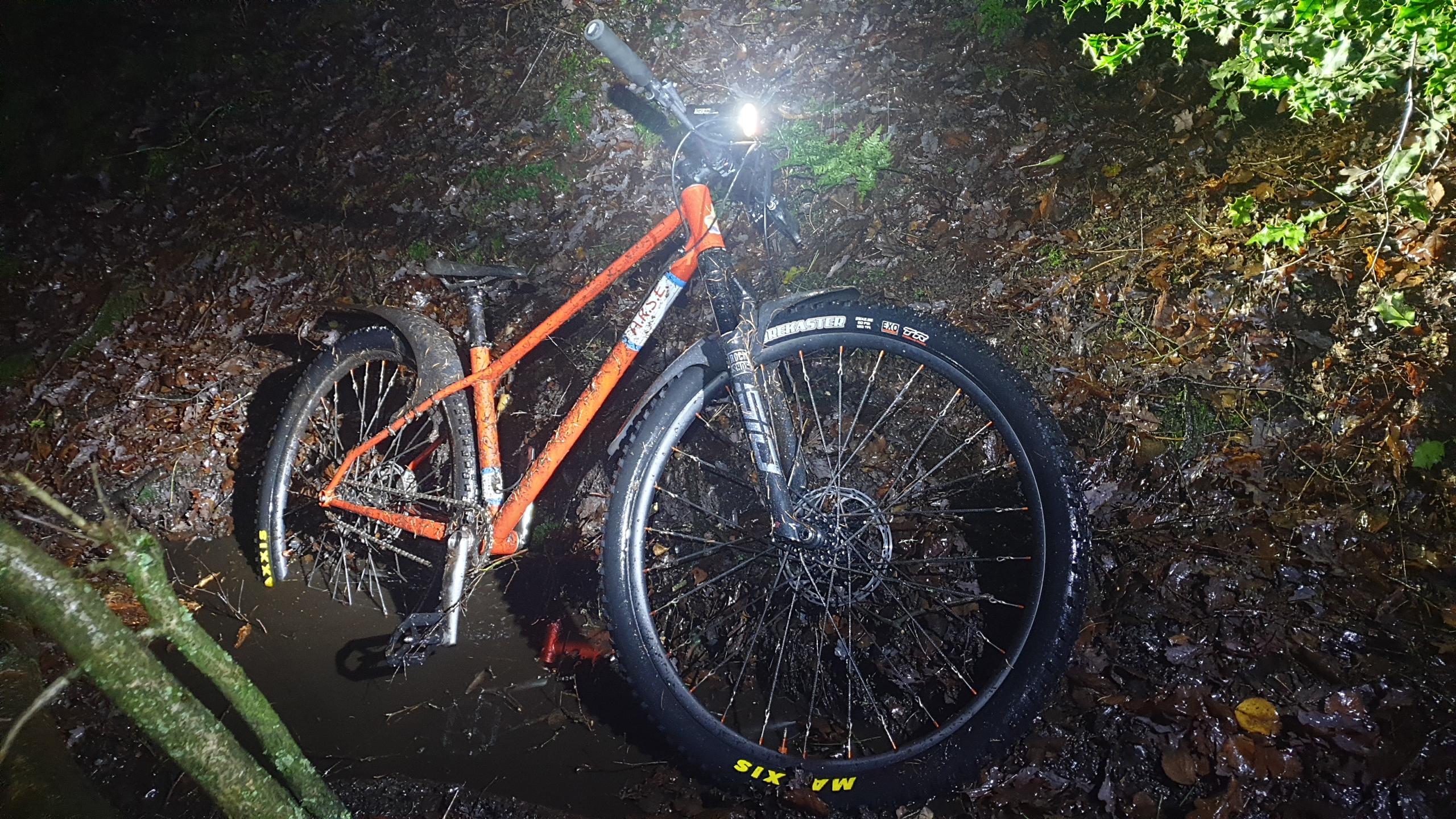

AdamR28 Posted December 8, 2021 Report Share Posted December 8, 2021 8.58kg in the photo above. Popped sidehops (edit, haha, the filter for S1D - as in short for a side hop and the name of a Rockshox fork - is still on!) on today and full mudguards, about 9.8kg now. Quote Link to comment Share on other sites More sharing options...

AdamR28 Posted December 9, 2021 Report Share Posted December 9, 2021 Well the wheels are still alive after 20odd miles including a bit of light trialsing... they have both come a tiny bit out of true (less than 2mm) which I put down to differing rates of bedding in for each spoke and eyelet. Hopefully one last fettle and they'll be reet. Hard to say how they ride exactly as there have been so many changes compared with what I'm used to (more modern forks, lighter rims, lighter bars, bigger tyres, bigger diameter wheels, lower tyre pressures) but the bike does have a lovely general compliance about it in the directions it needs to. I don't usually use Strava but do stick it on every now and again to compare significant bike changes and see how my fitness is getting along, and PRd by a few seconds on a fairly fast ~1:20min descent (despite dreadful conditions) - the rough final section felt much smoother than I remember! Despite the muck, they've come up clean after a hose down too. Winner. Will give them some more stick and report back again soon 8 Quote Link to comment Share on other sites More sharing options...

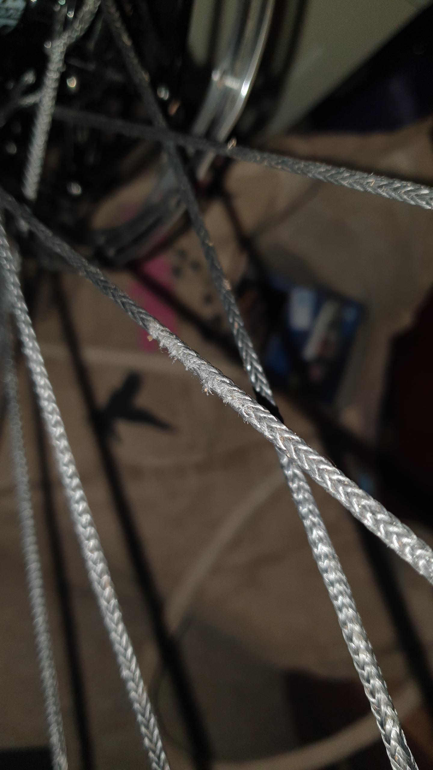

AdamR28 Posted December 10, 2021 Report Share Posted December 10, 2021 Found one spoke thats had a scuff... no drop in tension, but will keep an eye on it. Will be a good test! And thought this video might help convey them better than photos. 1 Quote Link to comment Share on other sites More sharing options...

AdamR28 Posted December 15, 2021 Report Share Posted December 15, 2021 That's good to know... cheers Ali. Yeah I guess with less tension that gives chance for mud / stones to move out from the belt / sprockets, rather than it constantly being rammed into them! See how it goes... easy enough to adapt... Had another blast last night. Rode some pretty steep / rocky stuff (local name for the line is 'Rampage', ha) which was a good test for the wheels, as well as the usual XC-type blasting, and all still well. Bike has an amazing forgiveness to it, so comfy for a hardtail! Quote Link to comment Share on other sites More sharing options...

AdamR28 Posted January 28, 2022 Report Share Posted January 28, 2022 Just a little update... now about 300 miles in and still going strong. I honestly wasn't convinced they'd hold up... the rims weigh 310-320g and are 32mm wide, so the spokes have a lot of work to do - but the wheels have stayed true and round, with no drop in tension. In that 300 miles I've been through two sets of sintered brake pads and worn out set of ti pedal axles, so the bike hasn't had an easy life 1 Quote Link to comment Share on other sites More sharing options...
