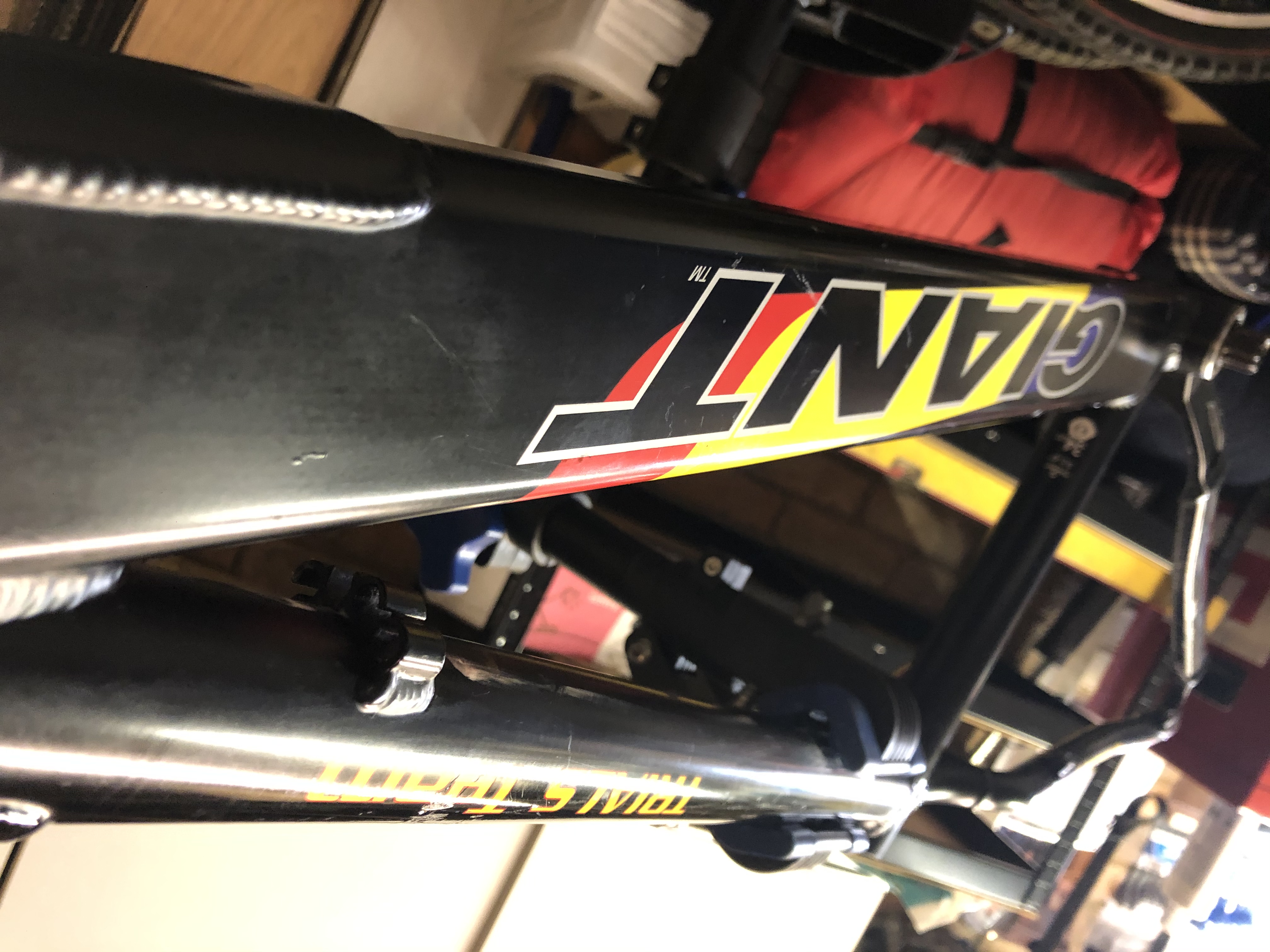

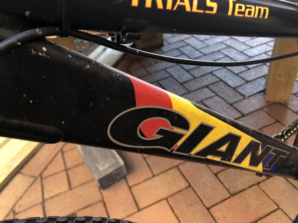

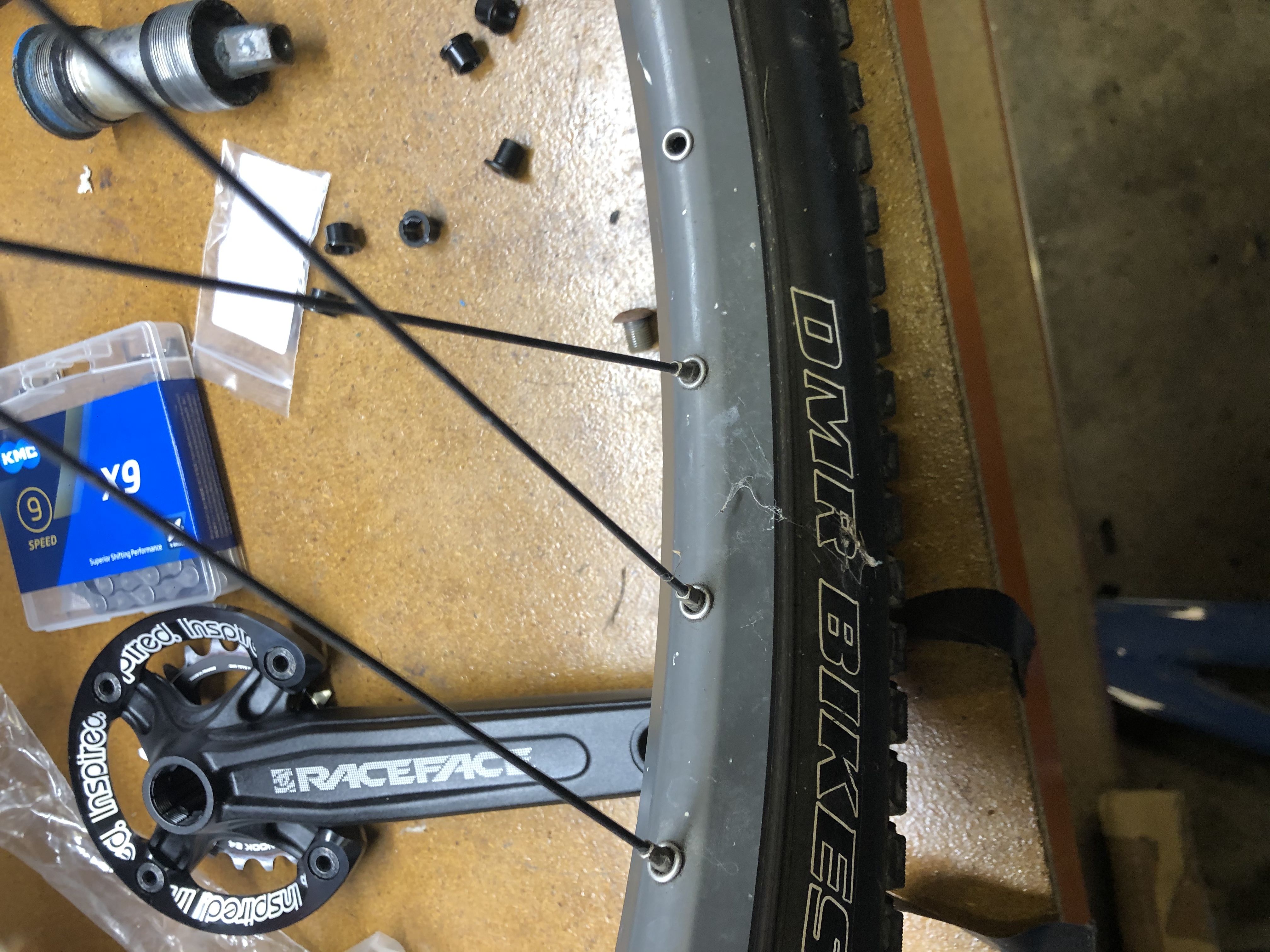

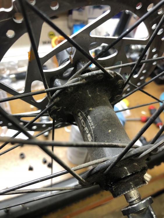

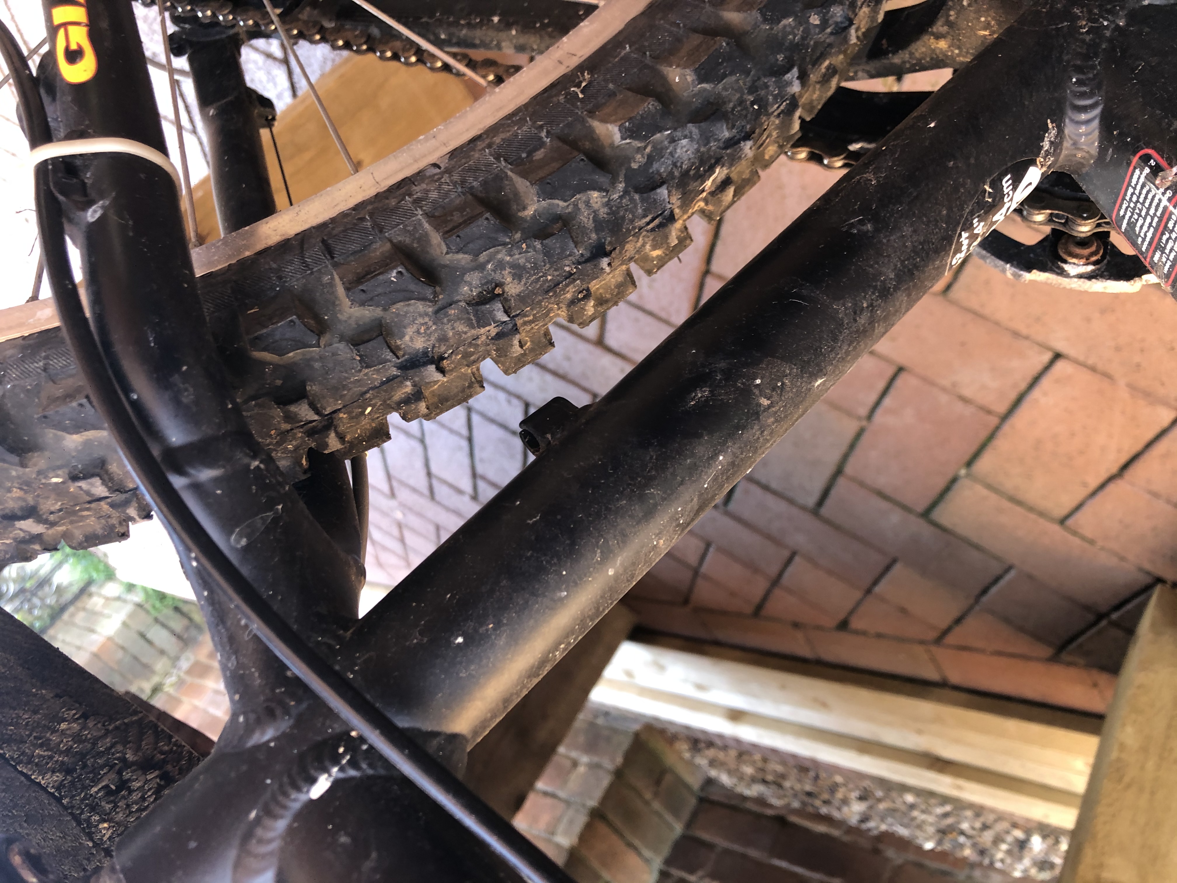

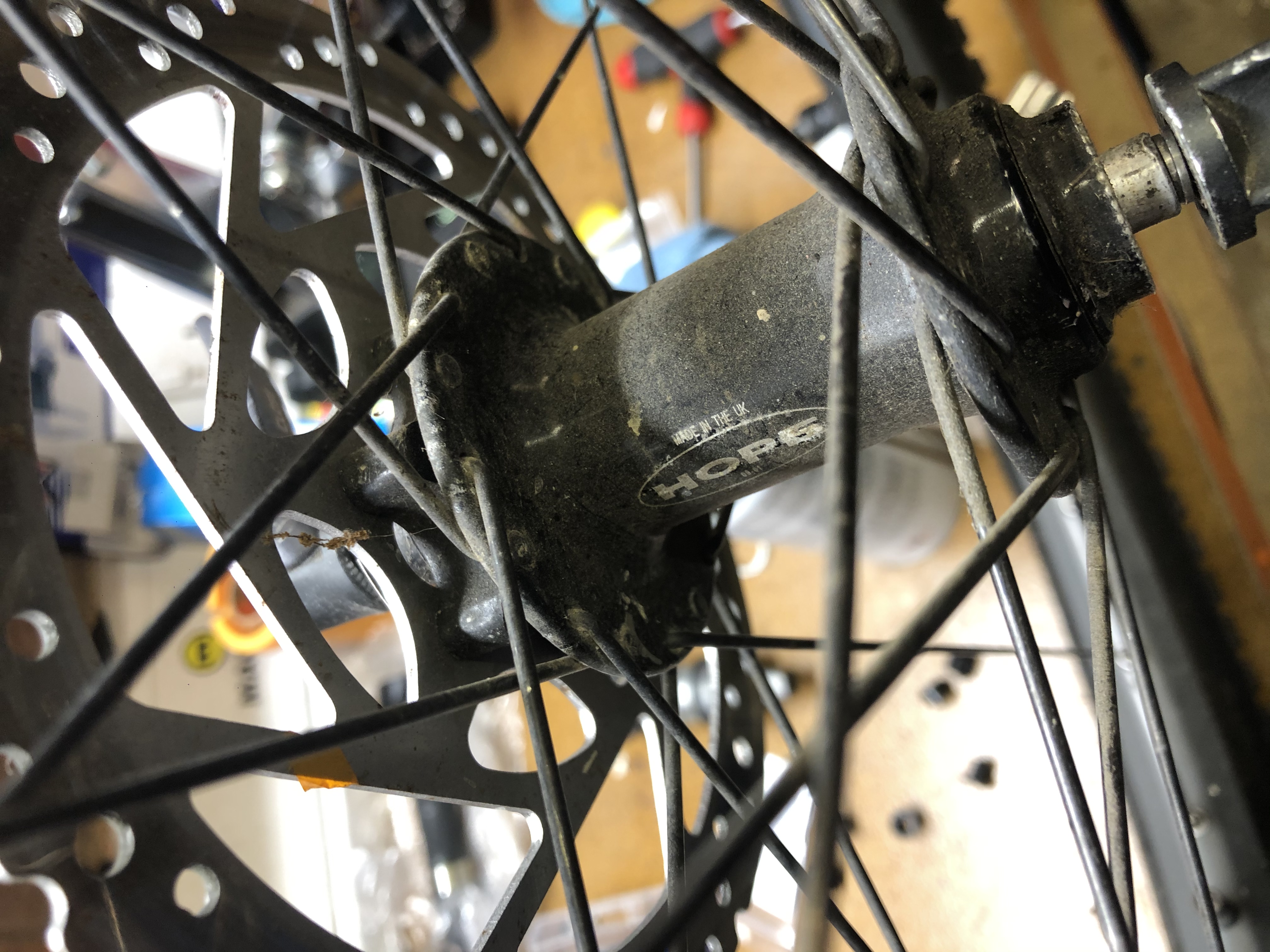

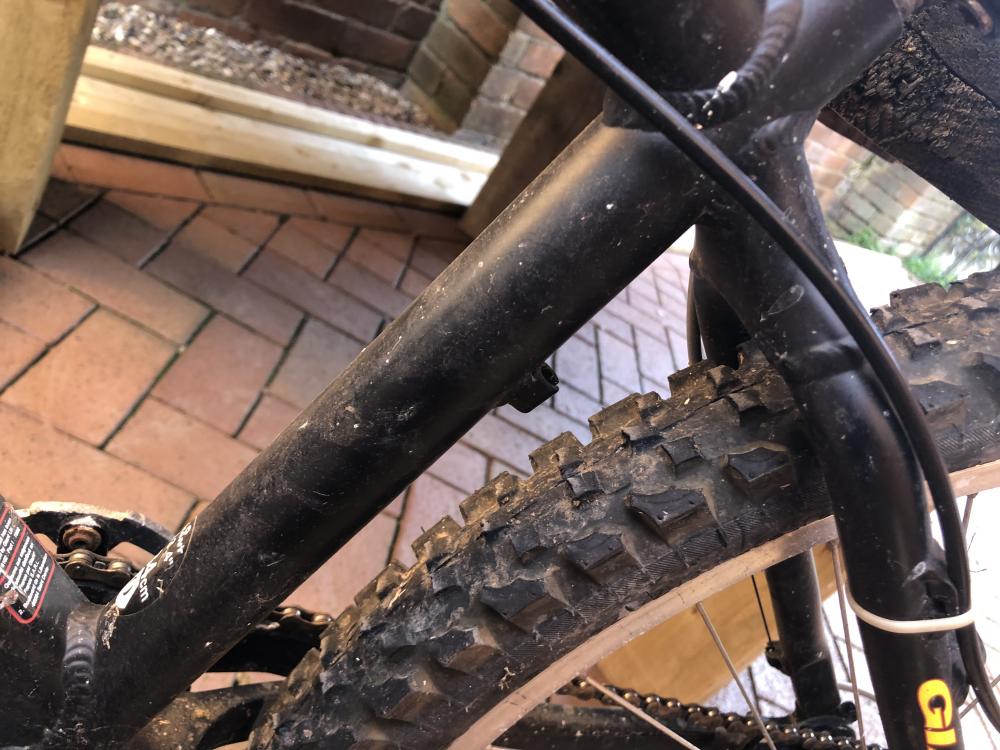

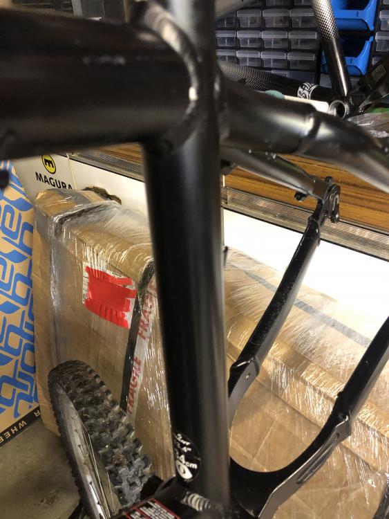

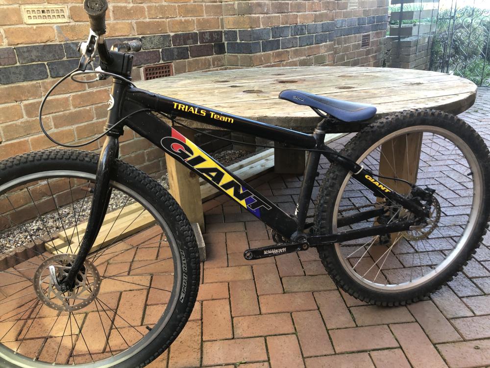

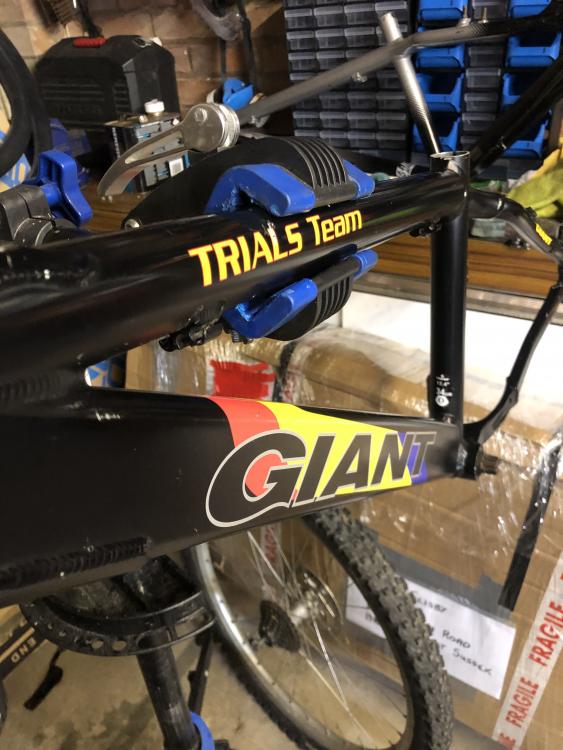

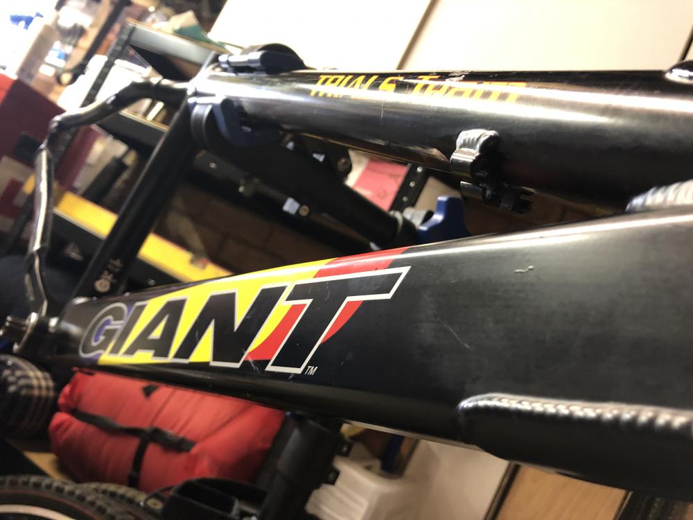

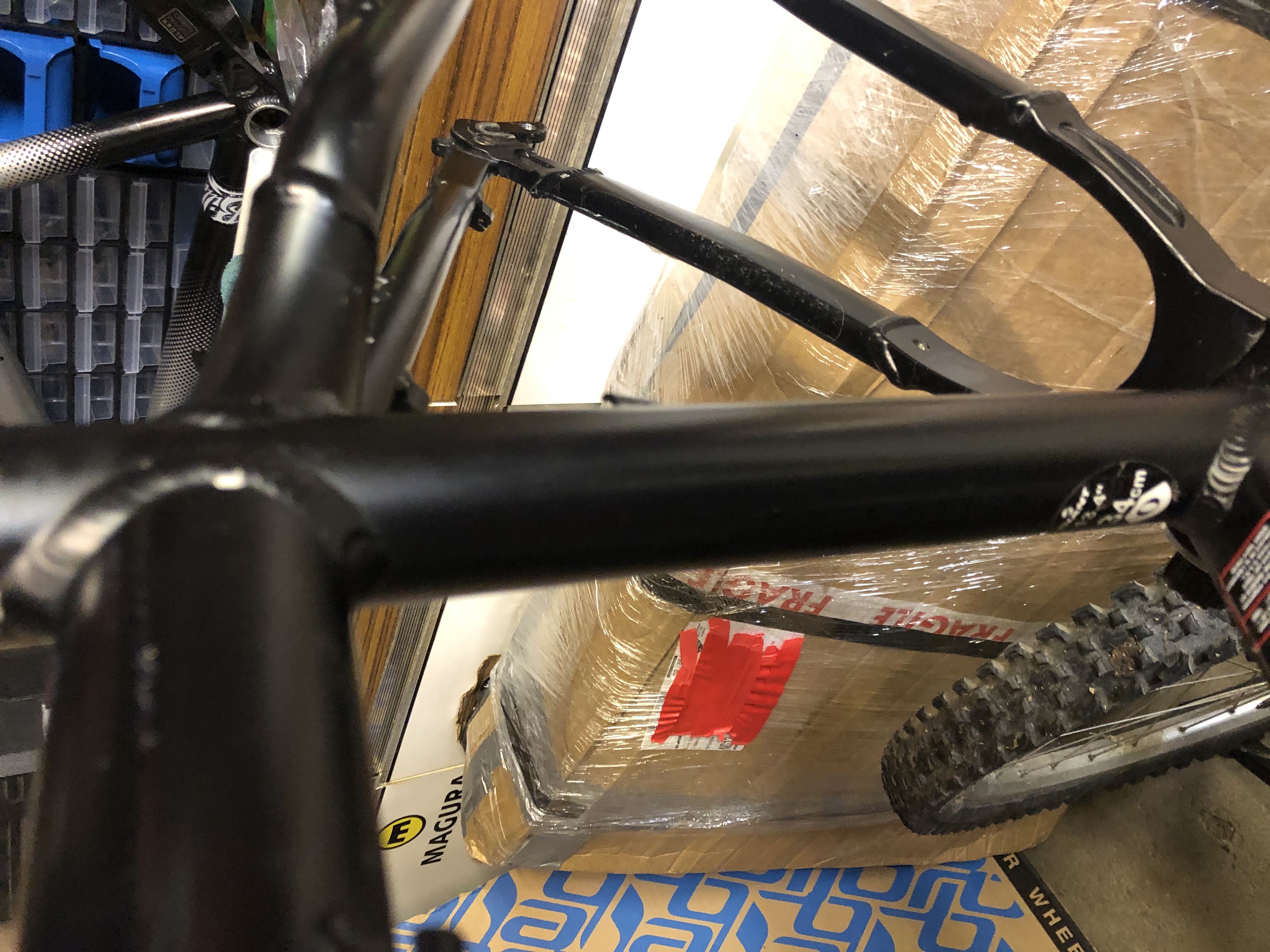

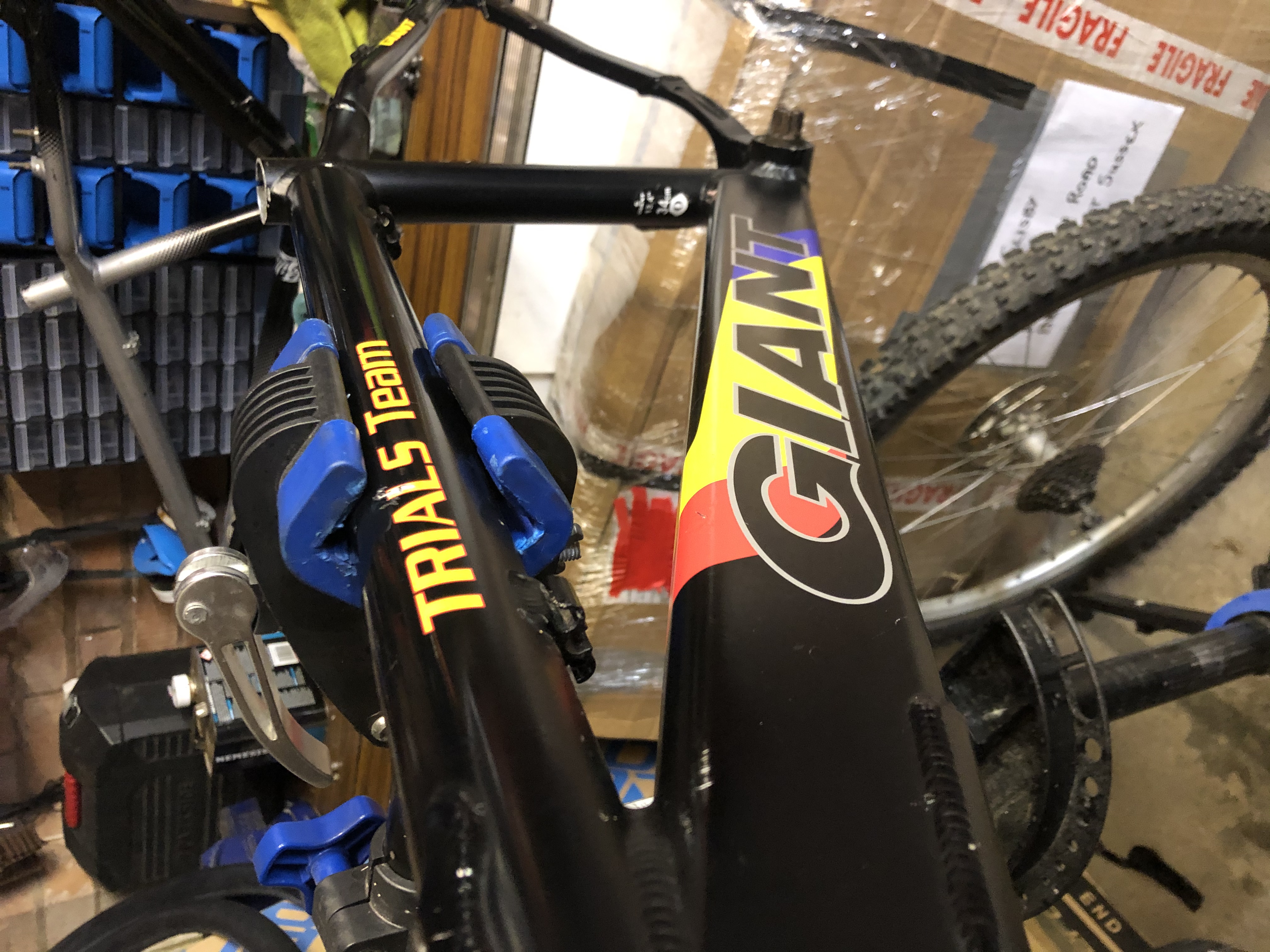

Private Repress Posted April 15, 2021 Report Share Posted April 15, 2021 (edited) Ive been on the hunt for one of these for some time now, so was delighted when I found one that I felt I could rescue. Pretty much a barn find - the stuff dreams are made of for someone like me! The bike was covered in dirt and dust and just in generally bad shape: But the under the grime the actual structure of the frame was sound with no cracks or dents. It even had the mandatory race face turbine cranks - I wouldn’t built one of these with anything but! The wheels were in poor condition with spokes missing and worn braking surfaces. To me this is the epitome of a bike project! Edited April 15, 2021 by Private Repress Typo 4 Quote Link to comment Share on other sites More sharing options...

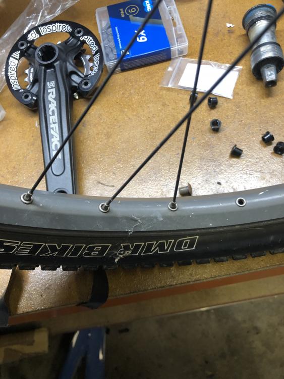

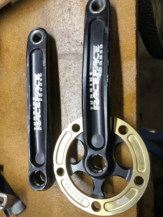

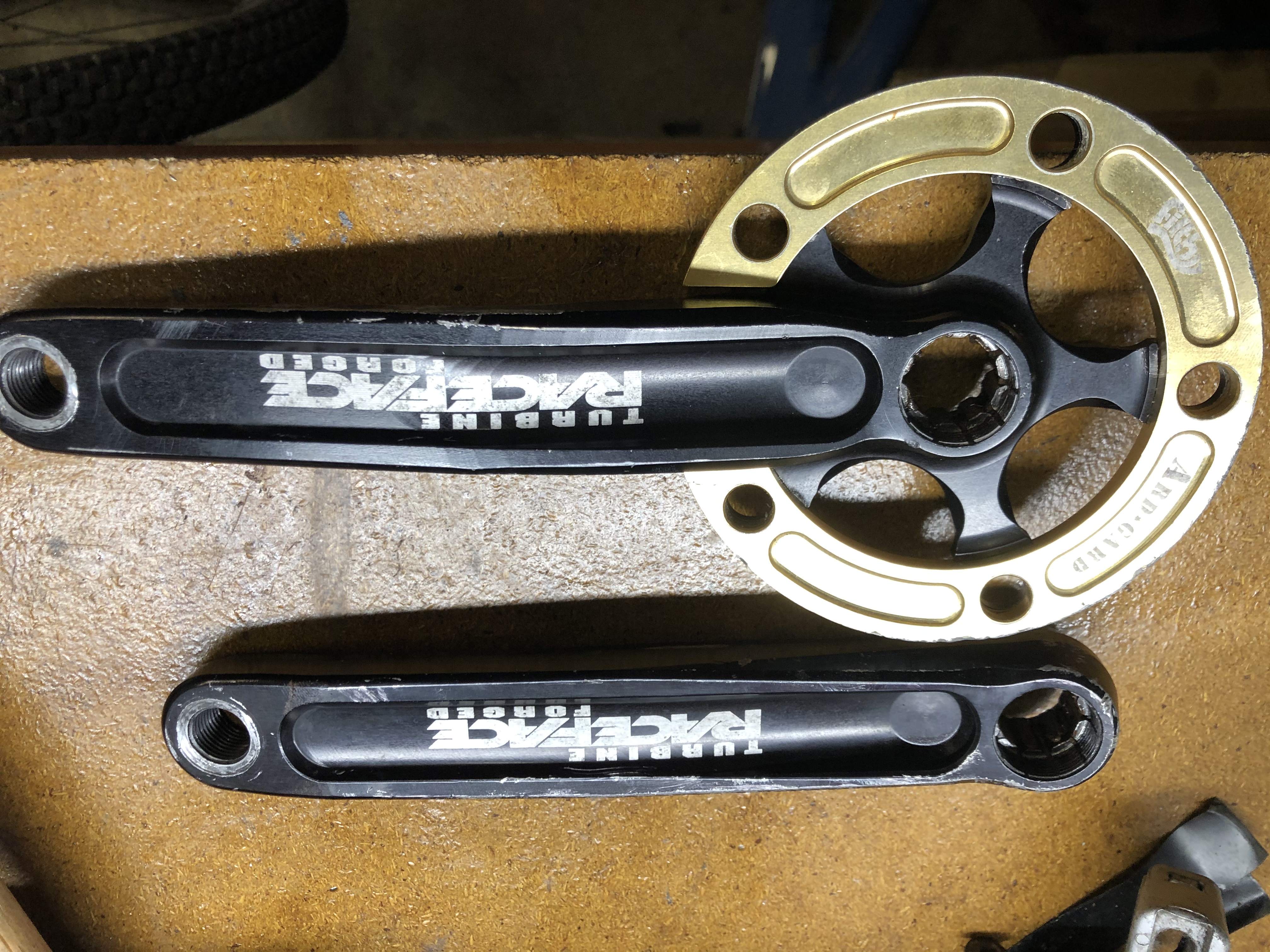

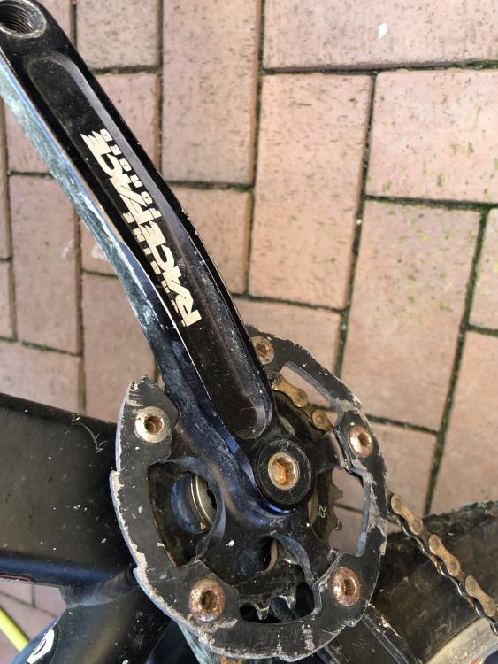

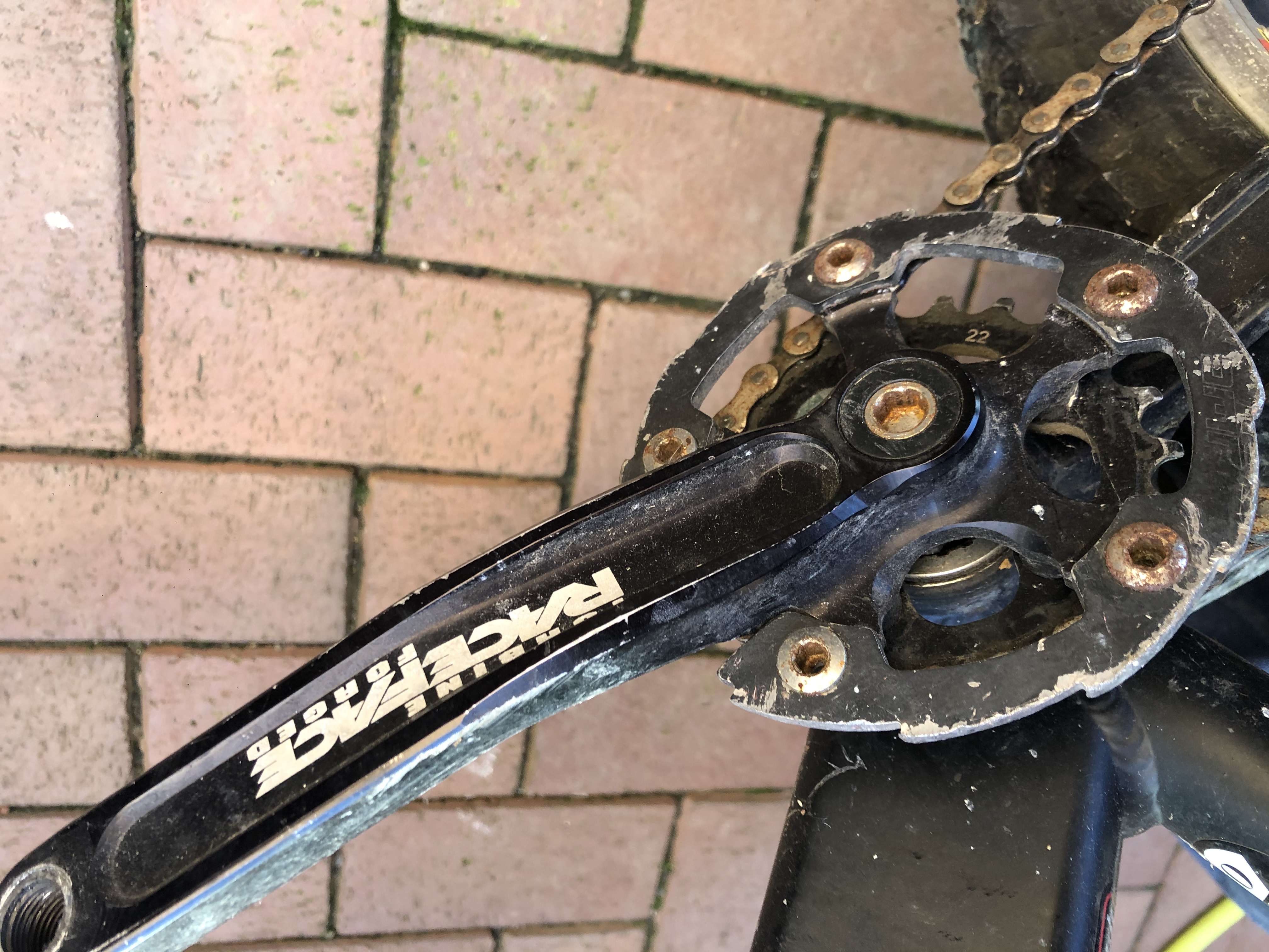

Private Repress Posted April 15, 2021 Author Report Share Posted April 15, 2021 So I got to work stripping it down and cleaning! I used a mild abrasive polish on the frame to remove the grime, then used a Matt finishing cleaner to bring it back to life A good friend of mine donated a gold filthy bash guard (permanent loan) to bring the cranks to life in true hawzie style: this has since has the benefit of a new 22t middleburn ring 2 Quote Link to comment Share on other sites More sharing options...

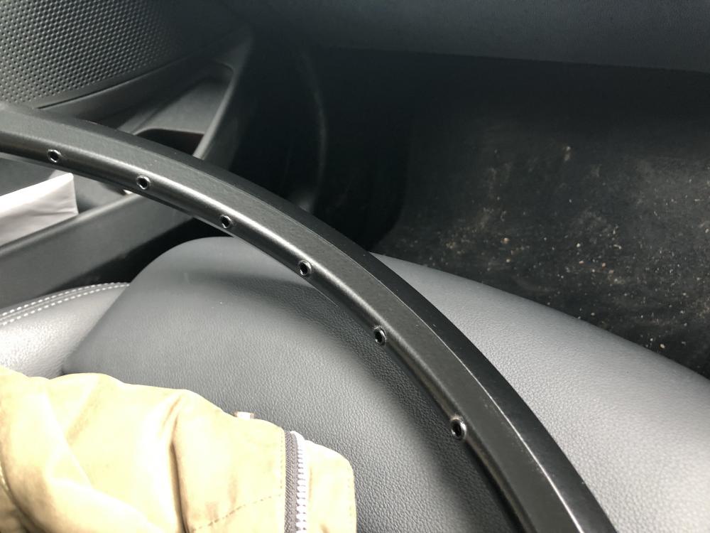

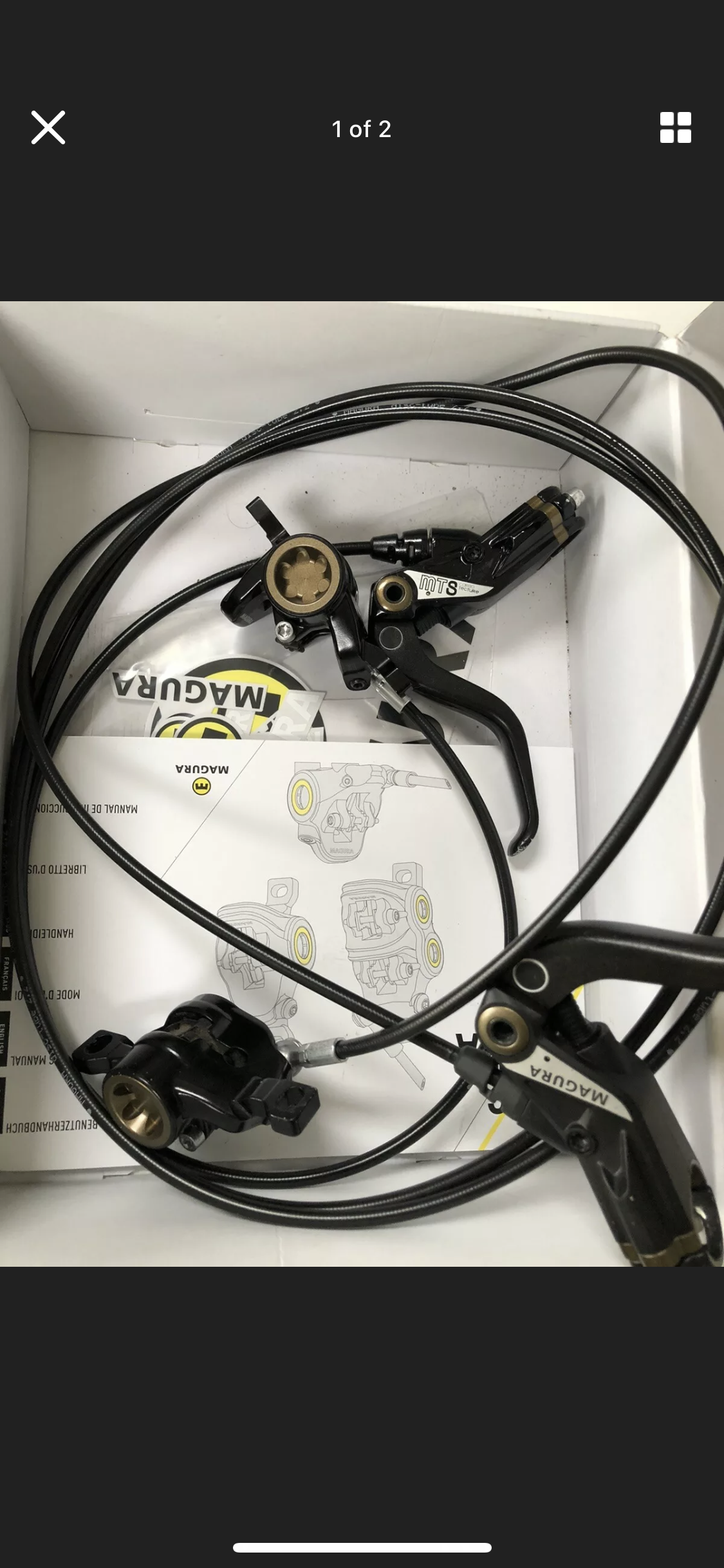

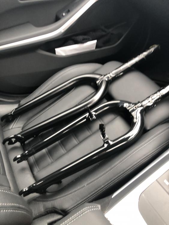

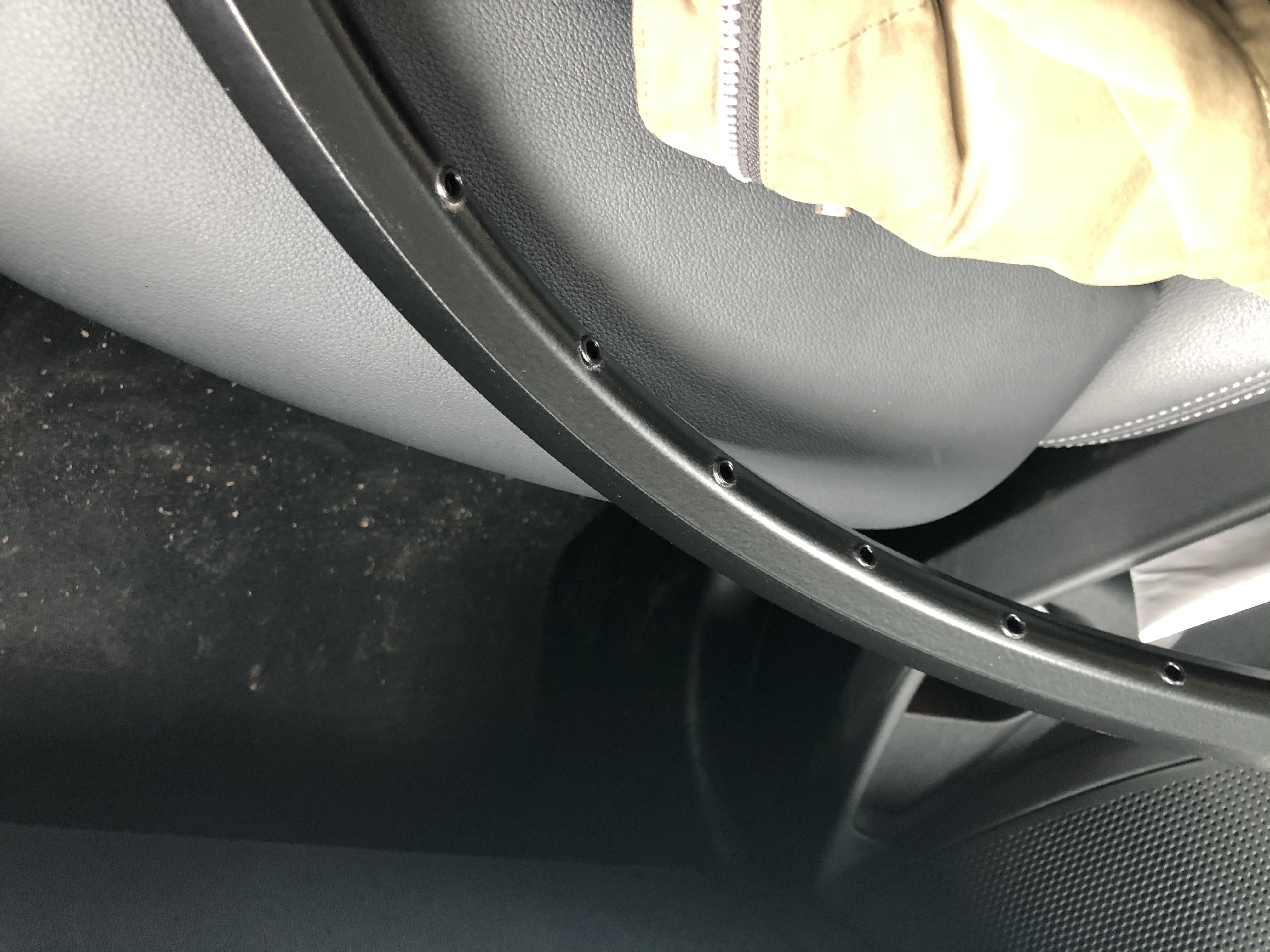

Private Repress Posted April 15, 2021 Author Report Share Posted April 15, 2021 Now to sort the wheels... I took the wheels apart and had the rims powder coated satin black along with some Echo Urban disc forks I also managed to bag a pair of second hand Magura MTS brakes, same as the MT4’s but for Specialised to equip on their bikes. This was a great find as the gold and black really fitted the theme Quote Link to comment Share on other sites More sharing options...

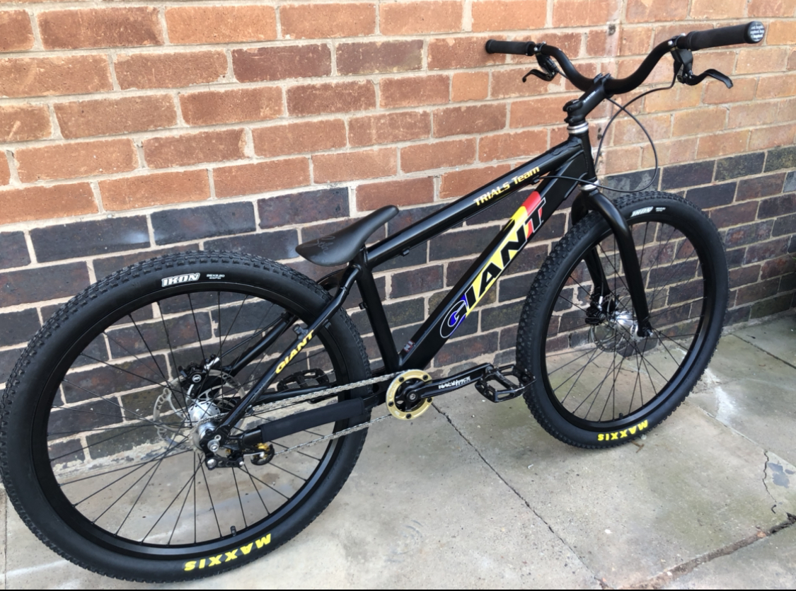

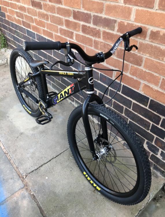

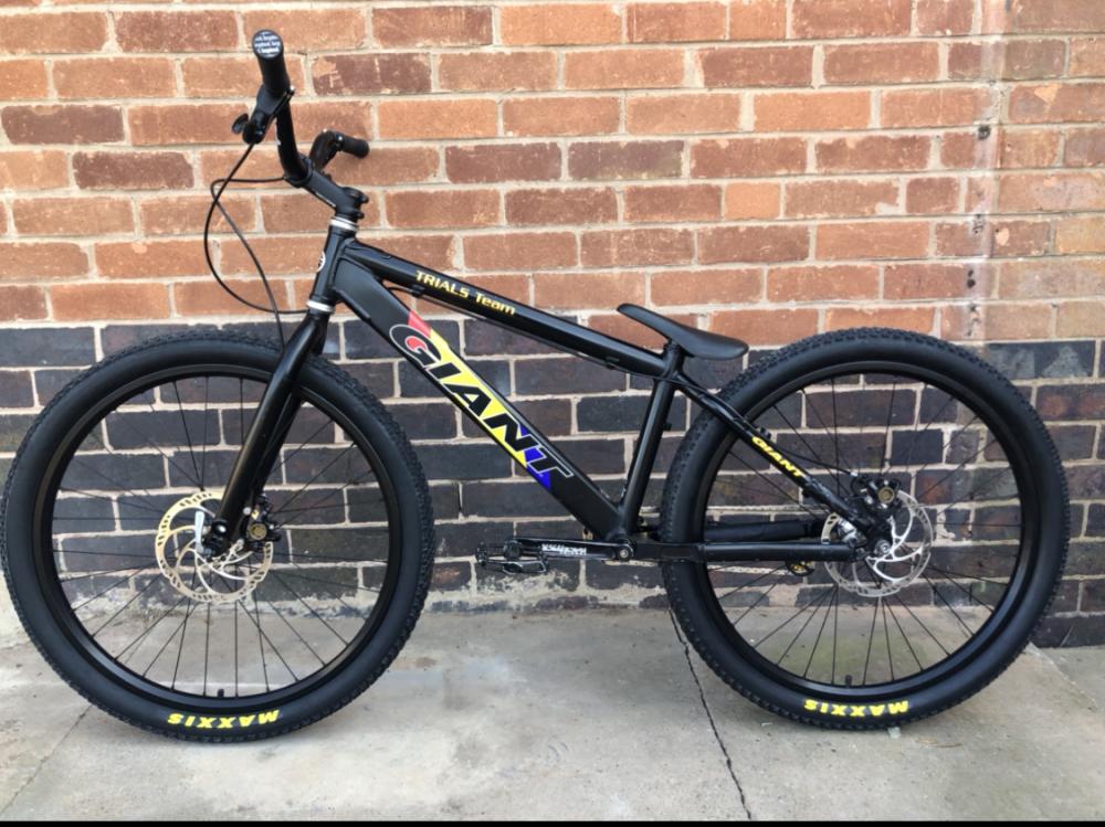

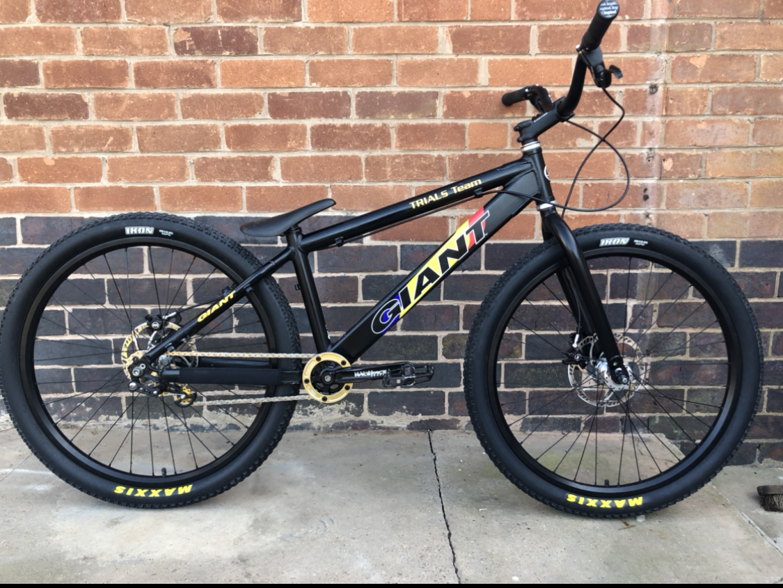

Private Repress Posted April 15, 2021 Author Report Share Posted April 15, 2021 (edited) A few finishing bits and the build is complete! I should point out my aim here was not a replica. I was looking to build a 26inch street bike, my yellow Giant remains a replica, but this was about having a bike that felt familiar with modern components where needed to deal with the type of riding I have in mind. Edited April 15, 2021 by Private Repress Typo 12 Quote Link to comment Share on other sites More sharing options...

Private Repress Posted October 19, 2023 Author Report Share Posted October 19, 2023 7 hours ago, Bramblej said: What a peach!!! I know i am a little late to this post, but what rims are you using? and what width tires? i'm about to build up one of these and just getting some ideas. also, stem specs would be helpful too. thanks! @Private Repress Thanks 👍🏻 The rims are Mavic D521s that I powder coated black. The tyres in the pic are Maxxis ikon, 2.2 inch. Truthfully they are fine for a front wheel, but I ended up with a Maxxis holy roller on the rear which is 2.5 inch. For me these frames work perfectly with a 90mm stem, so that’s what I went for, with 7° rise. It’s an Easton EA50. Hope that’s helps, good luck with the build! Get some pics up 👊🏻 Quote Link to comment Share on other sites More sharing options...
