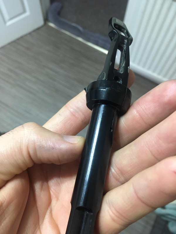

Mark W Posted March 18, 2021 Report Share Posted March 18, 2021 Feels weird to be using a different part of TF... Anyways, I've got some Rockshox forks on my bike with a regular Maxle. It's the full poverty spec one that isn't adjustable (save for the grub screw for the paddle), and with where it ends up when my wheel is the right torque it's a faff to use. Basically, it ends up almost in line with the fork leg, but due to the diameter of the fork leg you can't really keep the paddle fully engaged with the cut-out in the axle body. It's resulted in it slipping out a few times and mulching the sides of the cut-out in the axle, which in turn isn't great either... It also has a habit of coming loose. Basically, QRs of any sort can get in the sea so I'm looking to switch to something like the Stealth Maxle. I've got the OneUp EDC Lite tool in the steerer so I've always got an alley key to hand, so convenience wise it's not a problem. My only real question is how well they work, and if they're less susceptible to coming loose than the QR Maxles? I'm not really looking to spend Rockshox money on a replacement, so for full disclosure I'm looking at something like the Brand-X version: https://www.chainreactioncycles.com/brand-x-bolt-through-axle/rp-prod176624 Quote Link to comment Share on other sites More sharing options...
AdamR28 Posted March 18, 2021 Report Share Posted March 18, 2021 Got a photo of the Maxle you have Mark? I was under the impression they are all adjustable, just the mechanism on some is very 'hidden'! I've never had my QR one come loose before... I know people with the BrandX rear Allen key ones and no issues. Quote Link to comment Share on other sites More sharing options...

Mark W Posted March 19, 2021 Author Report Share Posted March 19, 2021 17 hours ago, monkeyseemonkeydo said: But also as Ad said I thought it was standard for them to have some awkward adjustment system built in! They don't appear to as far as I can tell, save for the 2.5mm allen key adjuster for the lever tension itself: There isn't the cone spanner type adjuster that some Maxles have, and definitely no easily rotatable clicker setup either. Appears to be just a one-piece axle in that regard, as far as I can tell. That's where it ends up towards being fully tensioned. Prime. That's partially why the 'loosening' face of the axle slot is so f**ked (the other part being me doing it wrong obvz) - when it starts loosening off, the position of the fork leg relative to the axle means it lifts it pretty far out of the slot so there's hardly any contact with it, and with it being fairly thin aluminium taking a bunch of force... Cheers for all the tips anyway peeps, looks like some form of stealth axle is the way to go. Be glad to get rid of that muntery lever from my forks! Quote Link to comment Share on other sites More sharing options...
