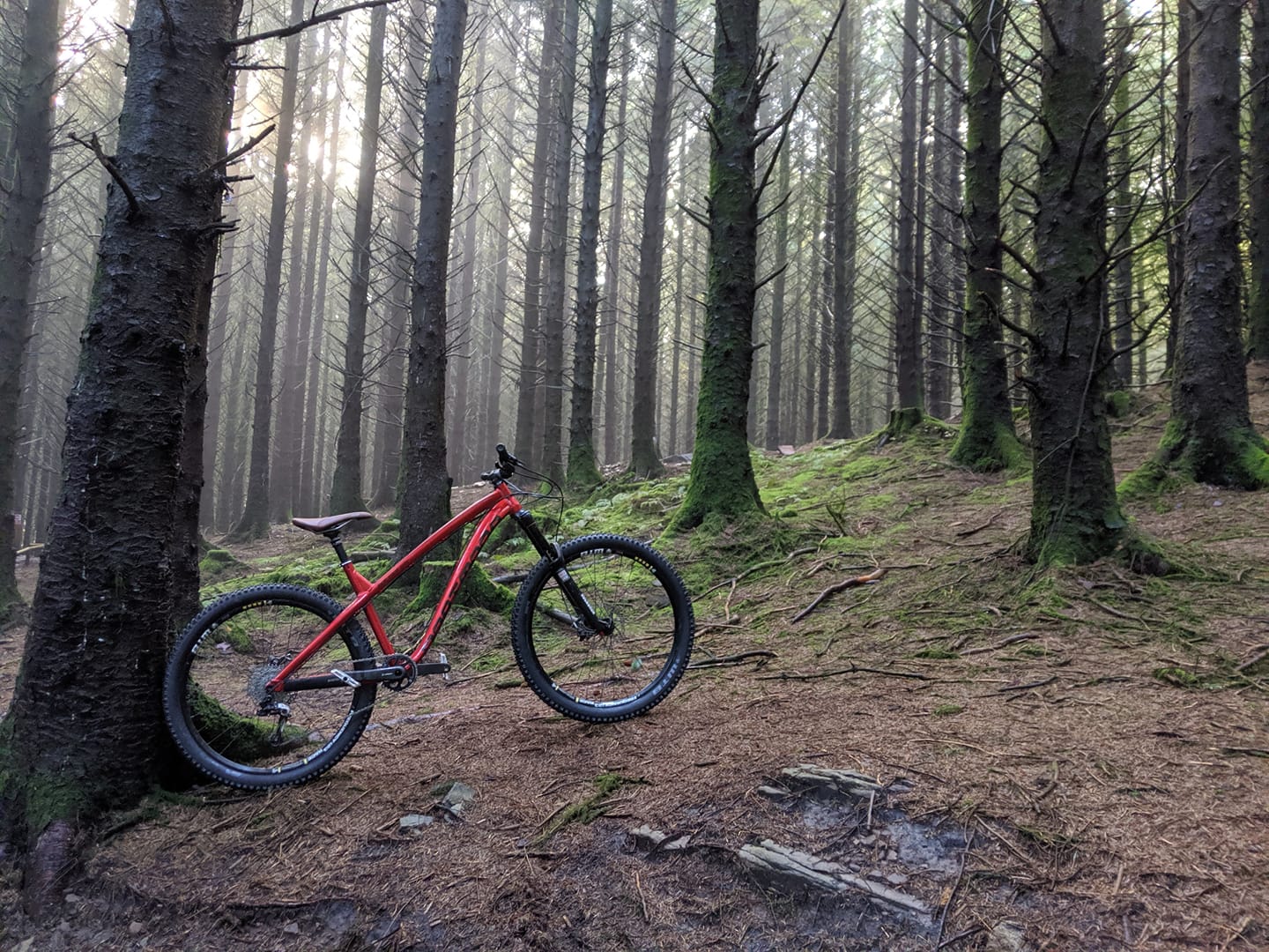

Mikee Posted March 15, 2021 Report Share Posted March 15, 2021 (edited) You've basically described my hardtail frame. It's a 2019 NS Eccentric Alu 27.5" frame. I find the cockpit a tad cramped, but have lots of fun riding it. Could be one to look out for. Edited March 15, 2021 by Mikee 1 Quote Link to comment Share on other sites More sharing options...
