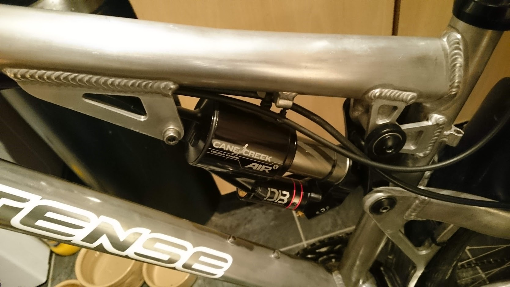

forteh Posted March 15, 2021 Report Share Posted March 15, 2021 If you want it true raw aluminium as in with weld discolouration visible and natural finish on the tubes then it's chemical stripping with dichloromethane (the active ingredient in old formulation nitromors) which is not legal to buy for personal use and is particularly nasty stuff. Blasting it will give a uniform look to the material, losing the original finish on the tubes. I stripped the old powdercoat from my intense 5.5 using dichloromethane and it took days and days of apply, wait, scrape, apply, wait, scrape; many chemical burns were endured and the boilersuit I wore still has bits of red melted powdercoating embedded in it Bear in mind that was 7-8 year powdercoat and it was really hard work, frame came up lovely though Quote Link to comment Share on other sites More sharing options...

forteh Posted March 15, 2021 Report Share Posted March 15, 2021 If you're planning onrecoating then yes, blasting is better (as long as the blaster doesn't get happy filling the threads with grit!) as it will key the surface better. I specifically wanted the raw factory aesthetic so went for dichloromethane. Quote Link to comment Share on other sites More sharing options...
