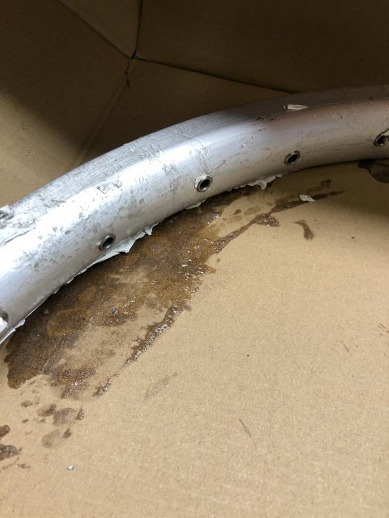

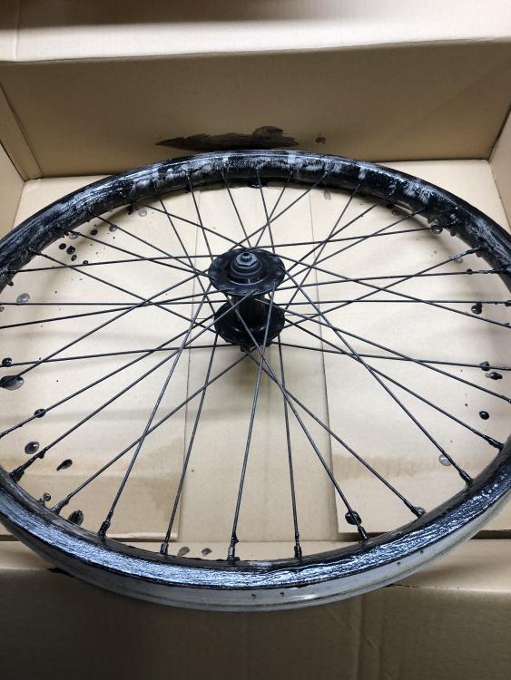

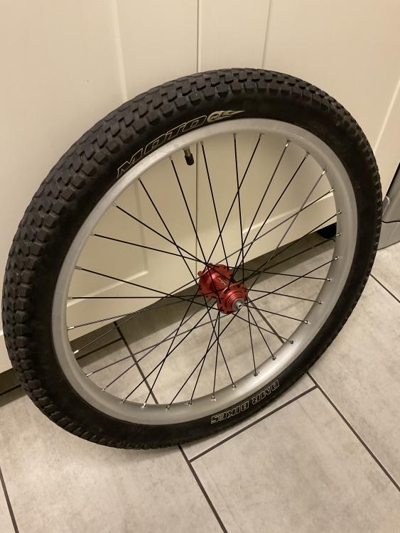

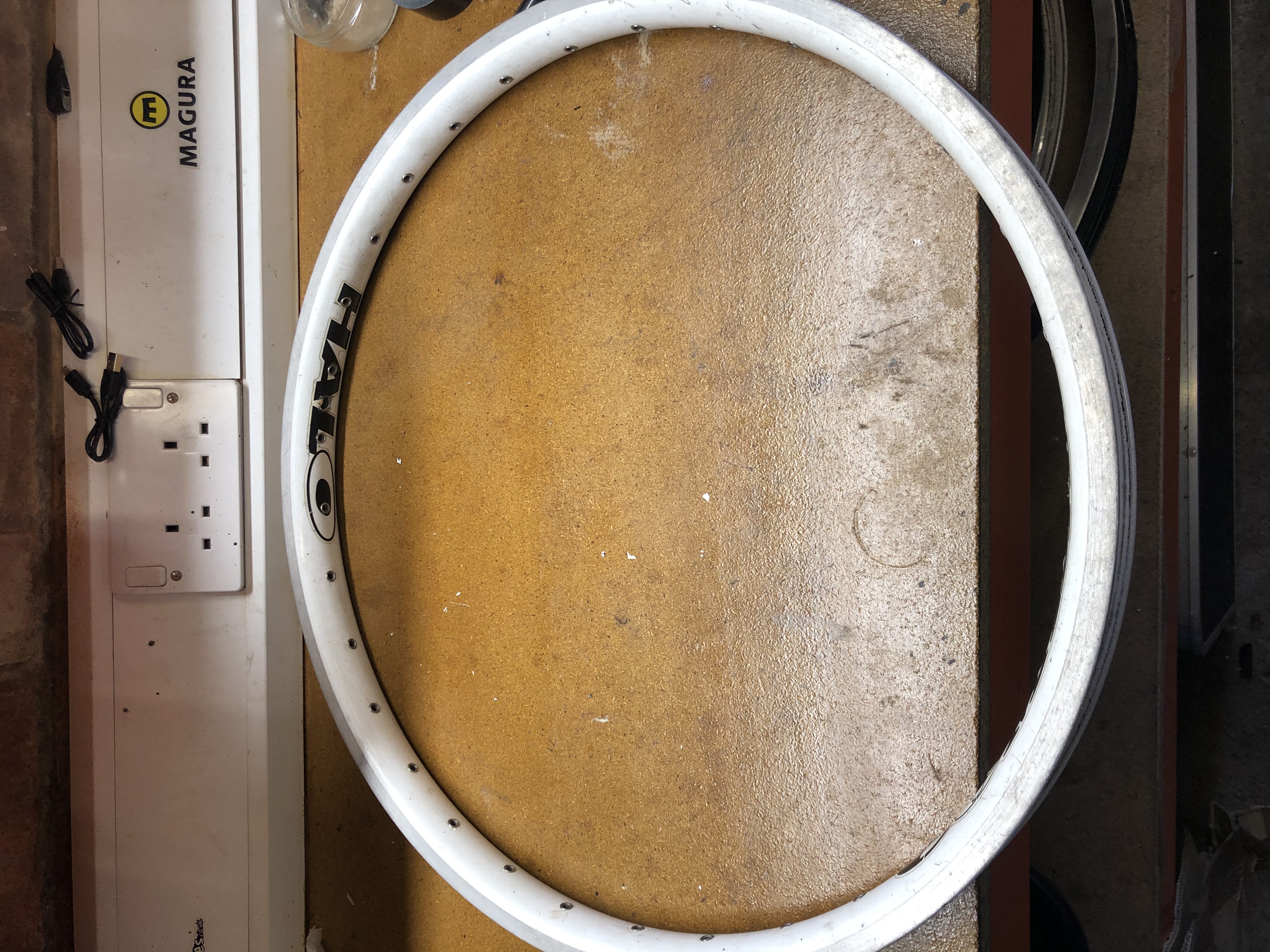

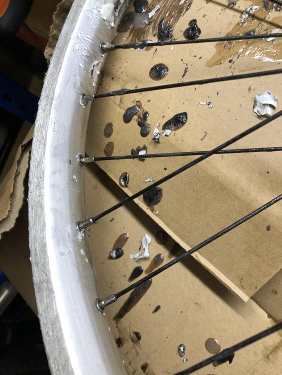

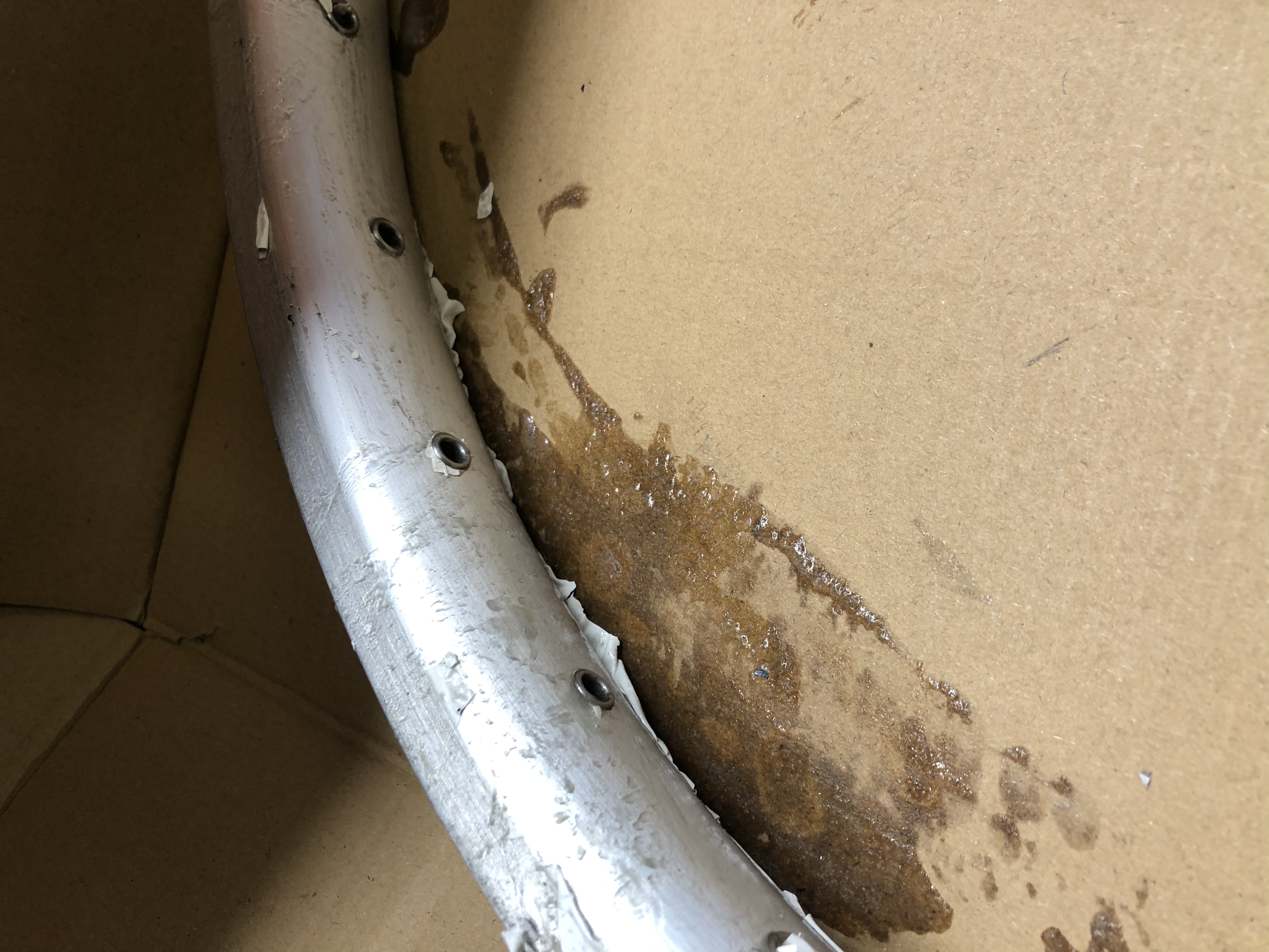

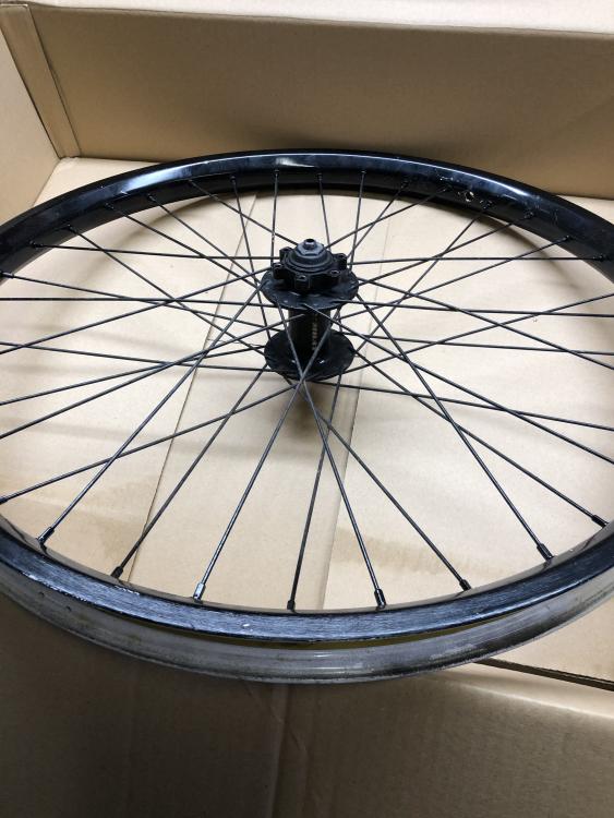

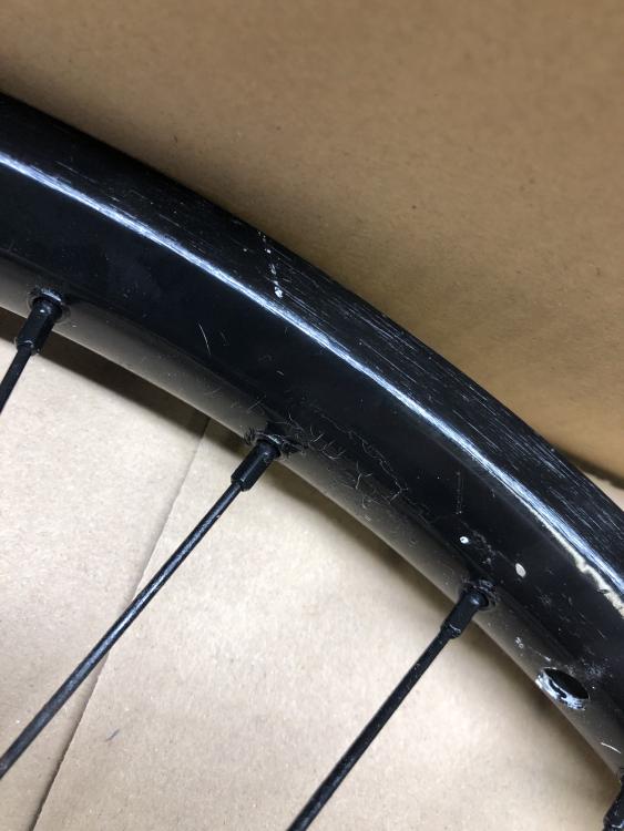

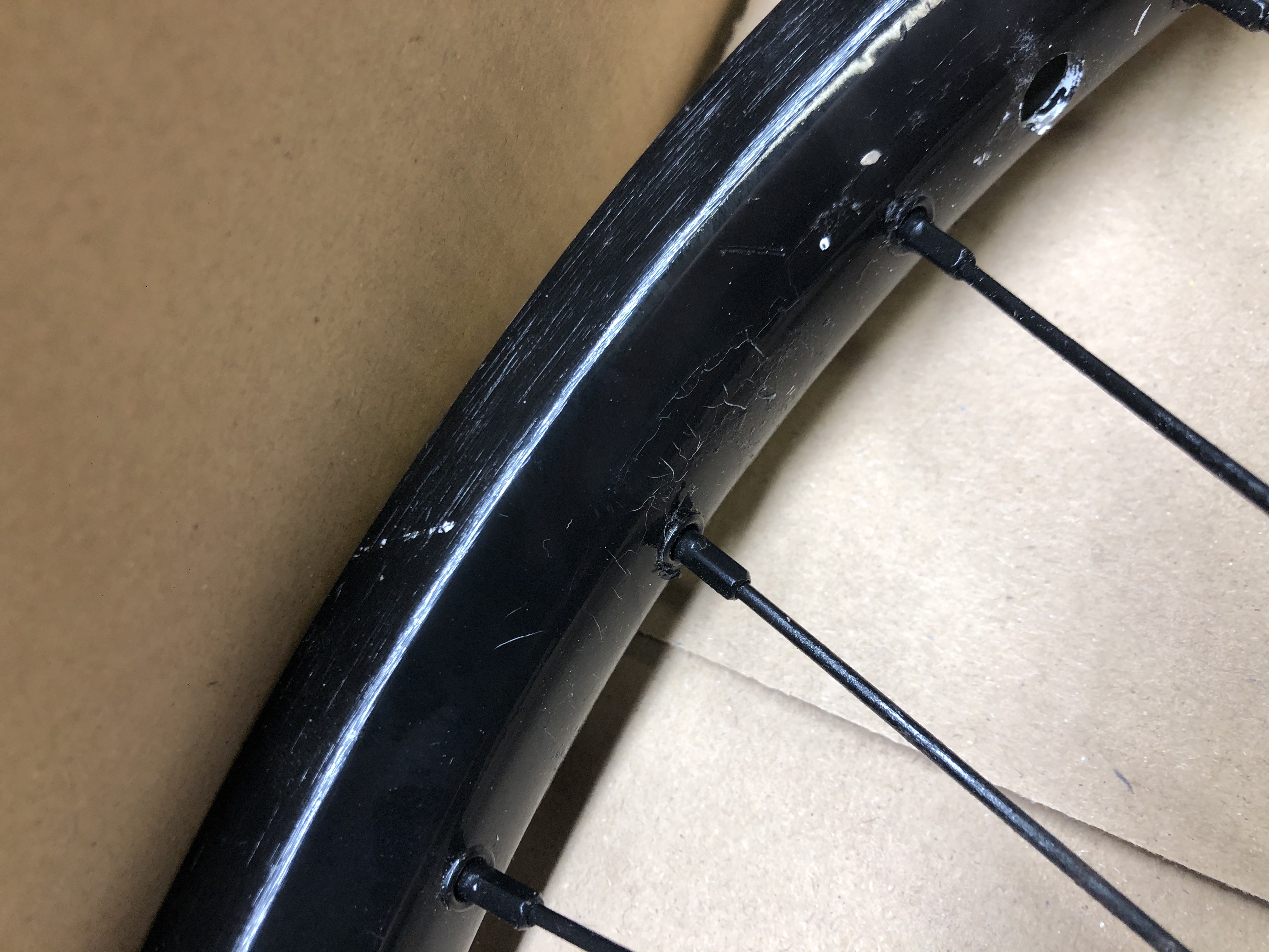

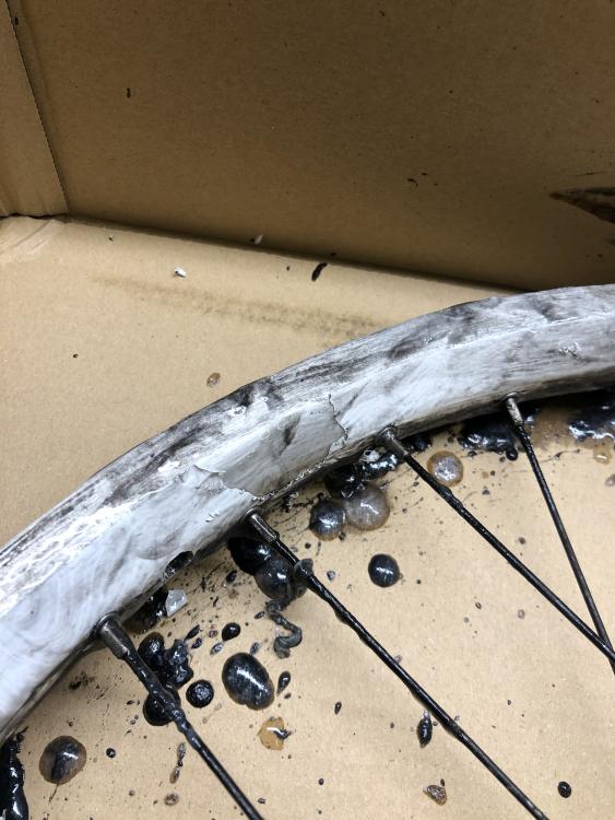

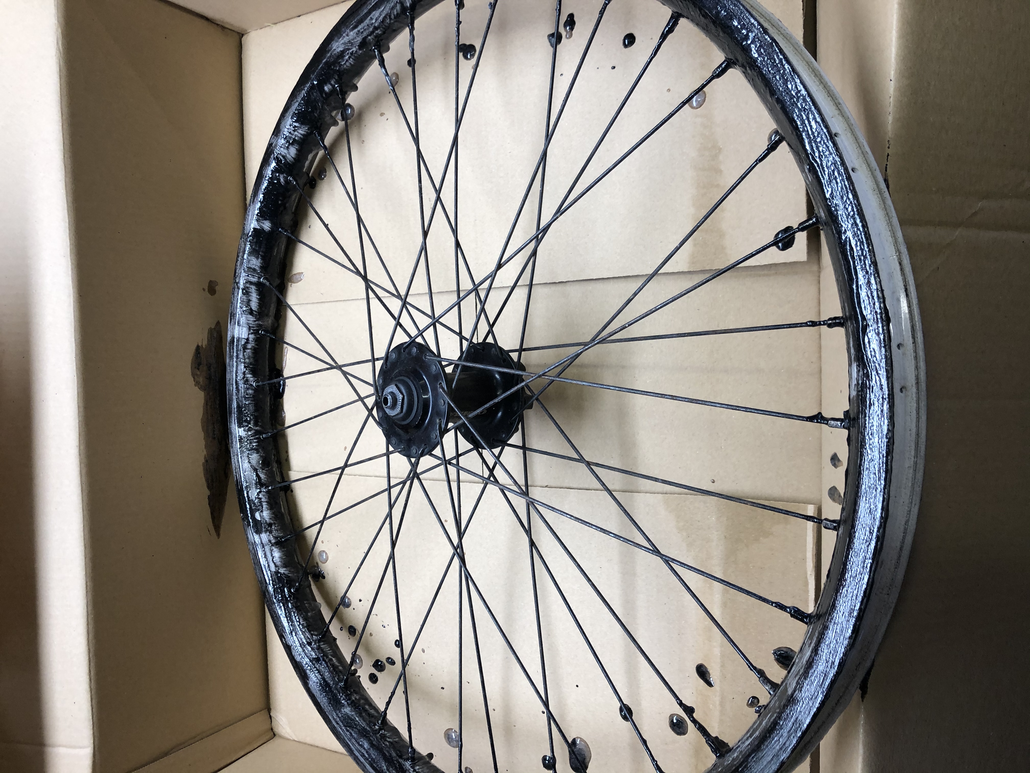

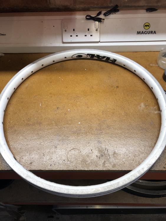

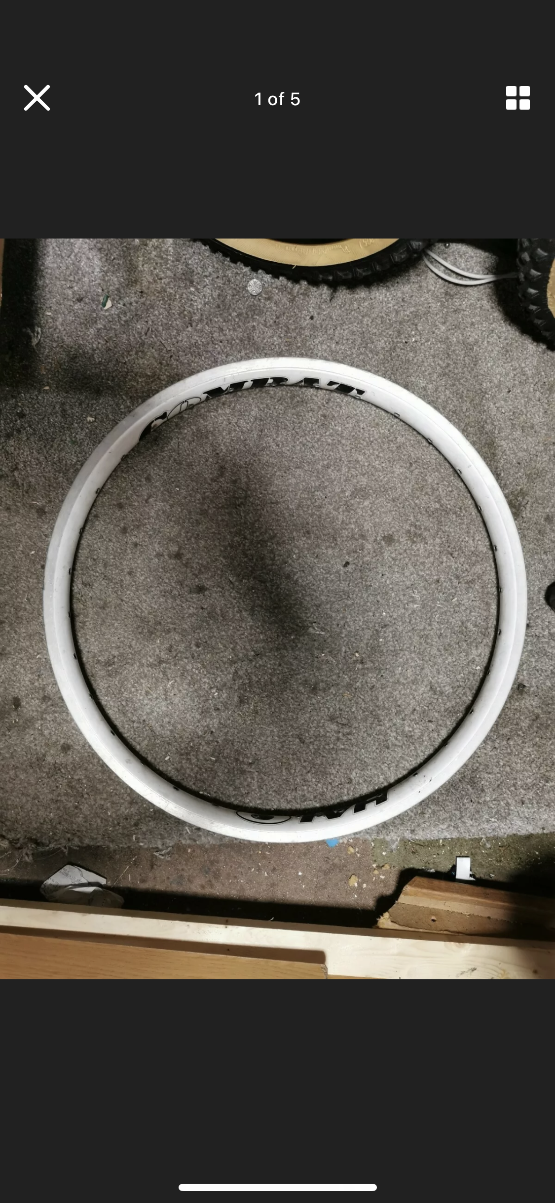

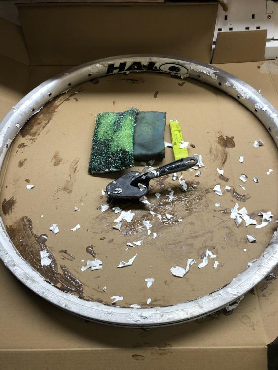

Private Repress Posted February 23, 2021 Report Share Posted February 23, 2021 (edited) Been going through my spare parts seeing what I have left and what could be built. Came across some wheels in the roof of my garage that I’d forgotten about. A set of halo combat rims on halo hubs. they came second hand on a complete bike I bought a few years back. The rims had been sprayed black over the existing white paint, clearly whilst the wheel was built as the spokes and nipples had lots of overspray. Never thought I’d use these, but I had a 36 hole pro 4 kicking around (bought it second hand with the intention of slapping it on the Marino build - not realising at the time that spank only do 32 hole rims!) so out with the good old paint stripper: Two coats and some scrubbing, and the bare metal finally started to show. Edited February 25, 2021 by Private Repress Title Quote Link to comment Share on other sites More sharing options...

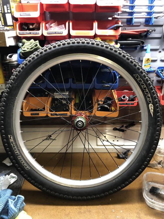

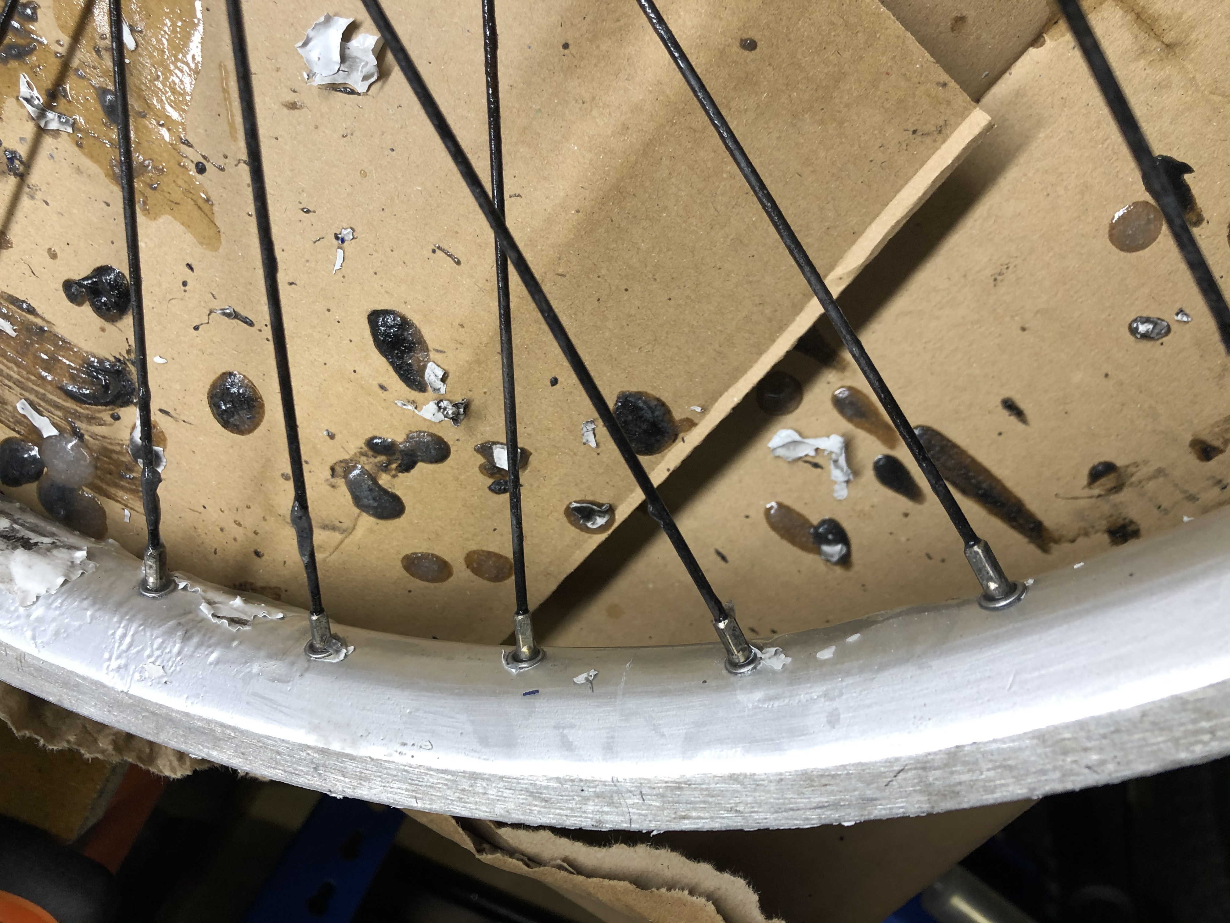

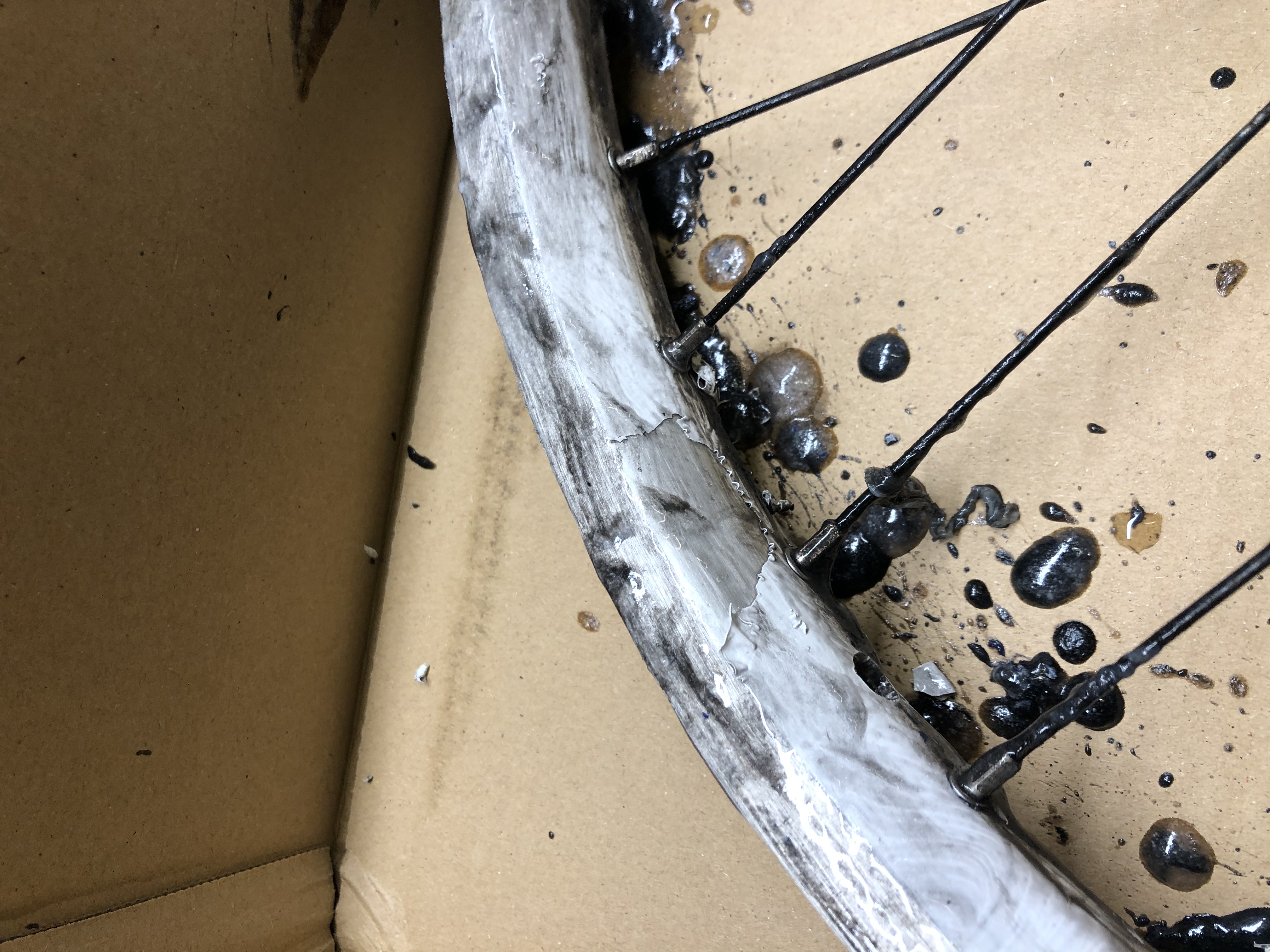

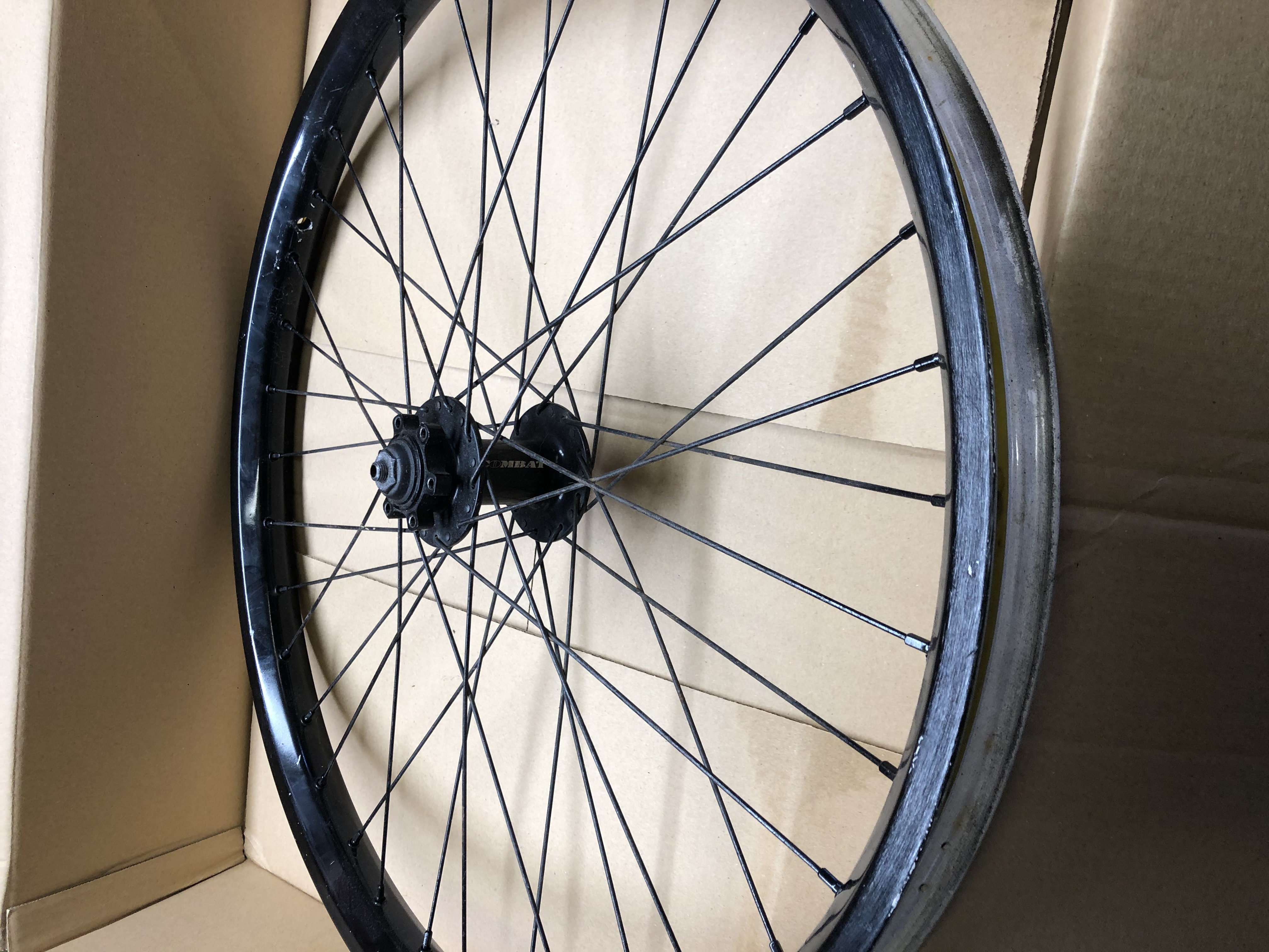

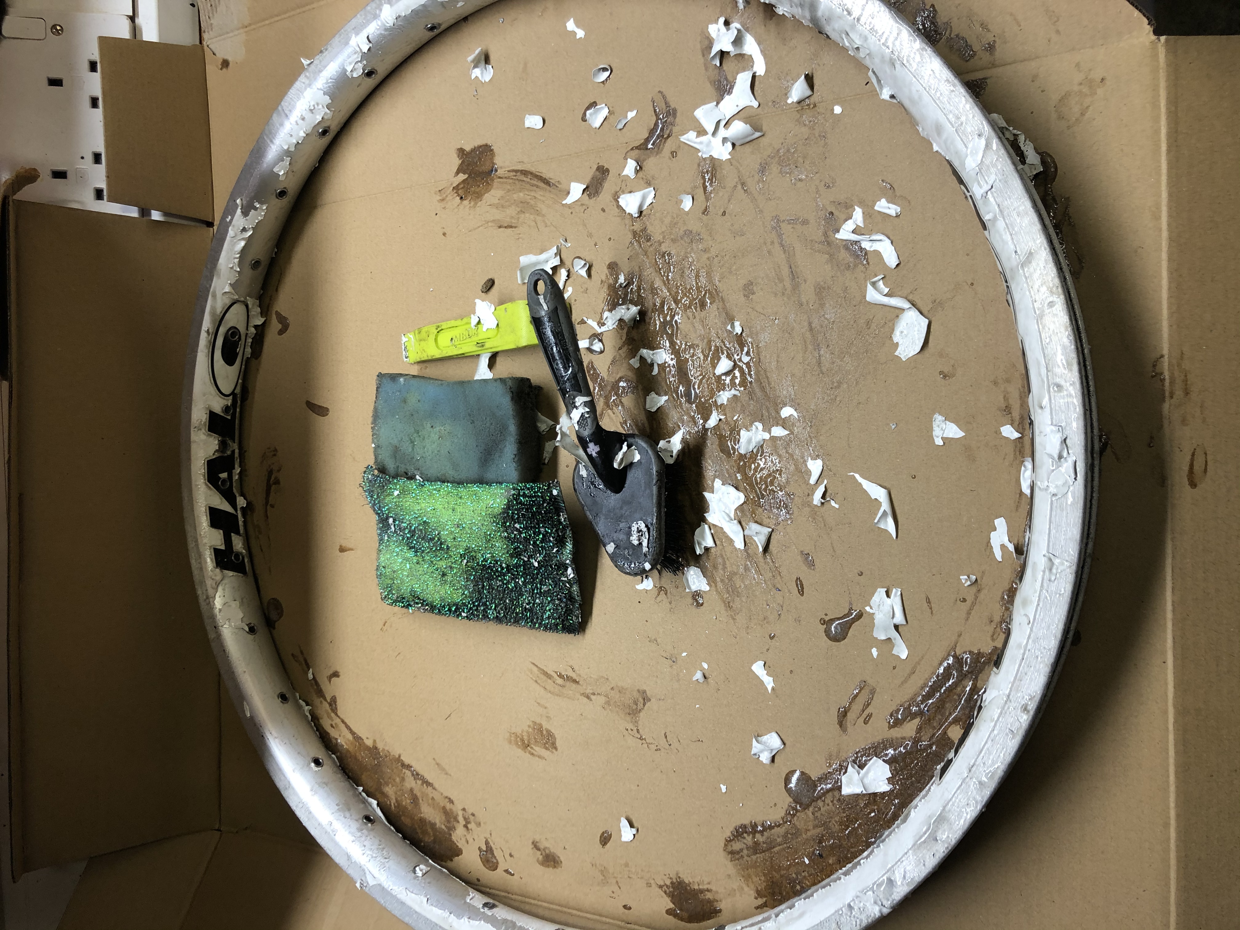

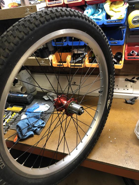

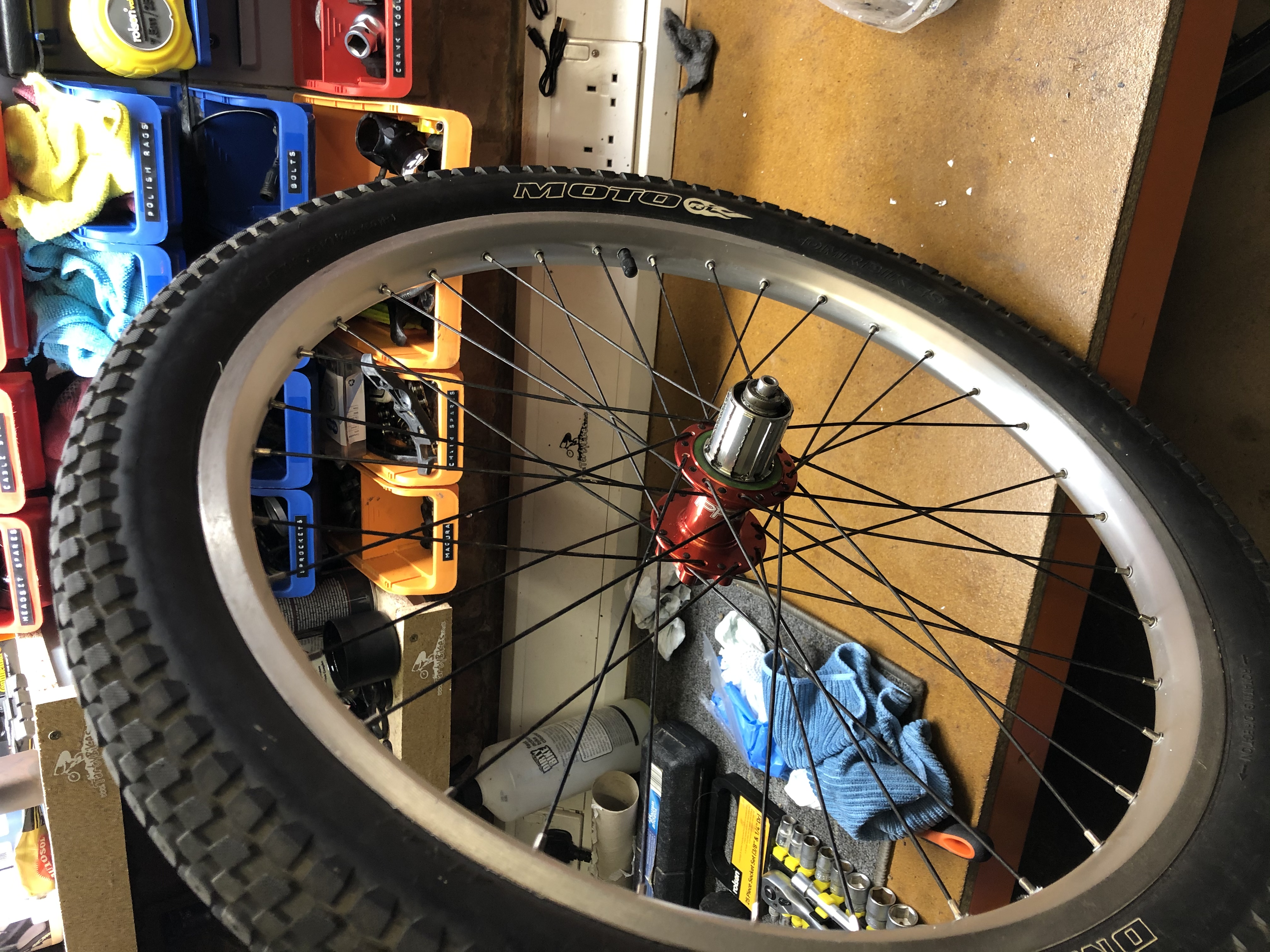

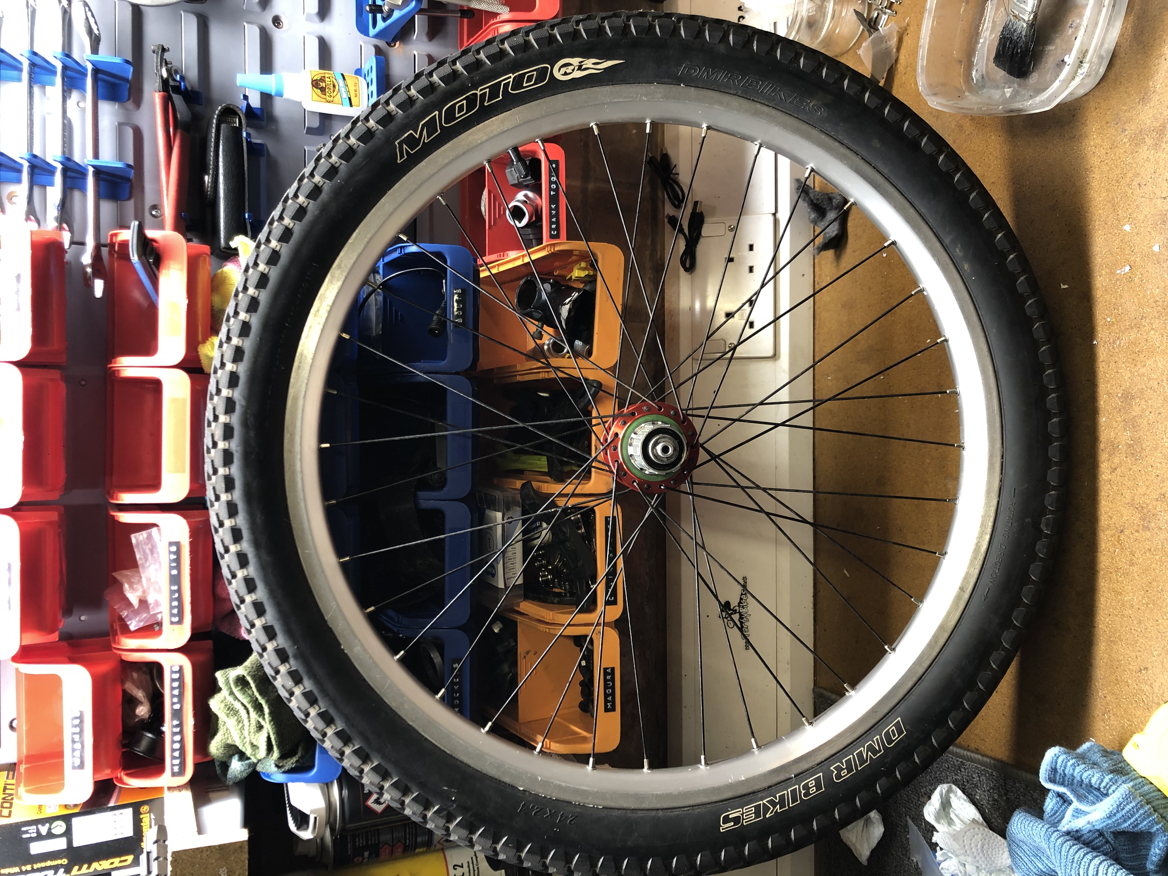

Private Repress Posted February 23, 2021 Author Report Share Posted February 23, 2021 (edited) Once I’d cracked the original white paint it all started to peel much easier. eventually I got to this: thankfully this free’d up the spoke nipples so I could take it apart. Once done I rebuilt it onto the spare Hope hub: after truing it I cleaned up some old DMR motos and fitted one... Pretty pleased with the results. Considering how poor the rim looked on the old build I never really thought I’d make any use of it. Really do get a kick out of bringing old bits back to life. Edited February 23, 2021 by Private Repress Typo 4 Quote Link to comment Share on other sites More sharing options...

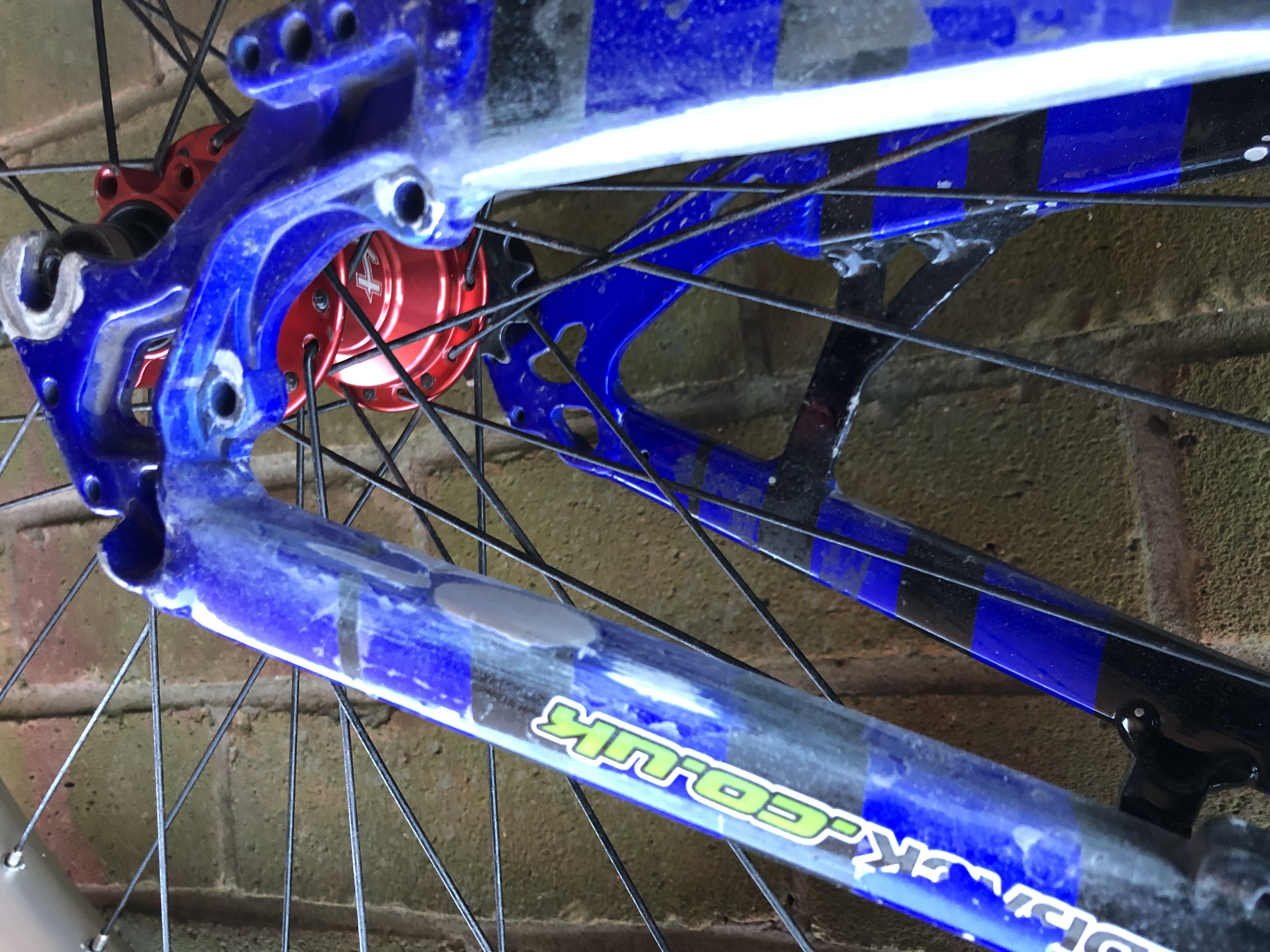

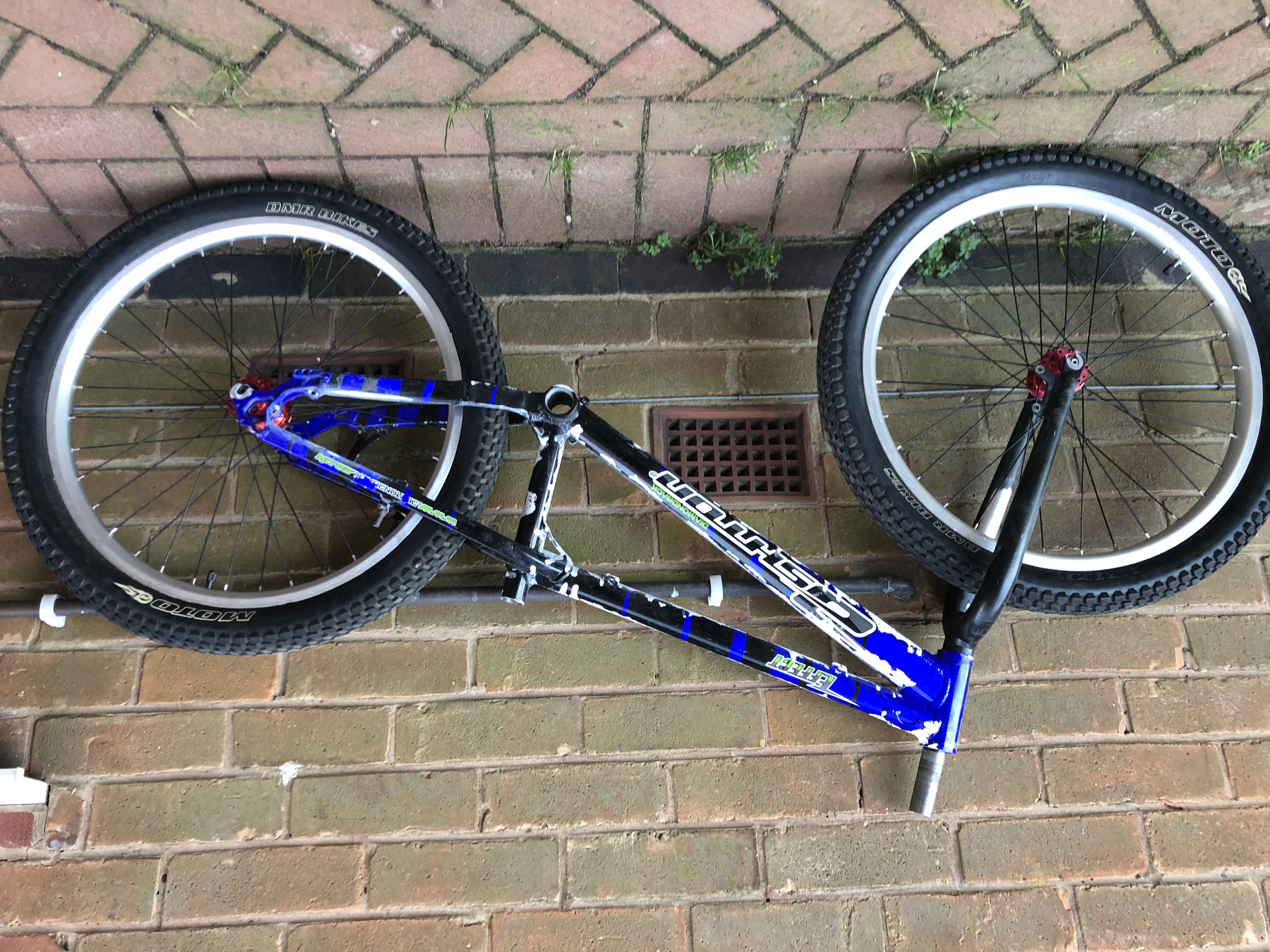

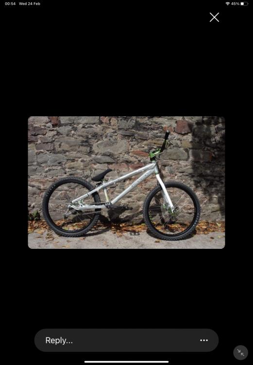

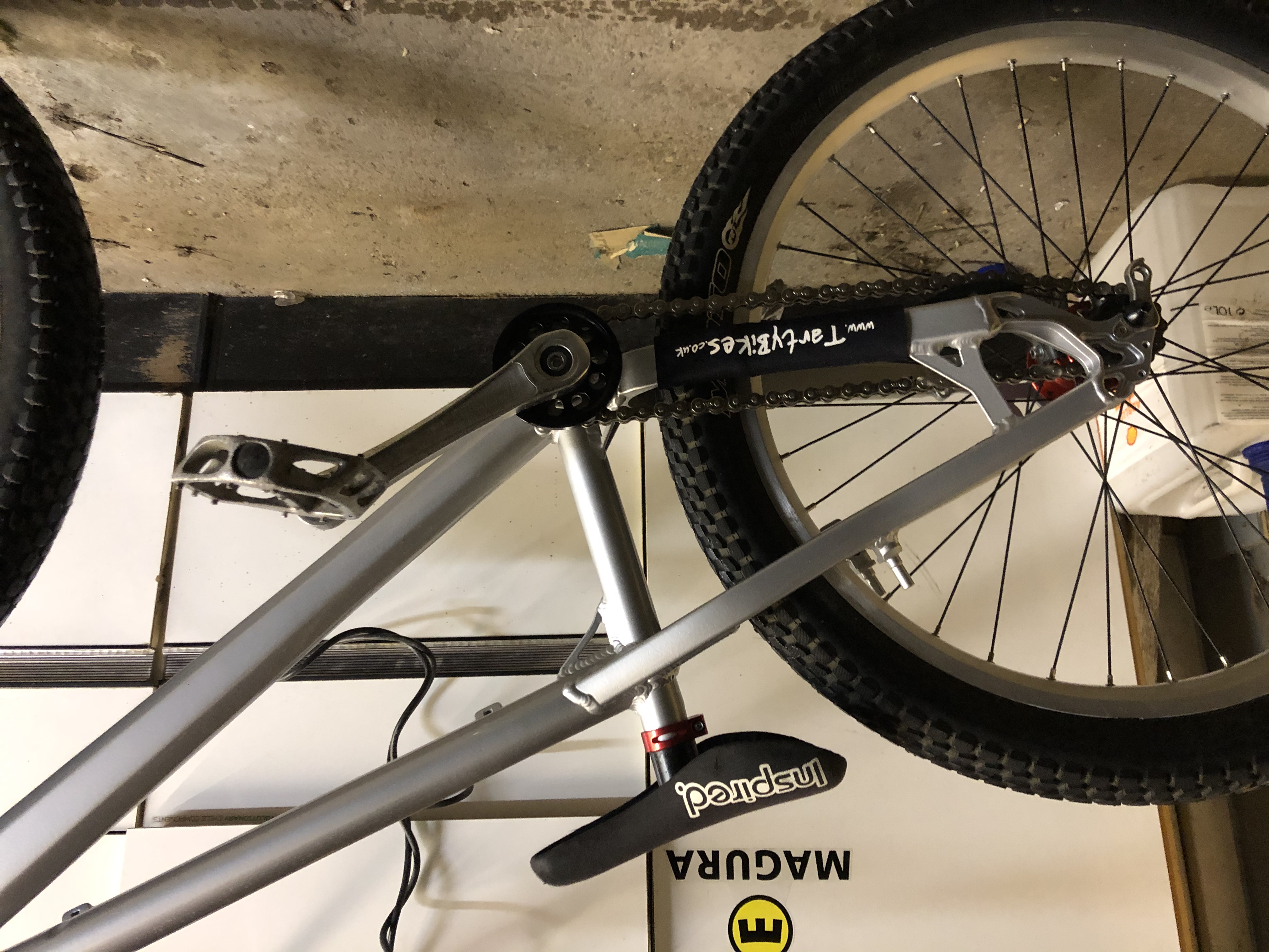

Private Repress Posted February 23, 2021 Author Report Share Posted February 23, 2021 Speaking of old bits, this will be the back wheel for a proper mash up of parts. I’ll probably update the title on this thread as I get more done and share progress on the unusual build. a sneak peek of what’s to come haha: 3 Quote Link to comment Share on other sites More sharing options...

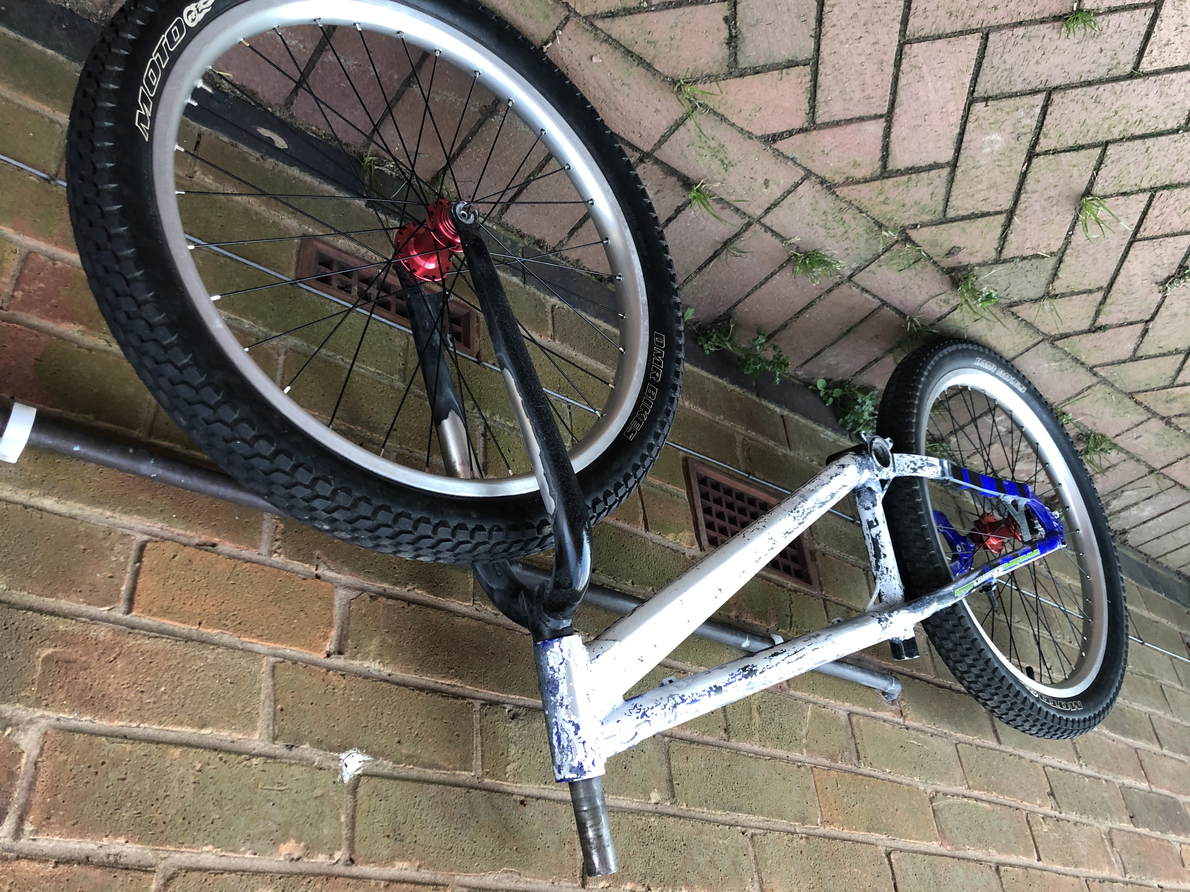

Ross McArthur Posted February 23, 2021 Report Share Posted February 23, 2021 Build a bike round a spare hub you had. Literally any one spare part is the start of a new build haha. Been there. And probably going to go there again at some point. Wheel looks great and I do love a 2.4 24” Moto. Go to tyre before the Contis. 1 Quote Link to comment Share on other sites More sharing options...
Private Repress Posted February 23, 2021 Author Report Share Posted February 23, 2021 11 minutes ago, Ross McArthur said: Build a bike round a spare hub you had. Literally any one spare part is the start of a new build haha. Been there. And probably going to go there again at some point. Wheel looks great and I do love a 2.4 24” Moto. Go to tyre before the Contis. @Ross McArthur Mate it’s out of hand! was thinking exactly the same thing the other day.. ‘Oh I’ve found a single HS33 pad, a bike must be built to use it’ haha. To be fair this was the original foundation for a Frankenstein bike that turned into a showroom condition fourplay. But I’m setting rules for myself on this one... 1. No parts purchased unless I can’t repair what I have or I don’t have a variant of it. 2. Said parts required must be second hand 3. Additional money may be spent on paint job, but to keep it really budget... and more in keeping with Rowans proto bike (a nod to the good old days), sandblasting the frame silver is most likely. (Thanks for the photo and the inspiration on this one Ross). 4. I may not talk about about fight club I have already broken rule 2 as I didn’t fancy a second hand headset, so got a ODP one for less than a tenner. Picked up an angle grinder disc tonight to finish off what I started a little while back on the frame... smoothing off those gear cable guides. Once done I’ll get some pics up before dropping it off to be sandblasted - the paint stripper barely touches the paint on this bike, and even when it does finally come off, there is a white layer underneath that appears to be able to withstand all but a nuclear fallout. 1 Quote Link to comment Share on other sites More sharing options...

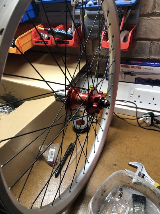

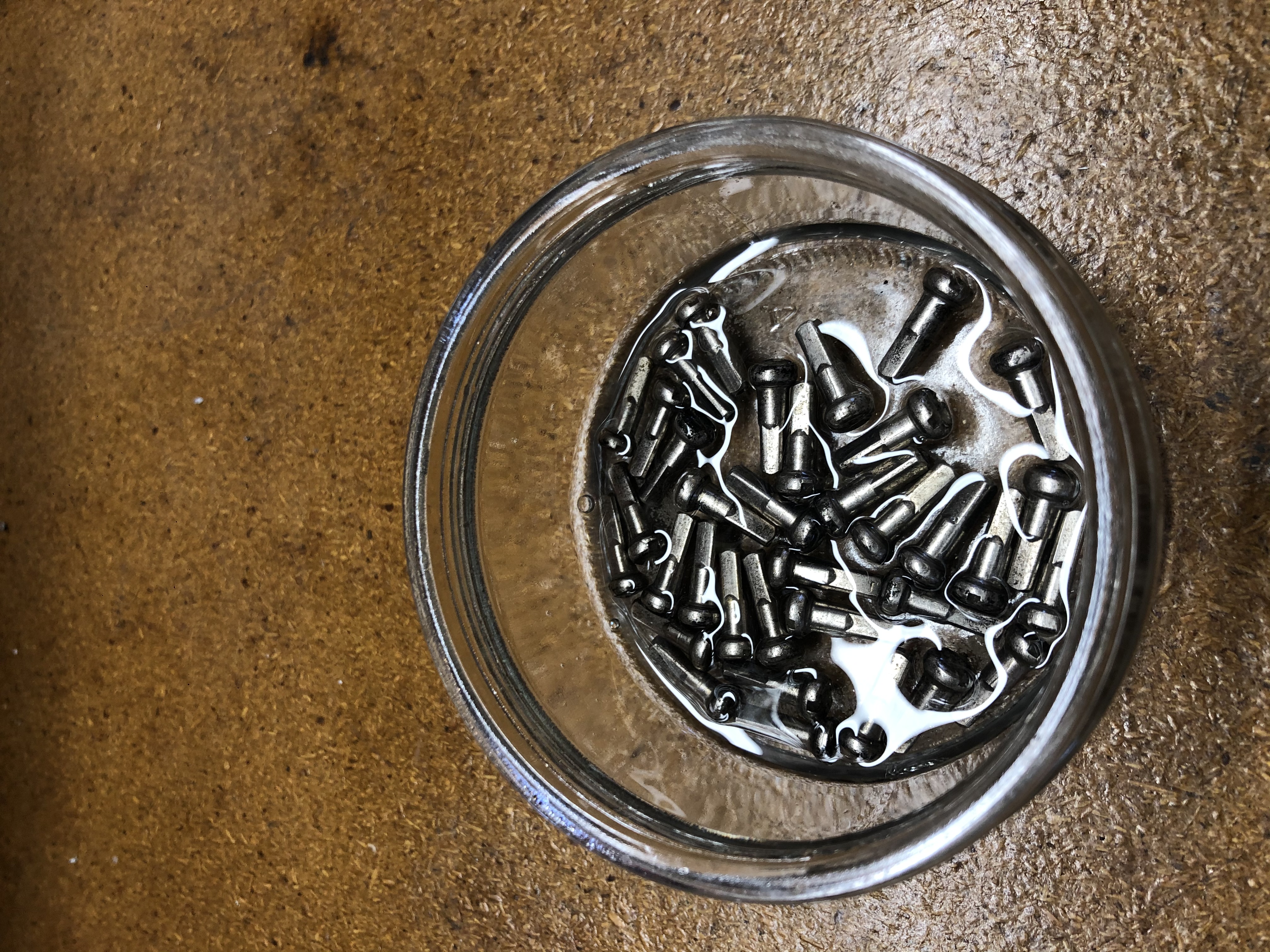

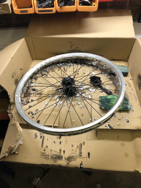

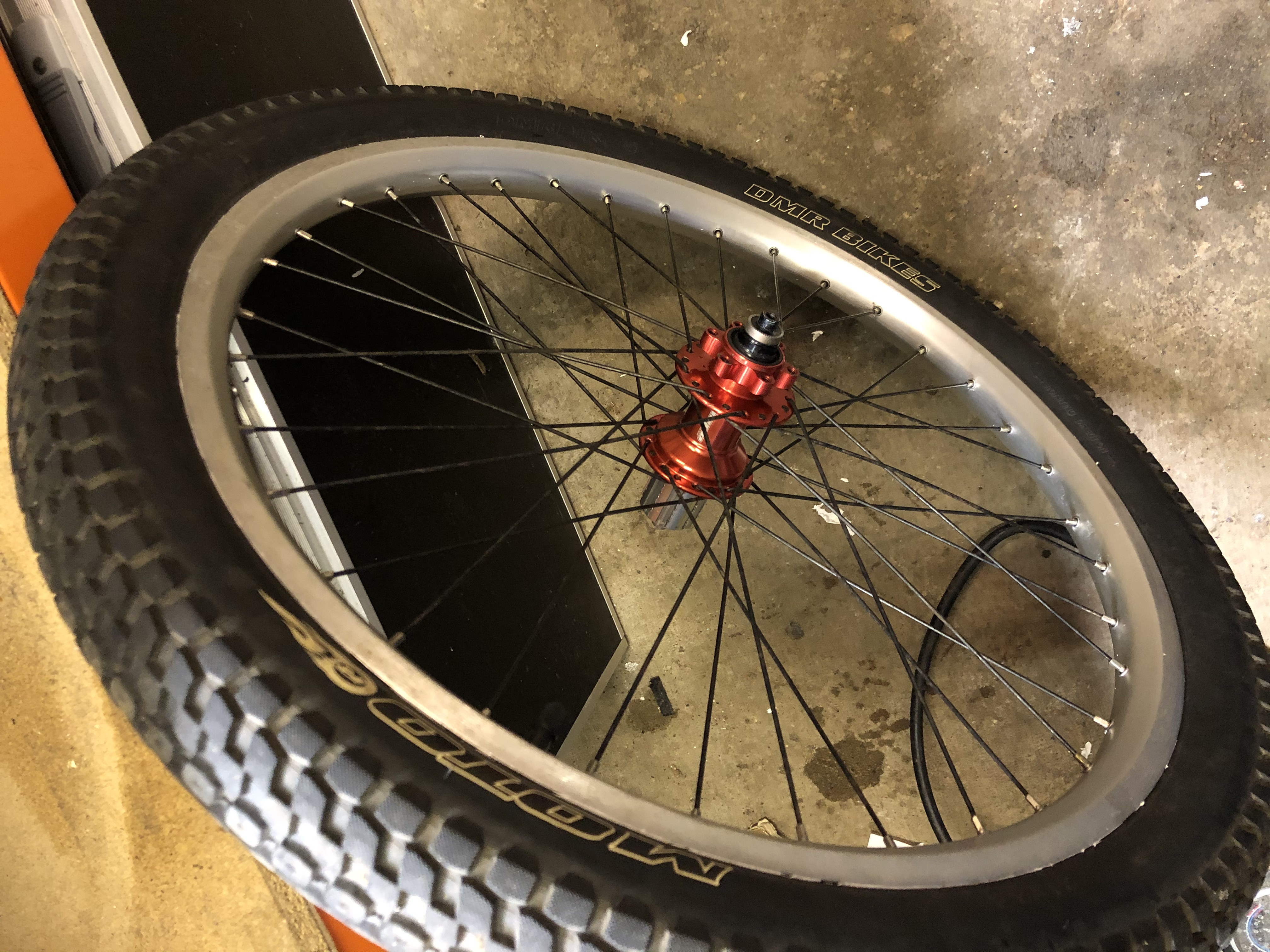

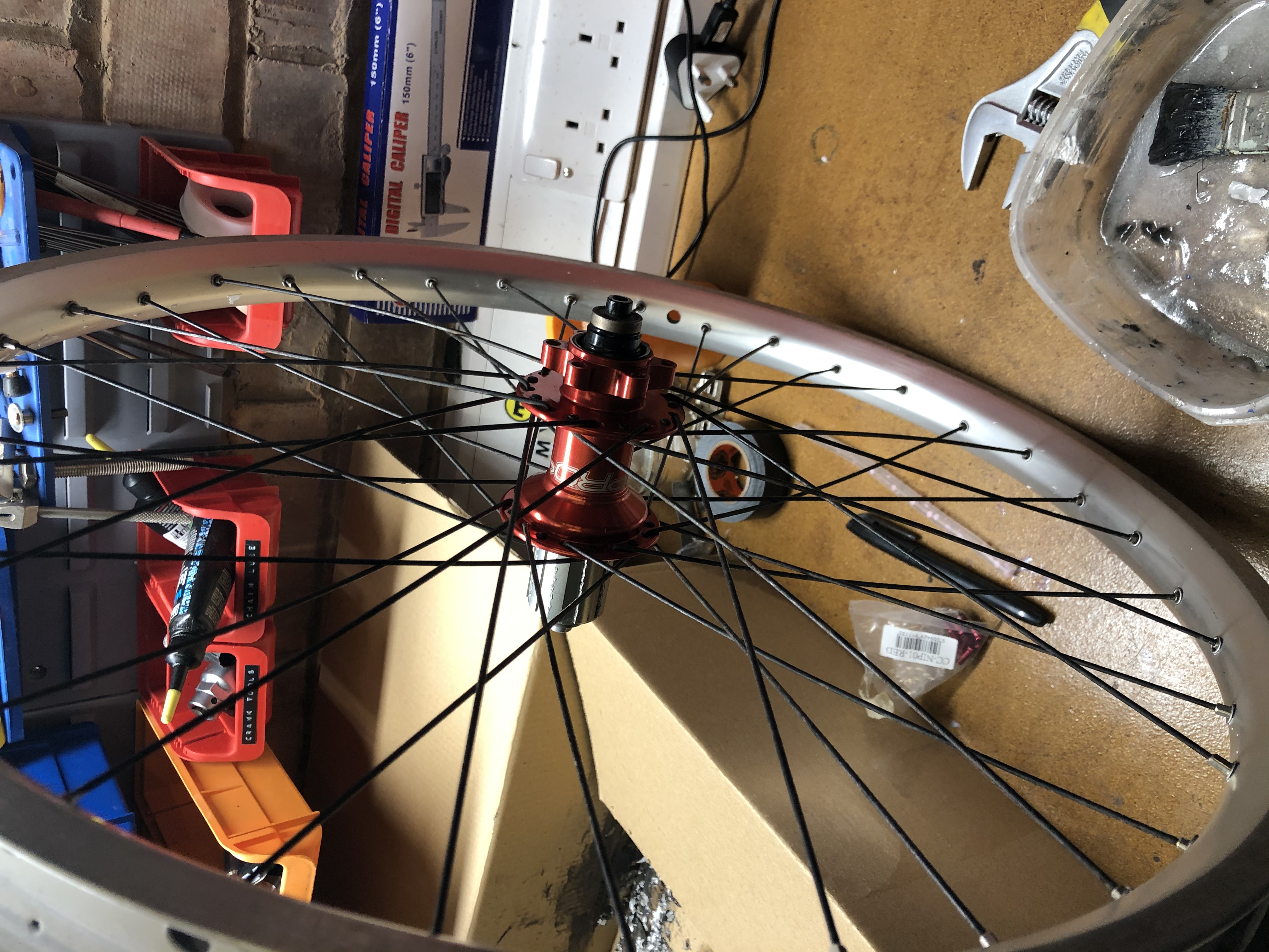

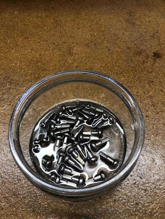

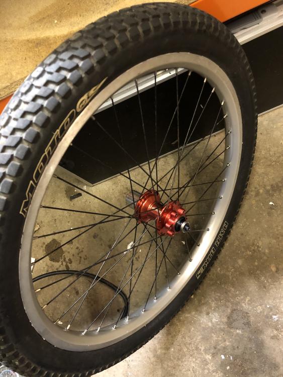

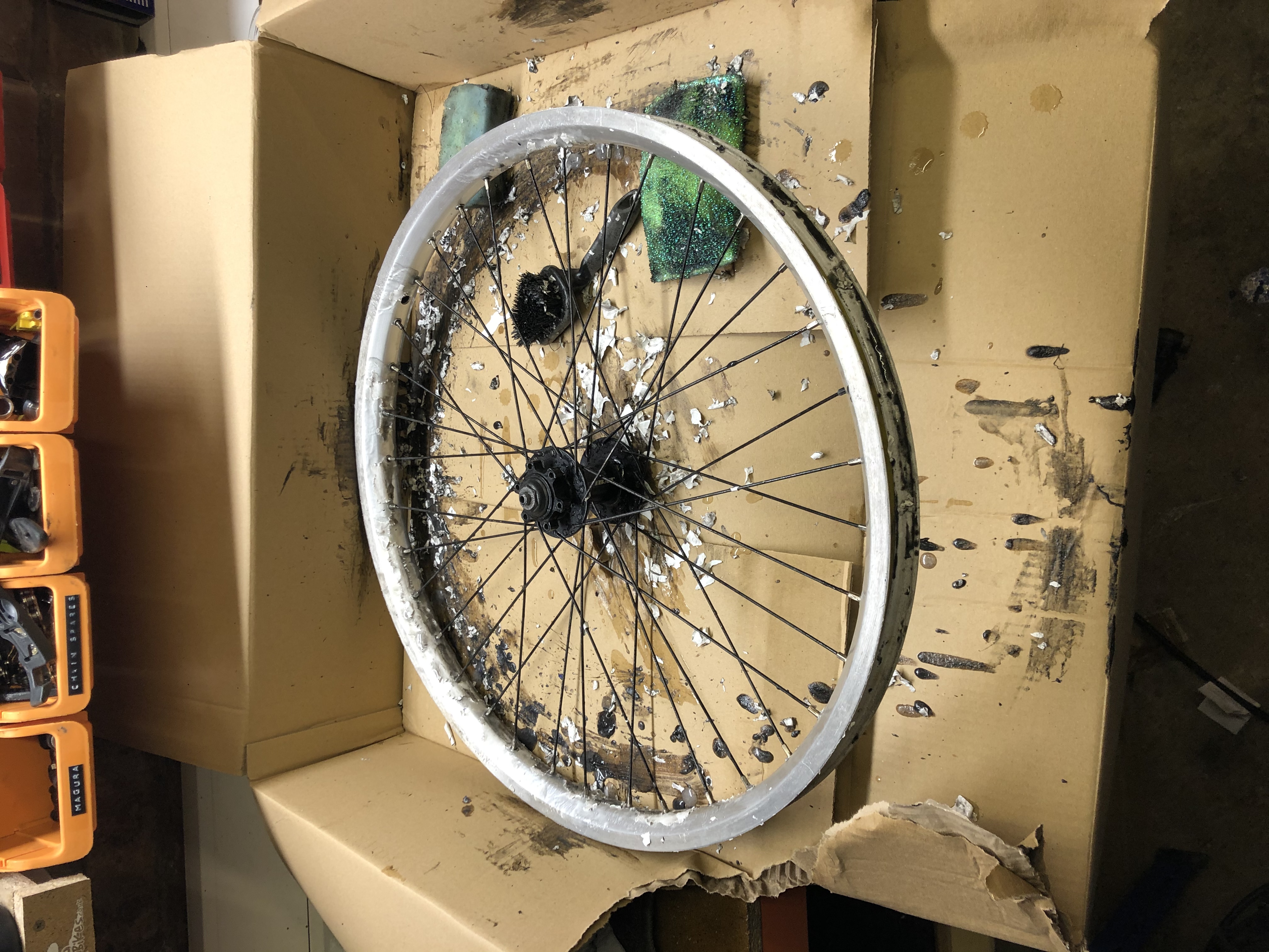

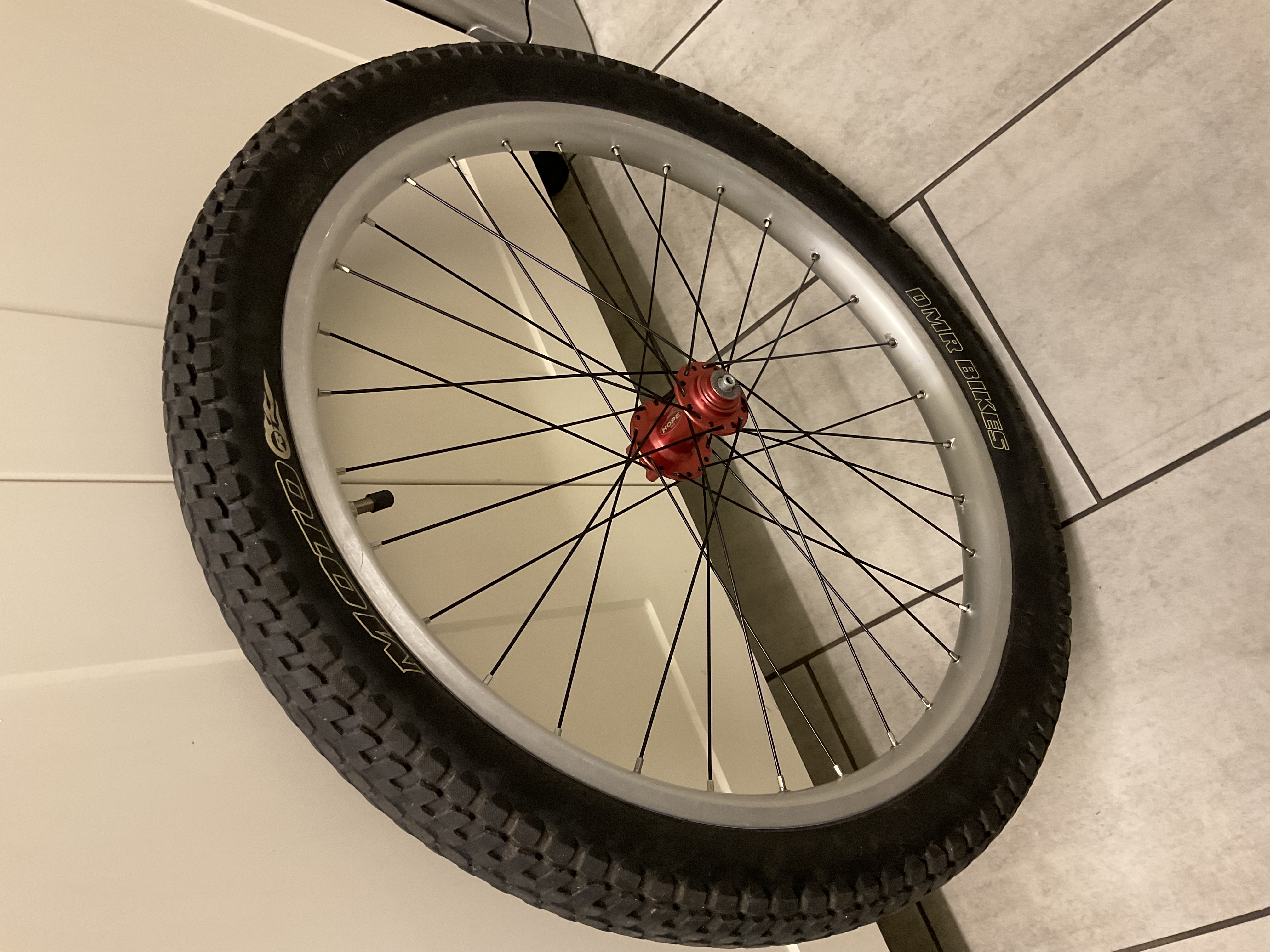

Private Repress Posted February 24, 2021 Author Report Share Posted February 24, 2021 Front rim has arrived smothered it in paint stripper between work calls today It’s coming along nicely so hoping that I’ll be able to get the XC hub built onto it later. Also cleaned up the old spike nipples, paint stripper soak them shook them in a tub with some sand, finally left them to soak in oil, they’ve come up okay too and finally an idea of what the frame will look like silver - Rowan John’s old bike (sorry about the poor image quality) Quote Link to comment Share on other sites More sharing options...
Private Repress Posted February 24, 2021 Author Report Share Posted February 24, 2021 Front wheel built 1 Quote Link to comment Share on other sites More sharing options...

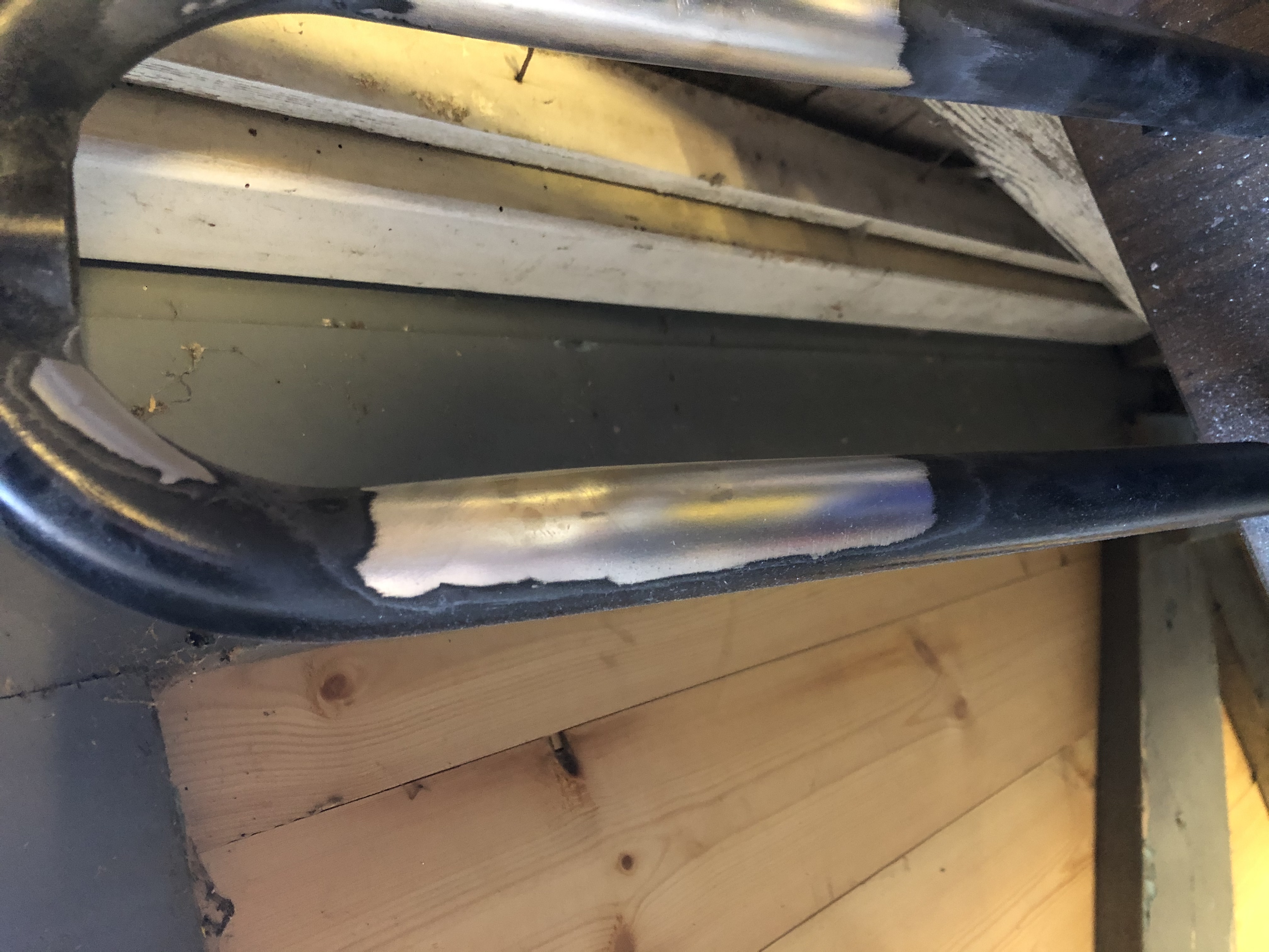

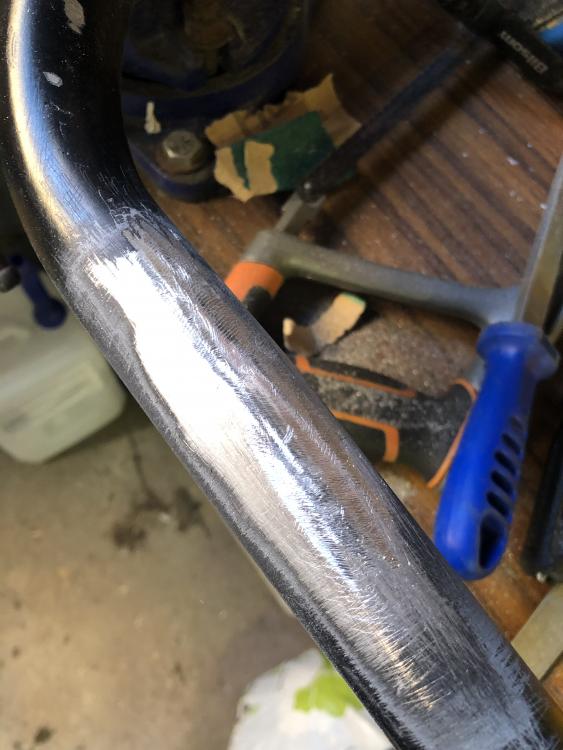

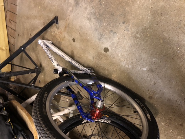

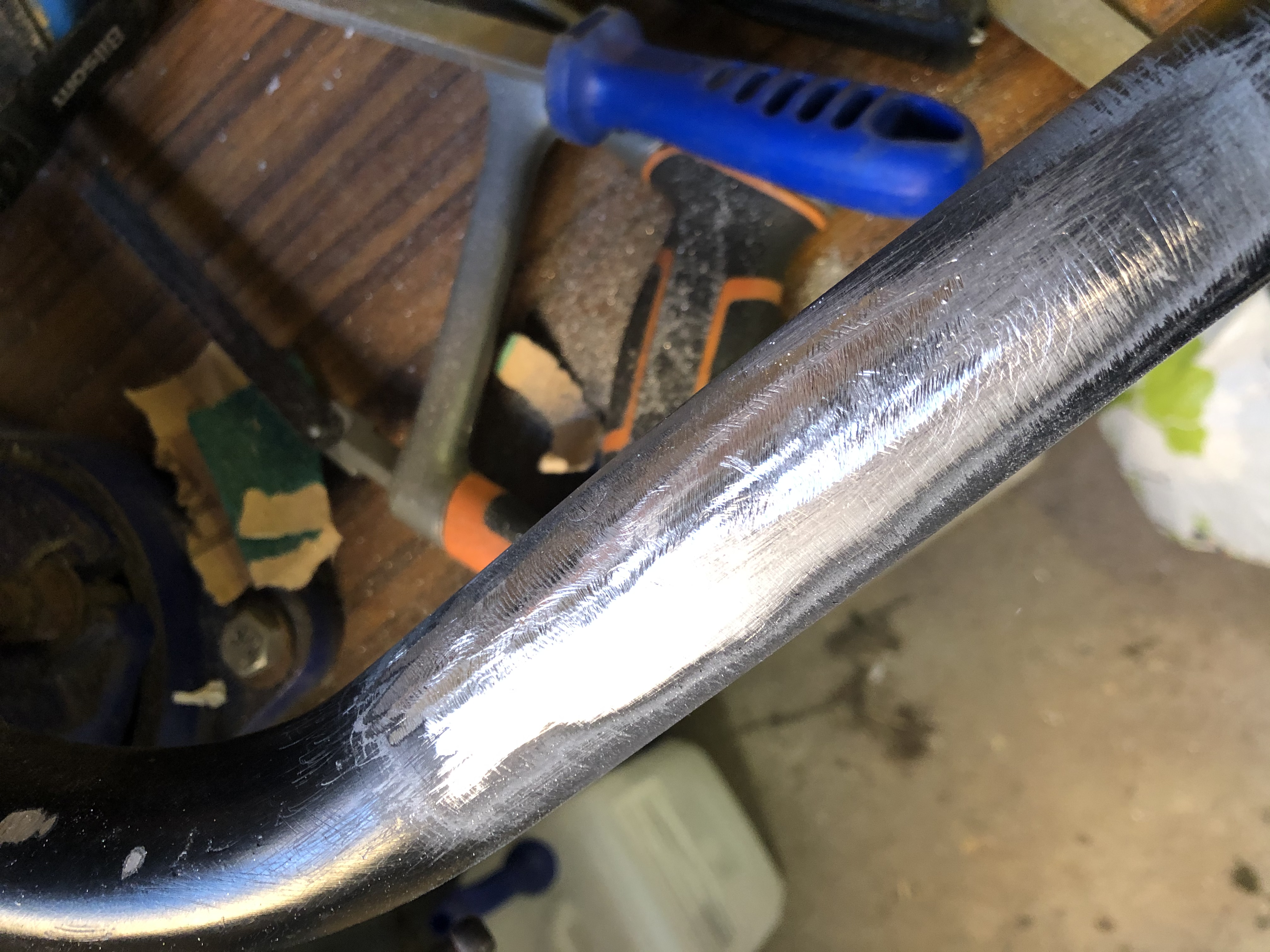

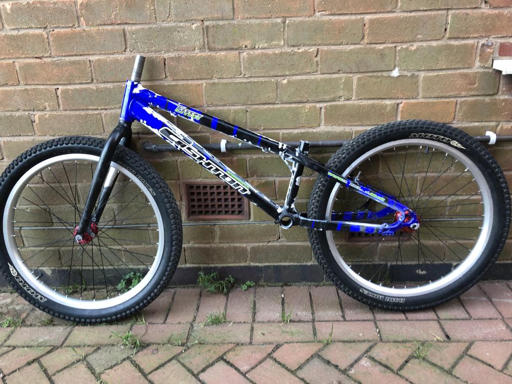

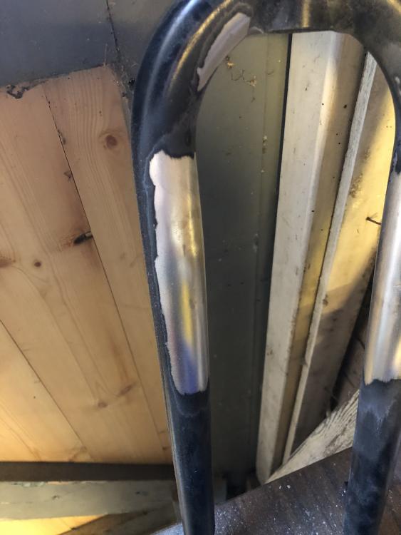

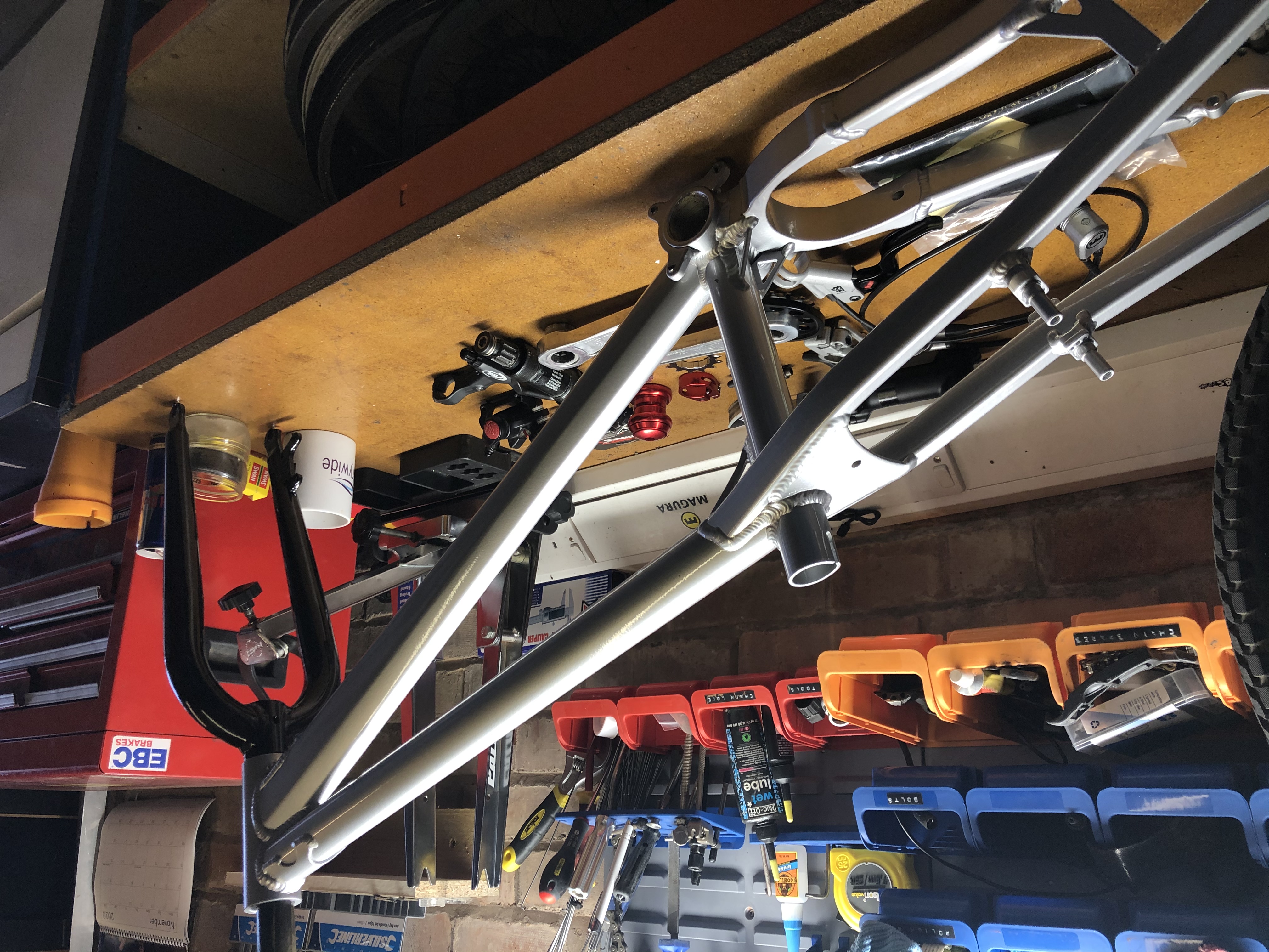

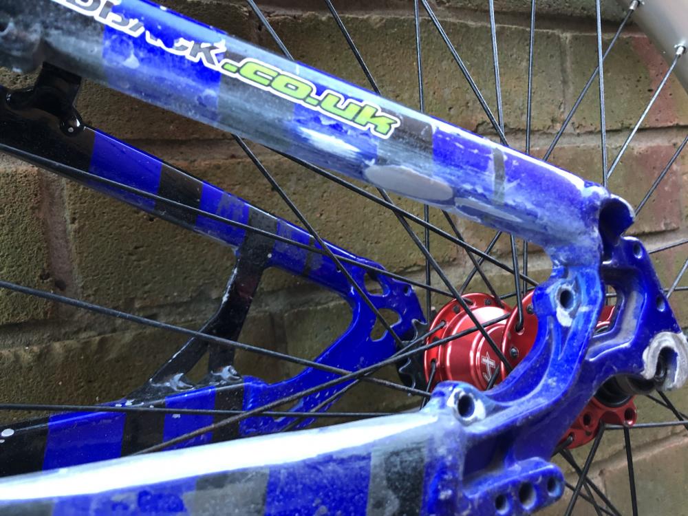

Private Repress Posted February 25, 2021 Author Report Share Posted February 25, 2021 Also managed to spend an hour on the Diamondback Ashton frame with an angle grinder. The disc mount strap had been cut by the previous owner to accommodate a calliper that didn’t fit. So I’ve smoothed that off... the gear cable mounts have gone too. the forks that came with the bike had the brake mounts hacked at with a hacksaw. Took the opportunity to smooth these down too, although they are for the Planet X Zebdi. This may have to have Onza zoot forks, unless something straight pops up cheap. shame because these forks do look the shizz on the rolling chassis! hoping I might be able to get the frame in to he shot blasted tomorrow Quote Link to comment Share on other sites More sharing options...

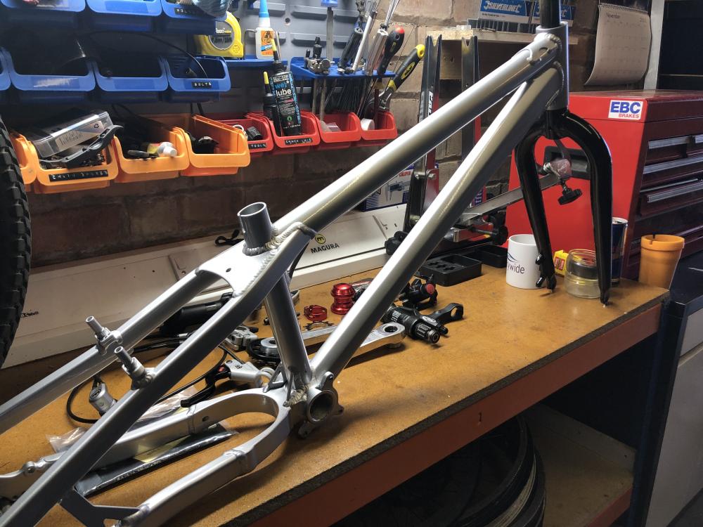

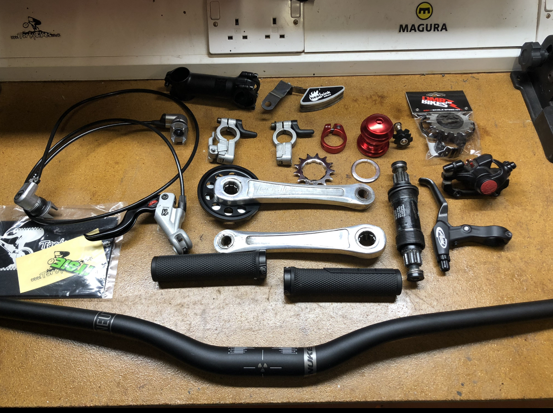

Private Repress Posted March 2, 2021 Author Report Share Posted March 2, 2021 Frame and forks are being collected tomorrow afternoon so thought I’d get most of the remaining parts out ready to fit: Looking forward to this, especially thanks to these little beauts that are in the post: thanks for hooking me up @Ross McArthur in other news I’ve managed to bag some echo urban disc only forks from eBay. Get in! they’ll either go on the Zebdi or this. I’ll see what mood I’m in when I begin the build. I’m steering towards having the Ashton forks on this now. 1 Quote Link to comment Share on other sites More sharing options...

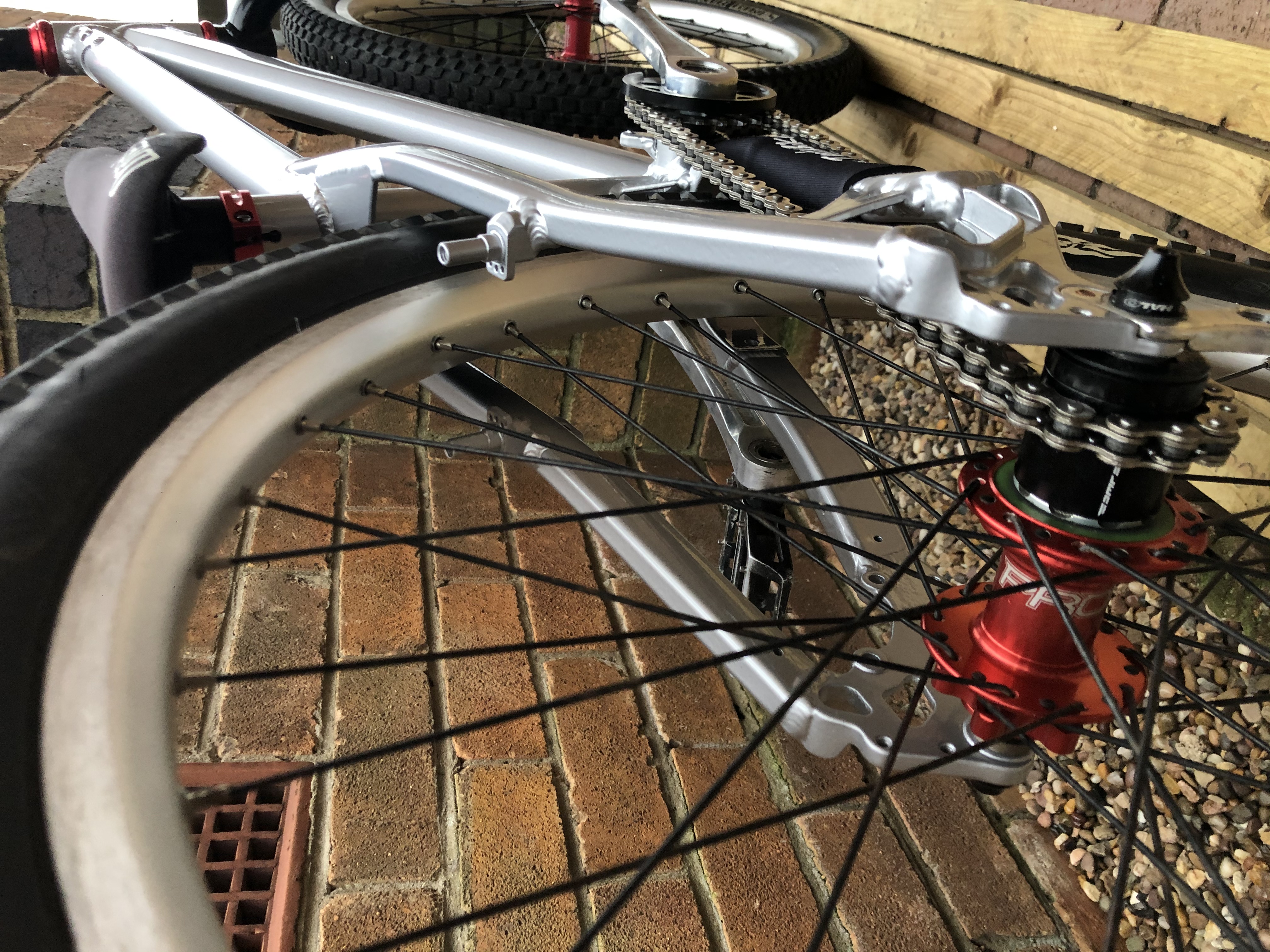

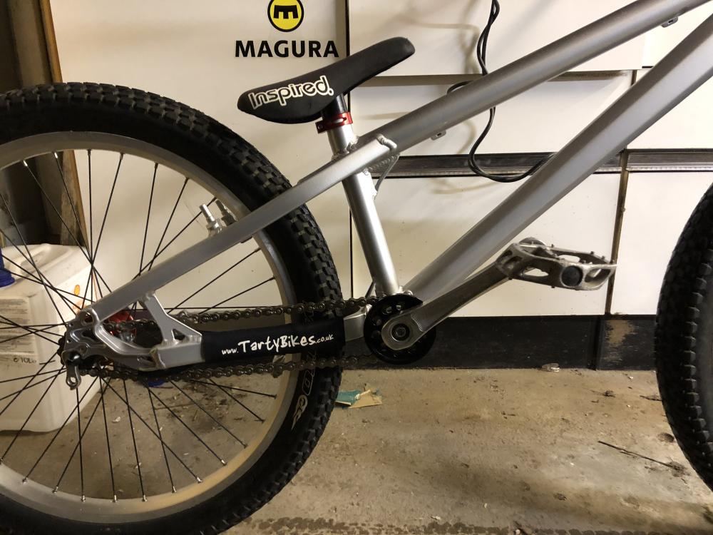

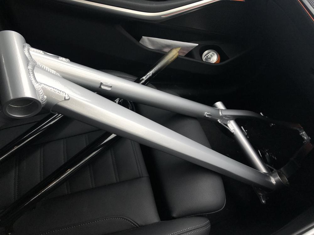

Private Repress Posted March 3, 2021 Author Report Share Posted March 3, 2021 Collected the frame and forks today looks so so good in the flesh! 2 Quote Link to comment Share on other sites More sharing options...

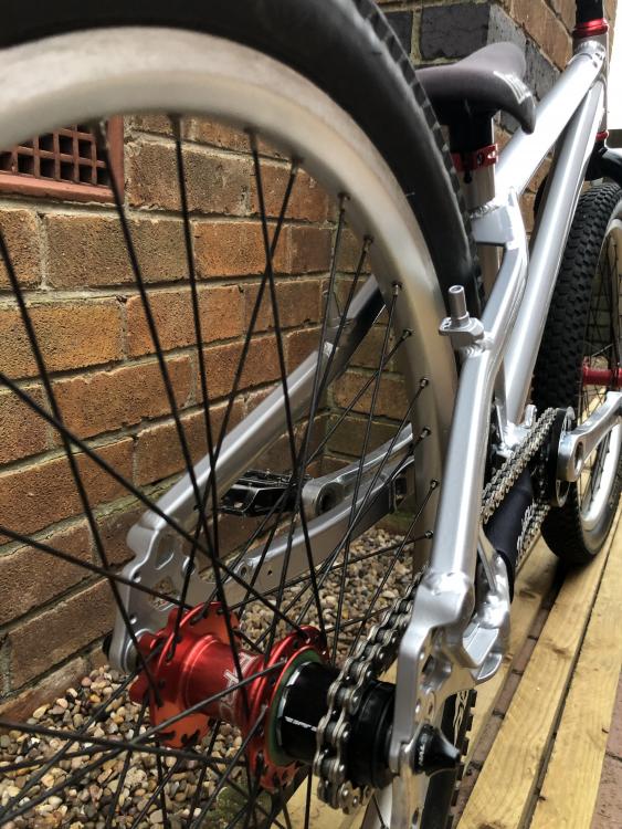

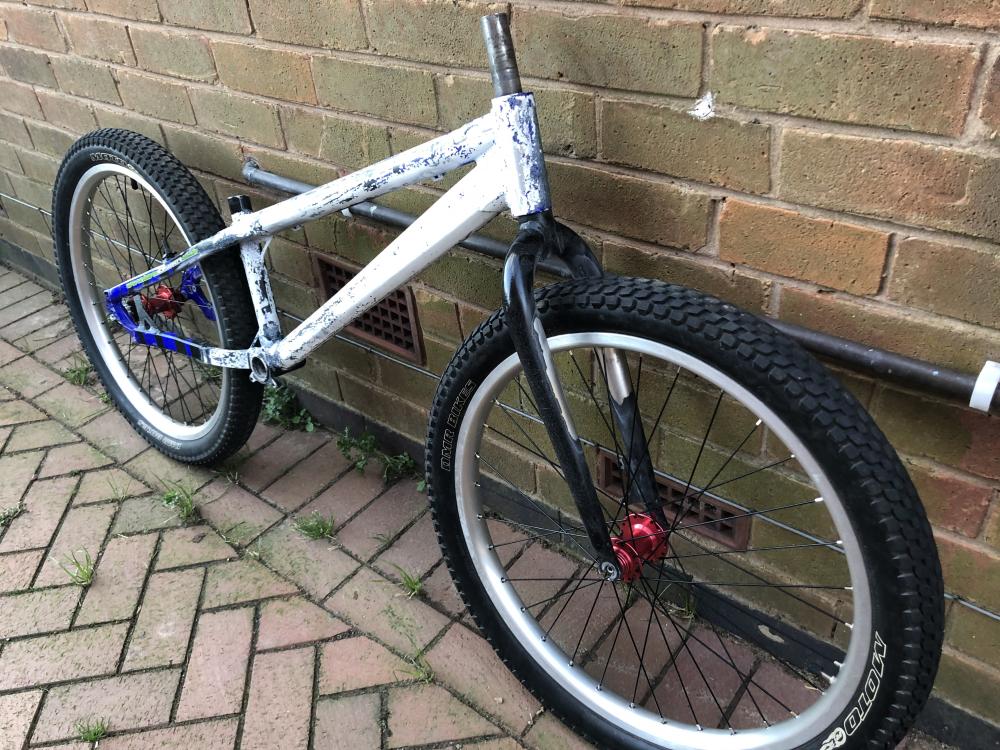

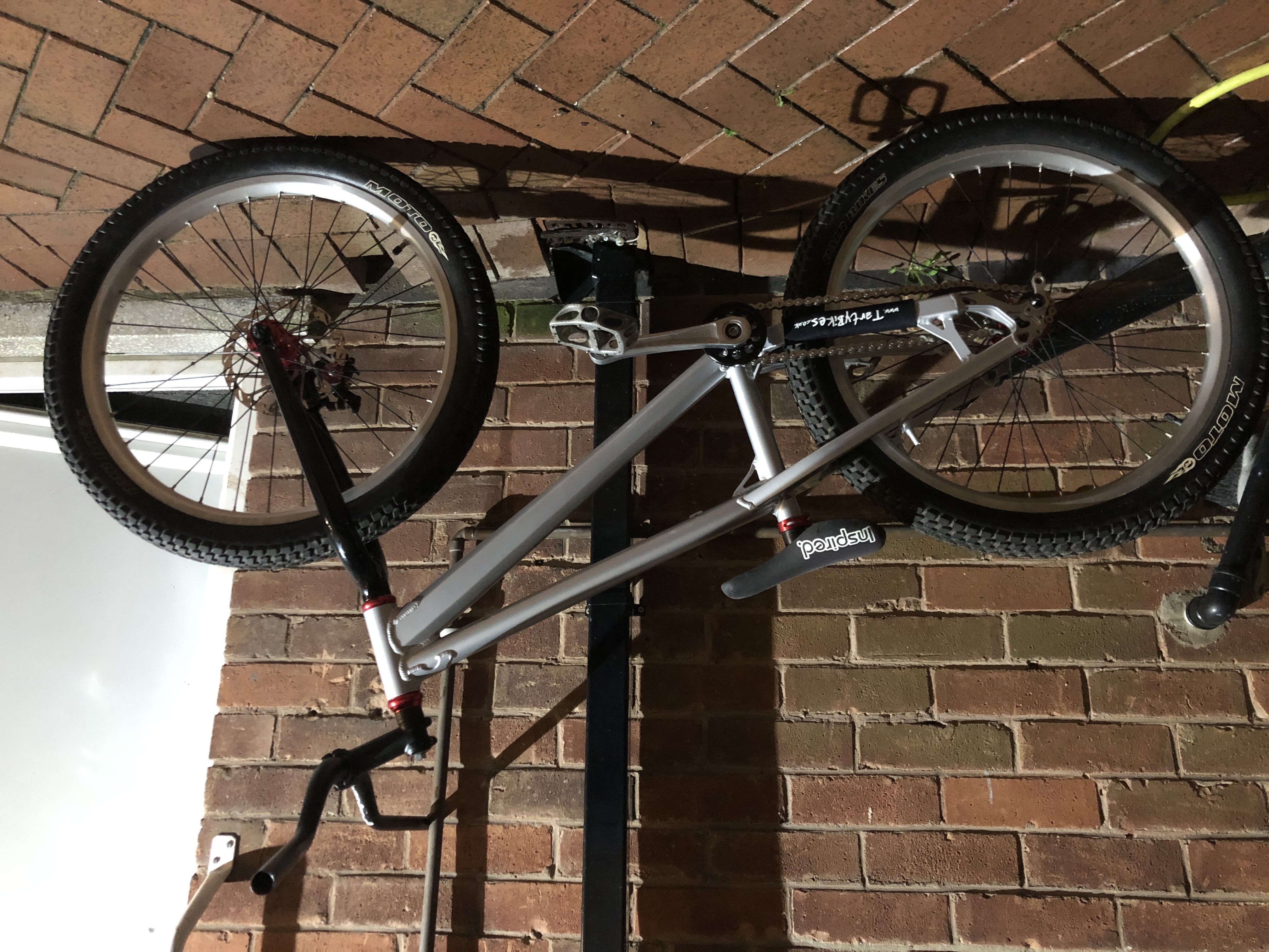

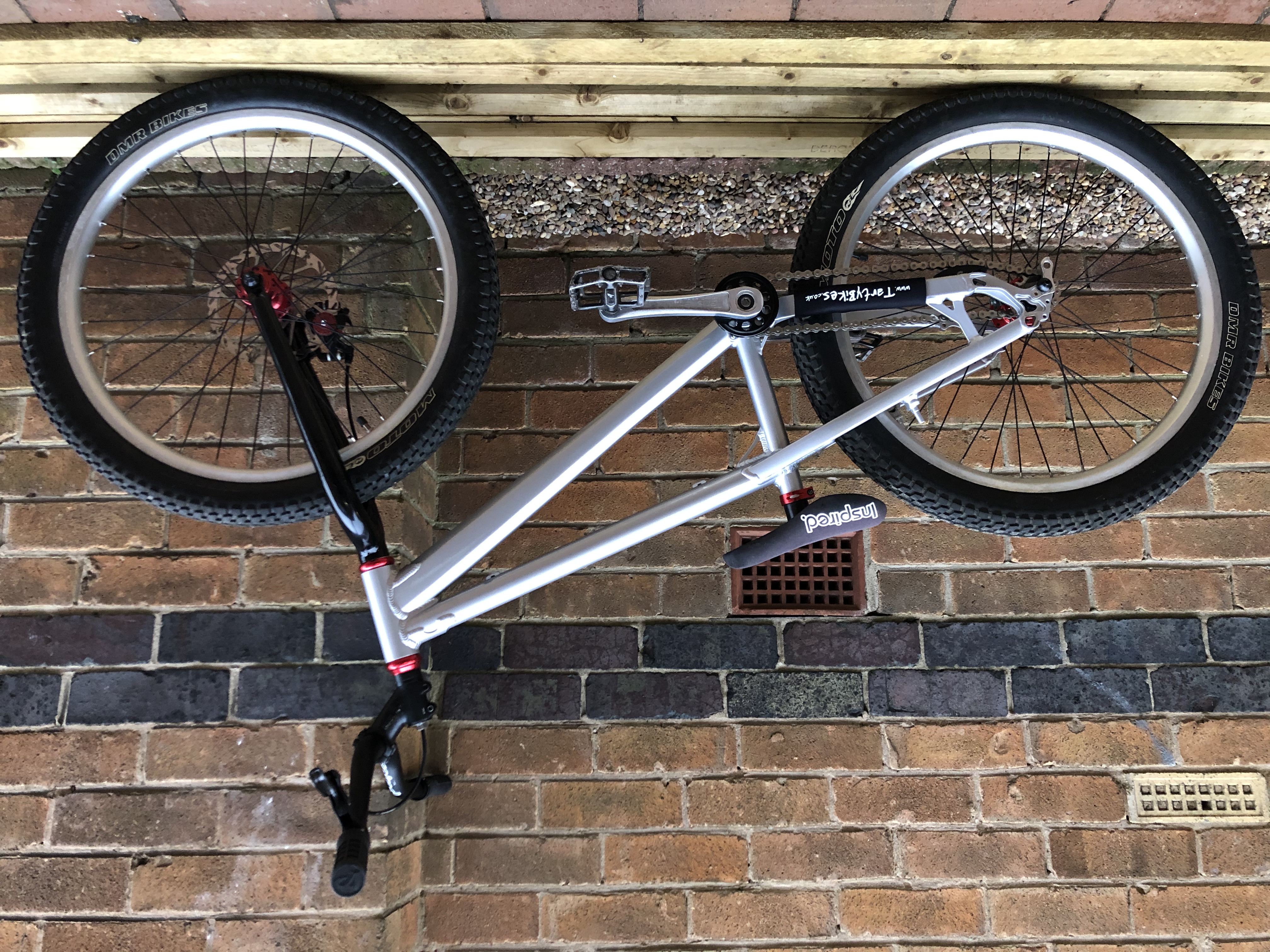

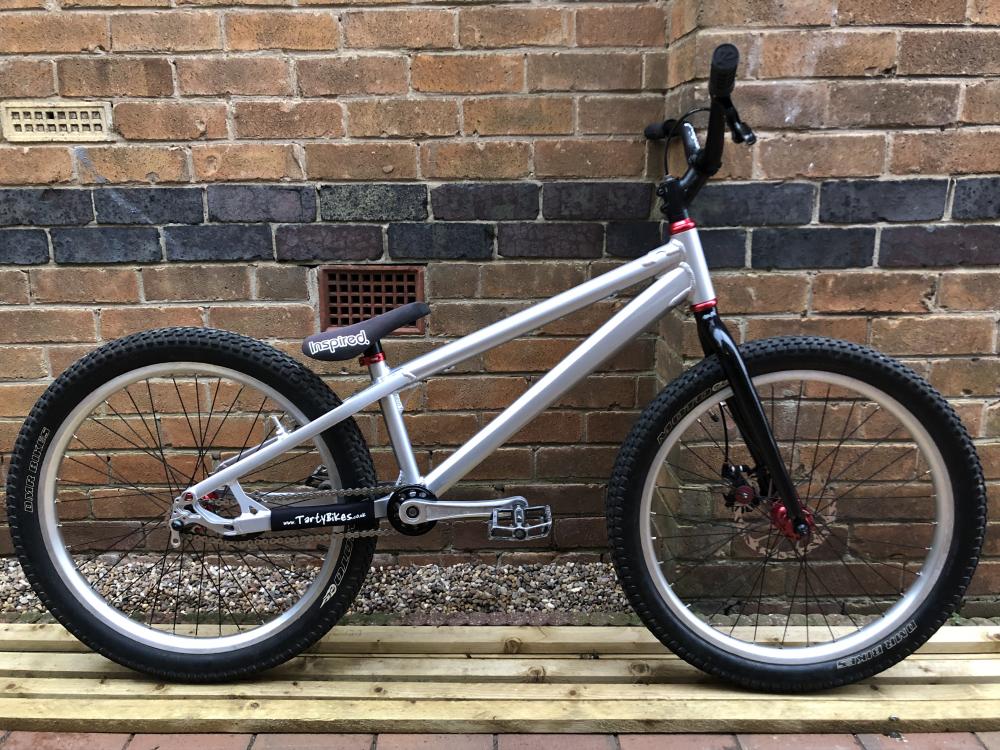

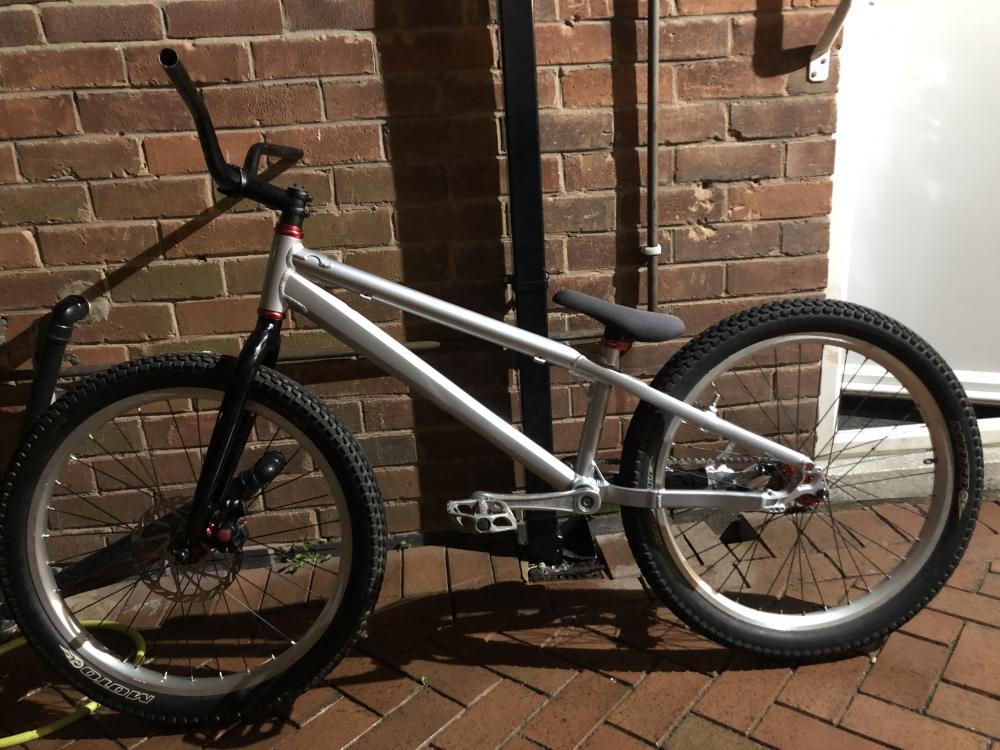

Private Repress Posted March 3, 2021 Author Report Share Posted March 3, 2021 After an hour or so in the garage this evening this is how far I got: A quick roll around tells me the front feels a bit low for my liking so the 80x40 stem will be going on. Quote Link to comment Share on other sites More sharing options...

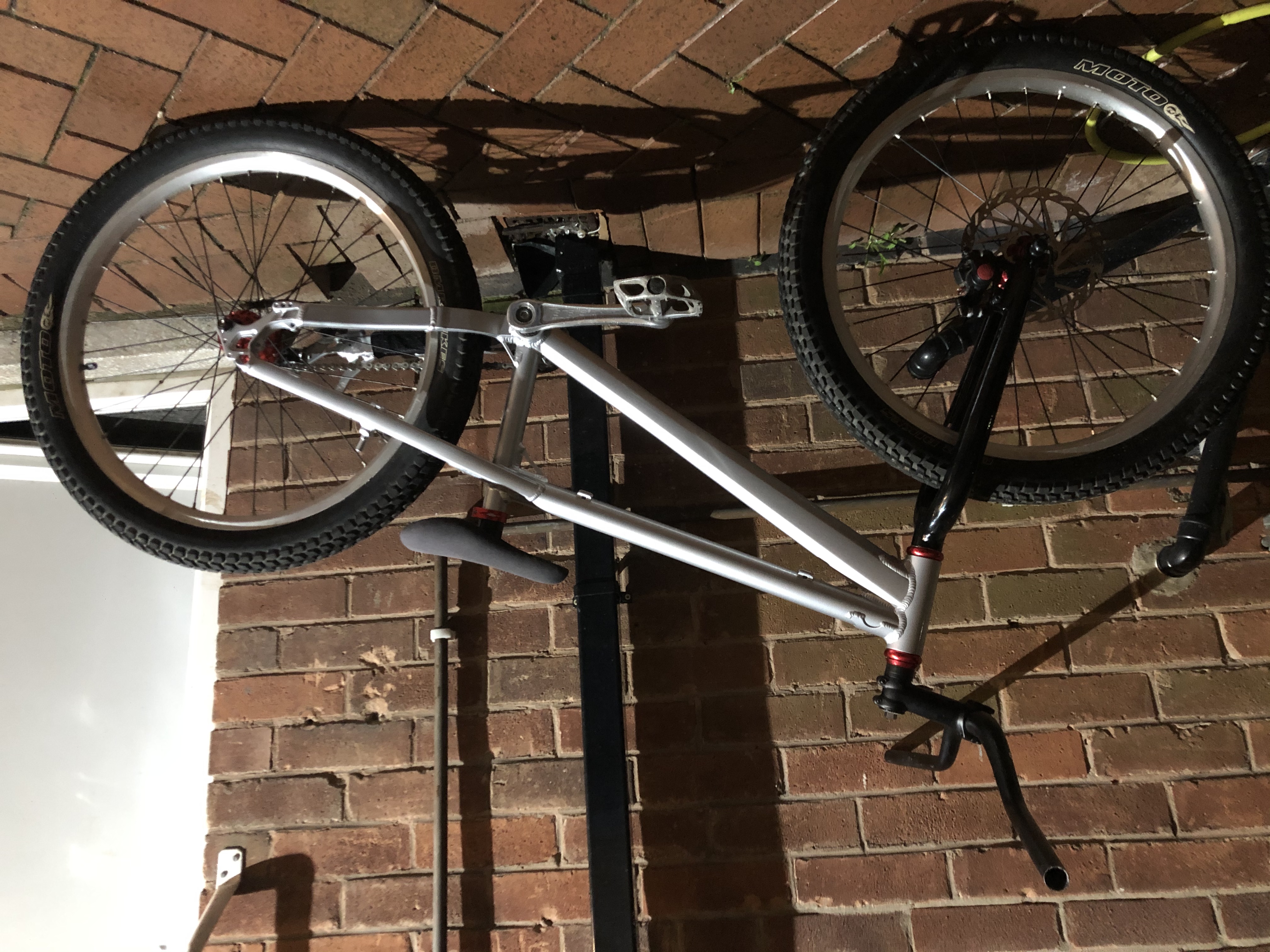

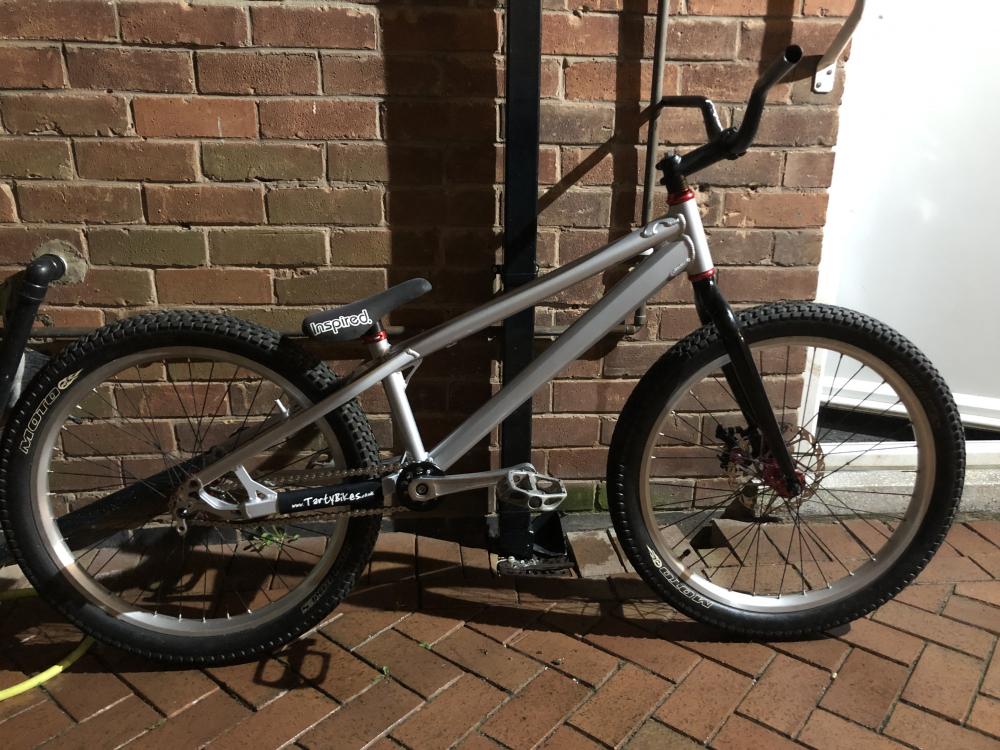

Private Repress Posted March 4, 2021 Author Report Share Posted March 4, 2021 A bit more work on it this morning and some clearer images, this stem feels much better 6 Quote Link to comment Share on other sites More sharing options...
