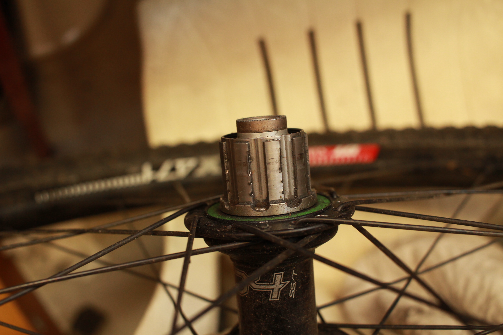

La Bourde Posted January 12, 2021 Report Share Posted January 12, 2021 5 hours ago, isitafox said: Power put through a DJ drivetrain is nothing like the power put through a trials drivetrain, especially for a big chunk of sexiness like Luke Depends if the rider is riding some street ... I bought a pro 4s from a dj/street rider and even the steel freewheel body had some deep scratches, so that I had to file them to put a cog on. Guess when one is doing 180 halfcab with 30km/h (with a bitch crank) you have almost the same torque there. Quote Link to comment Share on other sites More sharing options...

La Bourde Posted January 12, 2021 Report Share Posted January 12, 2021 (edited) I agree with you if you use thin sprockets (and it will be even worse with an alloy body). But the scratches are wide (5-6mm) on this hub and it is a steel body, as I mentioned. I have another Pro 4s, that I use now for 2-3 years for trial and the scratches are not so bad. Before I had a pro II ss and the scratches weren't that bad too. Maybe this is due to the kinetic energy, that can be much important riding street. The chain/cogs on a dj/street bike are typically 1/8" wide. Edited January 12, 2021 by La Bourde Quote Link to comment Share on other sites More sharing options...
Paperclip Posted January 13, 2021 Author Report Share Posted January 13, 2021 15 hours ago, La Bourde said: I agree with you if you use thin sprockets (and it will be even worse with an alloy body). But the scratches are wide (5-6mm) on this hub and it is a steel body, as I mentioned. I have another Pro 4s, that I use now for 2-3 years for trial and the scratches are not so bad. Before I had a pro II ss and the scratches weren't that bad too. Maybe this is due to the kinetic energy, that can be much important riding street. The chain/cogs on a dj/street bike are typically 1/8" wide. I have a pro 4 hub that is currently been okay since 2017. I got a new hope pro 4 2020 and that's been my issue. Without me having the same failure in the first (2017) hub I can't find out if the threads are different or not. My current hub Hope didn't use locktite but a bonding to try avoid this happening but I can't see it working. Quote Link to comment Share on other sites More sharing options...
