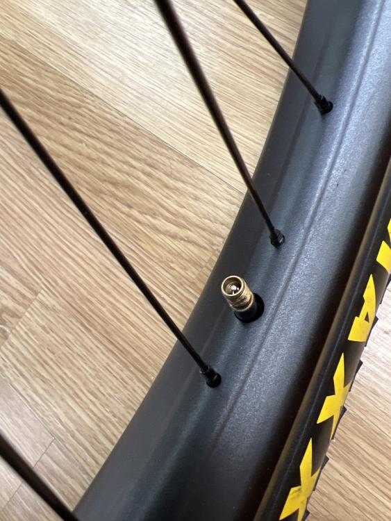

Rip Posted May 15, 2021 Author Report Share Posted May 15, 2021 This might be why I have a complex about the hole sizes in my rims. See how the locknut on a Schrader valve actually disappear into the hole That locknut is has a 10.5mm diameter and comfortably rattles about in the hole so the hole must be at least 11.0mm diameter which makes my 5.8mm diameter tubeless presta valves an extremely lose fit. (Yes I know technically it doesn't matter). For obvious reasons I didn't wind it in any more but it will probably eventually rattle its way down there at some point anyway. Quote Link to comment Share on other sites More sharing options...

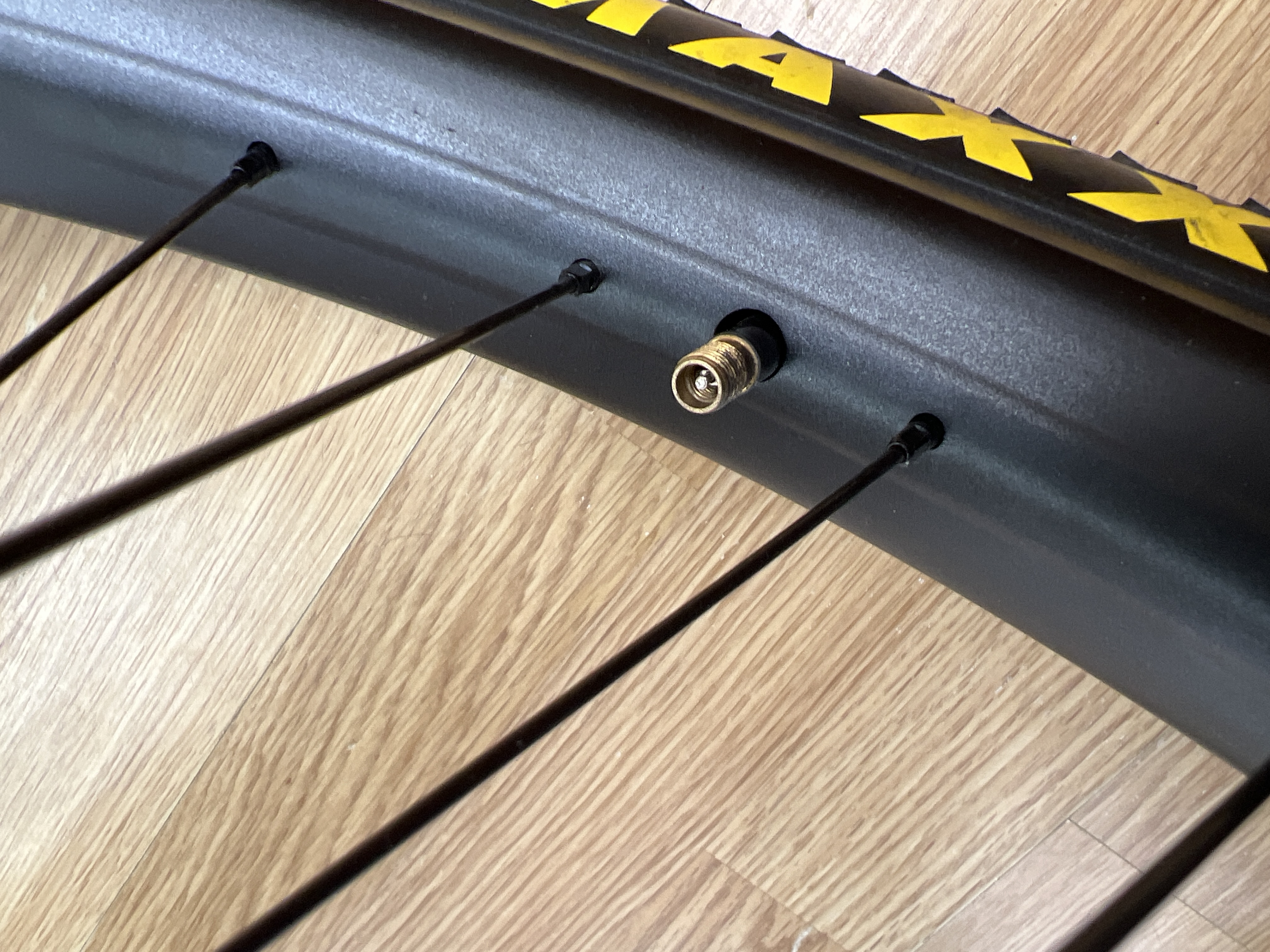

DJEHB Posted November 27, 2021 Report Share Posted November 27, 2021 (edited) Bit of a bump but wondering if anyone has set up the carthy V2 rims tubeless successfully before I get into a whole world of pain? My biggest concern is the size of the valve hole Edited November 27, 2021 by DJEHB Quote Link to comment Share on other sites More sharing options...
AdamR28 Posted November 27, 2021 Report Share Posted November 27, 2021 I have (this is a front V1 but they are all the same in this respect). Drilled a new valve hole for Presta, glued the join. Quote Link to comment Share on other sites More sharing options...
DJEHB Posted November 27, 2021 Report Share Posted November 27, 2021 18 minutes ago, Adam@TartyBikes said: I have (this is a front V1 but they are all the same in this respect). Drilled a new valve hole for Presta, glued the join. Oh blimey, I thought I’d get away with the join and was hoping to get away with the original valve hole. That’s a bit further than I think I’m willing to go haha. Cheers Adam 1 Quote Link to comment Share on other sites More sharing options...

AdamR28 Posted December 3, 2021 Report Share Posted December 3, 2021 Yep just tape over the old hole. 6.5mm drill for the new valve (assuming presta). 1 Quote Link to comment Share on other sites More sharing options...
DJEHB Posted December 3, 2021 Report Share Posted December 3, 2021 On 12/3/2021 at 9:41 AM, Adam@TartyBikes said: Yep just tape over the old hole. 6.5mm drill for the new valve (assuming presta). Ah that's what I was hoping for, treat it like any other spoke hole. Looking at the photo of yours it looks sealed properly. I assume once araldite applied to the join you just sand it back fairly flat? Apologies for all the questions, I'd like to get it right first try. I think the biggest issue will be my maxxis holy rollers. Quote Link to comment Share on other sites More sharing options...
AdamR28 Posted December 3, 2021 Report Share Posted December 3, 2021 No worries! I sealed on the tyre-facing side of the inner rim wall, a little 'slug' of araldite, flat enough for the rim tape (I just use electrical tape) to conform to / stick over when under pressure. Quote Link to comment Share on other sites More sharing options...

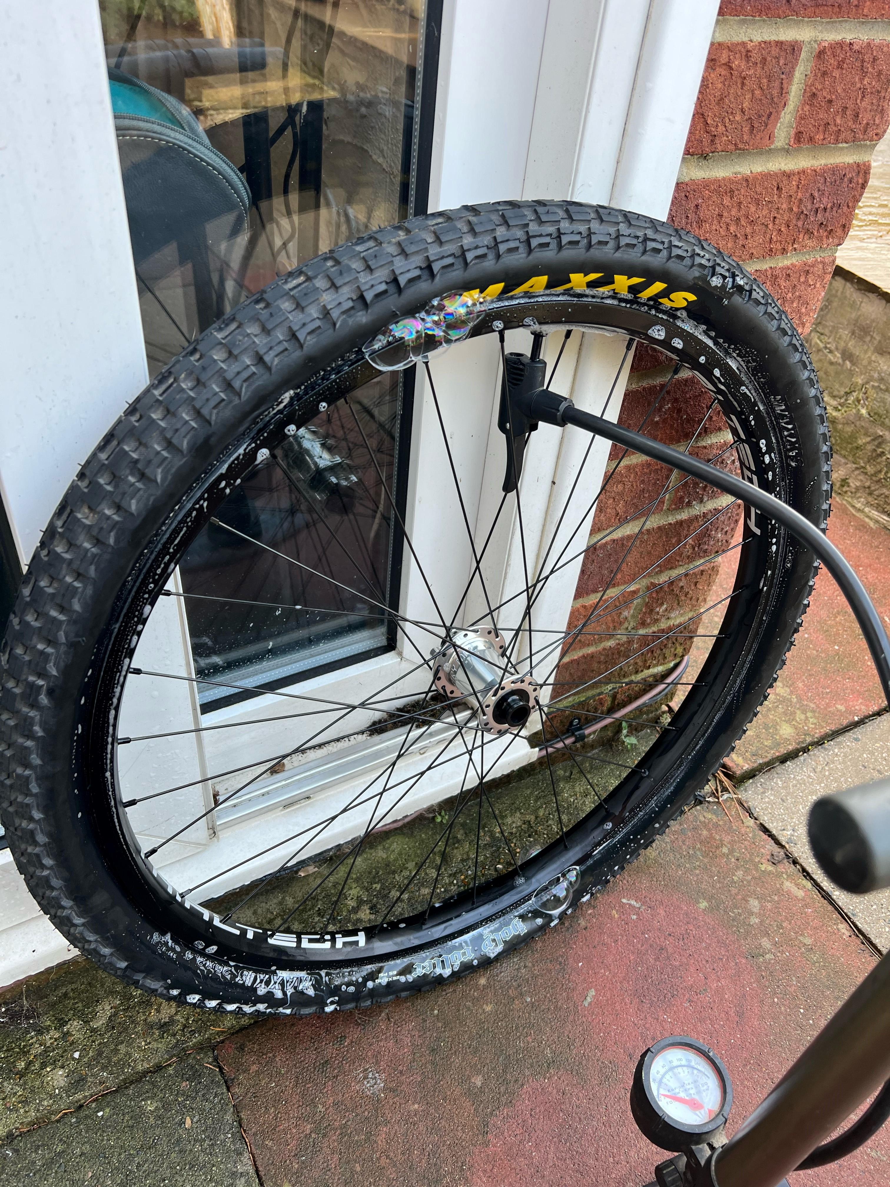

DJEHB Posted December 3, 2021 Report Share Posted December 3, 2021 Ok so I am of course having issues straight away haha. I cannot get the tyre to inflate, I've never had a problem using this track pump before but it doesn't seem up to the task this time. The maxxis is rather loose fitting I'd say, I've tried to add 2 layers of gorilla but still can get the tyre on by hand (just about). I've araldite'd the join, drilled a 6.5mm valve hole and in this instance I've taped to the sidewalls (on MTB I have always left a slight gap). I'm not sure that a compressor is even going to do the job, but I guess that's the next and only option. Quote Link to comment Share on other sites More sharing options...

AdamR28 Posted December 3, 2021 Report Share Posted December 3, 2021 Bummer. Are you set on those tyres? Some tubeless compatible ones will make a hell of a difference... Quote Link to comment Share on other sites More sharing options...
DJEHB Posted December 3, 2021 Report Share Posted December 3, 2021 (edited) On 12/3/2021 at 7:36 PM, Adam@TartyBikes said: Bummer. Are you set on those tyres? Some tubeless compatible ones will make a hell of a difference... I actually am not a huge fan of these at all. Anything you recommend? Edit: Off the back of Ali’s new build I’ve been a copy cute thief and gone for Ikon’s (and ordered an airshot to inflate). Beautiful build Ali, I’ve got a few similar flavours and silver touches in mine. Edited December 4, 2021 by DJEHB Quote Link to comment Share on other sites More sharing options...
Ali C Posted December 4, 2021 Report Share Posted December 4, 2021 thank you :) I must say that Holy Rollers weren't the easiest for me to inflate but I did manage it with a tubeless air blast pump. The Ikons should be a little easier but I still had to wiggle my front wheel around and physically pull one of the beads towards the rim edge for it to inflate with my compressor...just be patient, manipulate the tyre if needed and you should be ok 1 Quote Link to comment Share on other sites More sharing options...
DJEHB Posted December 8, 2021 Report Share Posted December 8, 2021 On 12/4/2021 at 11:15 AM, Ali C said: thank you I must say that Holy Rollers weren't the easiest for me to inflate but I did manage it with a tubeless air blast pump. The Ikons should be a little easier but I still had to wiggle my front wheel around and physically pull one of the beads towards the rim edge for it to inflate with my compressor...just be patient, manipulate the tyre if needed and you should be ok So.. ikons with an airshot made for a very easy set up. Although the overnight wait will be the real test. Can I just ask are you running a 2.2 ikon in the rear? It looks so narrow in comparison the 2.4 holy roller I had in there! Quote Link to comment Share on other sites More sharing options...
