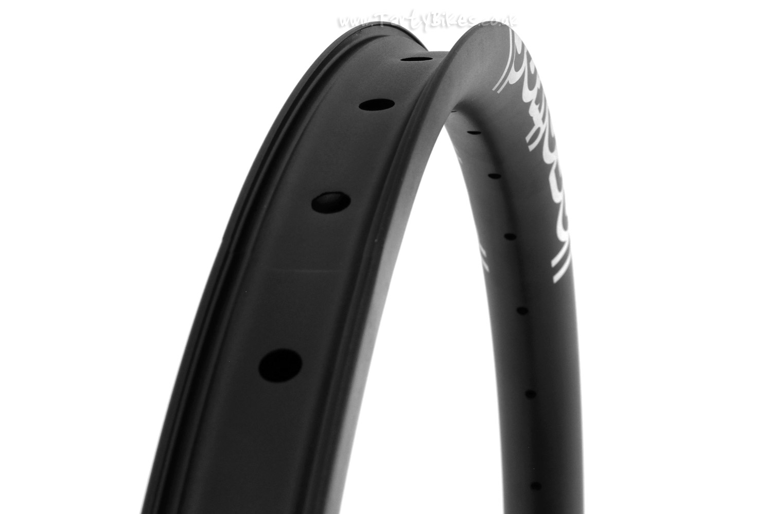

For the rim tape, Cap's school of thought with it was to go just for the rim well, so you're not on the section where the tyre bead sits on the rim. I think part of the reason that it can be hard to seat them is just the shape of the 'shelf' where the bead sits. If you look at it on the Team V2 rim compared to a random other rim, you can see it's a little different. It seems that tyres can get a bit hung up as they get pushed across sideways, so they don't necessarily seat fully against the outer edge of the rim:
I think the diameter of that 'shelf' where the bead sits is different on the latest generation V2 rims which is why Inspired refer to them as being better for tubeless.

Next time I'll try tape just across the well in the rim again then so I'm not increasing the rims shelf diameter any more, fit some Schrader tubeless valves or at least some rim hole adapters and apply a lesser amount of soapy water to the beads and of course I'll be in control of exactly how much sealant goes in, Ali C put 140ml of MucOff sealant in during one of his videos about tubeless inserts so I guess I'll go for about the same amount.
