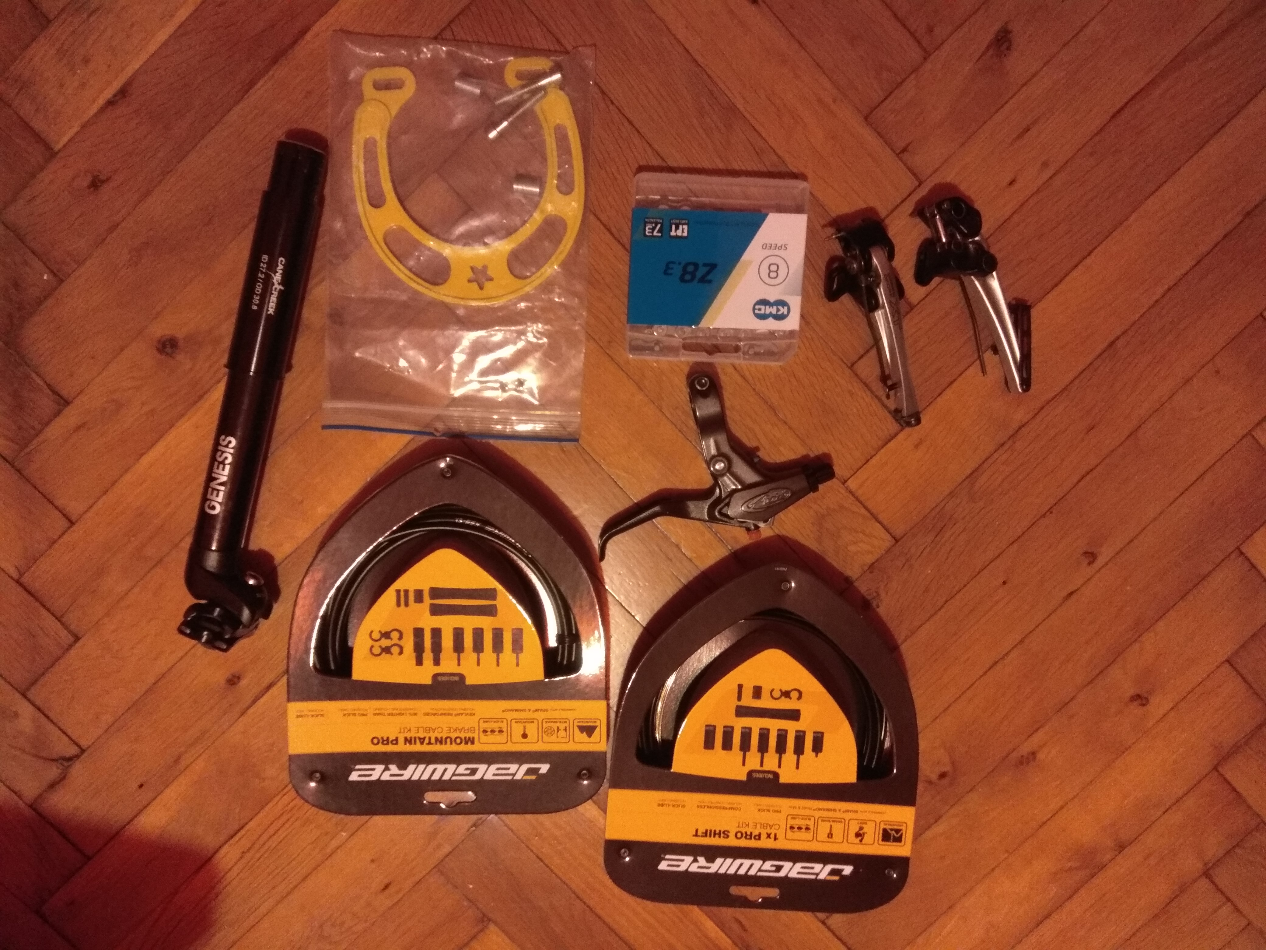

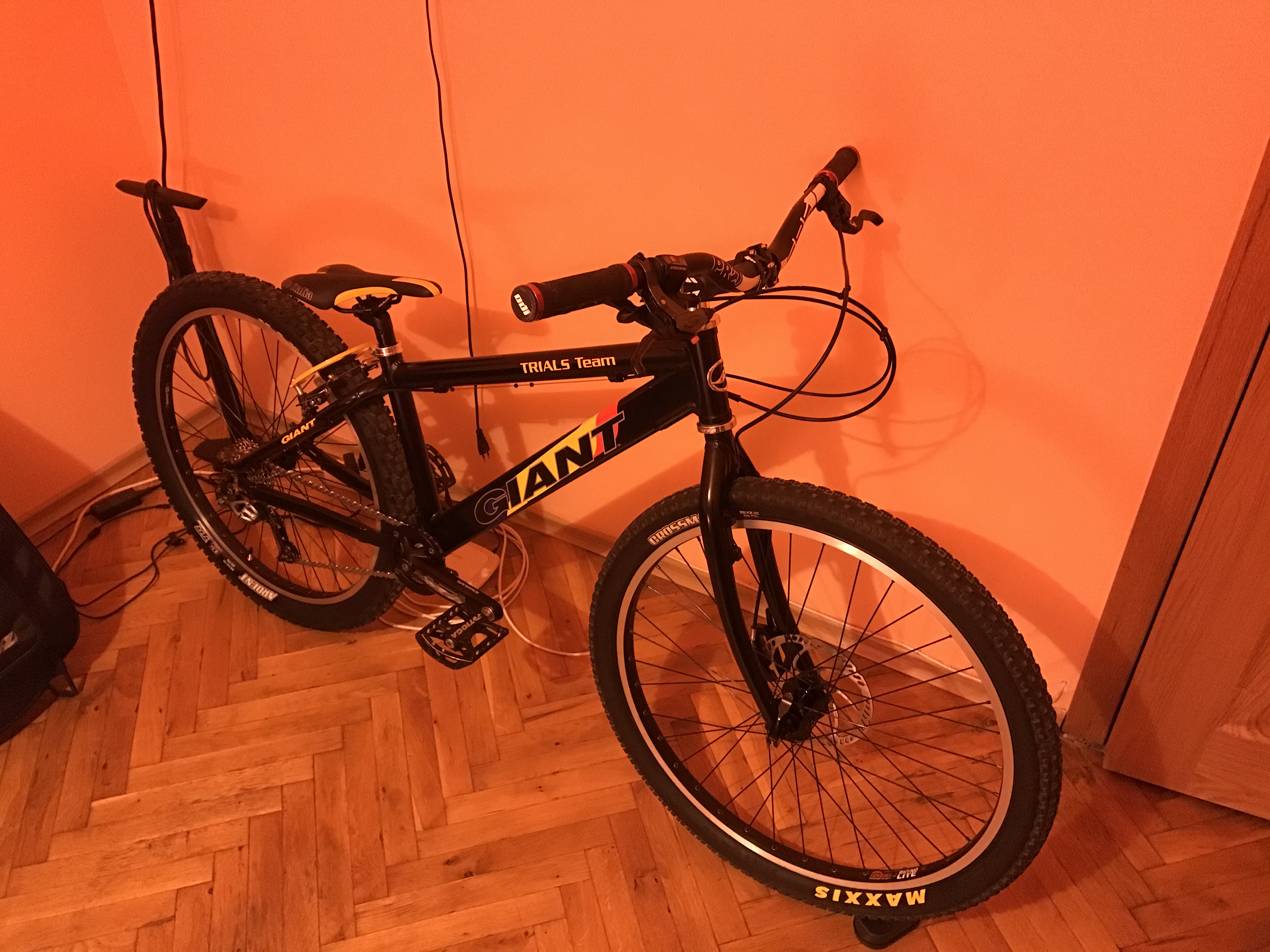

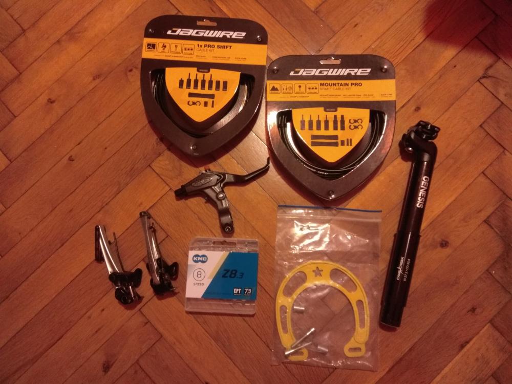

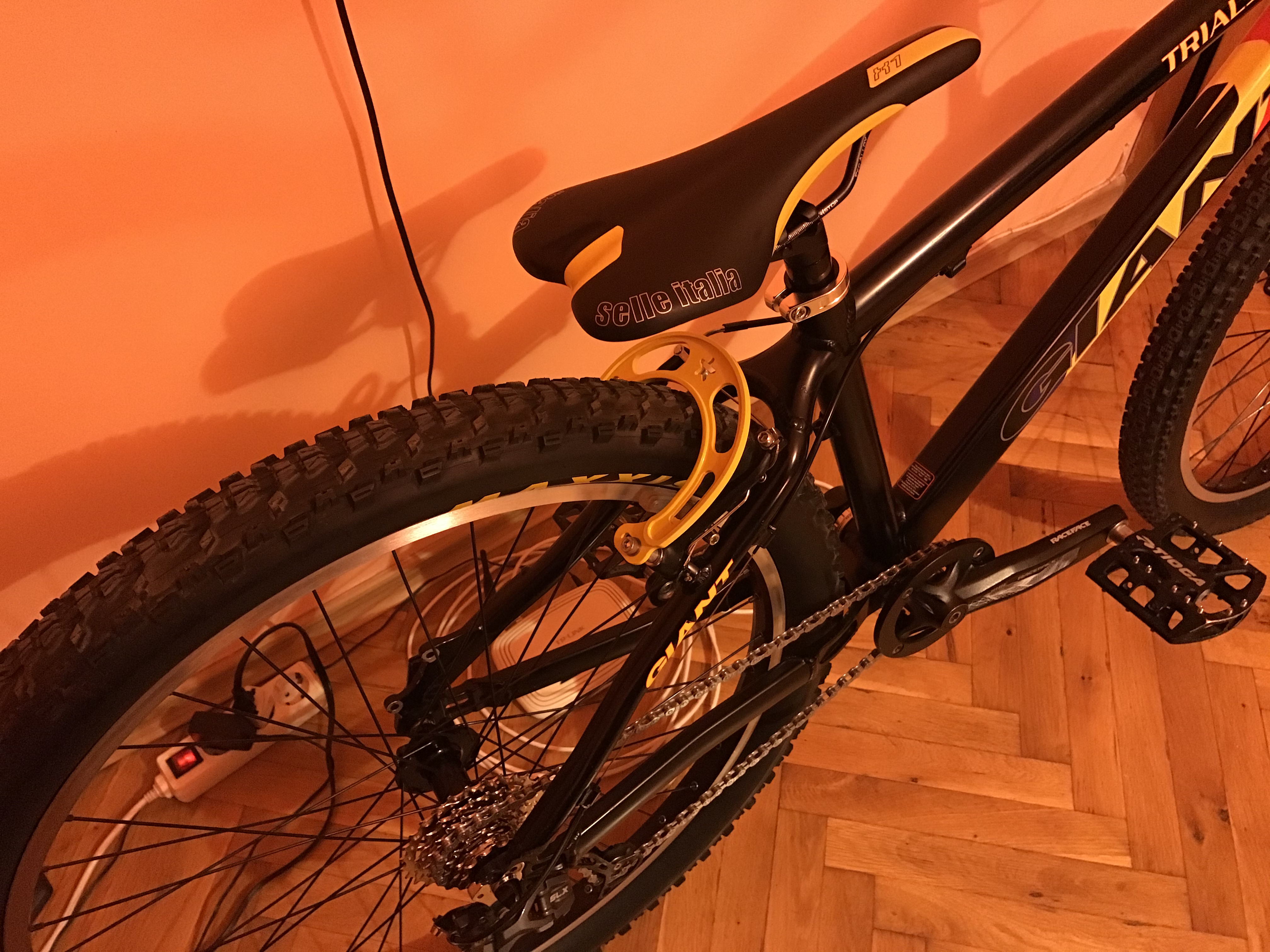

basstrials Posted November 16, 2020 Author Report Share Posted November 16, 2020 A little update,not much but this right now,i hope so to finished it next week.I am waiting black and yellow Selle and some other stuffs to arrived,so i could move on. The handlebar is cheap one,so it is going to be replaced,just wanted to try higher rise (around 105 total rise)and 720mm width paired with stem 100/17. What do you things about Trialtech Hybrid bar? Have a nice day. Quote Link to comment Share on other sites More sharing options...
LEON Posted November 16, 2020 Report Share Posted November 16, 2020 That's a seriously high front end for a very dated frame. 1 Quote Link to comment Share on other sites More sharing options...
basstrials Posted November 16, 2020 Author Report Share Posted November 16, 2020 15 minutes ago, LEON said: That's a seriously high front end for a very dated frame. I have new 100/10,but i wanted to try these ones out,just experience,i would say.Just watching some pictures of this bike and you are right,it is too high.Thank you for your time. Quote Link to comment Share on other sites More sharing options...
LEON Posted November 16, 2020 Report Share Posted November 16, 2020 It's not just that, you have 20mm of spacers too, these old bikes are sluggish with long chainstays and low bottom brackets. The standard back then was pretty much 90 x 10, 2" risers and hardly any spacers. 1 Quote Link to comment Share on other sites More sharing options...
basstrials Posted November 16, 2020 Author Report Share Posted November 16, 2020 3 hours ago, LEON said: It's not just that, you have 20mm of spacers too, these old bikes are sluggish with long chainstays and low bottom brackets. The standard back then was pretty much 90 x 10, 2" risers and hardly any spacers. Thank you,about the points.The chainstay is exact 400mm and bb is almost zero or maybe -5 or close to this.I am very new to trials,just try to make some appropriate beginners bike to start with.I know that most people here is sick with some rookie questions,so i appreciated everyones view and advice. Quote Link to comment Share on other sites More sharing options...
LEON Posted November 17, 2020 Report Share Posted November 17, 2020 No it's cool, but a lot of people try and set old frames up like a Hex, when the frame is nothing like a Hex. 400mm is huge by today's standards, even 390mm is pretty much unacceptable. Your frame will benefit from a short, low stem, around 90mm, 2 inch risers. Pretty much what they were designed for. 1 Quote Link to comment Share on other sites More sharing options...

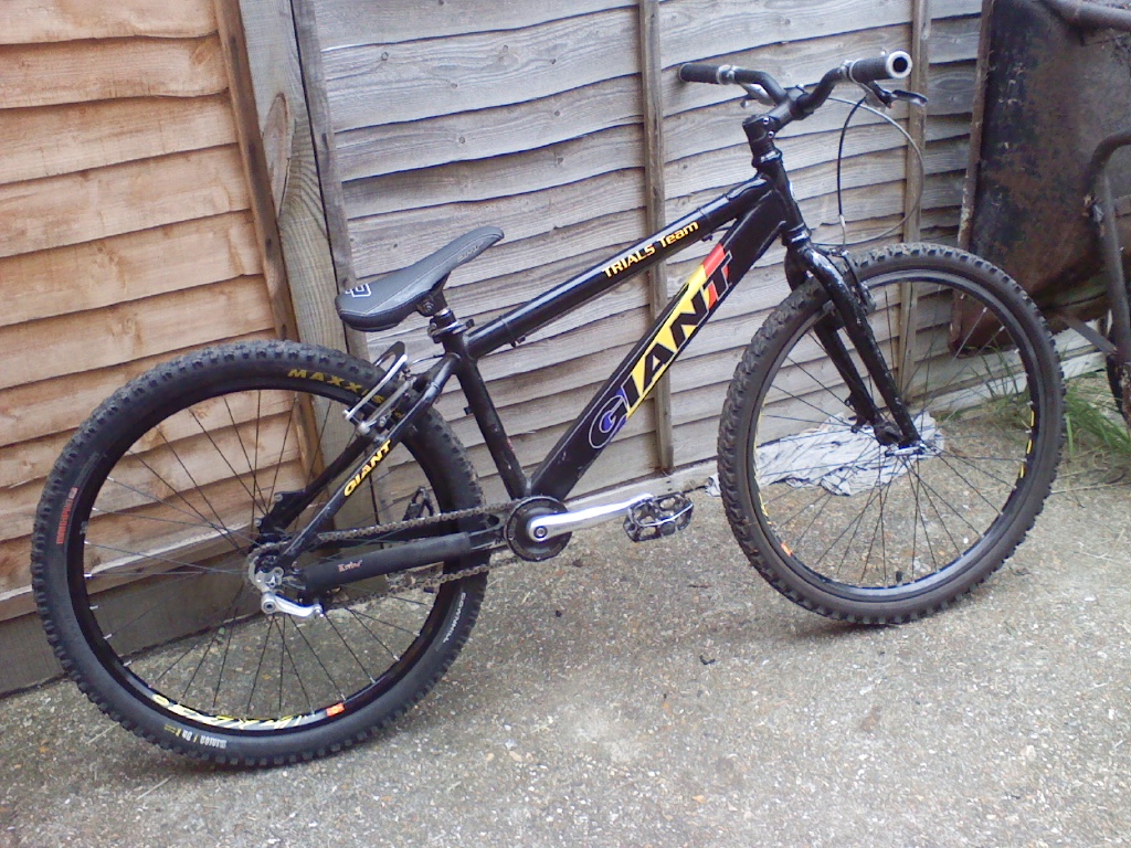

basstrials Posted November 17, 2020 Author Report Share Posted November 17, 2020 (edited) Is it that your bike?Man,i have downloaded this picture a few days ago and wanted to do it like this,but front disk brake with.Did you have any stem spacers it on? I do not know why people try to "converting" it to Hex,but i want street bike to learn some stuffs and ride around the town,also, so that is why i put 7 speed cassette on back.What is like to run rear v-brake back on?I have always had rear disk brake,just wander if it is going to make a job well,i am a 90 kilos. Did order Jitsie brake pads,the white ones,i hope so they will work on smooth rims like mine.Any other brands and models recommendation? Thank you. Edited November 17, 2020 by basstrials Quote Link to comment Share on other sites More sharing options...
LEON Posted November 17, 2020 Report Share Posted November 17, 2020 Not my bike, just a decent example of a front end. 1 Quote Link to comment Share on other sites More sharing options...

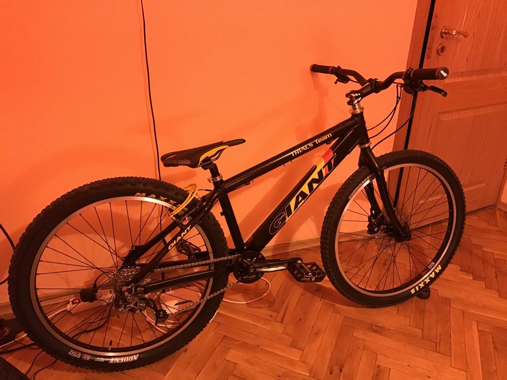

basstrials Posted November 27, 2020 Author Report Share Posted November 27, 2020 That is the final build...for now,at least. 1 Quote Link to comment Share on other sites More sharing options...
