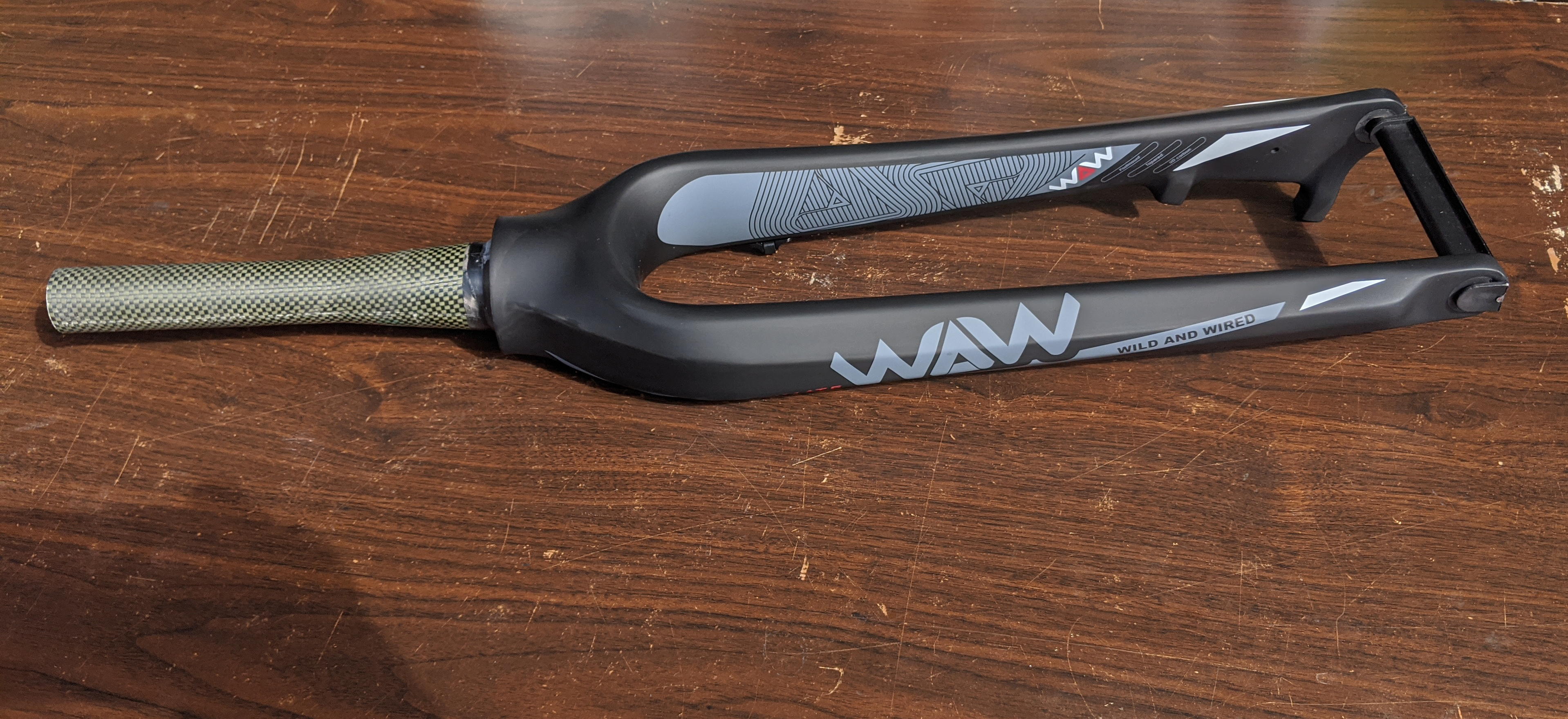

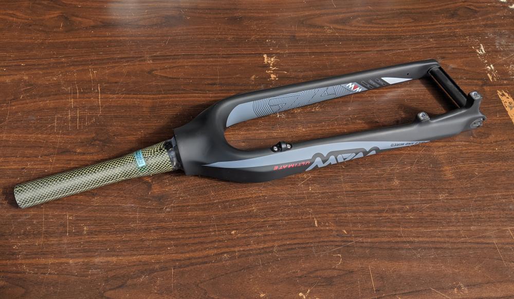

Swoofty Posted July 28, 2020 Author Report Share Posted July 28, 2020 Thanks @stirlingpowers Got these beauties from DHL yesterday. So gorgeous and so light! Now I'm just waiting for rims... 3 Quote Link to comment Share on other sites More sharing options...
