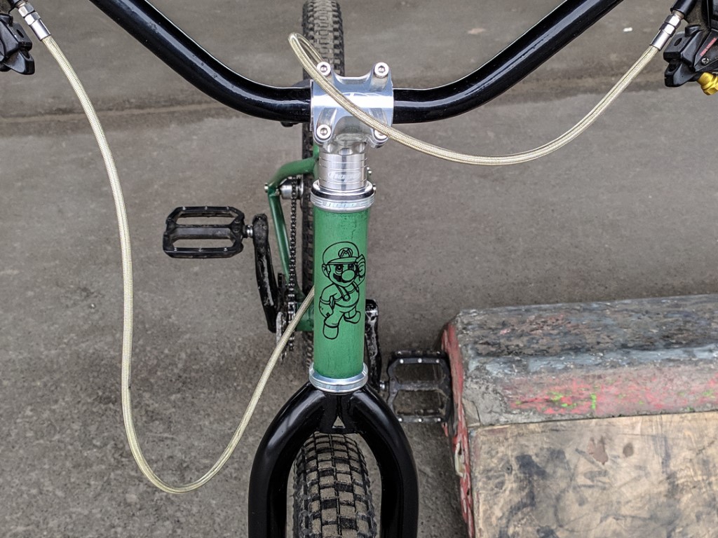

andrey-p Posted June 24, 2020 Report Share Posted June 24, 2020 (edited) I'm riding on a steel 22.2 bar with a Hope AM/FR 31.8 stem with no any problem. I ordered a custom adapter, which cost literally nothing. Edited June 24, 2020 by andrey-p 2 Quote Link to comment Share on other sites More sharing options...
Wantedinspiredarcade Posted June 24, 2020 Report Share Posted June 24, 2020 (edited) 34 minutes ago, andrey-p said: I'm riding on a steel 22.2 bar with a Hope AM/FR 31.8 stem with no any problem. I ordered a custom adapter, which cost literally nothing. Good news! I’m wanting NS District Bars but then I’ve been bummed that I don’t have a wide choice of stems... I bought a bmx stem, looks cool and feels unbreakable but it’s weighty.... the hope AM stems look beaut, what bars are you running there? Also your bike looks cool dude, any chance of some pics and spec ???? Edited June 24, 2020 by Wantedinspiredarcade Quote Link to comment Share on other sites More sharing options...
andrey-p Posted June 24, 2020 Report Share Posted June 24, 2020 19 minutes ago, Wantedinspiredarcade said: Good news! I’m wanting NS District Bars but then I’ve been bummed that I don’t have a wide choice of stems... I bought a bmx stem, looks cool and feels unbreakable but it’s weighty.... the hope AM stems look beaut, what bars are you running there? Also your bike looks cool dude, any chance of some pics and spec ???? It's local made bar named TSB (123mm rise and 2mm walls thick) and it's only sold in Russia I think. There is only an old topic with my bike, but I repainted the frame and changed some spares since that time. 1 Quote Link to comment Share on other sites More sharing options...
