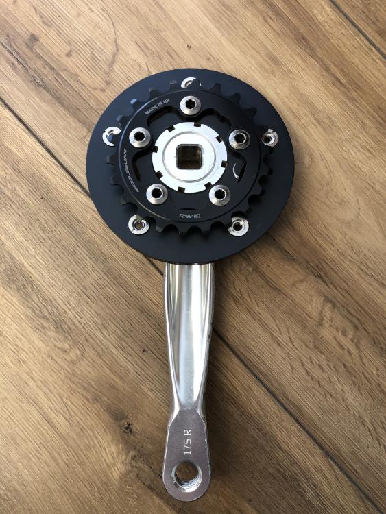

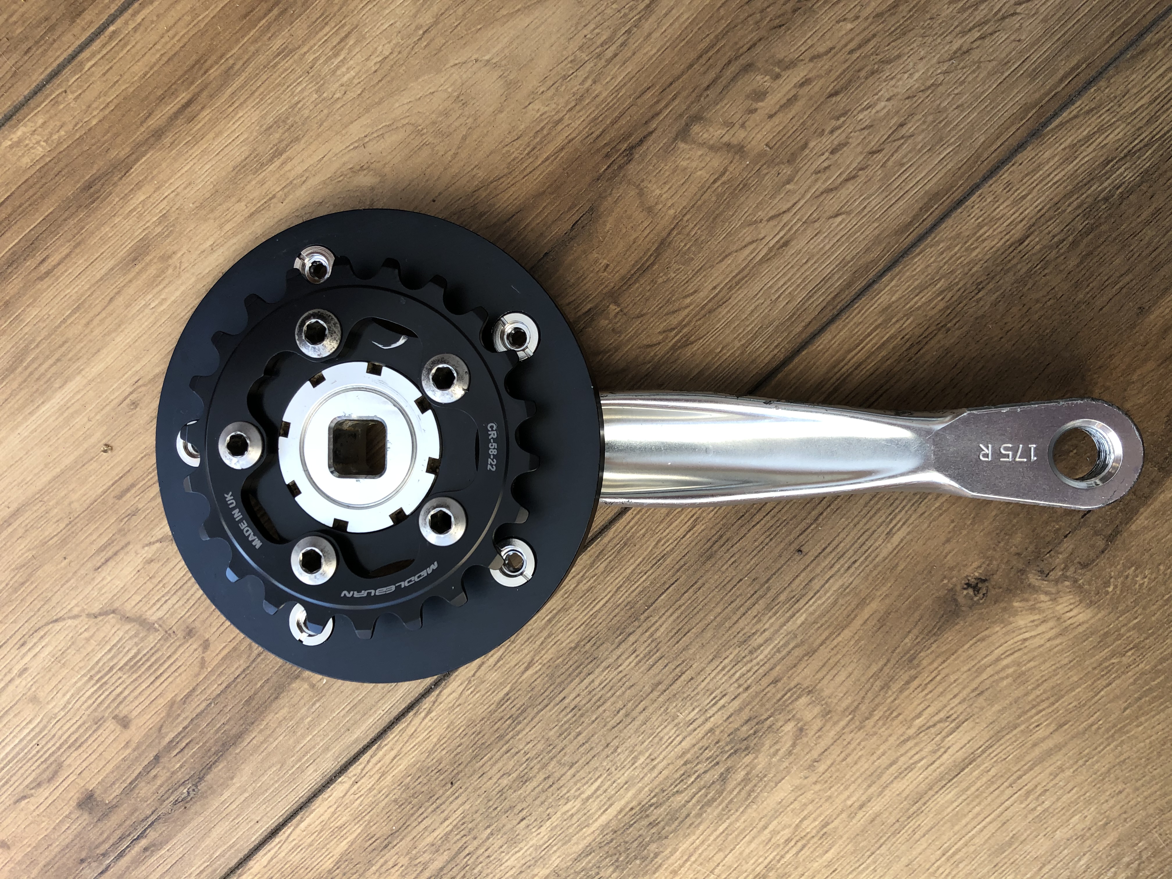

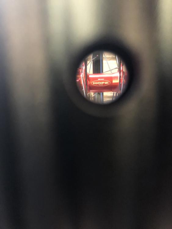

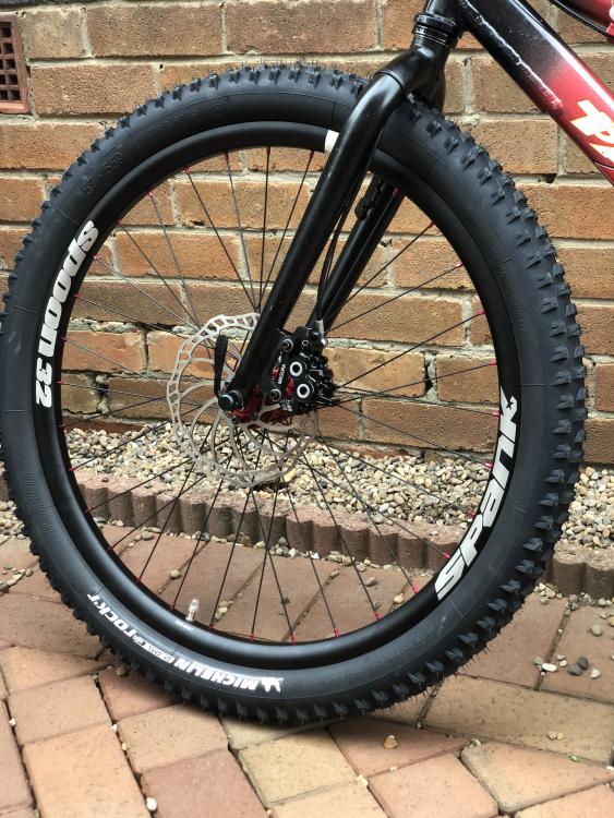

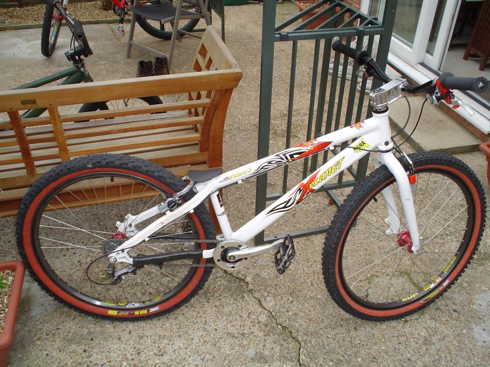

Private Repress Posted June 19, 2020 Report Share Posted June 19, 2020 Thought I’d share some progress on my lockdown project. Started off with with a bit of a desire for a midskool 26 that I could do a bit of everything on. Had some modern parts spare and a few classic, not quite enough for a full build. Oh and I needed a frame. Managed to get the Zebdi on this forum, lovely condition and fitted the bill perfectly: I’d picked up a second hand hope XC on an onza rim as part of a bundle of bits I’d bought, along with some tensile cranks. made sense to bang them on with the other bits I had so ended up with this: the front wheel wasn’t a permanent choice, just borrowed from my Giant, the intention was to have discs front and back for noiseless trials. Never the less I liked the red hubs so spent what felt like a year trying to find a red front hope XC. Ended up getting one on eBay, took 3 weeks to come as it was from France! I decided I wanted to run a 22t up front as opposed to the 18 I had on the tensiles. Not a straightforward task! Could not believe how hard it was to source a spider and bash ring. took a chance on this threaded spider on eBay and found a black spire granny god NOS, happy days! sadly on arrival I realised the offset on the spider meant it wouldn’t fix to the tensile crank arm. Argh! so bit the bullet and got some second hand middleburns with a spider: next up I realised the rear wheel had a small crack where the rim is pinned. So figured I’d get two rims, build the front up front scratch and replace the rim on the rear. Didn’t want anything drilled so settled on DMR DeeVees. Placed the order, in May and they still hadn’t been dispatched this time yesterday, so cancelled that, spoke to Tarty bikes and settled on some spank spoons. They arrived today! so laced up the wheel whilst I was on a work conference call following @Ali C wheel building tutorial to the letter (great vid if you haven’t seen it!). Then banged the wheel in the jig this afternoon to straighten it up: Quote Link to comment Share on other sites More sharing options...

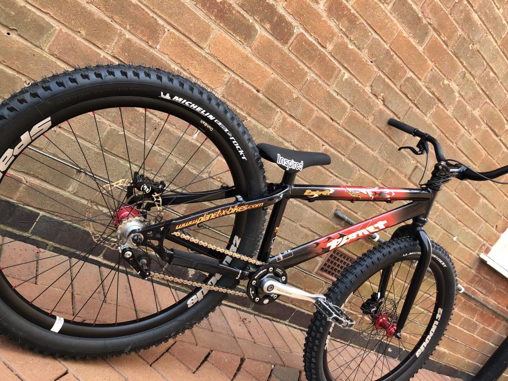

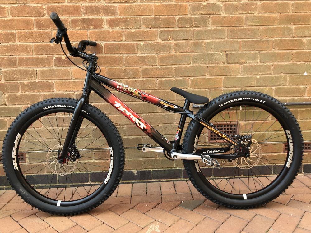

Private Repress Posted June 19, 2020 Author Report Share Posted June 19, 2020 Here is the bike as it stands now: I’ll get the back wheel stripped down over the weekend and rebuilt on the spank. Had a quick mess about on the drive and it’s a lot of fun, may opt for a short stem in the future and possibly stick these tyres on my Ashton in lieu of some slicker skate park/street friendly alternatives. I absolutely love it though. Street sesh this Sunday for sure. 8 Quote Link to comment Share on other sites More sharing options...

biketrialler Posted June 22, 2020 Report Share Posted June 22, 2020 I had 2 Zebdis back in the day and I dont remember the rear disc mounts being up to it, more of an afterthought. Beware! Looks great though and a lot of fun. 1 Quote Link to comment Share on other sites More sharing options...
Private Repress Posted June 22, 2020 Author Report Share Posted June 22, 2020 (edited) 40 minutes ago, biketrialler said: I had 2 Zebdis back in the day and I dont remember the rear disc mounts being up to it, more of an afterthought. Beware! Looks great though and a lot of fun. Yeah to be fair not many many frames of this period had durable disc mounts. I’m not doing anything major on it and like to think of myself as a smoothish rider so hopefully will hold out. Edited June 22, 2020 by Private Repress Typo Quote Link to comment Share on other sites More sharing options...
Ross McArthur Posted June 22, 2020 Report Share Posted June 22, 2020 On 19/06/2020 at 5:29 PM, Private Repress said: Here is the bike as it stands now: I’ll get the back wheel stripped down over the weekend and rebuilt on the spank. Had a quick mess about on the drive and it’s a lot of fun, may opt for a short stem in the future and possibly stick these tyres on my Ashton in lieu of some slicker skate park/street friendly alternatives. I absolutely love it though. Street sesh this Sunday for sure. Cant wait to see it with the rear spank on it. The rear braking surface is killing me! Its making the front tyre look bigger than the rear. Cant be having that haha. Quote Link to comment Share on other sites More sharing options...

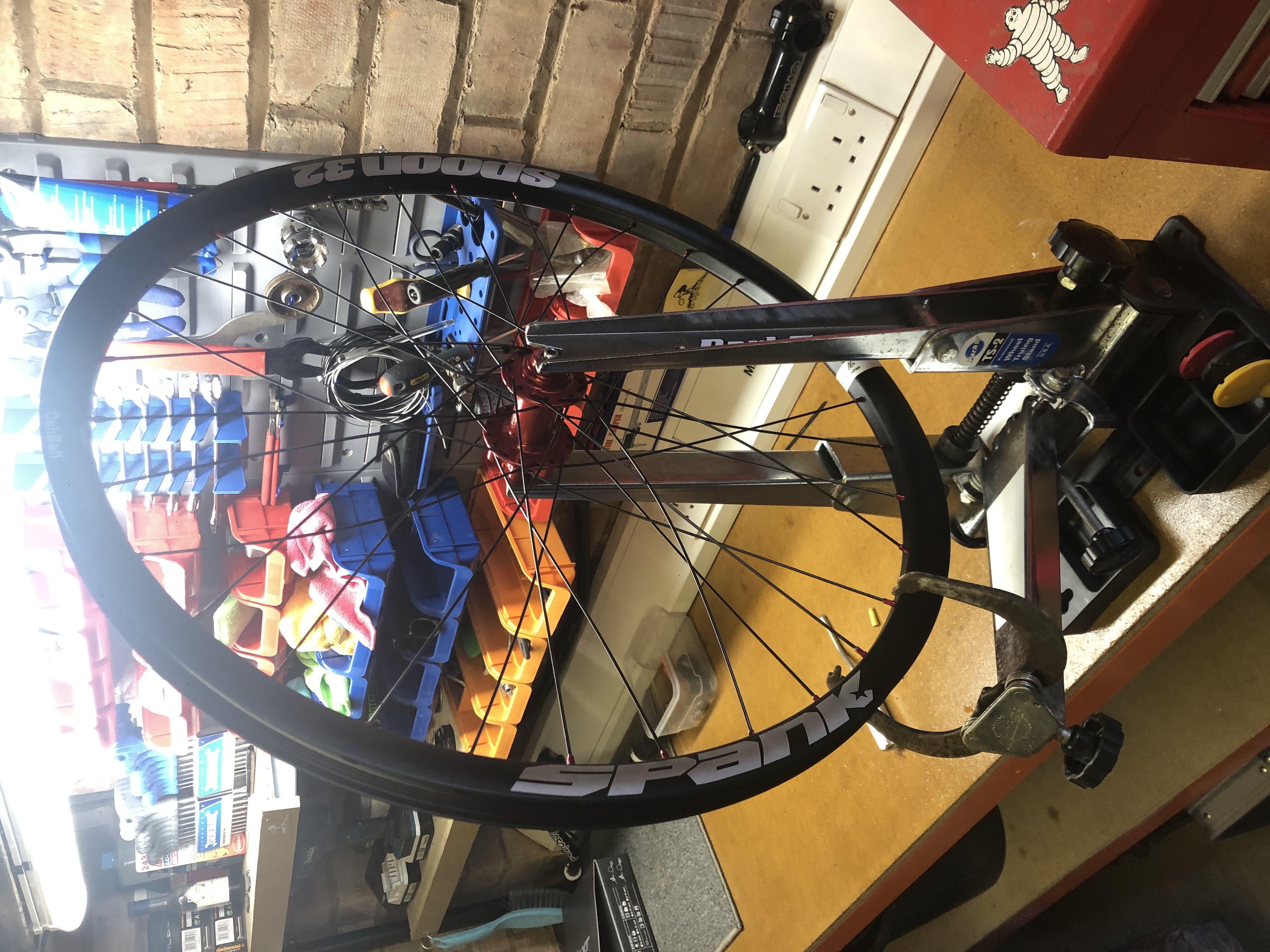

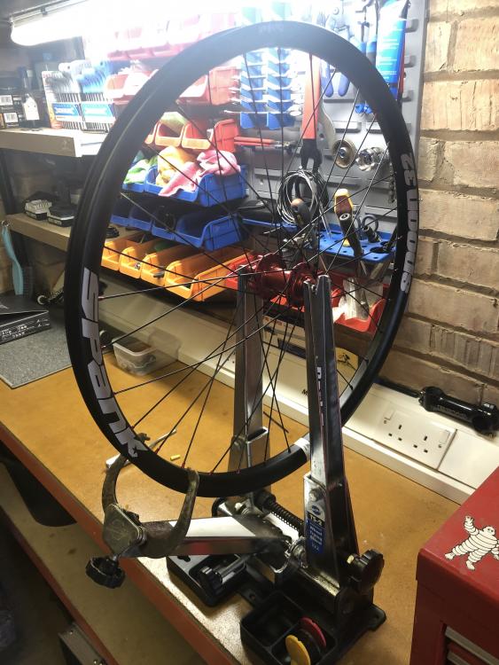

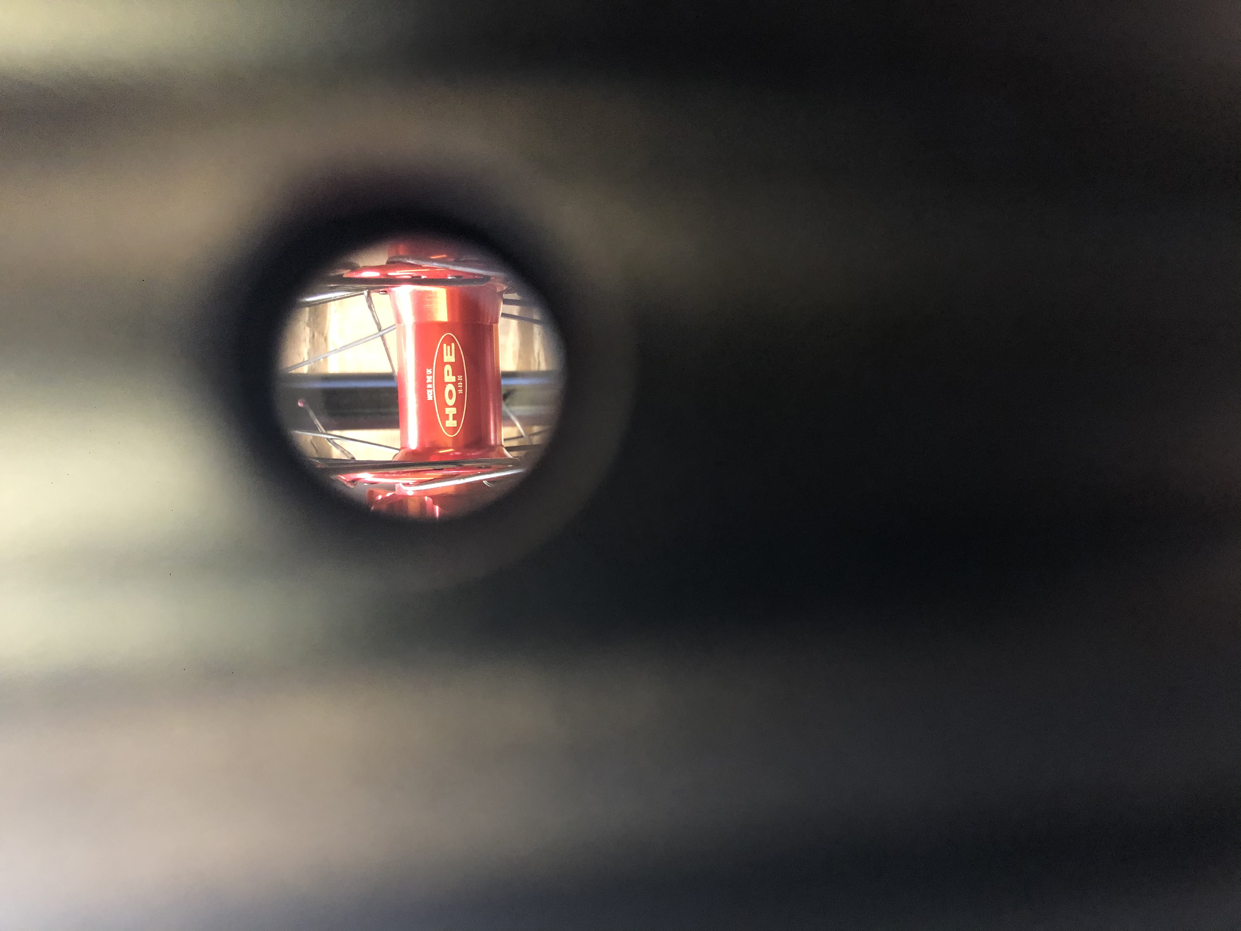

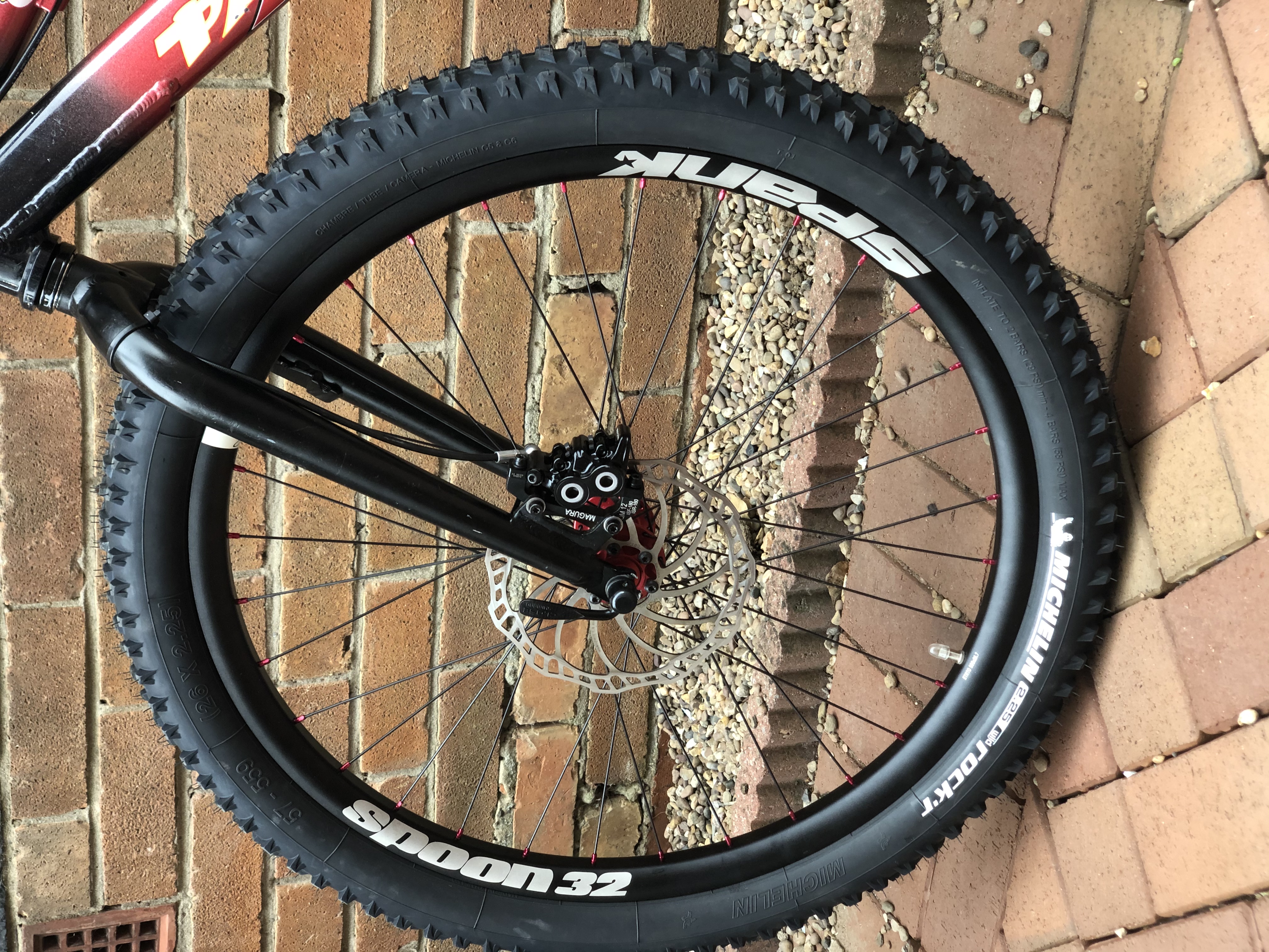

Private Repress Posted June 22, 2020 Author Report Share Posted June 22, 2020 @Ross McArthur you request has been duly noted sir: I didn’t have time to get the back wheel built before going for a ride on Saturday. So much fun though, hit a new concrete skatepark, which became over ran with scooters so went for a street sesh. Managed to snake bite the rear going front to back on a wall. Didn’t mind though as I stripped the wheel down when I got home and built the hub up on the spank. 2 Quote Link to comment Share on other sites More sharing options...
Private Repress Posted June 22, 2020 Author Report Share Posted June 22, 2020 (edited) Also dropped the gearing down a notch from 22:17 to 22:16 - not sure if I can get the chain any shorter yet... something to check later Edited June 22, 2020 by Private Repress Typo Quote Link to comment Share on other sites More sharing options...
LEON Posted June 22, 2020 Report Share Posted June 22, 2020 Very nice, sold one very similar a couple.of yeats ago, same colour. What's the bb height and chainstay length? I remember those being about 393mm. 1 Quote Link to comment Share on other sites More sharing options...

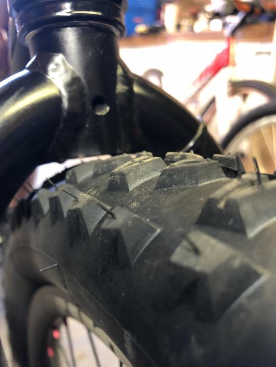

Private Repress Posted June 22, 2020 Author Report Share Posted June 22, 2020 3 hours ago, LEON said: Very nice, sold one very similar a couple.of yeats ago, same colour. What's the bb height and chainstay length? I remember those being about 393mm. Thanks @LEON Yes chainstay length is bang on 393mm, looks to be about +5mm bb rise with the short forks I’m running (only just accommodates the tyre/rim choice!) 1 Quote Link to comment Share on other sites More sharing options...
Ross McArthur Posted June 22, 2020 Report Share Posted June 22, 2020 Oooosh, very nice! On the gearing point. Where did you think you were lacking in gearing? Just for getting around? Or we were you kicking thin air on the 17? I had a 16 on the Ashton and went back to 17 as I feel its the sweet spot! Quote Link to comment Share on other sites More sharing options...
Private Repress Posted June 22, 2020 Author Report Share Posted June 22, 2020 @Ross McArthur thanks mate, I’m delighted with how it’s worked out, and it’s been worth the wait. Gearing wise it wasn’t so much it was lacking in any particular place, I’ve just always seemed to ride a harder gear than most, but I tend to a lot of rolling manoeuvres ie. pedal hop up a wall as opposed to static stuff. Haven’t had much chance to settle on it yet, but hitting street tomorrow after work, so might switch back yet! Quote Link to comment Share on other sites More sharing options...
LEON Posted June 22, 2020 Report Share Posted June 22, 2020 (edited) 6 hours ago, Private Repress said: Thanks @LEON Yes chainstay length is bang on 393mm, looks to be about +5mm bb rise with the short forks I’m running (only just accommodates the tyre/rim choice!) Nice! My best Zebdi ever had short forks like that. Most people who are building up old retro frames are treating the front end like a Hex, it's not a Hex, it'll never ride like one, bikes like this need the short forks they were built for, usually low/short stems but that can depend on height etc. My most recent one rode like crap with Inspired forks on. Edited June 22, 2020 by LEON 3 Quote Link to comment Share on other sites More sharing options...

Private Repress Posted June 22, 2020 Author Report Share Posted June 22, 2020 (edited) @LEON Very nice mate! Lovely builds. I totally agree about the short forks and lower front end. I’ve only gone for the higher rise bars as I’m 6ft 2 and have problems with my lower back. it’s quite a comfortable geo for me with my weight fairly central, makes for a well balanced bike. I seemed to let the Zebdi slip under the radar when they were released, I had a giant trials team which I was besotted with and never really paid Planet X much attention. shame really because it’s such a sorted frame. Edited June 23, 2020 by Private Repress Typo 3 Quote Link to comment Share on other sites More sharing options...
