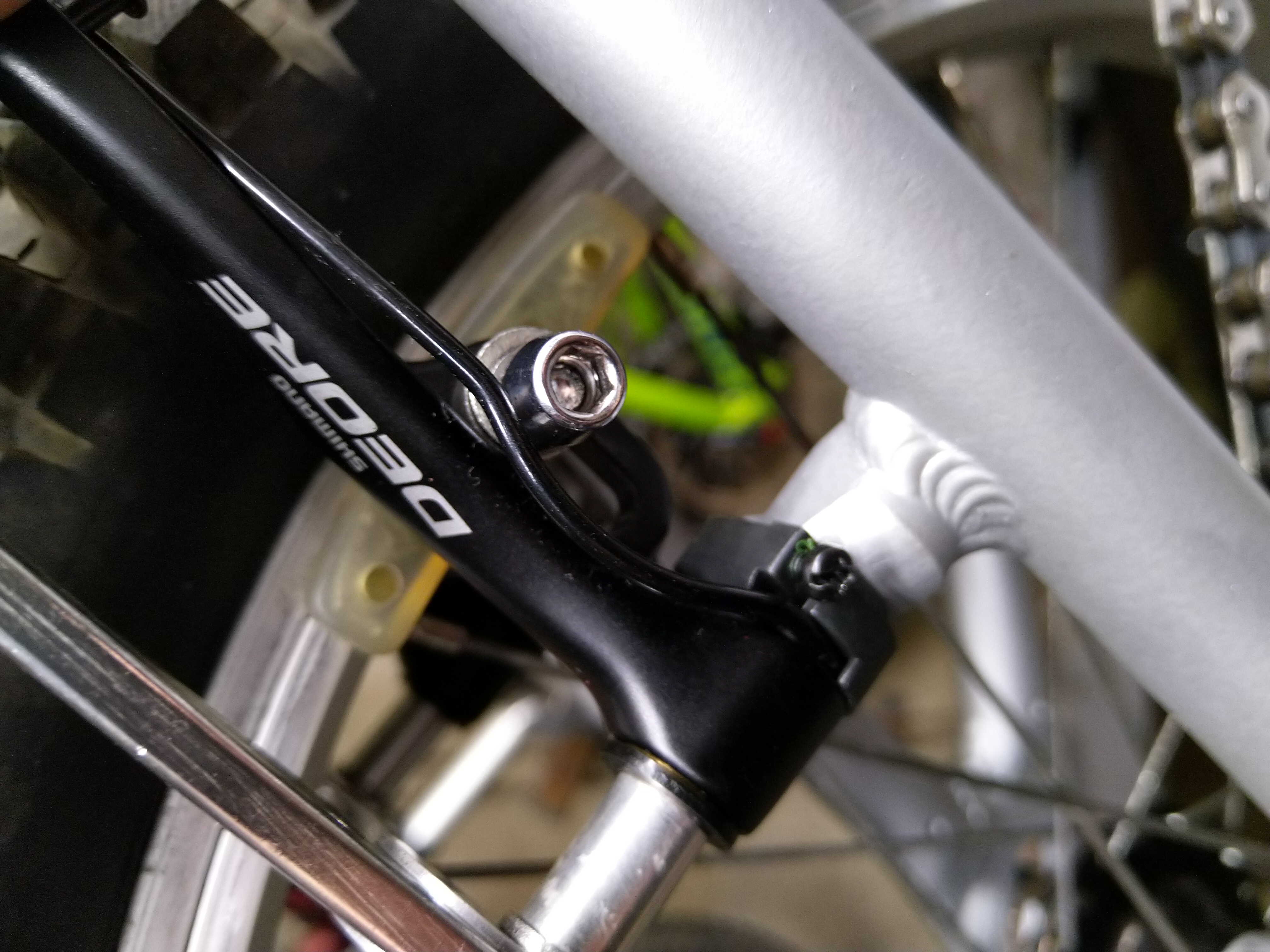

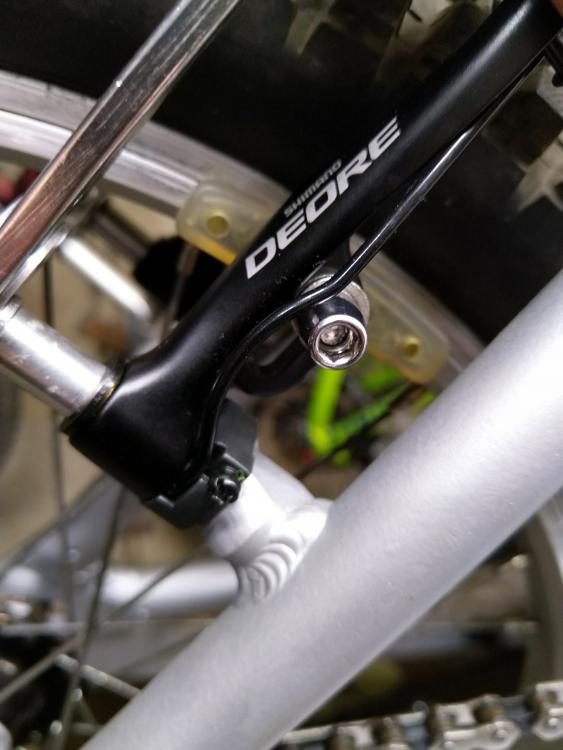

Karlos28 Posted June 18, 2020 Report Share Posted June 18, 2020 Hi all, I have what I think is an onza T-Bird (frame was raw when I bought it.. there seems to be many other brands putting their stickers on the same frame...) As a bit of a project to get me into trials. Long story short, I set the bike up and was riding it briefly, but the rear axle was way back right at the end of the drop outs, I wasn't comfortable with it so I whipped a link out of the chain. Now it tensions up great and is sat slap bang in the middle of the drop out. Ace. Then I came to set my (V) brake up and see pic below.... Tried to adjust every-which way possible and nothing seems to work, the pad will only reach about 50% contact with the rim... Someone on the trials rise s Facebook page has suggested that it maybe a 20" wheel when it should be a 19" wheel... Makes a lot of sense.. especially when I recall sanding the paint off the rim as it appeared to be unused (NOS??) I measured (as best I could) the rim, and I get about 42cm ish... Same as the front.. Can anyone shed any light? Or help me out with a 19" rear wheel if that's the case!? Quote Link to comment Share on other sites More sharing options...
Private Repress Posted June 19, 2020 Report Share Posted June 19, 2020 Yes it requires a 19inch rear rim Quote Link to comment Share on other sites More sharing options...
Karlos28 Posted June 19, 2020 Author Report Share Posted June 19, 2020 Thought so! Now to find a new wheel! Quote Link to comment Share on other sites More sharing options...
Eldertroll Posted June 19, 2020 Report Share Posted June 19, 2020 Or just put on half link in the chain. Cheapest option Quote Link to comment Share on other sites More sharing options...
Karlos28 Posted June 19, 2020 Author Report Share Posted June 19, 2020 No, really not keen on how far back the axle was in the drop out to get the brake working. Think I have sorted out a replacement. Quote Link to comment Share on other sites More sharing options...
