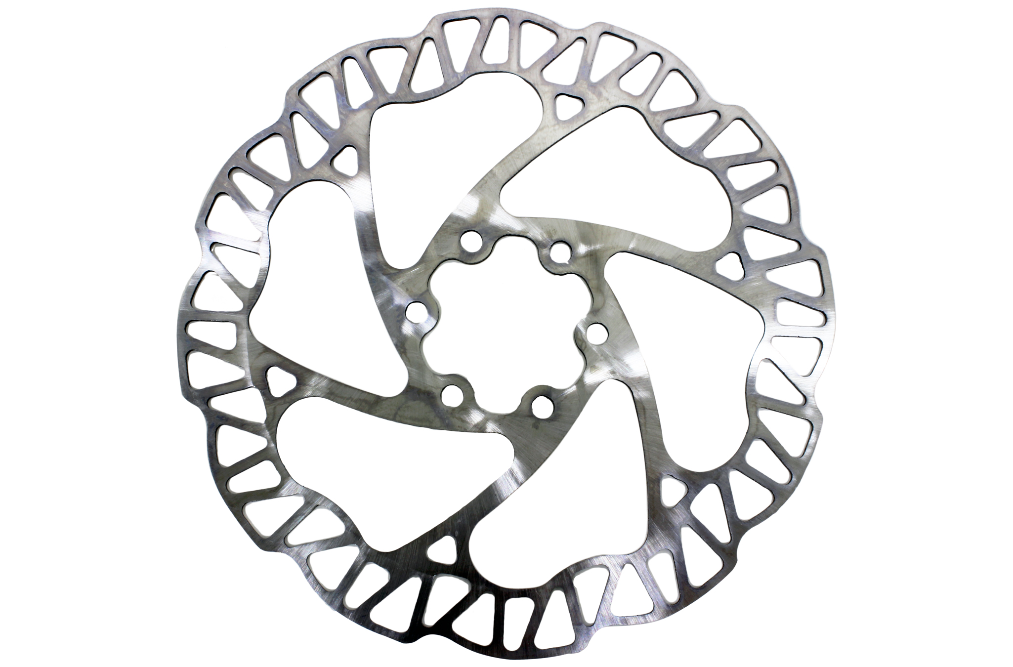

LEON Posted June 17, 2020 Report Share Posted June 17, 2020 Got this on the front, any kind of stoppie or dragging the brake results in a horrible grinding noise. Got Trialtech pads and power is no problem but is the amount of sheer surface area missing from this rotor causing all the noise? Never had an issue on any other rotor. Quote Link to comment Share on other sites More sharing options...
LEON Posted June 17, 2020 Author Report Share Posted June 17, 2020 Also, what other brands are best with a Hope Tech Trial brake? Thickness etc. Quote Link to comment Share on other sites More sharing options...
Mikee Posted June 17, 2020 Report Share Posted June 17, 2020 I had the same issue with an Aztec rotor, which had more empty space then metal. It also seemed to be wearing my new pads down rapidly, so I changed to a more solid rotor and all was good. 1 Quote Link to comment Share on other sites More sharing options...
LEON Posted June 17, 2020 Author Report Share Posted June 17, 2020 (edited) Yea I thought that, sounds like absolute shit on anything but full lock. Google says Hope and Shimano rotors are both 1.80mm new so I should be ok. Cheers. Edited June 17, 2020 by LEON Quote Link to comment Share on other sites More sharing options...
