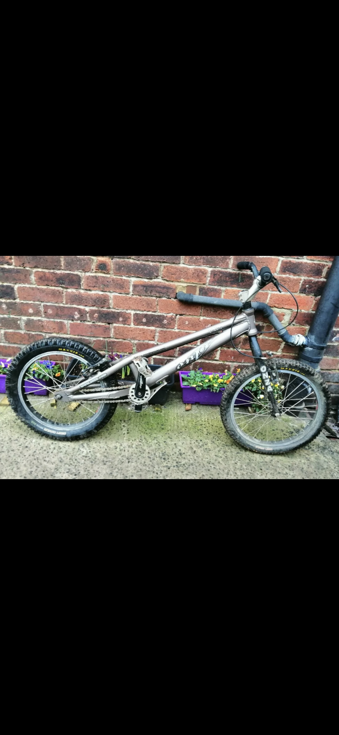

Hi all  Because of the lockdown my son and myself can’t do any trials ( both do moto trials ). My son has got out of the loft his old Onza t-pro (2005) I think. The brakes are shot and it needs a rear tyre. Where is the best place to buy these from and what brands ?  Any advice would be much appreciated

A Maxxis Creepy Crawler 19" will be a direct replacement for what you've got on there now - they're good tyres and one of the cheapest out there, so no reason to go for anything else realistically.
For the brakes, replacing the brake cables and pads would probably go a long way to improving them while not being too expensive.  The brake arms and brake levers should still be good, it's usually just the cables that get a bit crusty and horrible feeling.
