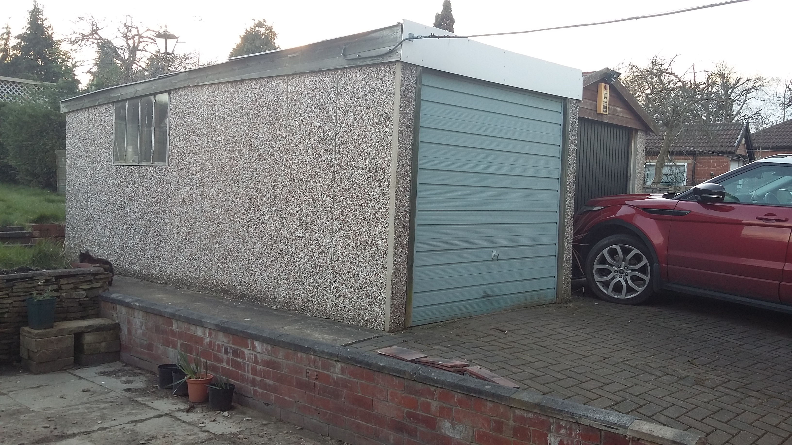

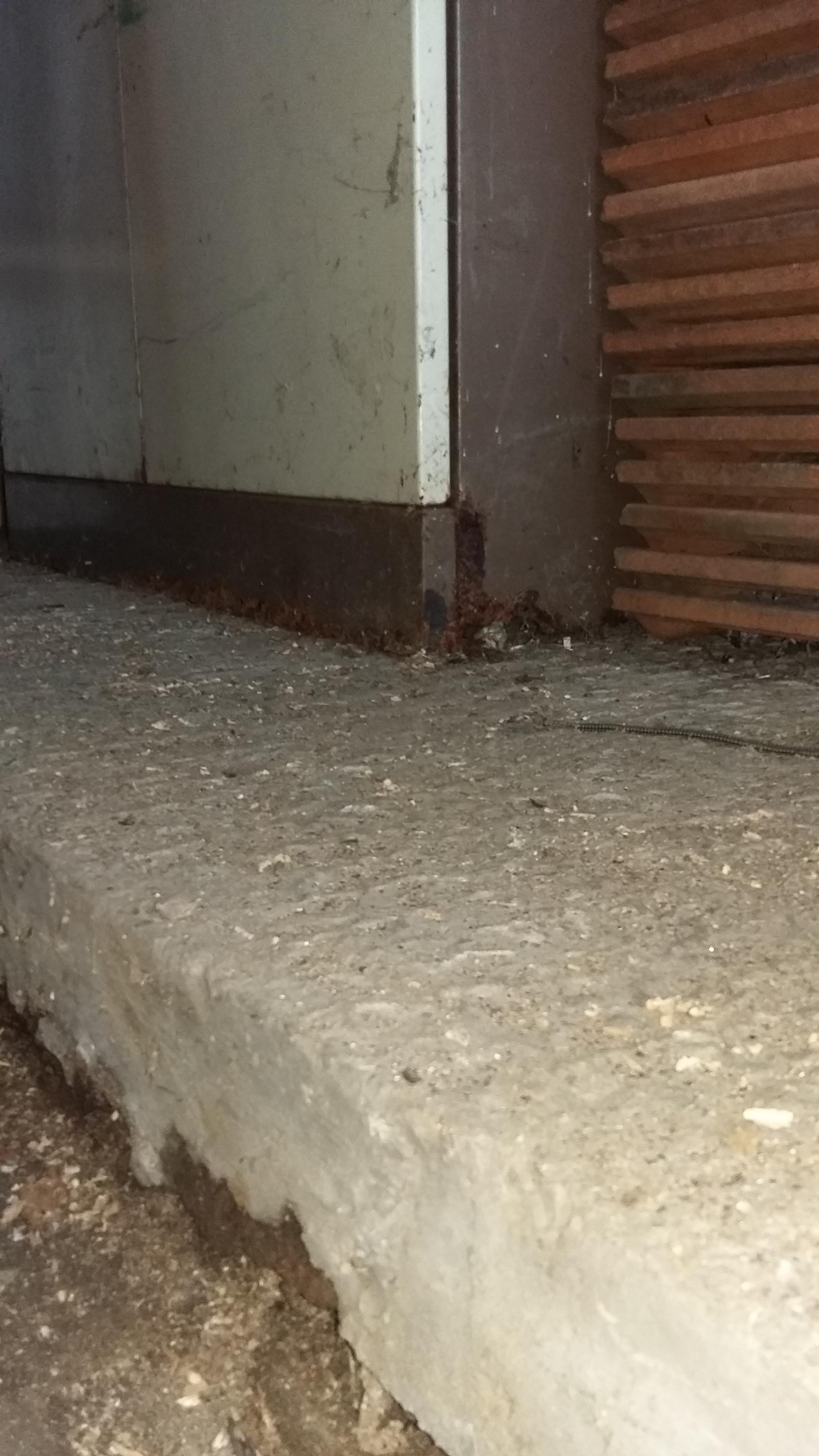

aener Posted March 6, 2020 Author Report Share Posted March 6, 2020 (edited) Pictures as requested. Can't really see the state of disrepair, but it's hiding there For example: Those end pieces flanking the door wobble something crazy. Enough that a solid kick can shove the door out of its runners. Not ideal with bikes and tools in there. Please note that the Environment Killer is next-door's, not mine. Also, as above - no asbestos present, thankfully. The end goal is to rip the current one out and build one in the style of the one in the background. Brick, tiled roof and large windows. Edited March 6, 2020 by aener Quote Link to comment Share on other sites More sharing options...
Al_Fel Posted March 6, 2020 Report Share Posted March 6, 2020 If it was me doing it I wouldn't worry too much about damp coming up though the floor, its well raised above any ground water. Damp is mostly caused by condensation and bad air flow anyway. I'd lay 2 courses of brick straight onto that concrete then do a damp course. For the floor You'll be fine just pouring some self level compound on when its all finished. A nice thin layer will stick great to that concrete. Check the flags out at the side of the building and make sure they are sloped away so no water can pool up and work its way in. There's always more than one way to do anything so take the advice of as many people as you can and what makes sense to you will do the job. Looks like a fun project anyway. Keep us updated 2 Quote Link to comment Share on other sites More sharing options...
