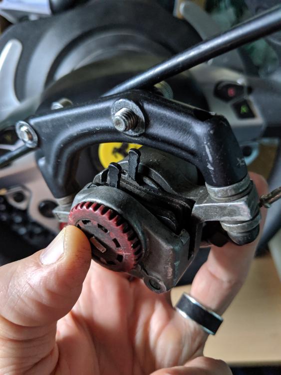

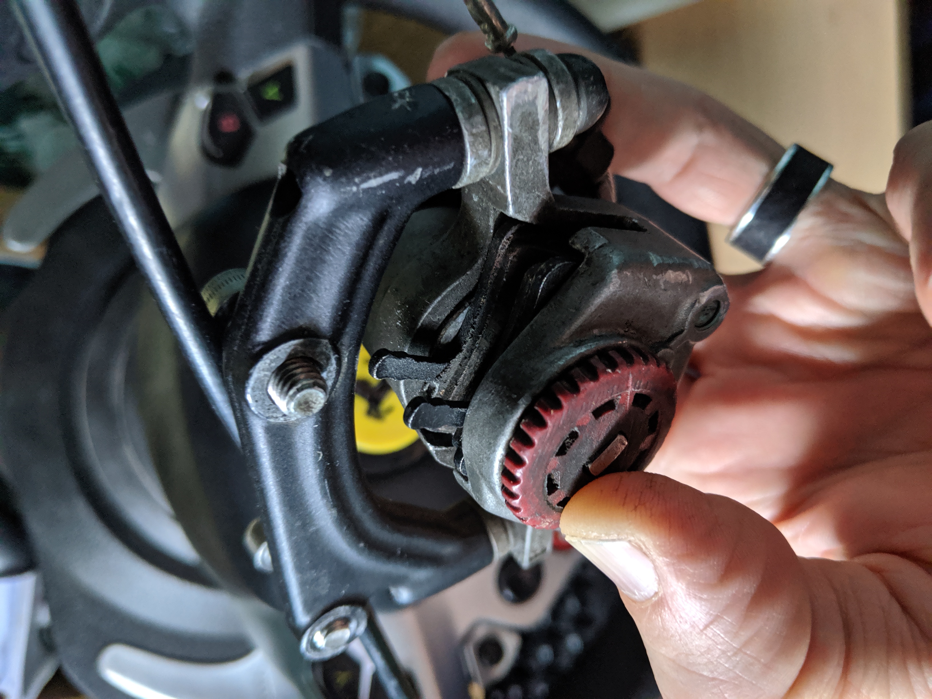

Hopefully this is me being an idiot but I've stuck a BB7 on my bike and can't get rid of the rubbing. The little prong thing coming off the pad is making contact with the post mount I'm using so it's always being pushed slightly out at an angle as a result. The calipers aligned okay besides this I think, so what am I doing oh so wrong here?

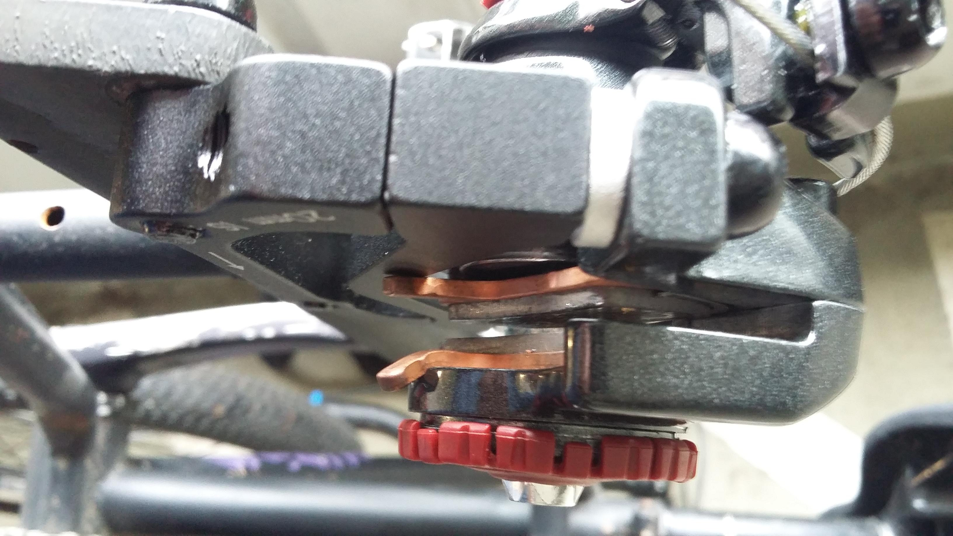

Here's one I photographed earlier :D
The avid IS-PM adaptor is thinner and wasted away, additionally it looks like you don't have the full compliment of conical alignment washers (should be 4 thick and 4 thin per caliper).
I would just cut your offending nubbin off :)
